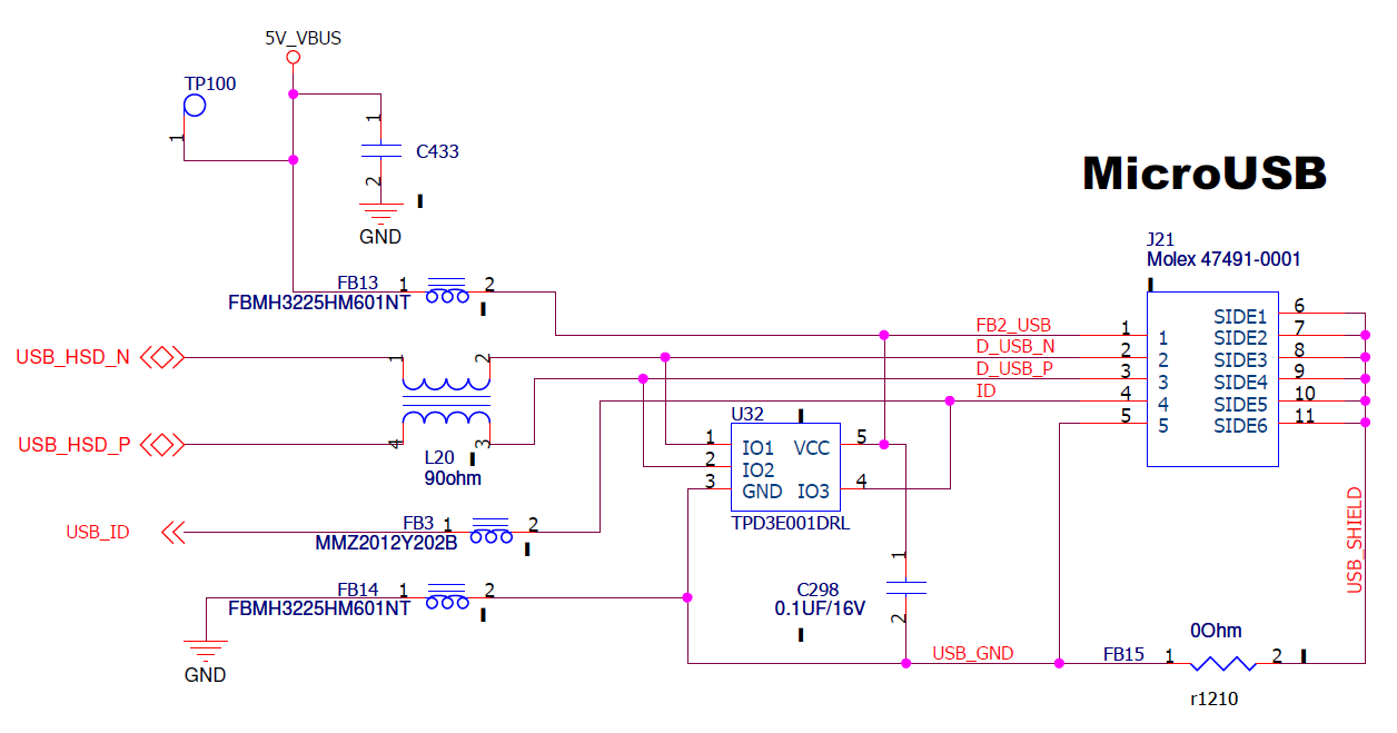

Hello marce, care to take a gander at this? Pi filter on the supply rail, common mode choke on data and an L connecting separate grounds.

Interesting and very similar to the design I posted last August🙂
It has a clear break between input and output, which means no capacitive coupling of the noise from the upstream device.
A zero Ohm resistor is a link it does not isolate the ground. The whole point of using the bead is to split physically the grounds, the high frequency noise is then attenuated by the bead... Have a look at the design I posted on the other thread, I believe I did a detailed description of the reasons why things were done as they were.... The zero R above is to allow the USB shield to be separated from the USB 0V or for a cap to be used in place of the resistor to provide a low impedance connection at high frequencies whilst isolating the screen from USB ground at lower frequencies.
Yes I noticed that. Would you say ground isolation this way is the main way for improving the USB interface?

We are talking EMC engineering and removing coupling mechanisms for the noise, if you have one contiguous ground then any noise will couple capacitivly to any routes and power lines that are over the ground plane. The scheme I showed was from some work I did where we had to have immunity up to 18GHz, not from a commercial design, where I worked with an rf engineer for two weeks on all aspects of noise reduction... and learned an awful lot regarding coupling mechanisms especially for high frequency noise, which is prevalent when you have digital switching such as in a PC, look up simultaneous switching noise.

A ferrite on the USB data line would do more harm than good, same goes for other digital high speed connections like HDMI and LAN.
You know how USB is such an iffy connection that always has spoiled connectors/cables and have to fallback to lower speeds because the cable degraded till it cannot support high speed?
USB 2.0 480Mbps has a clock of 240MHz and bandwidth of 1.2GHz. This is higher than lots of airborne signals (e.g. on-air TV) and higher than most SMPS switching frequency. The ferrite will block out more signal than noise.
In addition, high speed connections are impedance controlled in order to hit those speeds, so adding a ferrite choke (which is a high impedance in series) will cause signal reflections.

wwenze, what about the choke i posted from coilcraft?
That one supposedly is meant for USB 3.0 communication.
