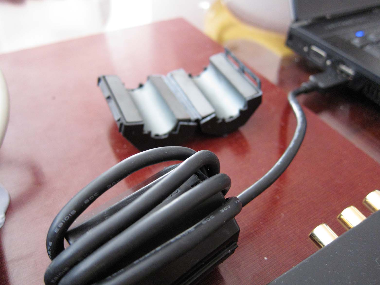

I use a ferrite & 4 USB cable loops. The solution (see the photo) provides great sound improvement in bass definition, spacial positioning, speed & timing. Amazing really...
The problem with most of the available isolators is they don't actually isolate the computer noise, the Jitterbug being a perfect example. most noise from the computer is high frequency (I would like to see some figures of how much noise is getting down the USB) the Jitterbug is not laid out with any consideration to this noise and the coupling mechanisms of the noise, so its useless as I believe measurement's on the WEB (and from stereophile I believe) have shown.
I second a ferrite it will do as much if not more than some of the dubious offering....
