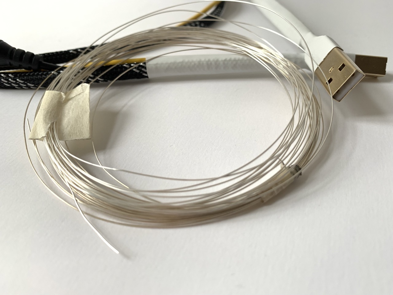

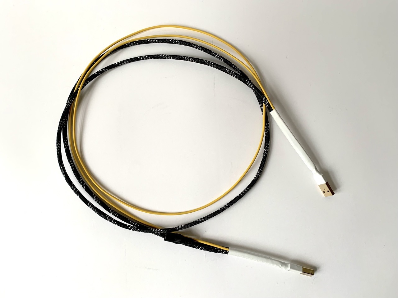

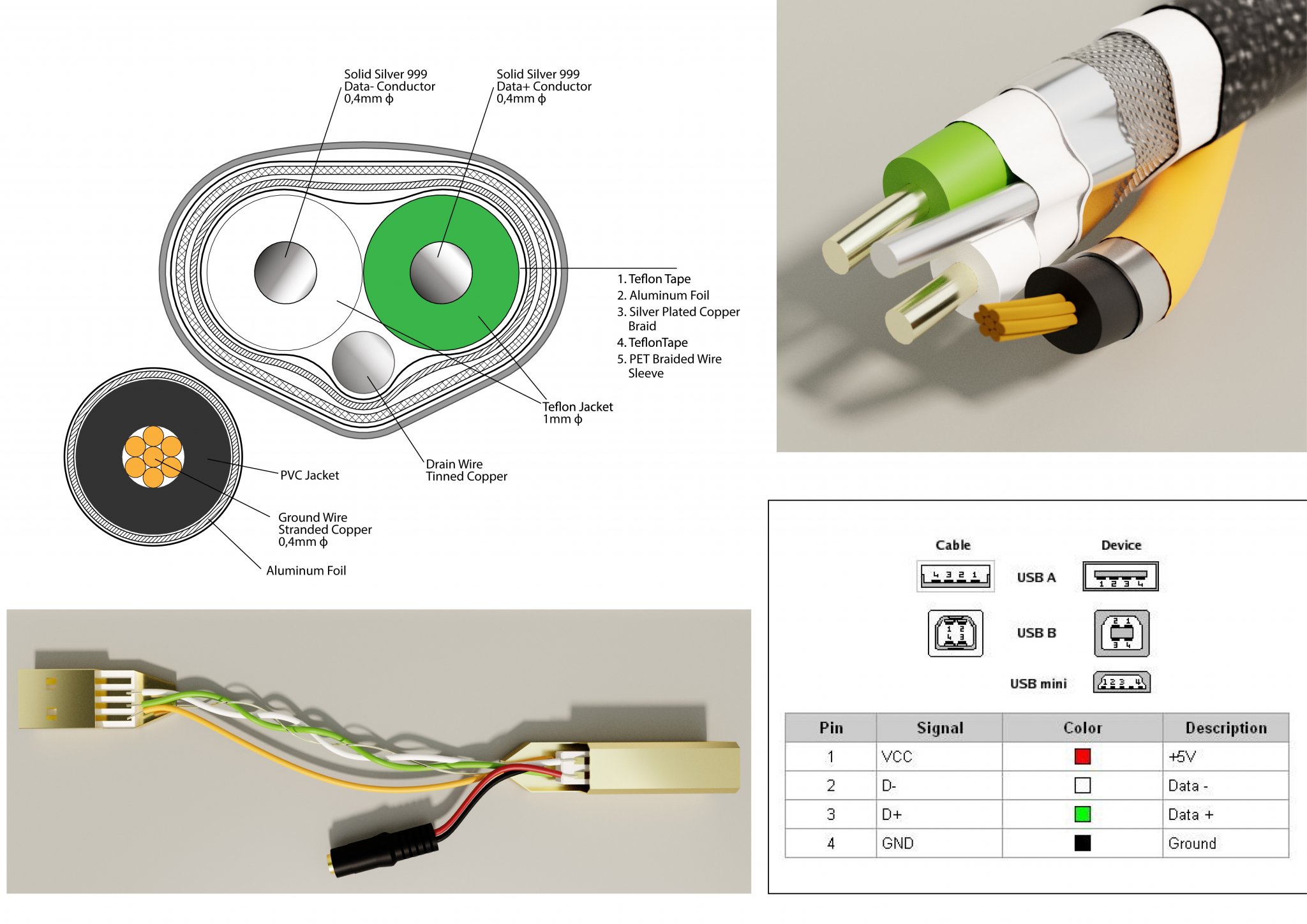

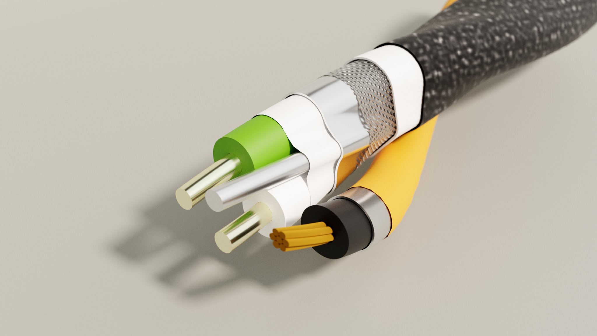

Hi there! I'm pretty new to this forum and found this very interesting thread. I have successfully build my own USB cable for my DAC. I built it using pure 999 silver conductors and separating the power delivery by adding a different external connector that is directly soldered to only one end of the usb.
I am using it in my system and although I don't have great speakers I can still hear a slight improvement. Here I'll upload some pictures and renderings I made to show the design.
What do you think about it? I'm curious to hear your opinion.
What software did you use to render your images? [ This is much a more impressive achievement than the cables themselves !]giova_dan:
Ahahah thank you, yeah took some time but wanted to experiment with that and I'd like to sell it if possible so I though it'd be useful.What software did you use to render your images?
I used Blender for rendering and some modelling and Rhino7 for the more precision modelling, the braid itself was made with grasshopper, with the Peacock plugin it's really easy.
But yeah about the cable I followed what I found in the internet, and came up with this version of my own. Don't know about capacitance and inductance but I guess since the signal is very low current that shouldn't matter so I focused more on the shielding.
If you find mistakes in the constructions or things I should have avoided / done differently please let me know since I'd like to make another one in the future, maybe thicker with cotton insulation and then braided shielding on the outer layer?
