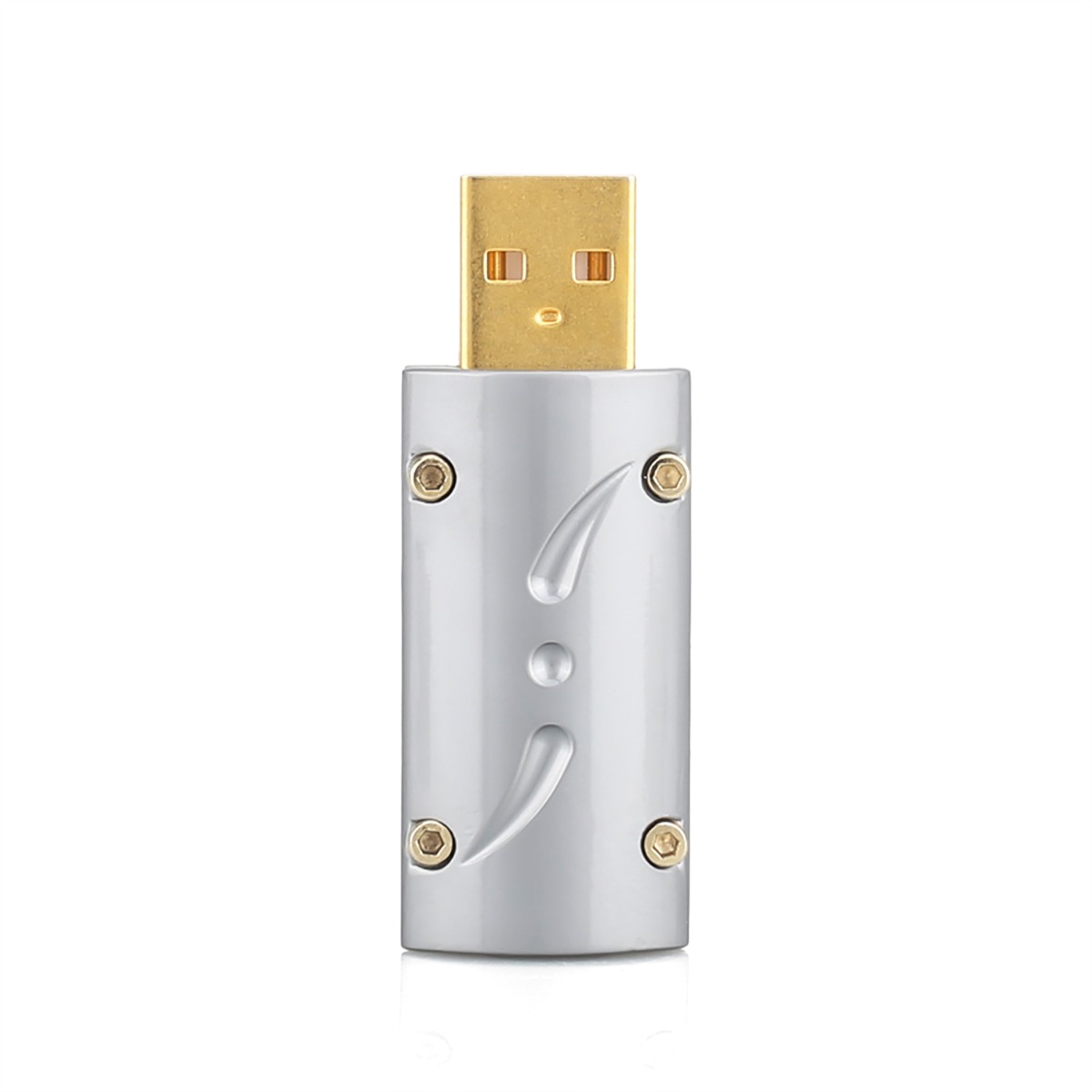

Where did you source your plugs from? Are they gold, Cu or both? For example:Yes it's right. One cable is for data transfer, the other for the power line: that's why both they have been used as a twin cable (cabling alongside). T,he shielding sheaths are then combined in the common connector (A + B).

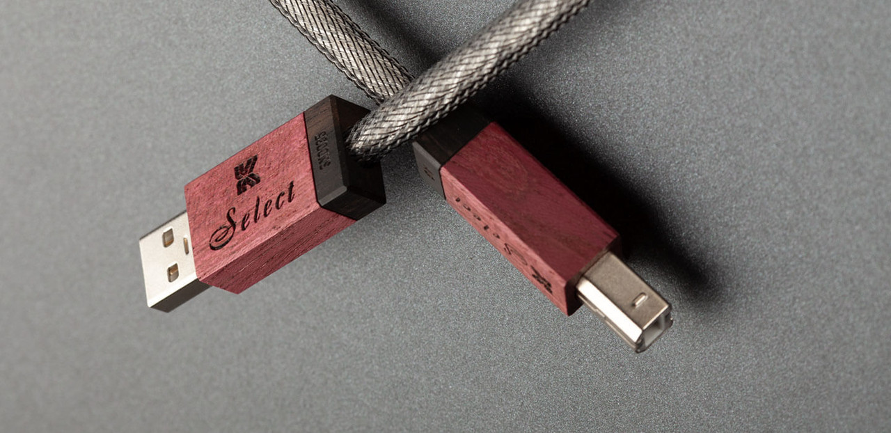

If you're feeling ENTERPRISING, you might go the Kimber Kable direction:
Price: $2,100.00
Part Number: KS-USB-AG-A-B-1.0M
The KSUSB-AG is a no compromise design. The highest grade aerospace materials are incorporated into the KSUSB-AG for unmatched performance.
Dye-free wrapped air- articulated PTFE dielectric provides the highest degree of impedance uniformity and dielectric performance related to loss and delay. 100% pure silver signal conductors provide near lossless signal transmission (up to a 6.5 meter length.) The over braided shielding with 95% coverage (44awg copper with 8% silver plating) is circumferentially bonded to the USB connector shell with pure silver foil for maximum shielding performance. The 5V DC line is comprised of 4, 24AWG pure silver conductors. In many DAC implementations that don't utilize this 5V DC line these conductors are used to augment the ground plane. In these circumstances these pure silver conductors will push noise levels even lower. With a powered device you will see very low voltage drop on the 5V DC line.
These carefully executed details deliver sonic performance with no compromise.
FREE SHIPPING
ORDERS OVER $99-
https://www.ebay.com/itm/284955857328
I bought them on an audio store placed in my country. They are gold plated, good quality ones. Here's the link for the USB-A:
https://www.audioteka.it/connettore-usb-maschio-tipo-a-placcato-oro.html
I'd like also to try the Viborg, which have an elegant shape.
Vborg from China. I have had the exact same plug in my Ali shopping cart for a few days:I bought them on an audio store placed in my country. They are gold plated, good quality ones. Here's the link for the USB-A:
https://www.aliexpress.us/item/3256801825698782.html
Pretty sure your Italy component is also from "the East" (probably brought back by Marco Polo himself):

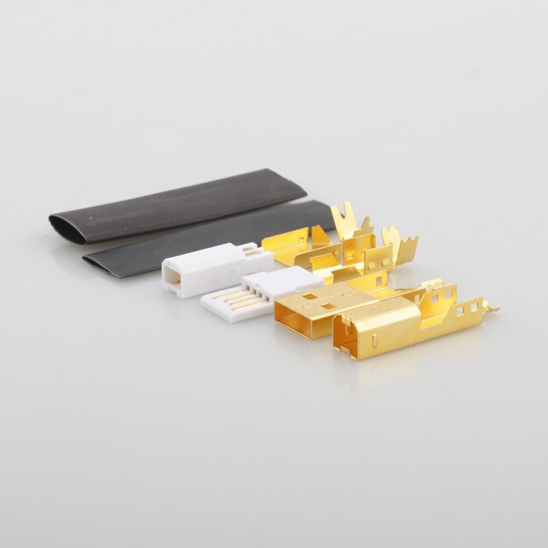

Made some USB cables many years ago.
Found the plugs to be the most disappointing aspect of DIY. What was available looked even worse than free cables.

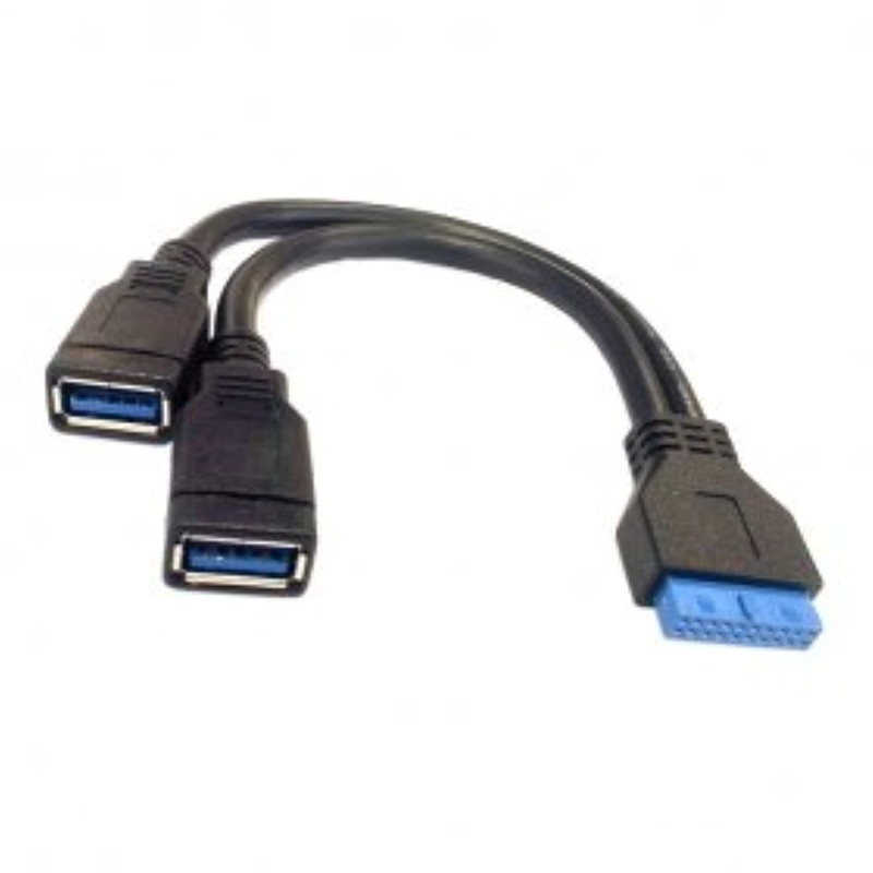

Most audio-related discussion about USB cable end at the PC jack (female port).
However, there is still the PC internal connections (inside the case).
All things held equal, such as you're using a decent motherboard and PSU to begin with, two possibilities exist:
(1) Use USB ports that are affixed to the motherboard itself (usually, the jacks/ports on the REAR)
(2) Use front or top ports on your PC case. (see image)--the end on the right is at the mbd pcb. In this case, you may consider re-wiring these to higher quality, solid silver or Cu wire.
