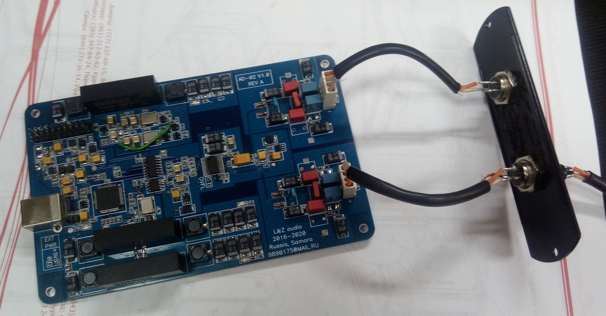

Finished the audio ADC on CS5381.
Connection interface: USB only.
The input buffer is made on an FDA op amp, so you can connect both balanced and non-balanced sources. Recording formats: 24-bit 44.1 kHz-192 kHz.
Powered by USB, current consumption 750 mA.

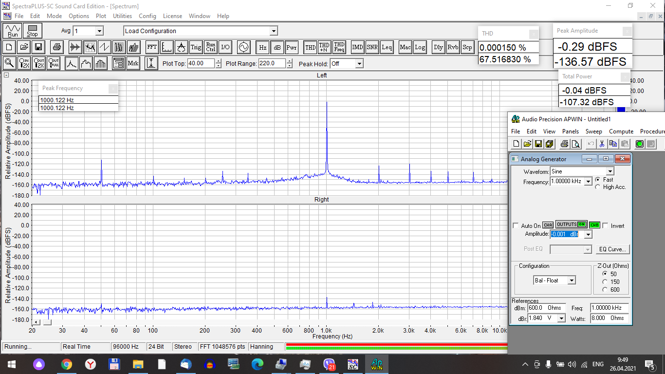

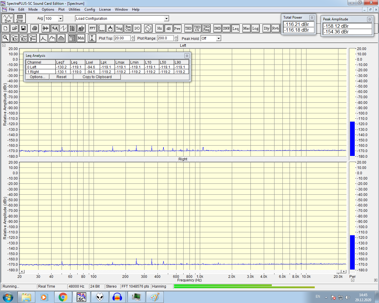

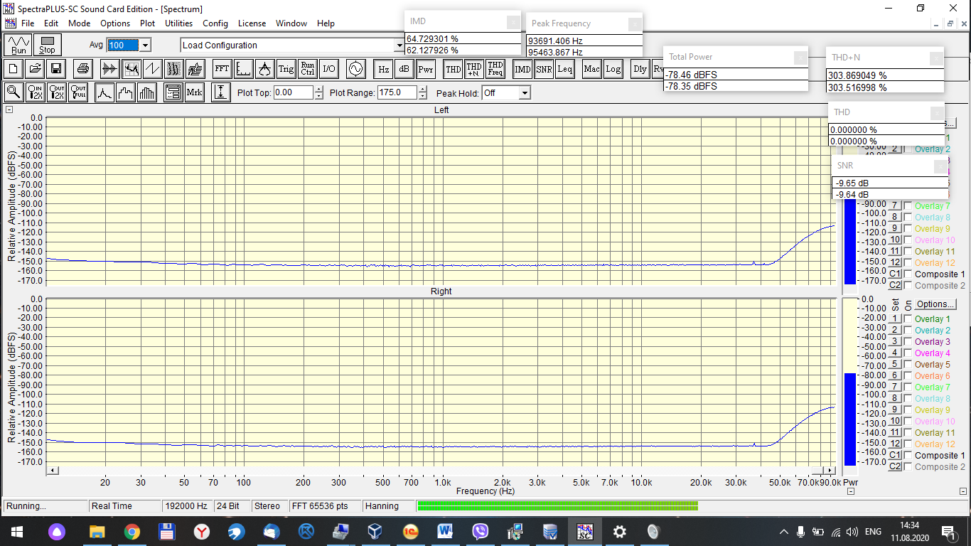

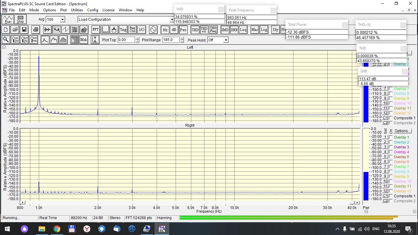

A pair of images: a noise shelf and THD, the source of the Victor generator at 1 kHz. The input divider -12 dB.
There are certain problems due to the low input resistance, so it may be necessary to recalculate the filter, which may cause a slight deterioration in THD
