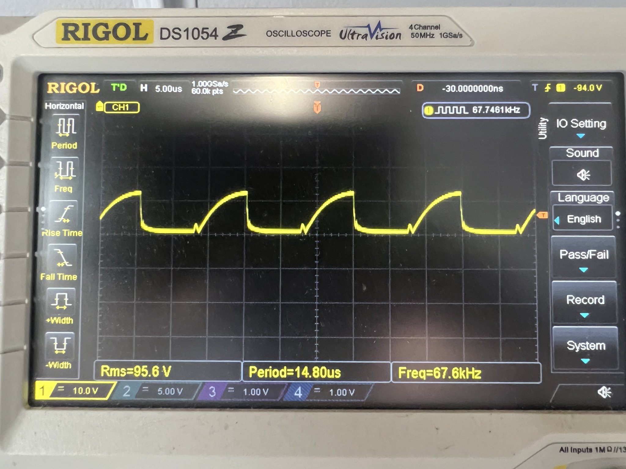

I replaced Q39 and now the amp is oscillating. However, there looks to be a problem still.

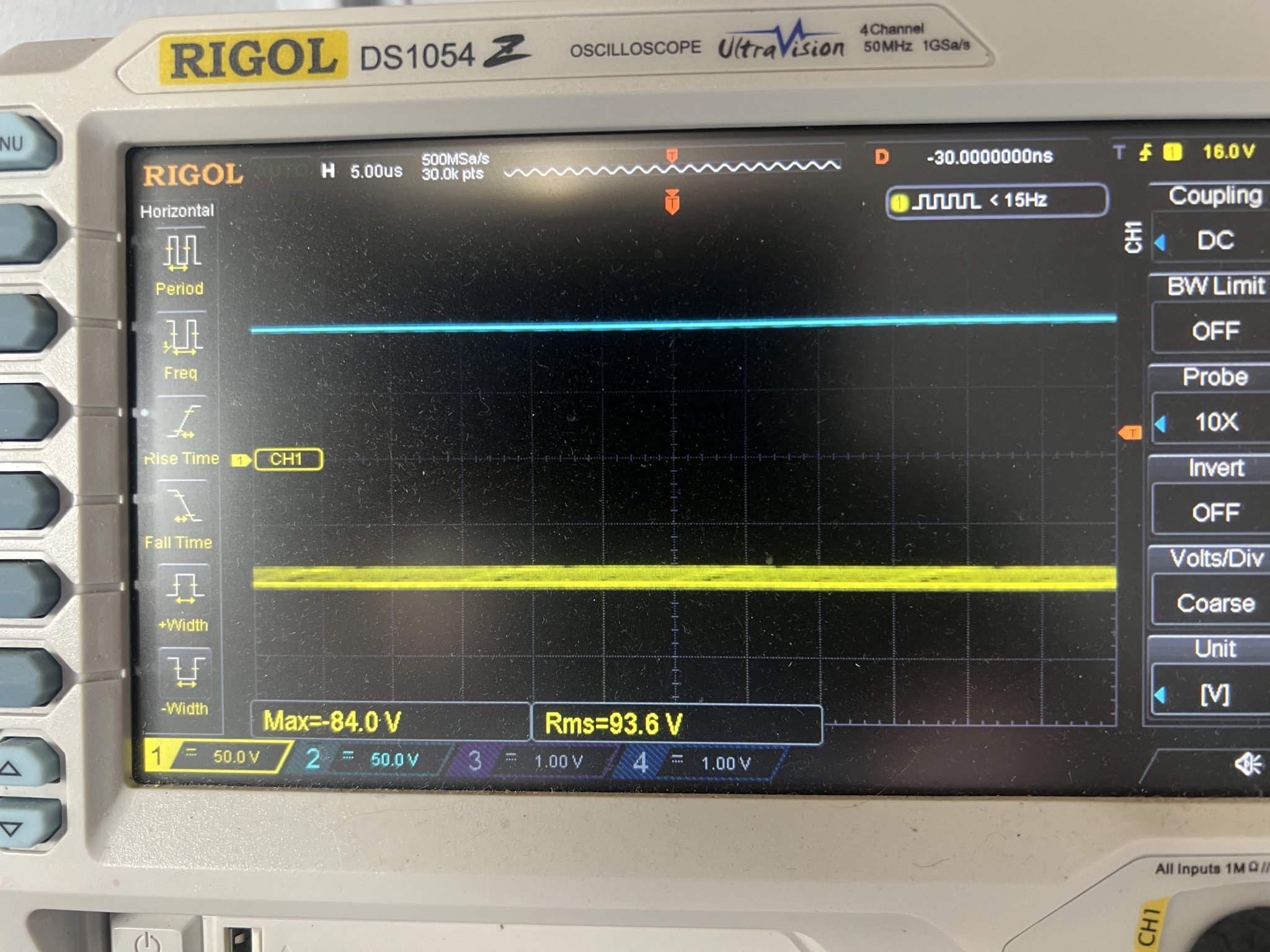

When probing after R146, the first photo is what I get. If I remove C75 to test, will that cause damage to the drive circuit? The second photo is when I probe the base of both Q45 and Q54.

When checking the bad drive side at the cap, I get picture one. The not so bad side I get picture two. I’m going to assume I need a new cap. I’m not totally sure how to test caps this way. I removed it earlier on in the testing and tested it with an LCR meter and it said it was OK. Just because it measures OK doesn’t mean it is….

The drive pattern that I’m getting though, looks as if something after R146 is pulling an NPN transistor down in the drive circuit. I have replaced all the transistors in the drive circuit so far.

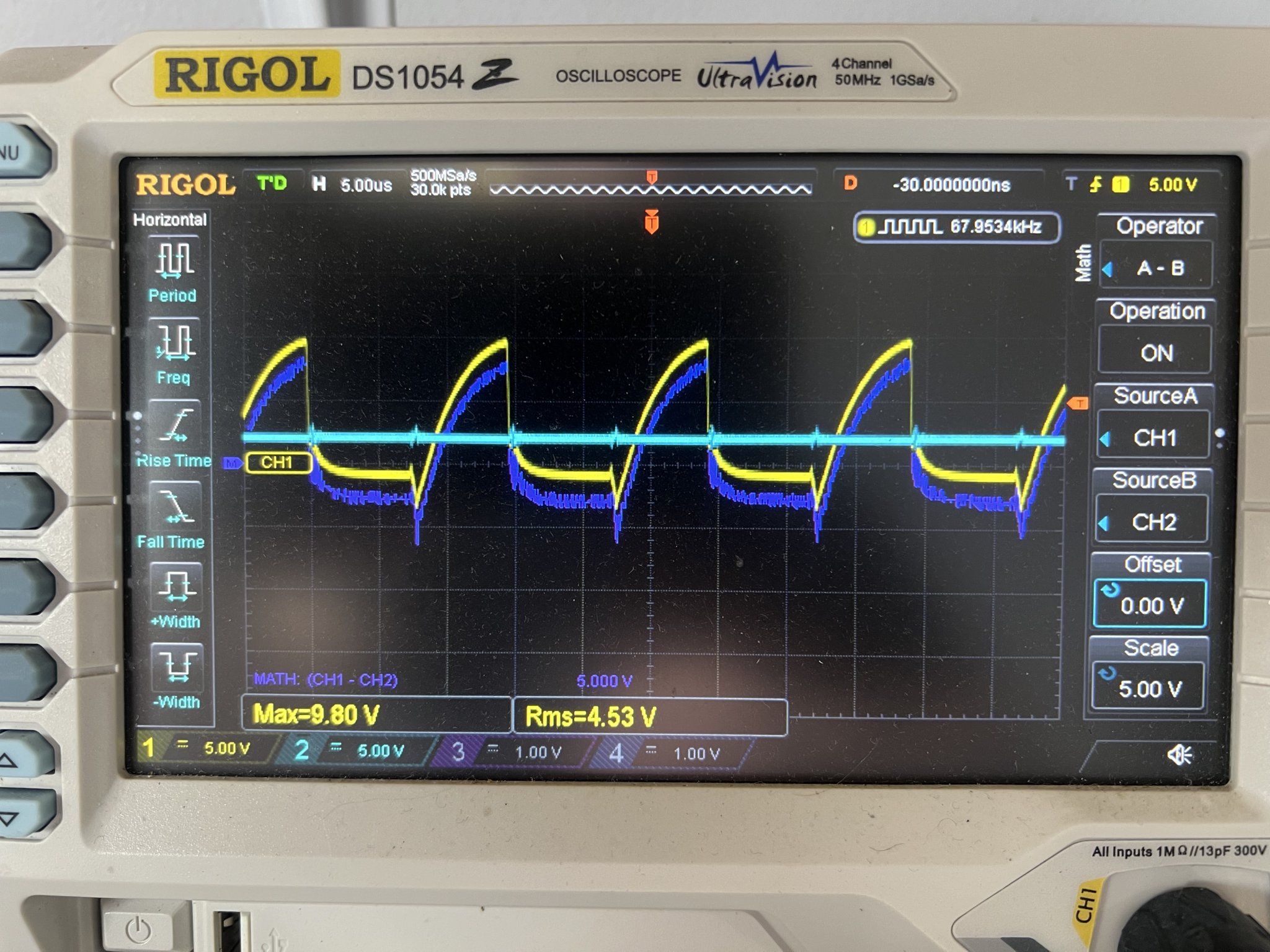

I put my scope in math mode, channel a - b. I put channel a on the source, and b on the gate. This is what I get.
If I connect the ground of my scope to the DC ground of my power supply, weird things start to happen.

The scope's chassis ground shouldn't make a difference. I'd leave it connected to the 12v power supply ground terminal.
In differential mode, you should only have a single waveform (like when using a single probe) when using both channels (two probes). Some digital scopes make this far more difficult than it needs to be but after you spend the time to get it right, you know what to do the next time.
Drive signals MUST go back to the voltage on the source terminal. You can't check that in AC mode.
All AC mode can tell you is that you have a signal and the amplitude... but the amplitude of the drive for the high-side is dodgy at best. You can compare the readings g-s for the high and low-sides and get a rough idea whether the drive is OK. If they seem OK and the amp doesn't draw excessive current and the outputs don't run hot, you can assume that all is OK. That said, differential mode tells you instantly whether all is well, or not.

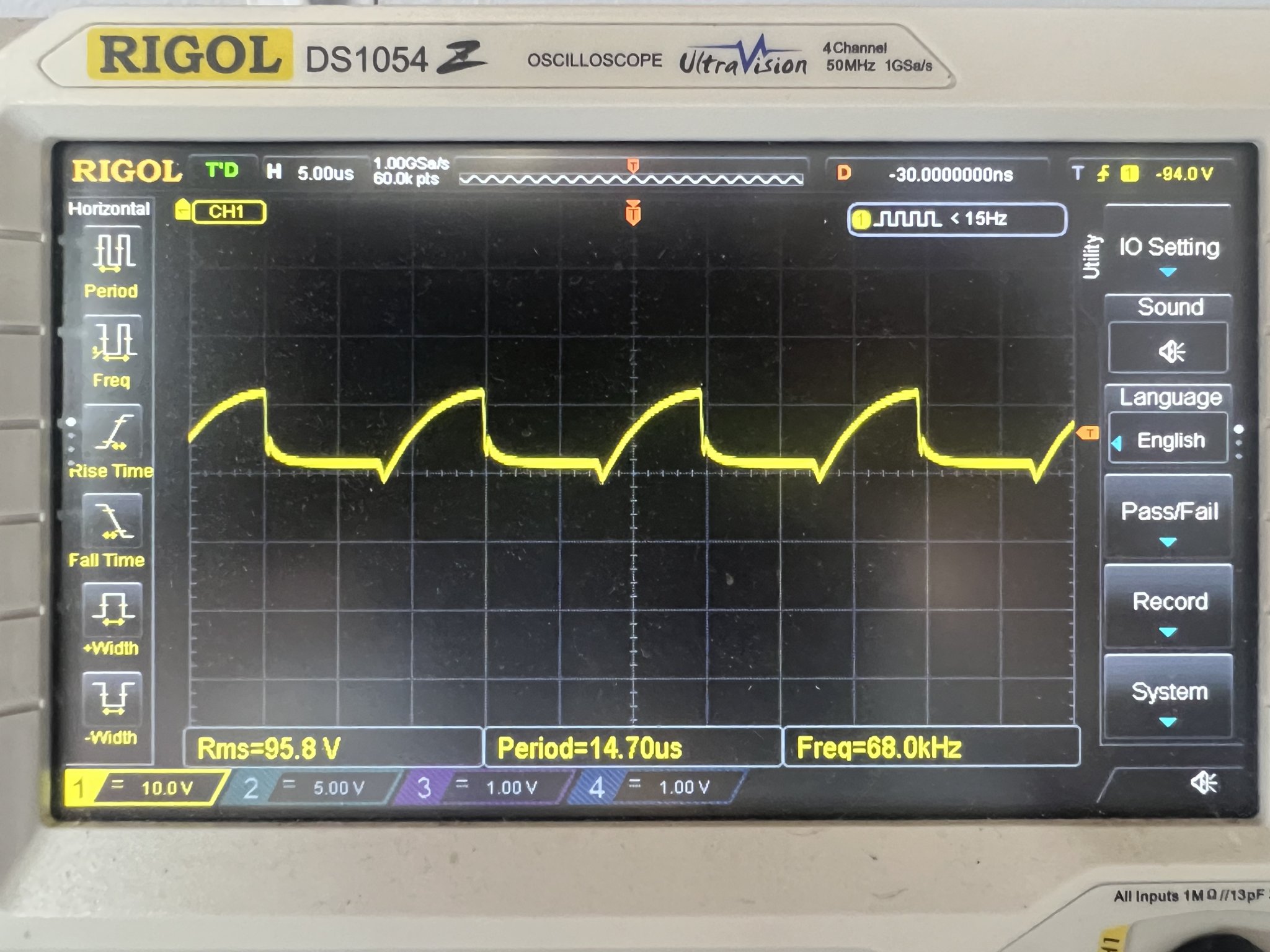

This is what I get when I couple DC, and move the trace up to where I can see it. Best this scope can do until I either float the scope (which I don’t want to do) or get differential probes.
The amp draws 2.0A of current as of now, nothing is getting hot. I’m going to install the transistor I removed to get the optocoupler working normally and put a speaker on it to see what it does.
I still can’t verify output waveform unless I have differential probes can I?

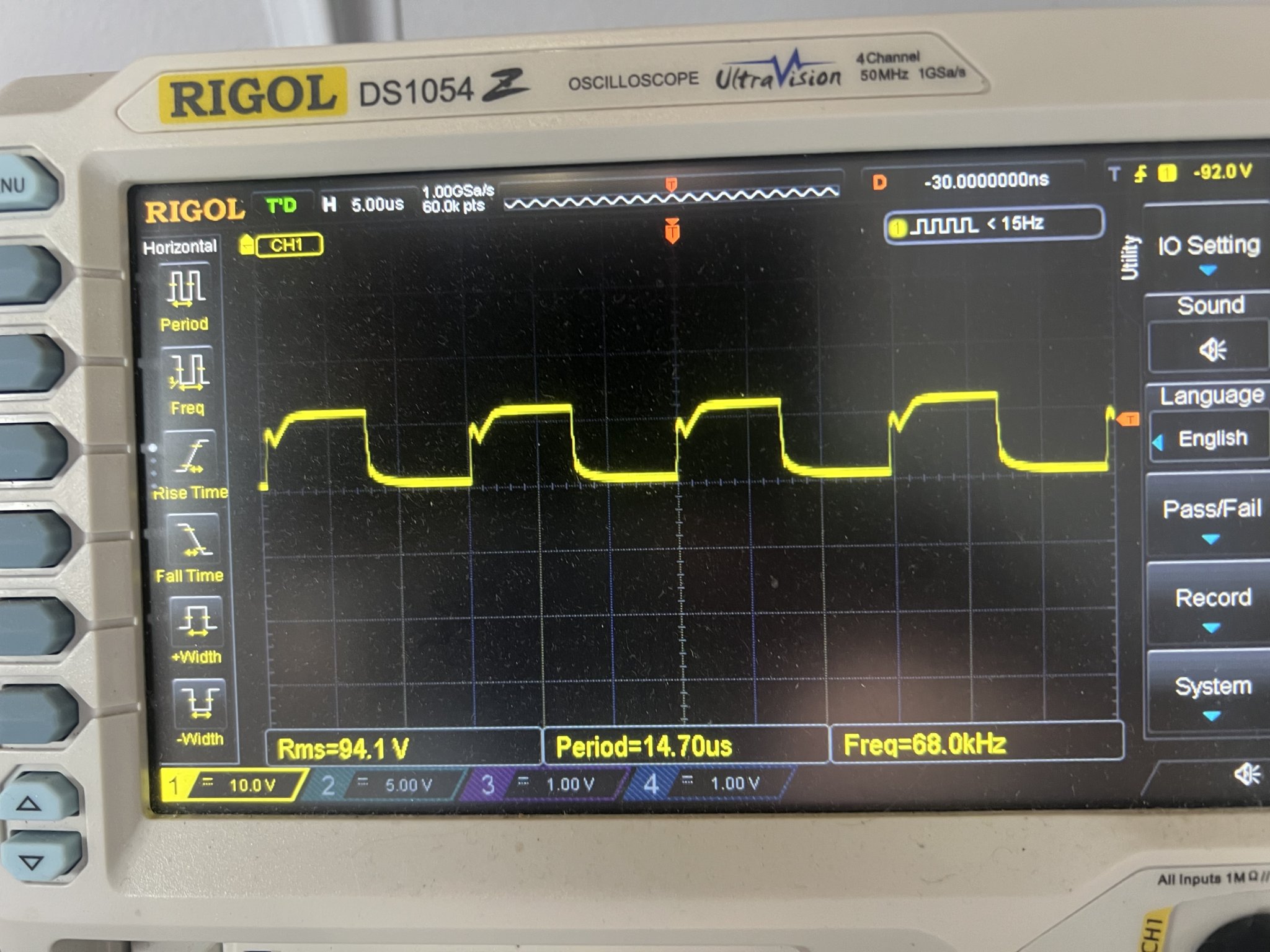

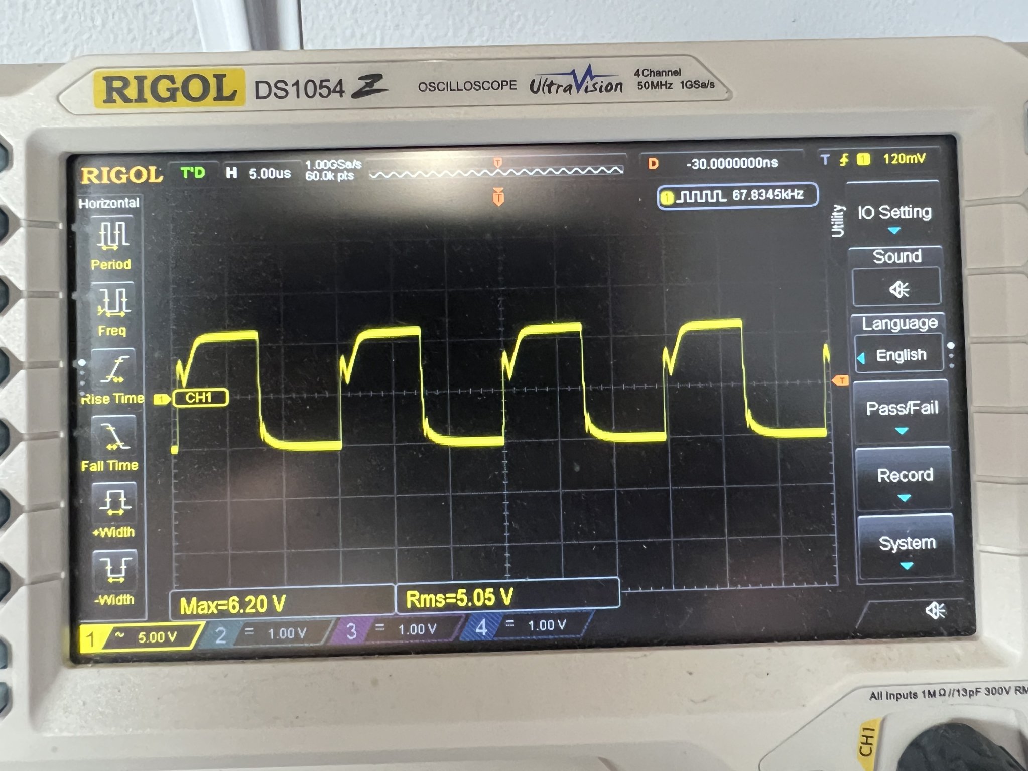

I don't know what point in the circuit you're testing. I test at the outputs.
Before installing the outputs, you can test the high-side drive without differential mode.
Since this is a relatively low-voltage amp, you can raise the display (DC coupling, lowest possible vertical amplifier setting) until low rail is at the lowest reference line on the display, then probe the signal for the low-side. You could use both traces (one probe on the negative rail and the other on the gate).

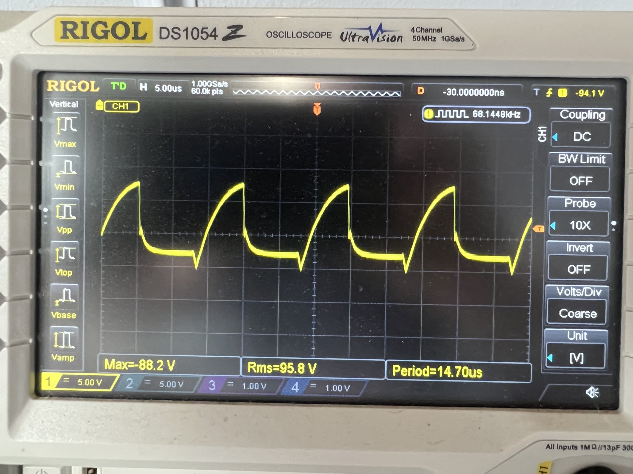

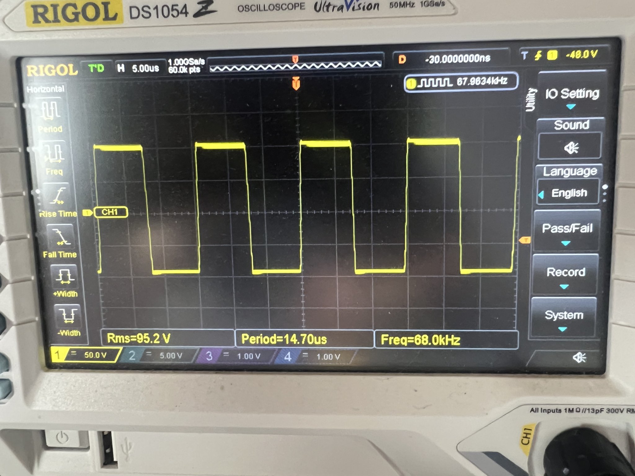

Picture 1 is at the first output fet gate (outputs are all installed) in the row, picture 2 is after R146 to the rest of the drive circuit to the fets. Picture 3 is at Q41 at the emitter (pin 1). When checking everything with a thermal imager, there’s nothing getting hot in the drive circuit at all.

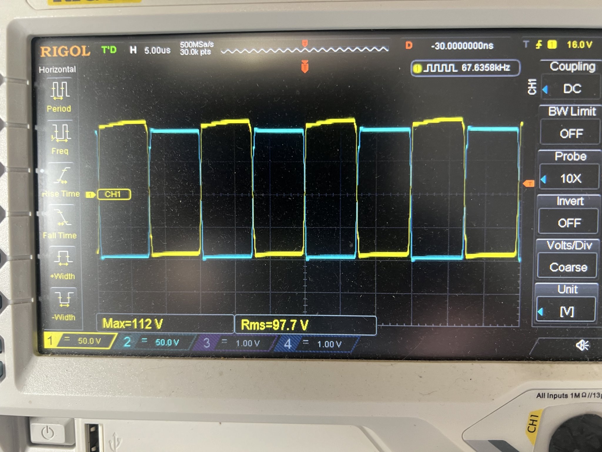

Finally the last photo is of the drain on the output fet where the gate is shown in photo 1. To me it looks dodgy but nothing is getting hot…..
This is DC coupled with the trace position adjusted so that you can see it on the scope screen.
