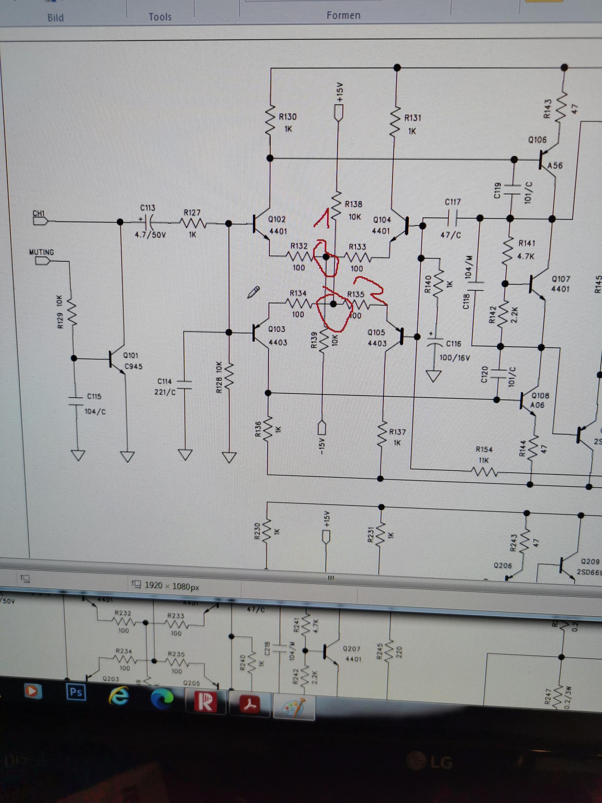

The jfet is pulling the input signal to ground, at the beginning of the first input stage. See the last diagram. I rechecked the voltages at the optocoupler. Ground is sec. center. At Pin 6 i have now -15VDC, the same as on Pin 4. It stays on all the time.

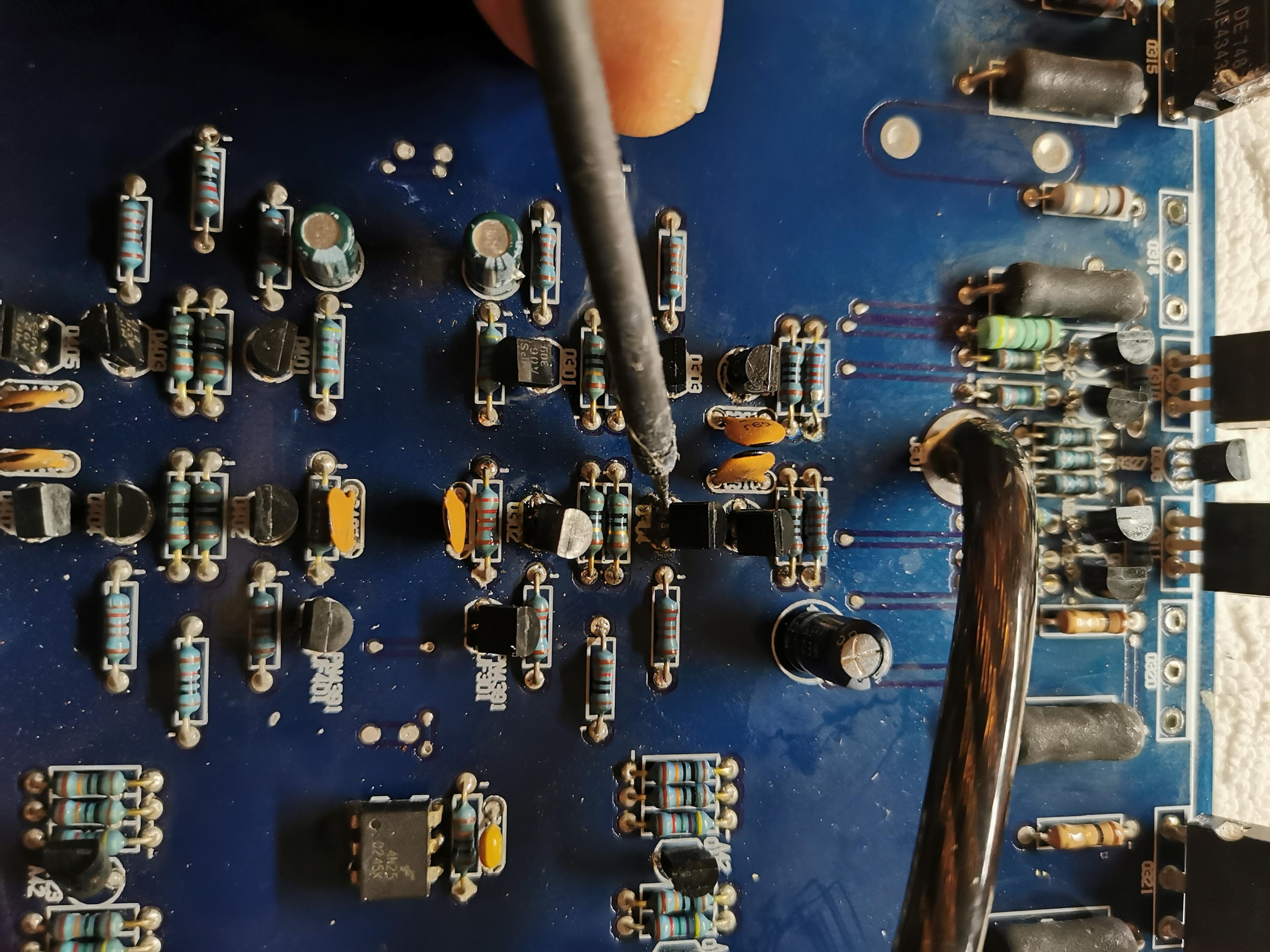

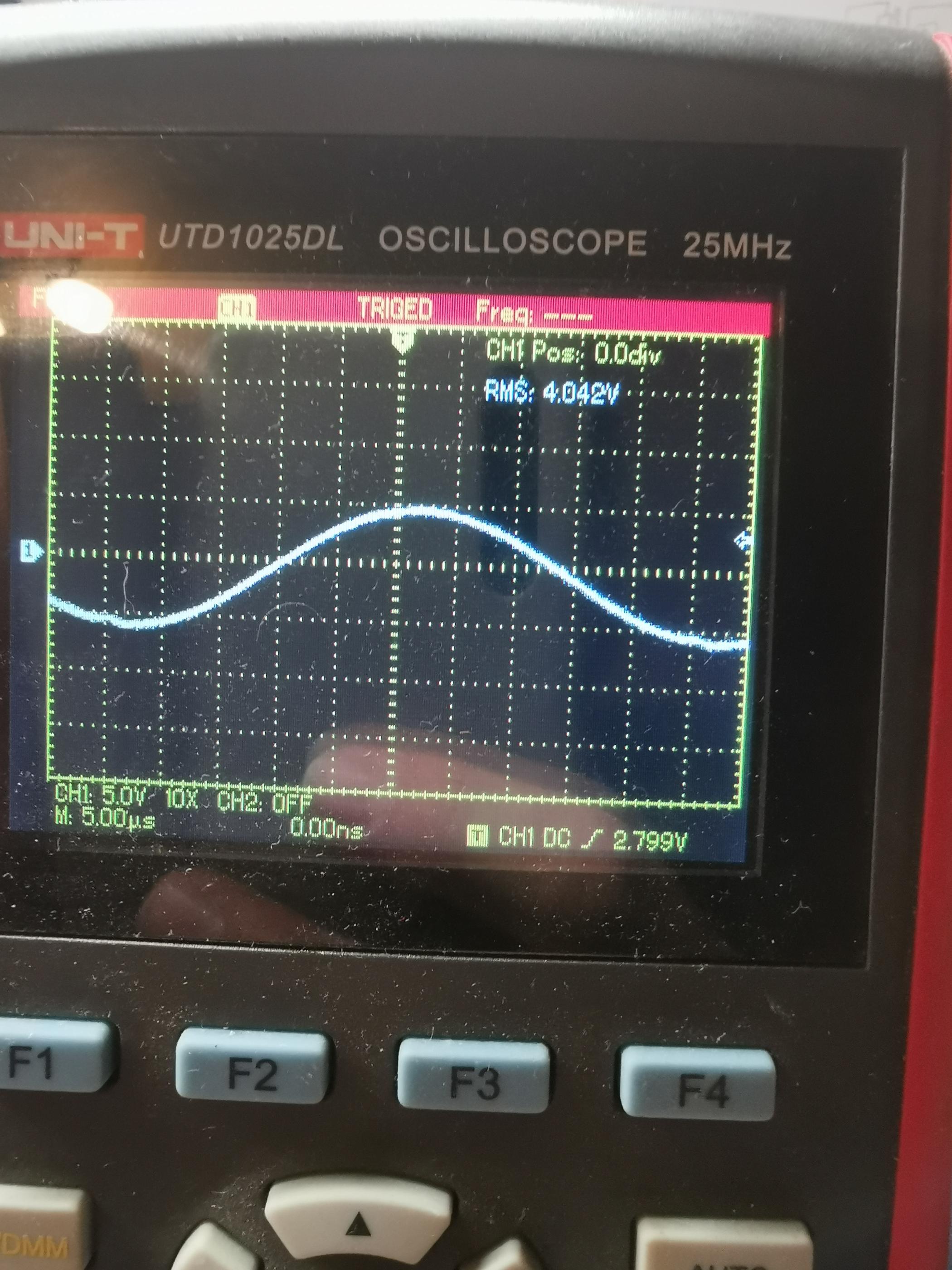

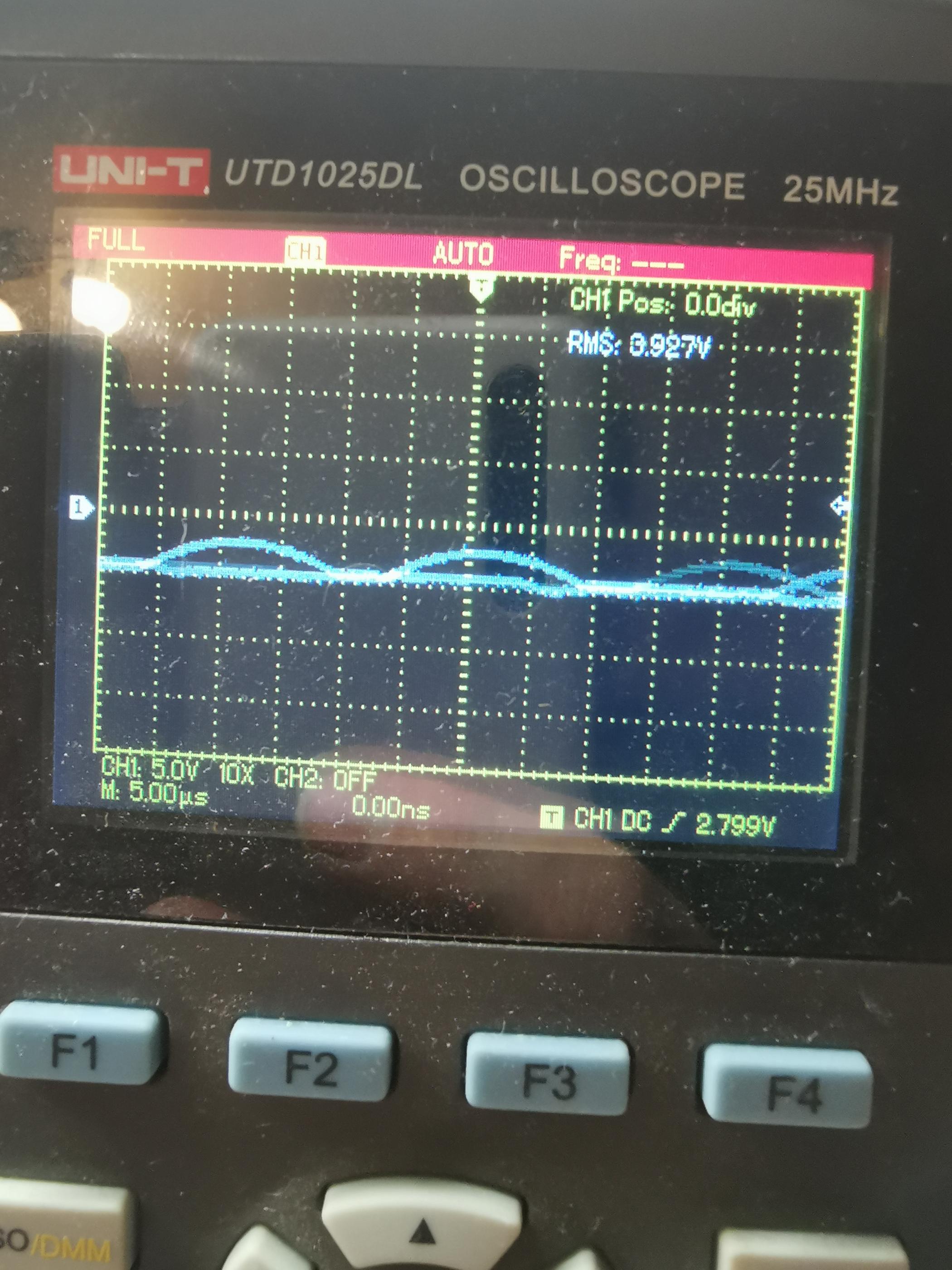

See attached picture. The left transistors signal is OK, the right one bad and pulled down. At the schematic the good side is 1,the bad side 2..

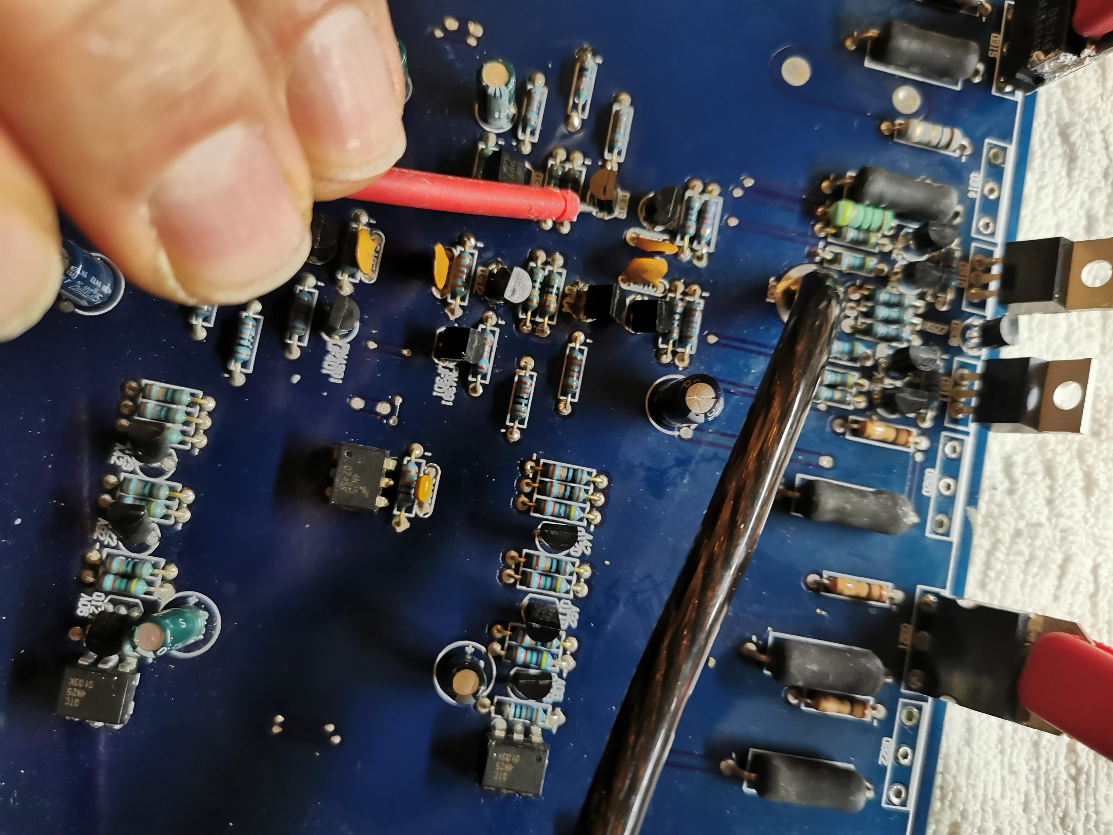

If I remove q105, the signal is good... But the transistors are OK. The 15 v is also present.
So, if i measure at the base on the outputs, it pulls my signal down to negative and fully disorted. But, if i reduce the frequency to about 200Hz, everything is fine. As more as i increase the frequency, as more it goes to negative, reduce the amplitude and disort more.
Found the problem... I think for the future i need some glasses....I made a bridge, at a place where no bridge should be.-..
