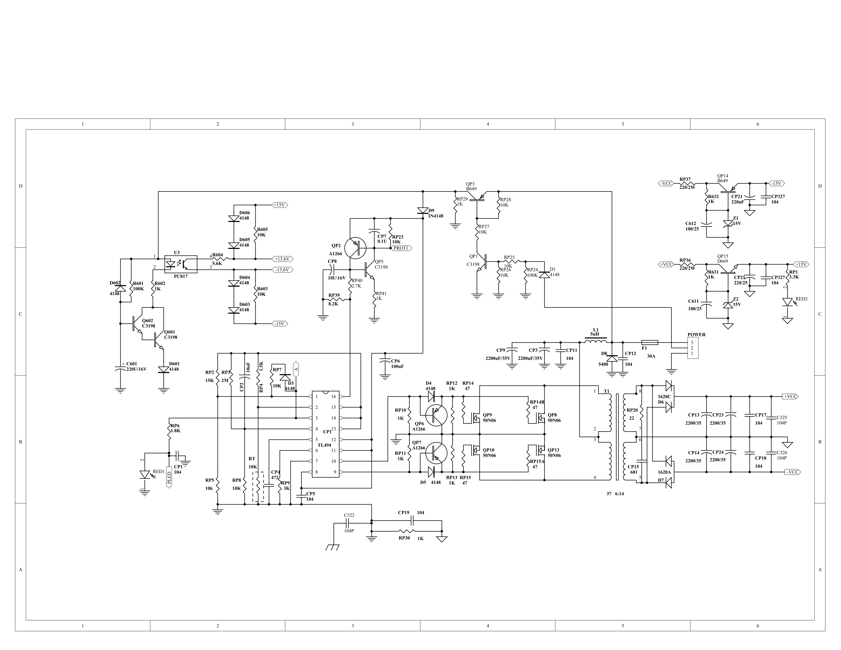

I don't understand the muting circuit as you've described it. N-channel jfets need negative gate voltage to switch off.
I also don't understand why you have positive voltage on pin 4 of the optocoupler. Is it still positive after the end of the mute delay?

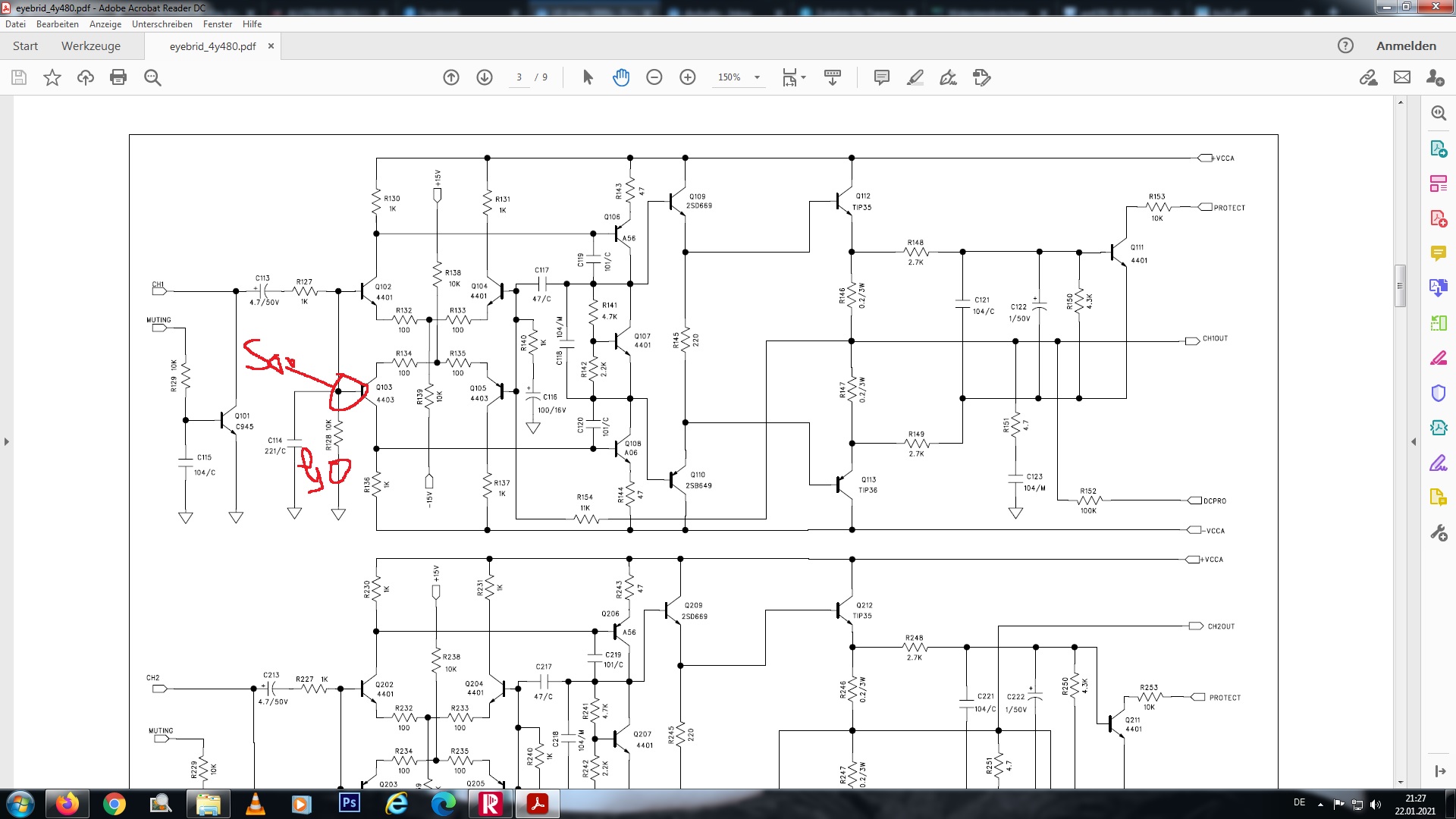

The jfet is pulling the input signal to ground, at the beginning of the first input stage. See the last diagram. I rechecked the voltages at the optocoupler. Ground is sec. center. At Pin 6 i have now -15VDC, the same as on Pin 4. It stays on all the time.

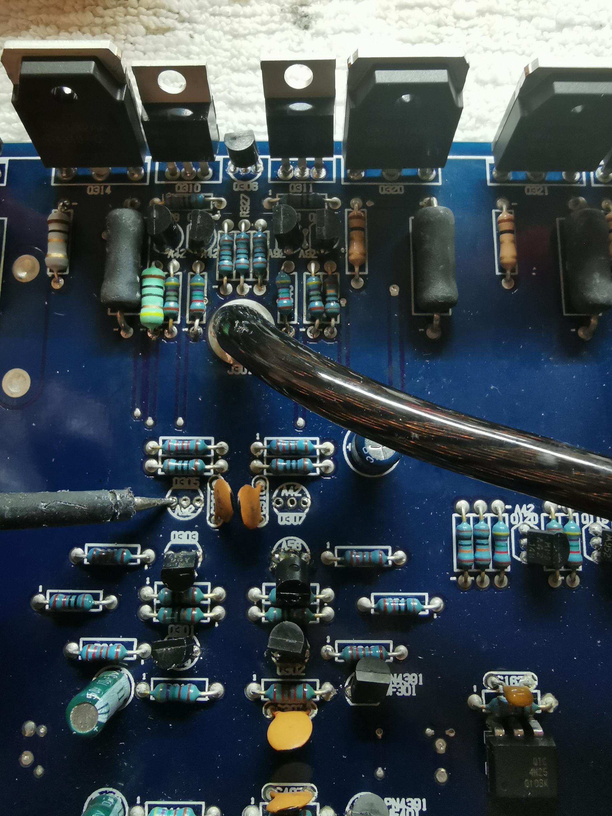

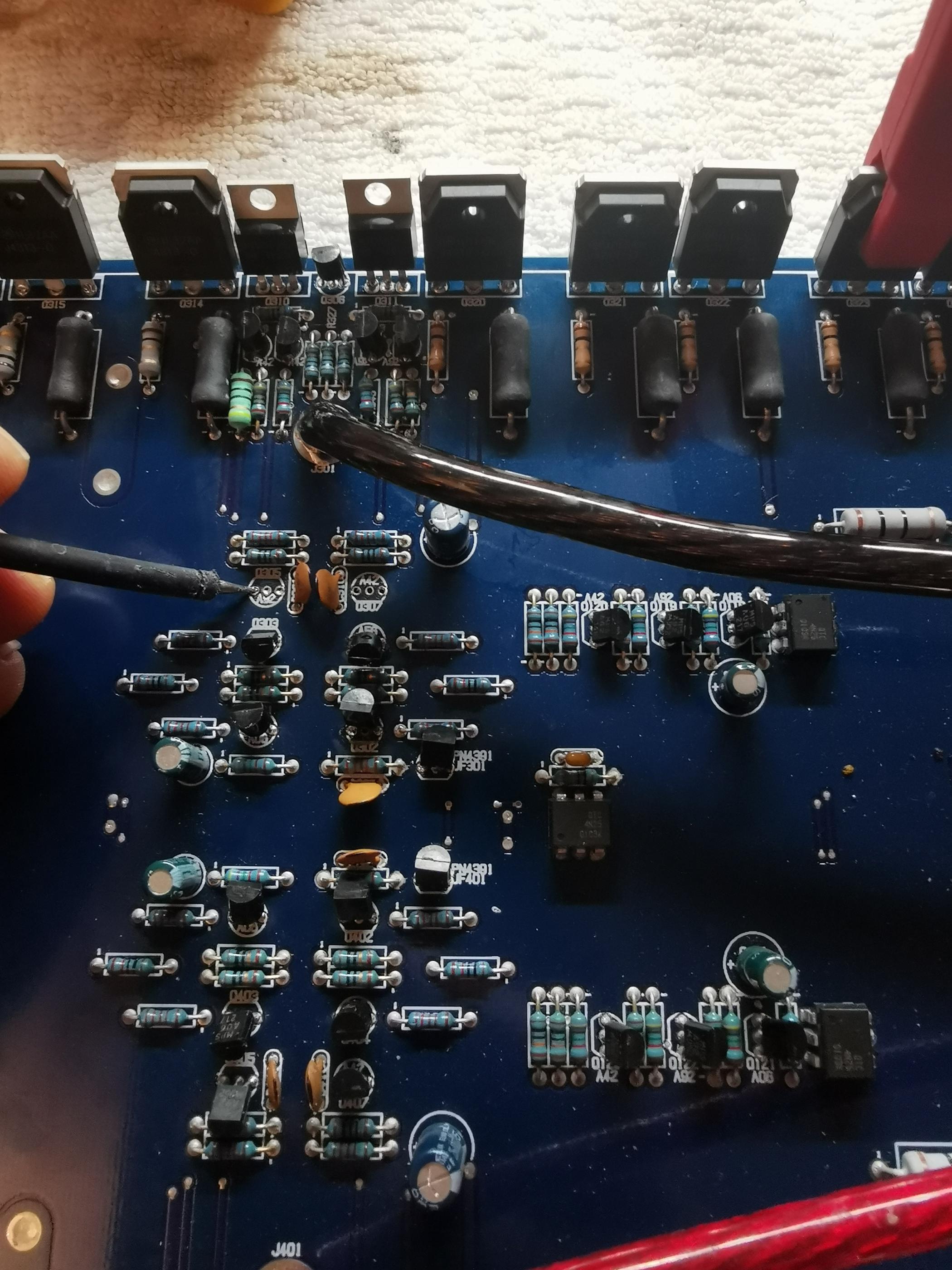

Now iam troubleshooting the repaired channel with this sawtooth problem.
It seems, that there is a new transitor leaking in the second stage from the negative side..
Also sometimes i have dc offset... so there is still an intermittend problem.
I don't know right now. But iam not sure if this is causing my problem.
See attached picture. The left transistors signal is OK, the right one bad and pulled down. At the schematic the good side is 1,the bad side 2..
If I remove q105, the signal is good... But the transistors are OK. The 15 v is also present.
