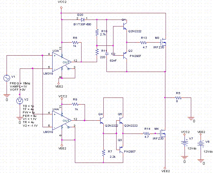

I have one week to finish my graduation project but there is a problem; shoot through
so i need a dead time circuit to overcome that effect

We designed a class D amplifier using discrete drivers for Nakamichi.
Your triangle wave signal drive line is the only place that you can place it
basically you run a comparator with a + and - theshold and only when the threshhold is exceeded can the output fets conduct.

Perhaps this can help: increase the rising time of the mosfets but leaving the turn off as fast as possible:
Instead of putting a resistor in series with each gate, put it connected to the NPN driver transistor. This way, when it activates, it passes current to the gate with the resistor in series (turn on), but when the PNP driver activates, it removes charge from the gate with no resistor in series.

search forum i good: http://www.diyaudio.com/forums/showthread.php?postid=429747#post429747
Here comparator drives drivers. drigvers trigger level for on/off and delayed on can bee made, it also makes it easier to make it self osscilating. In the tread the driver trigger level is also dealt with. Graduate ?
