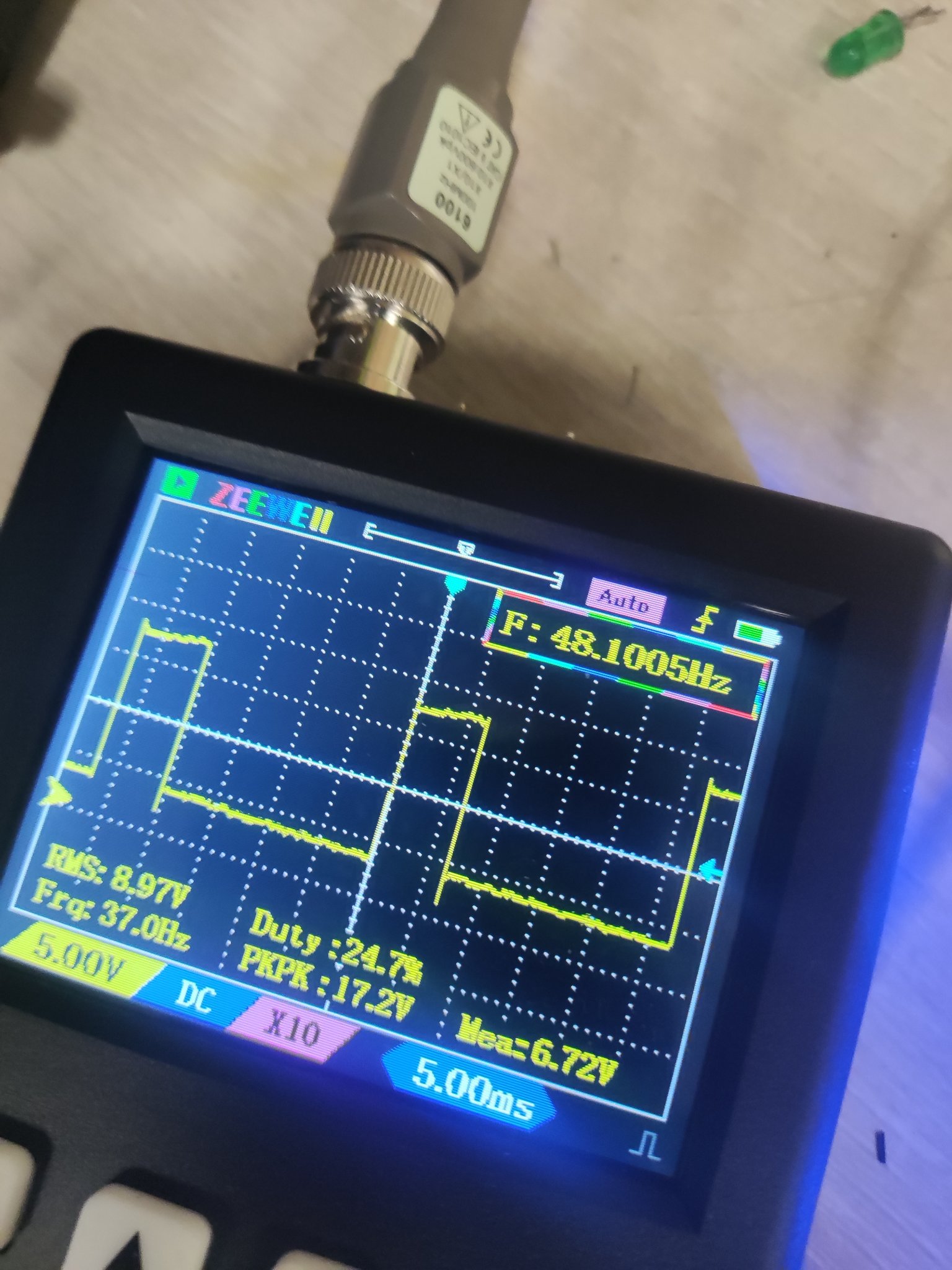

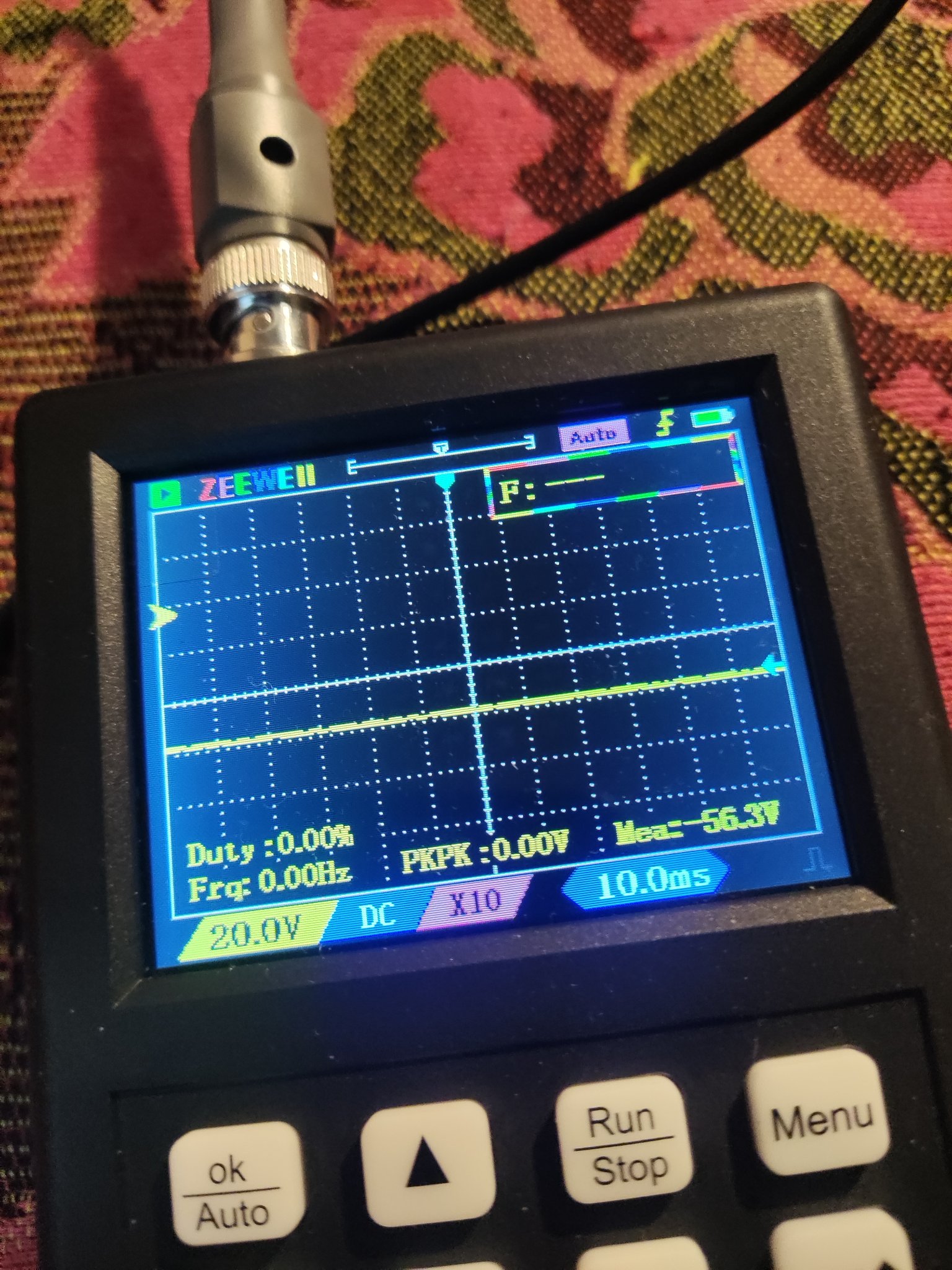

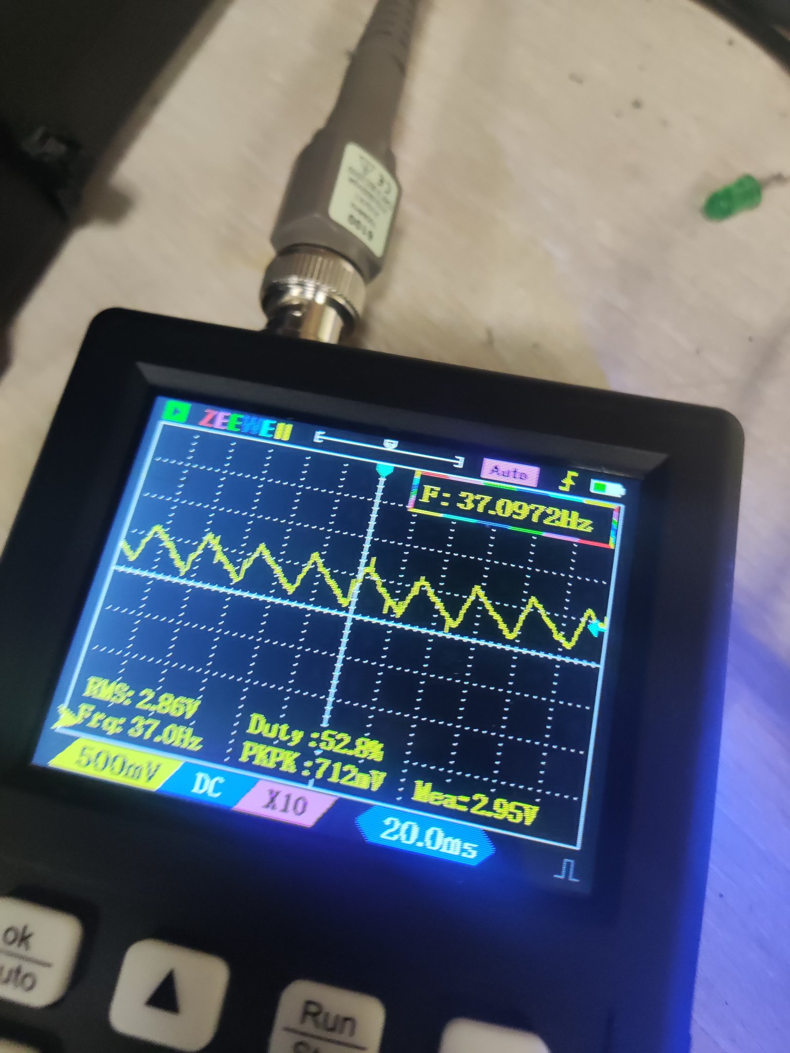

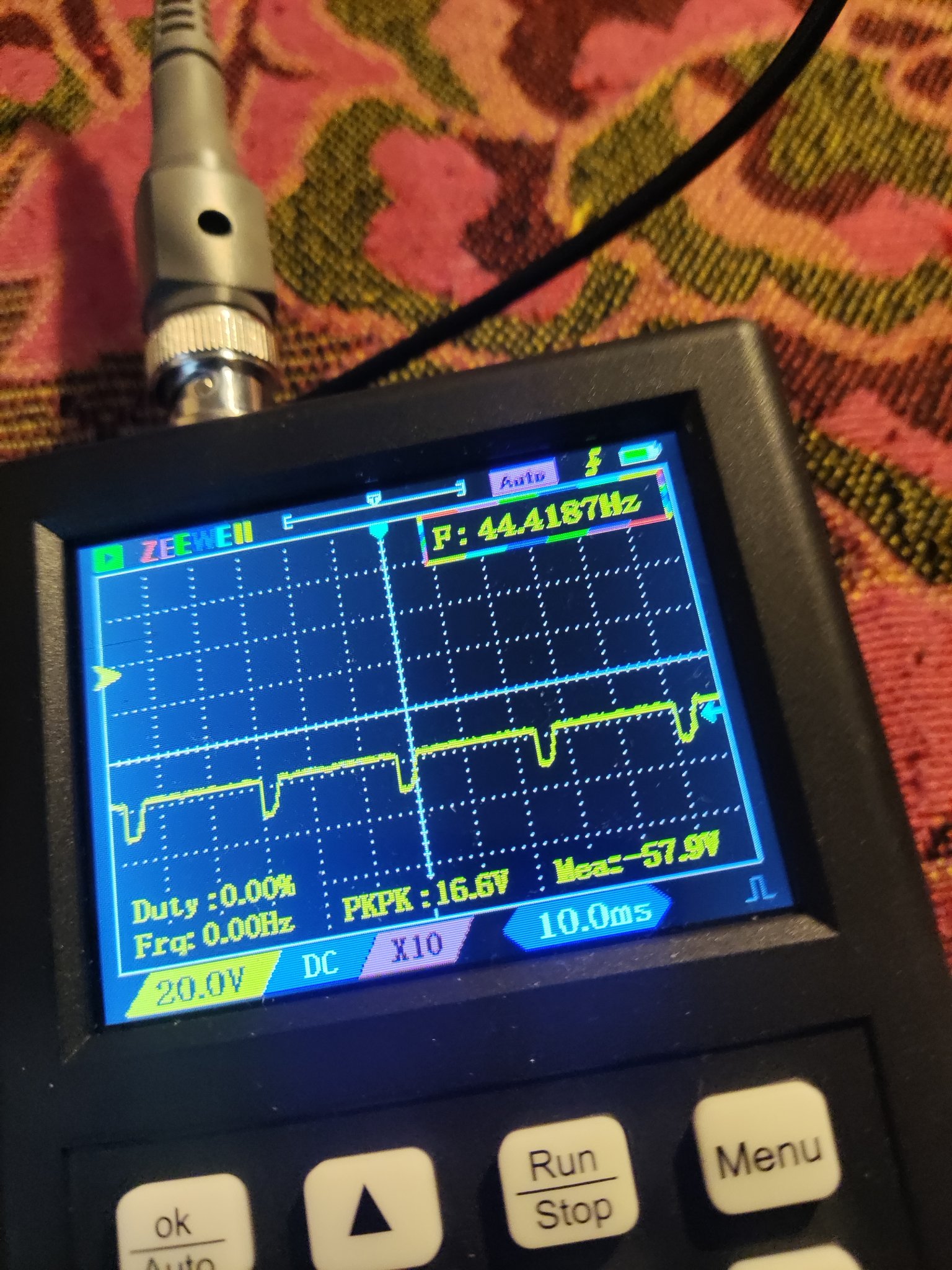

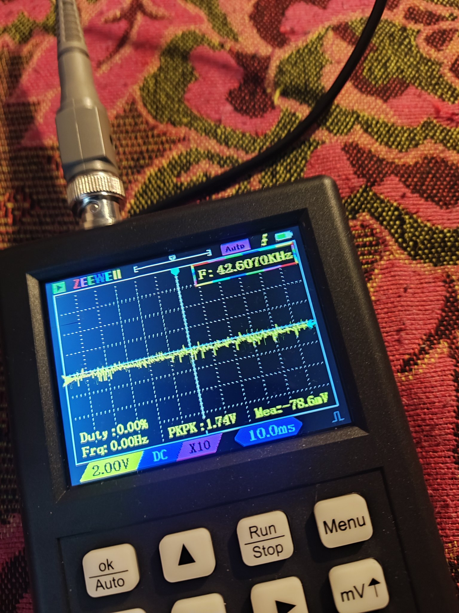

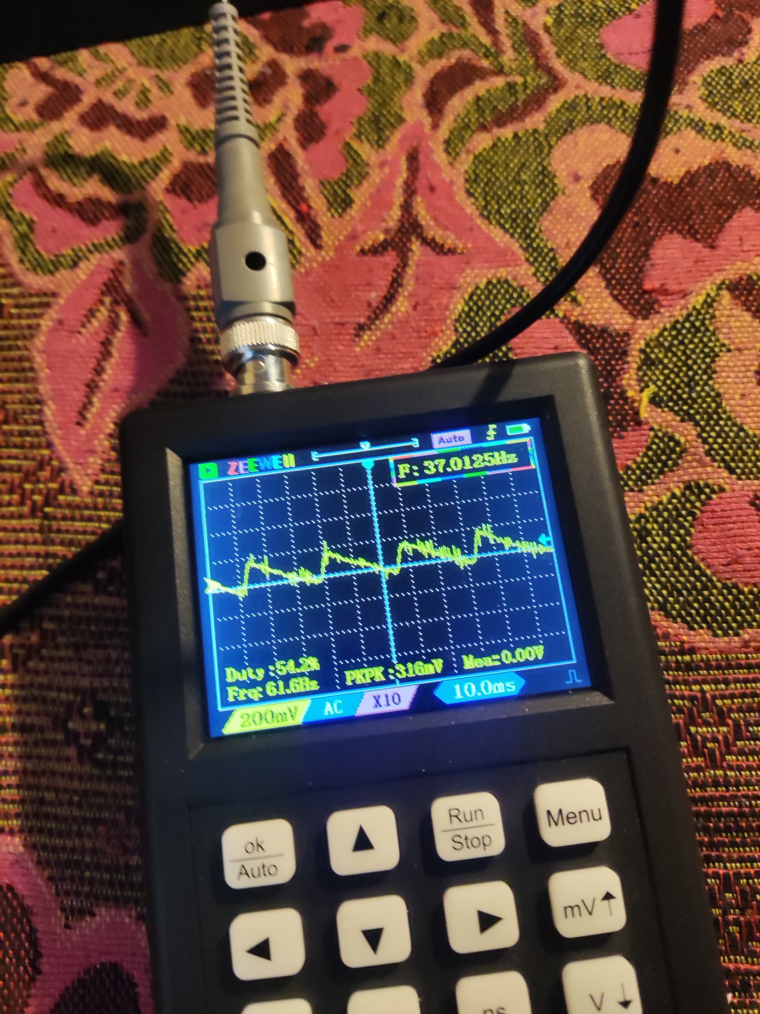

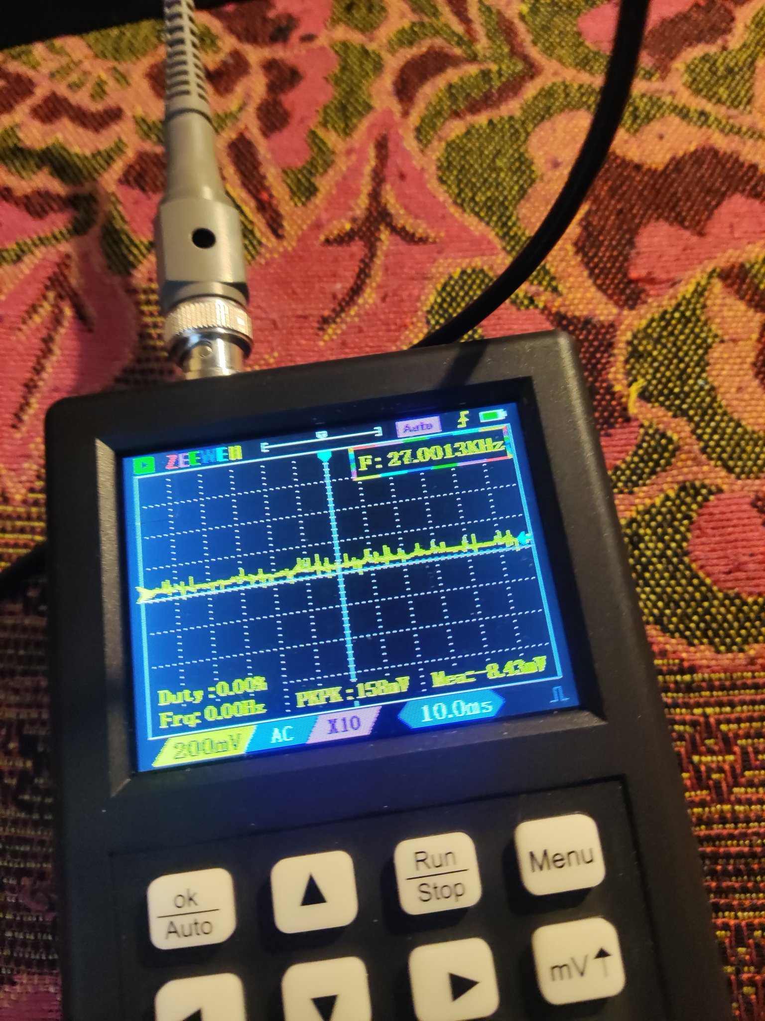

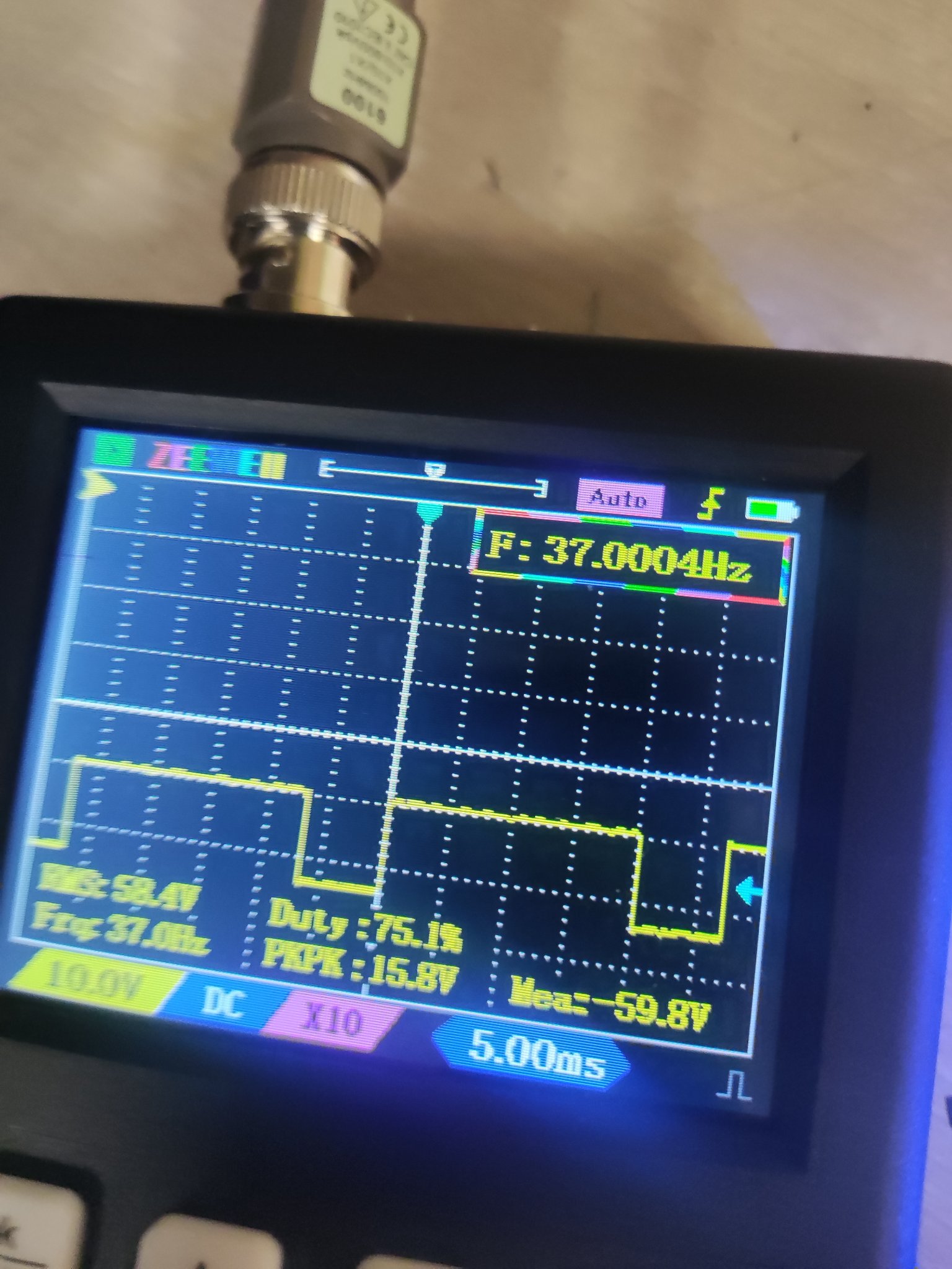

EDIT: measuring output section without and with signal (37hz sine wave) applied
One side gate:
One side source:
Other side gate:
Other side drain:
Speaker outputs:

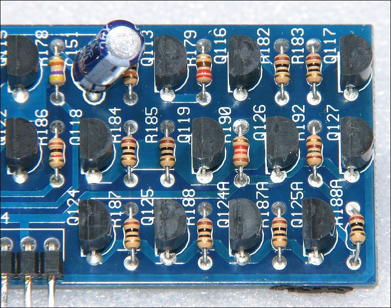

What's the circuit board designation for the hot A92?
The transistors Q124/A and 125/A all run very hot and can fail. They may check OK with a meter but won't work at normal switching frequencies. I'd replace all of them, cleaning all solder/pads for them (and any near that have overheated solder) before I do much else.

Unsure what you mean by "What's the circuit board designation for the hot A92?"
But the hottest transistor was Q117, but after removing it Q116 heats up instead. There were a couple of warm transitions on the card, but nowhere near those 2.

Q117 runs hot, normally. On the older amps with fans, this and the Q124/5 transistors were installed so they were closer to the fan (not an option here).
Replacing all of the transistors is up to you. I don't know what you consider (too?) expensive. I would only replace the ones that are typically a problem. Some may not be available from a reputable distributor.
The 4227 may be too much of a load for the already marginal driver circuit. The IRFB38N20D has been used fairly often and may only require a slight adjustment in the CCS on the driver board.
The 38N20D will work, it is way cheaper than the 31N20D (1.5eur cheaper per unit). And the MPSA92 also are fine in price.
Which ones usually are the problematic ones? As at 16 cents per unit I can afford to replace more than necessary.
Q117, Q124 and Q125?

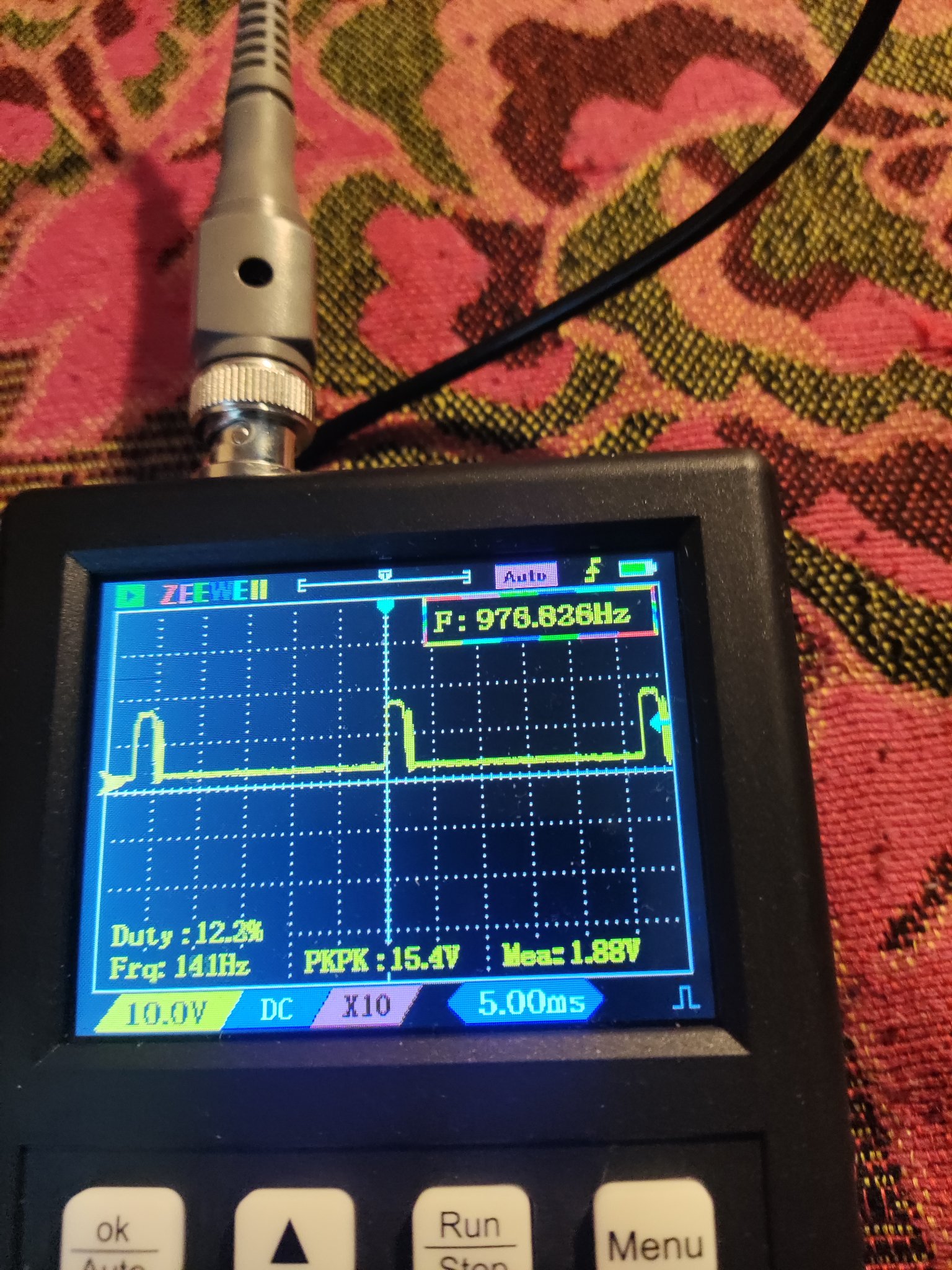

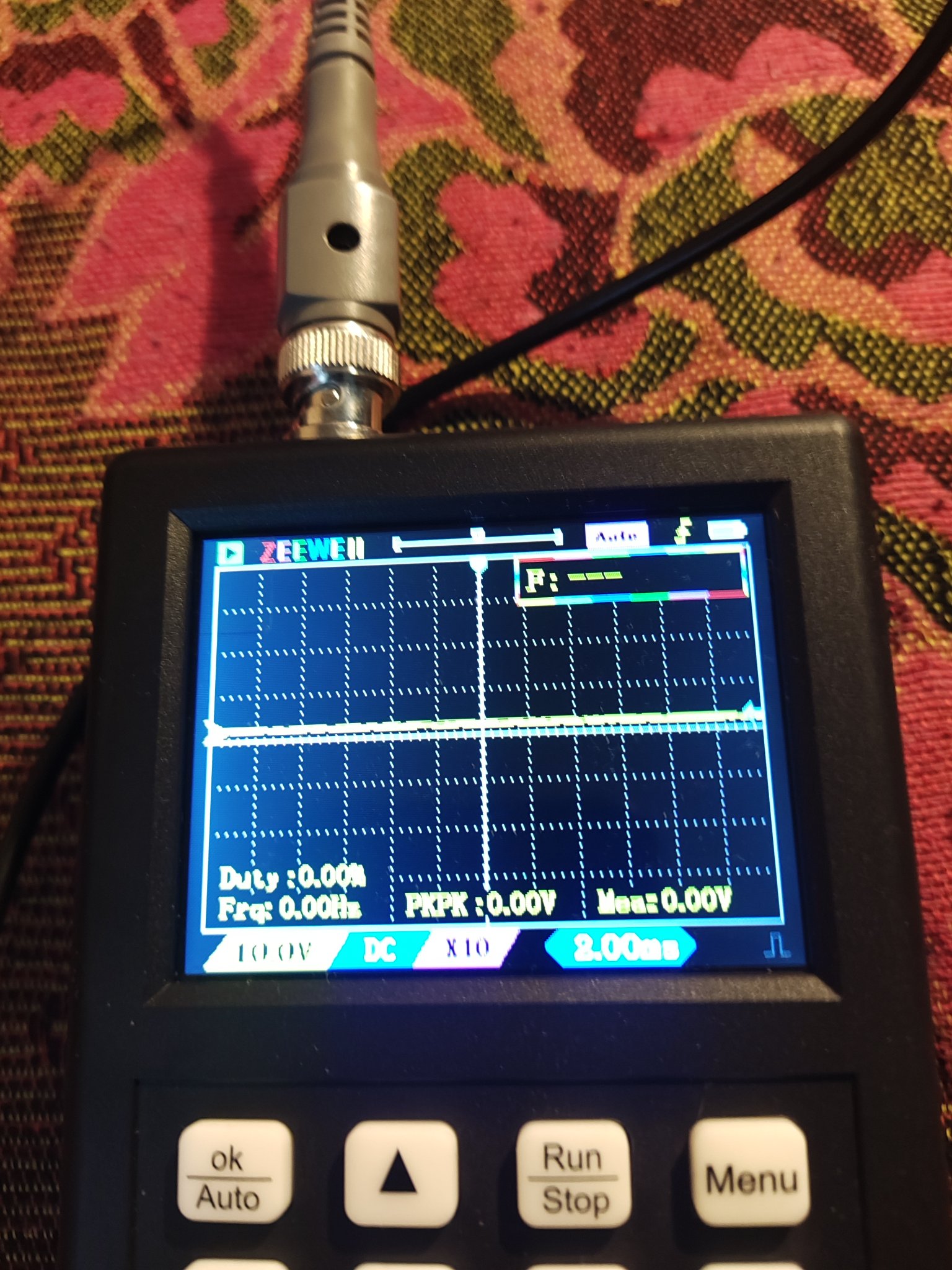

Replaced the transistors on the card
One side gate:
Other side gate:
It is looking cleaner, but is this on the speaker terminals normal? (37hz sine wave on the RCAs, still without output side FETs). seems to have a bunch of DC offset, more signal resulting in more offset
Edit: also it still has a high pitch noise in the hearable range. seems to be coming somewhere on the PSU side.
When using a mains-powered scope in differential mode (note for others) or using an isolated scope (you), place the negative terminal on the source leg of the FET when viewing drive signals.
Don't let the ground clip short from the drain pad to the source pad. Solder a short jumper wire to the source pad and clip to that if shorting is possible.
With no outputs in the circuit, there is no feedback and no ability to drive the output of the amplifier in any way (to correct for offset).
