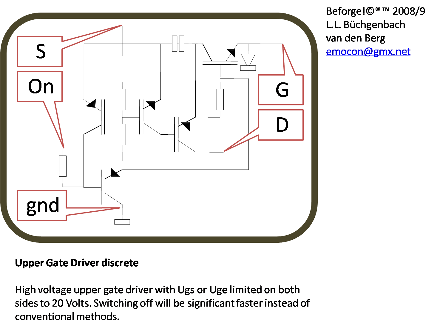

Upper Gate Driver, discrete
Disabled Account
Joined 2007
Designed to put +/-20v on the Ugs or Uge (substitute gds with gce for igbt), should result in nice off times.
Made in a public library, so don't say anything about the picture quality.
Start off values for the double transistor voltage regulator would be 10k/210k to get the wanted voltages.
Any suggestions and remarks are welcome, grtz Lleo
