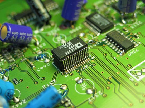

About the stacking of the DACs:
I found info on the AD1955:
http://www.analog.com/UploadedFiles/Data_Sheets/422968845AD1955_0.pdf
However, I could not find info on putting them in parallel.
I know that for instance Arcam chooses to put 2 or more Wolfssons in paralell (per channel) in their more expensive models.
Are there no disadvantages either? What about impedances, powerconsumption, etc..?
Did anyone do listening tests on this DAC stacking?
Lucas.

I got the AD1986 directly from the analog devices site, compared to the AD1985 it appears to have better snr (and costs twice as much!). It is pin compatible with the AD1985 with the exception of pin one that controls the long/short group delay, I think the pin is pulled up internally so it should just go as a direct replacement for the AD1985.
