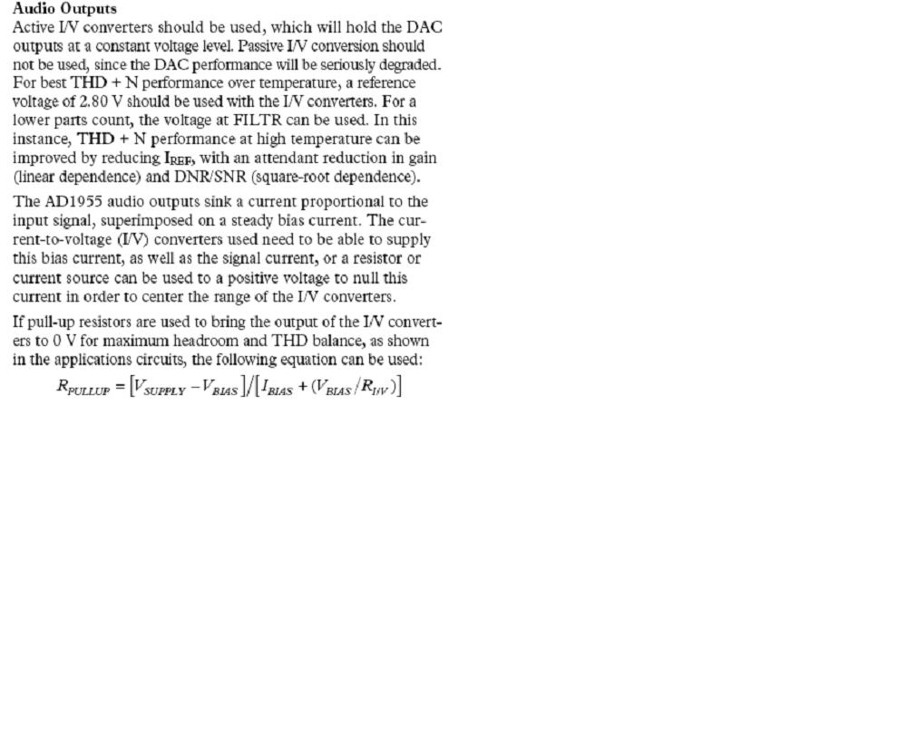

A (lengthy) question to all those DAC stackers out there:
I'm very astonished that nobody mentions any adaptations to the pull up resistors of the U/I section when stacking DACs. Following the datasheet of the 1955 there is a bias current of -3.24 mA at the DAC's output. To bring the DC level of the U/I op-amp output to zero in order to gain maximum headroom this bias current plus the 2.4 V bias voltage of the U/I stage should be compensated by the pull-ups.
Suprisingly the original pull-up resistors of 1.8 kOhm (e.g. resistor 3438) compensate for the 2.4 V only (is there an argument for that or did the Philips people just not recognize the bias current?!?). In deed if you measure the DC output level of opamp 7403 or 7404 in the original state you'll find 2.1 V which corresponds to the bias current of 3.24 times the feedback resistor of 650 Ohm (e.g. resitors 3403+3405).
Now we start stacking DACs. In my interpretation then all output currents add up and thus are doubled (or trippled when you even put 2 additional DACs). The 1.8 kOhm still compensate for the 2.4V but now I'd expect double (tripple) bias current leading to 4.2 V (6.3 V) DC at the output of U/I. The whole section is fed by +/- 8V only leaving a (in my view) very poor headroom to the positive supply rail. In tripple DAC config I'd even expect some clipping whithout further modifications since the output voltage swing is also trippled.
Can anybody confirm my interpretation or am I completely wrong? Do I miss anything?
If that is correct, the pull-ups should be 550 Ohm in double respectively 417 Ohm in tripple config to bring the ouput to zero.
Best regards and happy listening

Is Guunther correct? Do I need to worry about this if I plan to stack my DACs? Has anyone who has stacked the 1955's made such modifications, or did you just stack the DACs and leave the pull up resistors alone? I'd really appreciate hearing from someone who has stacked to know whether it is necessary to do further mod's for the stacking to work correctly. Sorry; my background is science, but not electrical engineering (I just love music and would like the best from my 963sa), so I have to rely on all of you to point me in the right direction with this.

when you refer to the datasheet page 13 you will get more information. The pullup resistor has to bring the output of the I/V converter to 0V. So what happens if you have more current because more than one dac are used? But anyway you will not get more voltage - the supply voltage is constant, the reference voltage must be constant too - the only thing is that you have to deliver more bias current and more signal current.

Hi Mchael,
yes right, as you said: you have to deliver more bias current. However the bias current has to be delivered by the pull-ups. And the pull-ups don't if you do not change them.
Thus if it's correct that with stacking DACs the bias current is doubled the formula on page 13 for the pull-ups changes too since - as you stated correctly- all other values in this formula stay the same.
Is there somebody who stacked the DAC who could measure the DC level at the output of U/I at either of testpoints I411, I417, I418 or I424?

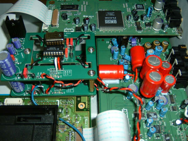

nice little picture - but what shows it? A double XO with internal power supply? Interesting kind of mounting the pcb with the XO- is it a "lord of the rings" mounting?😀
