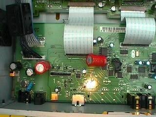

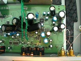

Some new pictures
As some of you requested pictures to visualise my tweaks:
here they are (sorry for the bad quality of the pictures). Later on I'll post better pictures.
Saffier

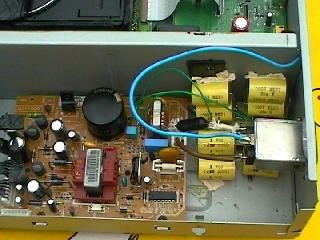

What film caps have you used in the power supply, and how did you use them? Are they just cupling caps, or replacement of e-caps?
SMPS upgrade
The film caps in the SMPS are MKP I 1500V 0,22 uF "snubber" caps to dampen switching noise. Two of each around every BYV96E diode. So everything you see on the right side in the picture above is just the replacement of the rectifying bridge.
This is a huge improvement, more tube like sound , much more clean and better dynamics.
Saffier
Saffier
Ok, saffier it is now getting clear to me. You used the space near the main inlet to place the supe e-caps and wired them to the place where the output caps where.
Did you use any special wire?
Many thanks for the information I've been searching several days now 🙂
Caps
Redfox,
Everything in the power supply compartment is for the SMPS, so no super e-caps as coupling caps in the SMPS.
The super e-caps are mounted on the wooden block between the AV board and the drive unit. I used silver/teflon wire.
Saffier
Redfox,
