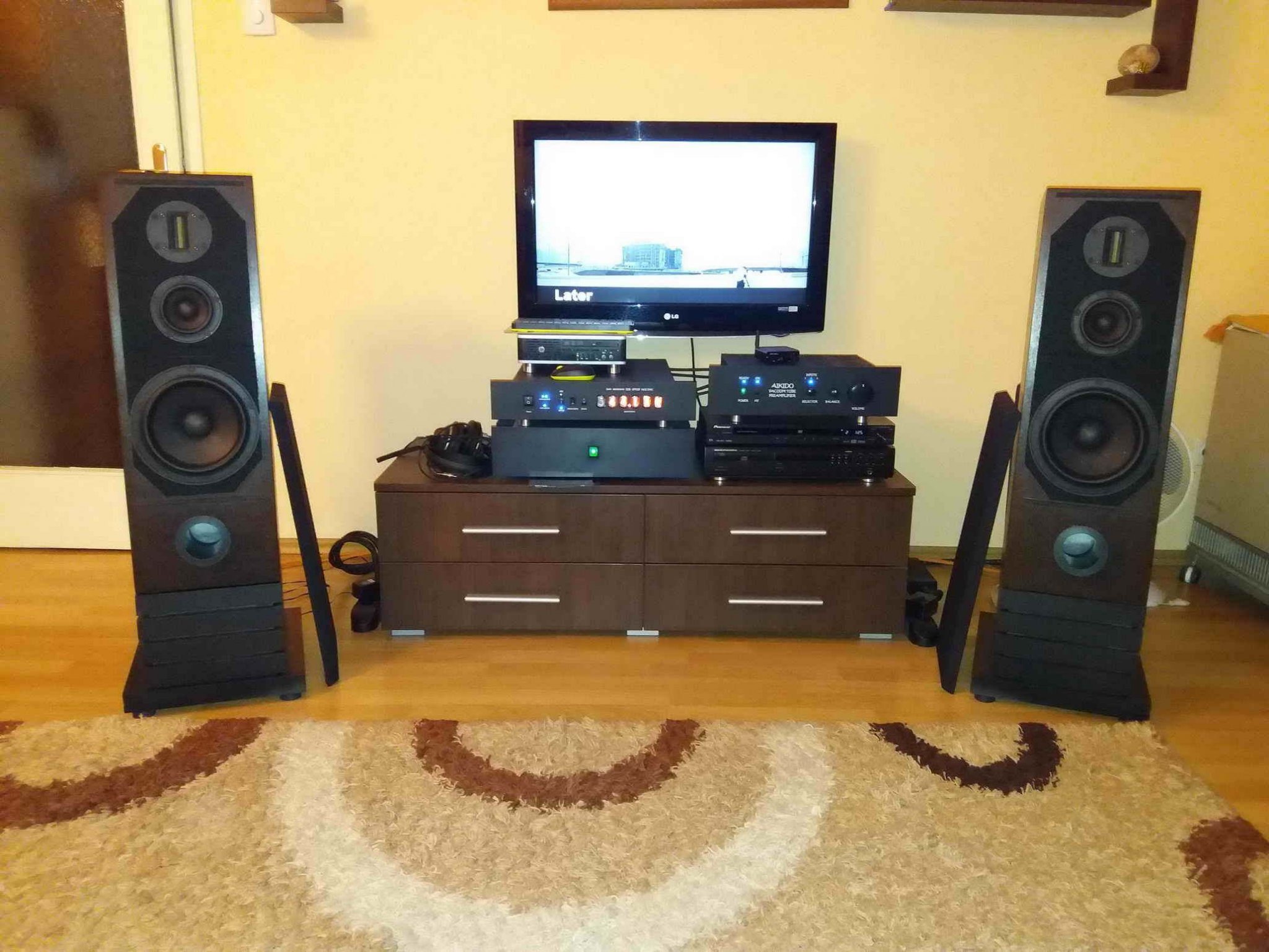

Everything is DIY except the HP mini PC. DDDAC 1794 (4 board DAC with output line transformers), Aikido cathode follower (6N6P tube buffer) as a preamp, Leach 4.2 LowTIM amplifier, speakers with Vifa NE225, Vifa NE123, Fountek NEO CD3.0 and Visaton G20SC backfire tweeter. VDH cables D102MK3 and SCS12 bi wiring. Supra USB cable.what gear do you have?
speakers , amp etc
The Marantz CD63 has been redesigned but is no longer used. For CD transport I use Pioneer DV300 modified DVD player.

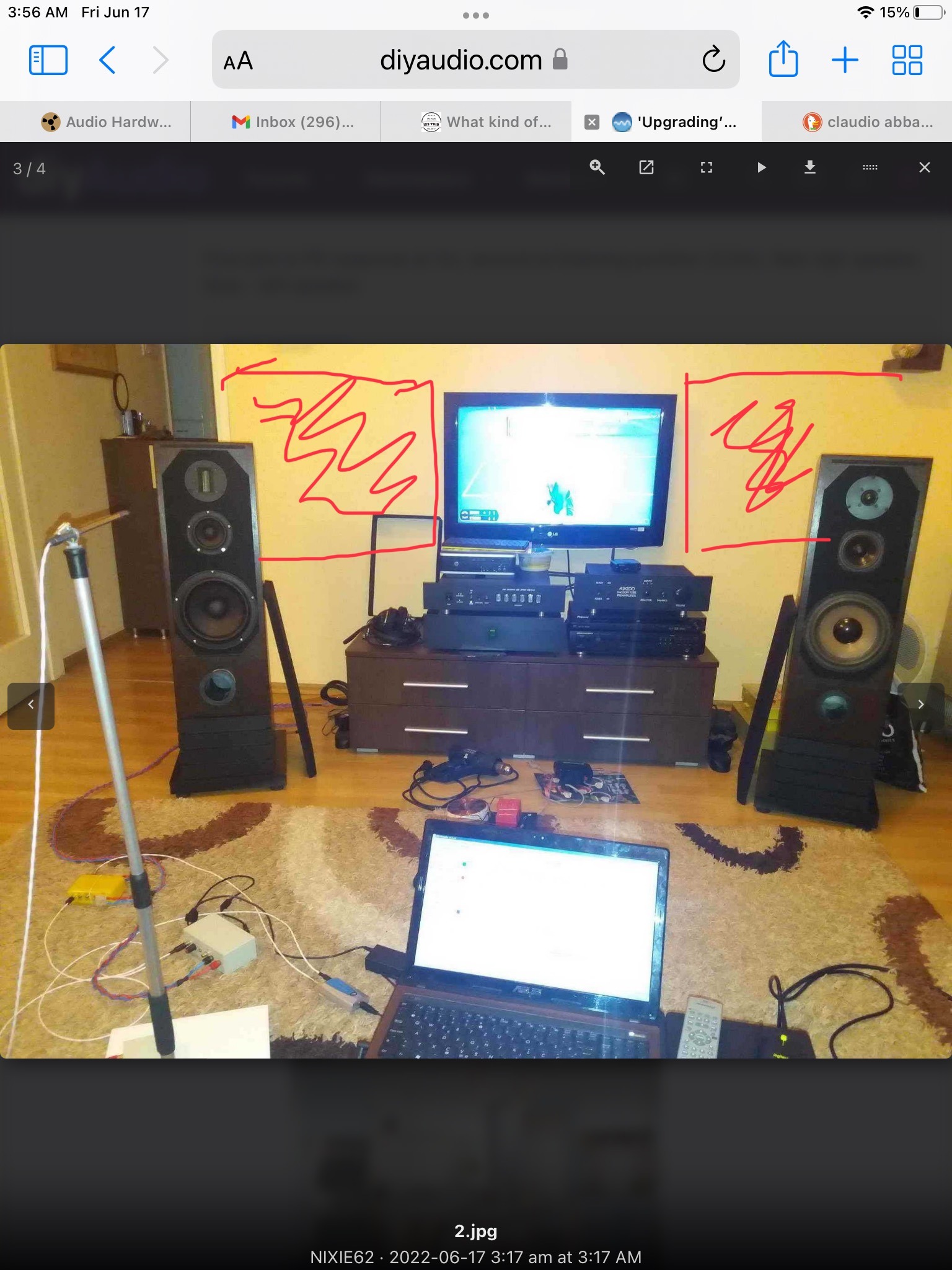

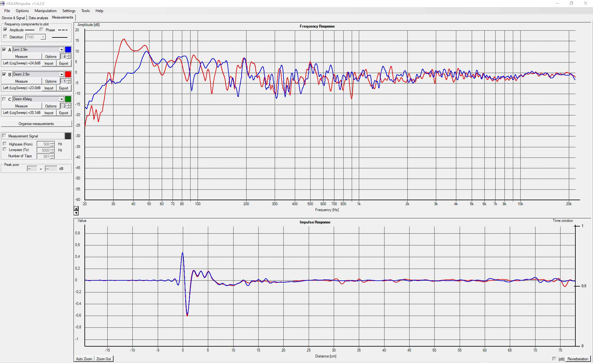

First plot is FR rasponse at 1m, second at listening position (2,5m). Red-righ speaker, blue - left speaker.

nice.
yeah I see the differences between speaker.
mine are like that as well
but kinda fill in each other.
no smoothing at all?

1/24 db/oct smoothing in Holmi Impulse softwareno smoothing at all?
thats really good.
i think you can go to 1/6th. Lol
no one is gonna accuse you of cheating.
ha
we aren’t hearing any of those details at 1/24.
good for deep analysis tho

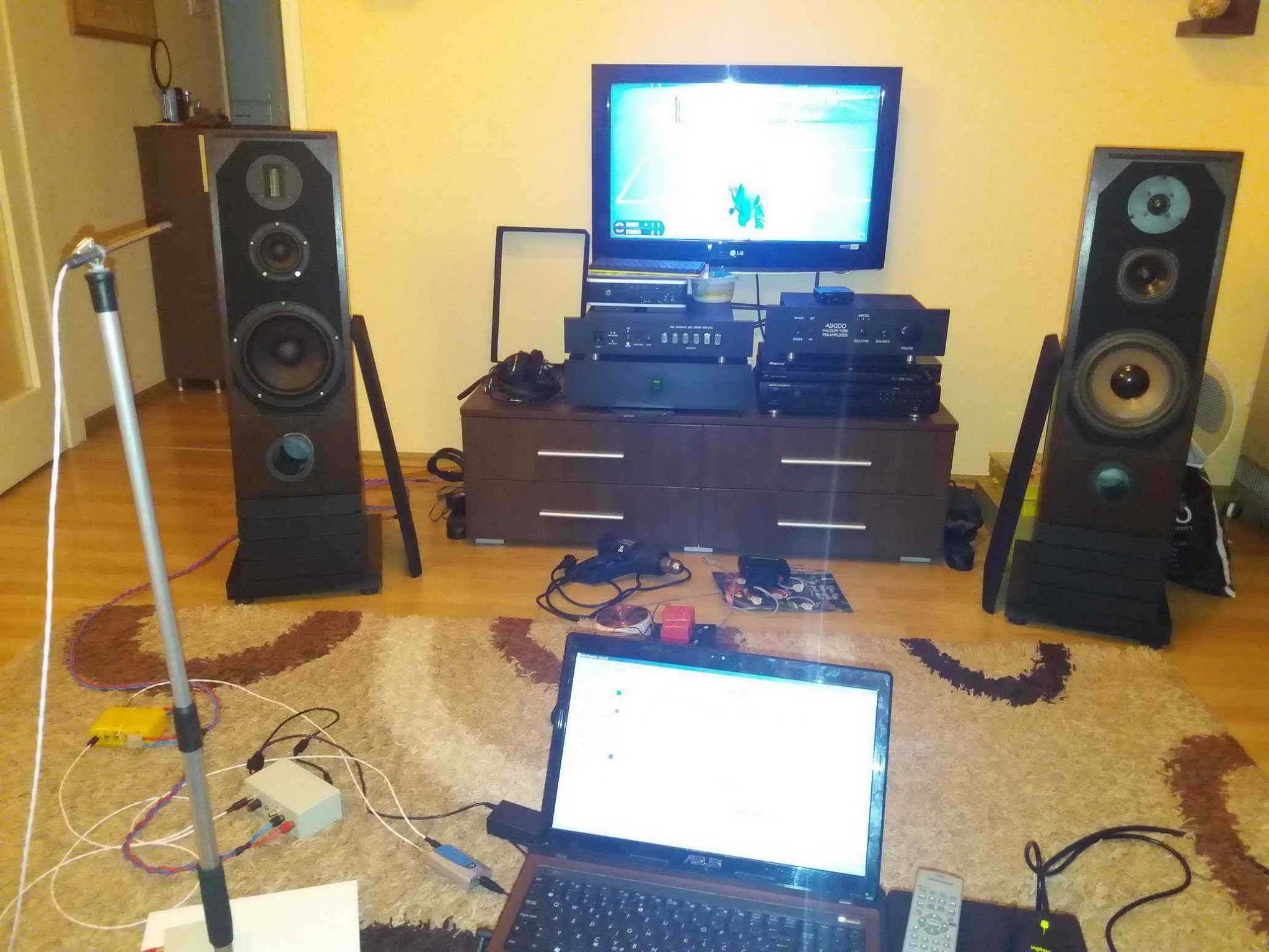

Closed i think. 🤔Are the measurements with the door open or closed?
I would put a panel on each side behind the speakers. Not all the way down.

Closed i think. 🤔
yeah those super lows are going riiight though that door. Lol
my room has the same crap.
try hanging some blankets folded in half so they are bit thick behind the speakers
