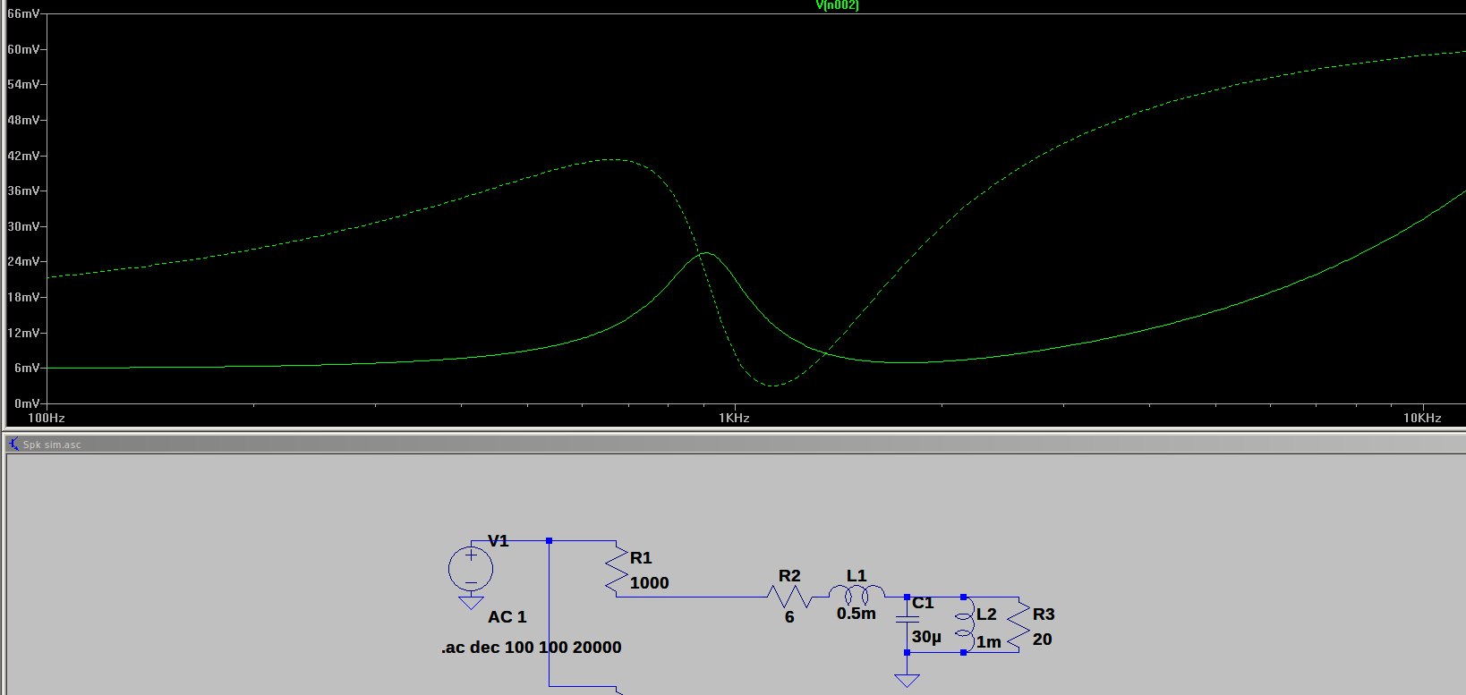

Normal electronic design will swamp the parasitics when appropriate. Parasitics are not normally to be relied upon to be consistent, well positioned, or linear (especially in resonant circuits), (if any of that matters in a given usage). Of course, it can always be measured and figured in. I've simmed an example to suggest the kind of magnitude that might be seen.then will compensate with some other factors, esr of an inductor and so on ?
It could be fortunate that tweeter circuits often have series resistance.
Capacitors do typically show a higher impedance at higher frequencies in addition to bottoming out where DF=1. The increase involves ESL. You mention self-resonance.a higher ESR as frequencies increase
It is worth noting that this isn't typical within the audio band and I'd want to see for myself if it was claimed to be a problem.
Take it in context of the circuit. This includes not only circuit impedance in general, but the influence of the component on the circuit nodes that matter.the x" is as important as the ESR in the DF percent result

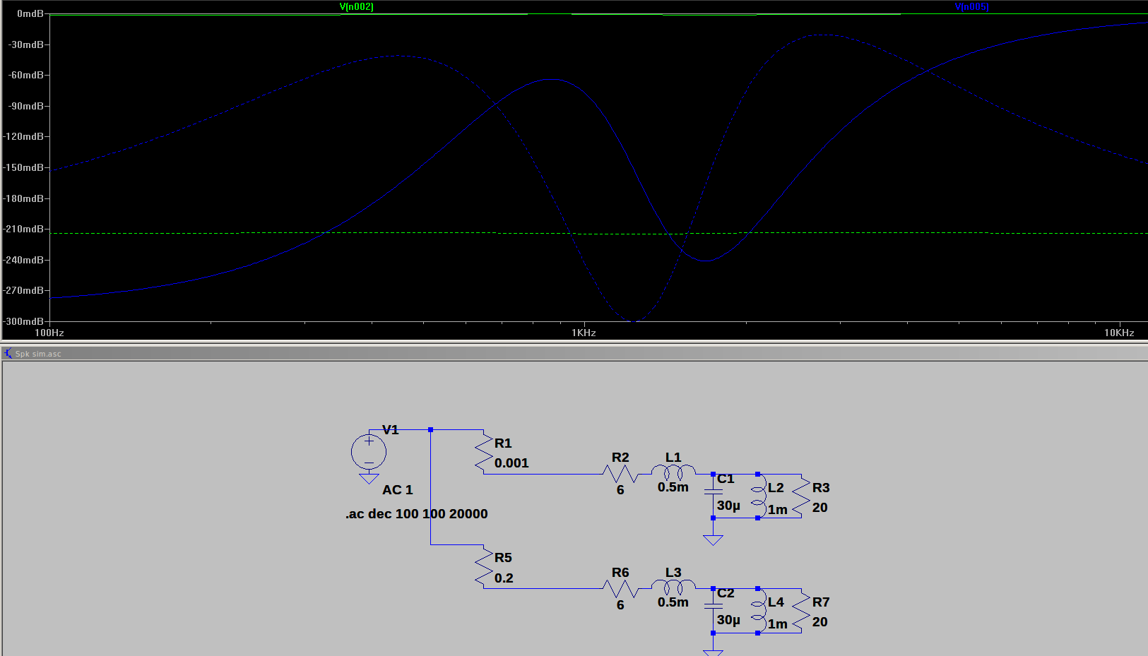

Btw, hope these attachments can also help someone in the learning process. Understanding more in always a pleasure with a hobby.
