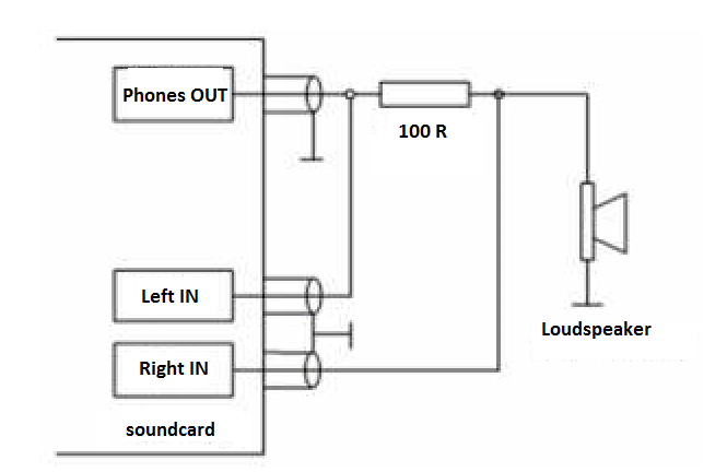

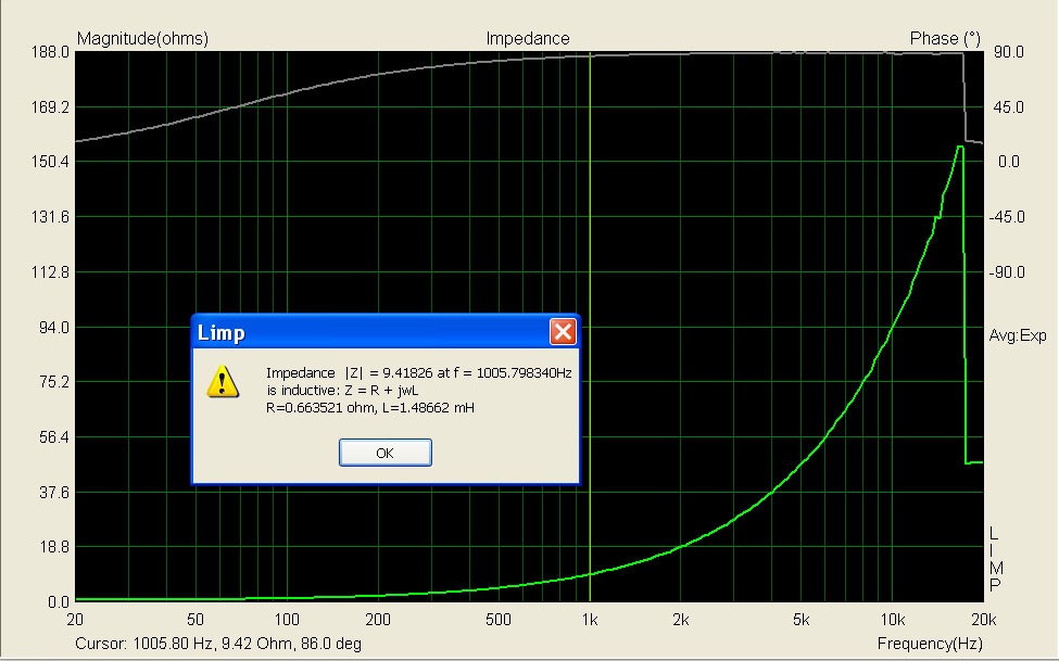

Among many, one of the means to measure impedance is to use Artalabs LIMP module. The schematic is attached, and the sound card used was a lower quality old Creative. If you inserted a capacitor instead, the curve would be mirror imaged, impedance falling down with higher frequencies. R (real part), jwL (imaginary part) of the complex number Z (impedance).
