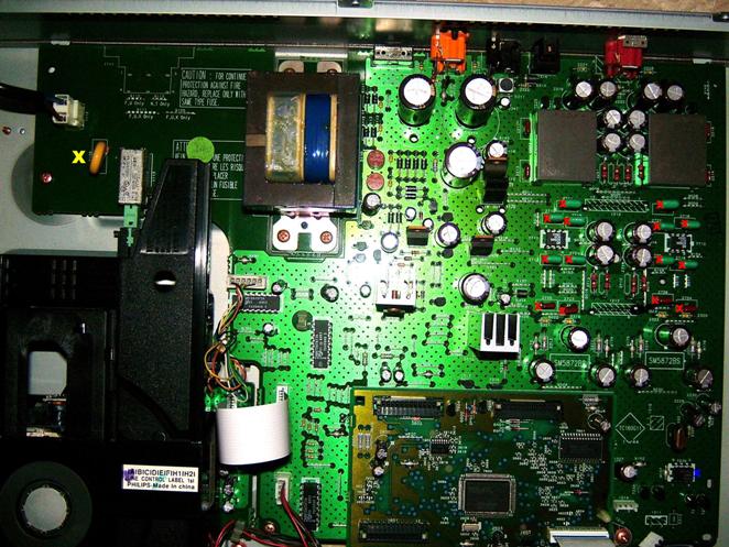

Hi All,
Need some advice from you.
Attached below is a used CD6000 std version I managed to get.
Few questions:
1. Any suggestion in upgrading the yellow thing on the top left? The one marked by yellow X.
2. There are many small green and tiny red caps marked by red X in the right centre which I believe are polymer caps with values betweem 120pf and 150pf, can I change all to better caps but all at 150pf?
3. Any suggestion in upgrading the chip at the right bottom marked by blue X? Any point at all?

marantz
hi if i were you i would for get abot the capacitors get a trichord clock 4 and a good power supply for it then sit back and enjoy a wonderful sound from this player
In my experience caps matter alot. But clock makes a the biggest difference.

Heat-sink the Op-amp and voltage regulators
Hi All,
First let me wish you a Merry Christmas.
With the holiday mood I added 4 heat-sinks to 4 voltage (the other 2 already have good heat-sinks so I left them alone); in addition I placed 2 heat-sinks on top of my Op-amps (AD826AN).
To heat-sink the Op-amps was a little tricky, I coated just a small dap of those heat-sink cream on the heat-sinks, then placed them carefully on top of the op-amps. Then slowly placed back the cover then connect the player back.
Results.......... NO AUDIBLE DIFFERENCE.
Well, lesson learned so not wasted.
Cheers.
