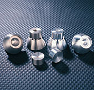

I own a marantz cd63 mkII and have applied a few simple mods.
I have dampened the chassis with buitemin pads (not sure if the spelling is correct). I got the pads at a car accessories store. People use them for noise and vibration damping in cars. I increased the weight of the cd-player with 3-4 kg`s. The sound was better in the lower frequencies after the mod.
Recently i borrowed some nordost pulsarpoints with positve results. The sounstage (wider and deeper) improved when using pulsarpoints. These are unfortunatly expensive.
At this site you can find somewhat relevant information about marantz cdp mods:
http://www.tnt-audio.com/clinica/cd67.html
Upgrading your cdp`s clock is good tweek. Info about making your own clock you can find here:
http://home.tiscali.nl/~t708955/cunos.htm
Picture of pulsarpoints:
