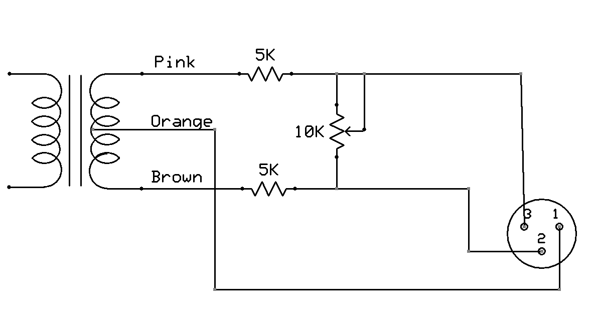

Maybe somebody can help me with my next update.
I want to include in the DAC the "Wire BAL-BAL" headphone amplifier taking the signal directly from the balanced output of the Sowter trafos that are already installed.
My problem is relevant to the dedicated pot that I want to install between the Sowters and the Wire. Reading in the Wire thread look like the correct value is 1K but I don't know where I can found a balanced 1K pot.
I look in Hificollective and they have only 100K as balanced.
Any suggestion?

"Wire BAL-BAL" 1K Pot
Looks like a simple but great sounding headphone amp. From the schematic I don't see where the pot would go. A 1K pot load after the Sowter would be felt by the DAC/buffer and seems too low a load reistance to me. Are you trying to do volume/balance control? IMO LDR volume control is the best sounding. The Tortuga self-calibrating units have remote control and can be bought as DIY modules or complete units. I bought the DIY modules and was planning to do something similar to the "Wire" for output buffering on 4 channels using the same IC chips.
I make some research and I found this thread http://www.diyaudio.com/forums/analog-line-level/161593-wiring-balanced-volume-pots.html. The schematic is quite simple and look like have been used succesfully. Can you give a look and let me know your though? Thanks!
Let me know if you need some help for your 4 channel.
Enrico
