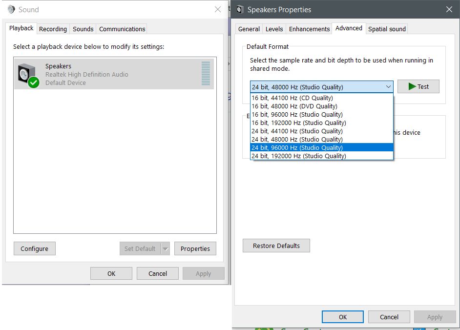

I think what you mean is within Windows OS there can be a number of software points where changes of audibility can take place. For example your Win 7 laptop could have multiple places such as the sound applet in control panel, the motherboard audio codec software application and the music/audio/media player applications where you can modify parameters like audio sample rates, dsp sound effects, graphic equaliser settings and replay gain normalisation.
So you could have audible difference between VLC and Foobar audio applications because they have independent settings from each other and in addition to the ones in the win7 control panel.
For the record, if using Windows its best to use ASIO drivers and make sure that in Windows control panel Sound Device settings that the sound device you want to use is not set as default for any Windows use (no green check mark by the device).
Please see screen capture below. The sound device can be seen to have a green check mark, which in this case is because its the only available sound device. In that case even if ASIO drivers are used Windows will always resample the sound stream to the default setting as shown in the right pane.
If not using ASIO drivers, then Windows will always resample according to the default setting with or without a green check mark. The only fix in that case is to set the default sample rate and bit depth for the music file you want to play. If the file is the same as the default setting, then no resampling is performed.
When Windows does resample, it does it in real time and not at the highest possible quality. Many people can hear there is something wrong compared to if there is no resampling.
To assign the green check mark to an unused device so that ASIO drivers can work properly, right click on the unused device and set it to "default sound device" and to "default communications device."
