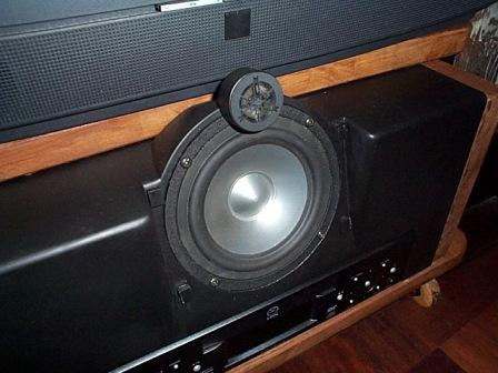

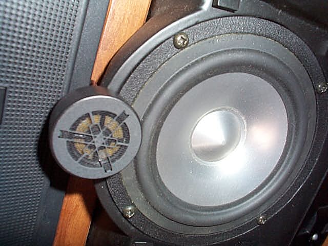

I use the Cantare Super Slim for about half a year with great satisfaction. I use it in a centerspeaker and it gives a very realistic image of voice and instruments. It is just sensation. With a good DVD (DTS) it’s like the microphone is straight plugged in to the center. Unbelievable!
I found the Jordan jx92s a wonder. But it has it’s limitations:
-the high is a bit messy (see its graphics)
-the low is from a bad quality
-it lacks a bit overall speed
But with a good design it acts so natural and in balance. I think it is mostly because it is almost a point source. Gone is the bit diffuse sound normal systems have.
After a while using a bare Jordan and later on with a BSC I discovered the Cantare SS. And with the help from Soongsc I developed a new BSC. So yes Landroval I have changed the BSC it based on the FlexoNotch see on forum. I can not find the JPG file on my computer and I don’t have time to search or make en new one, maybe Soongsc has it and can put it on the forum.
The switches are still in because I find it fun to let people hear the difference and let them go to the their own conclusion. The SS gives joy and sparkle to the Jordan. Do not expect firework it just is there, enough to do its job without sharp s and t sounds.

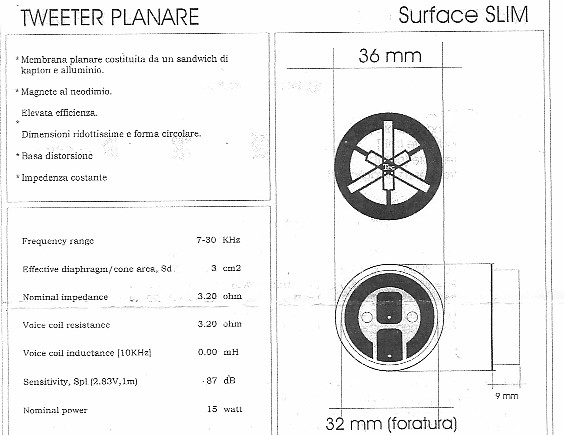

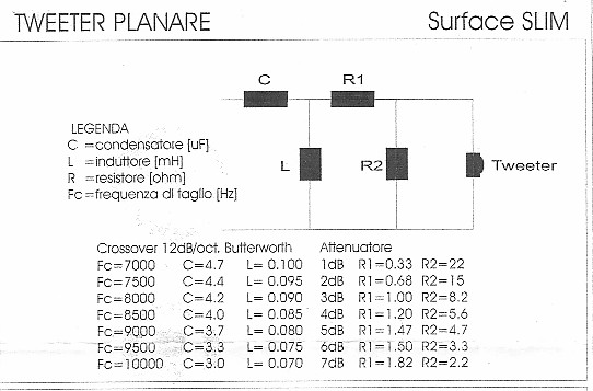

Why this particular tweeter
The Canatare Super Slim was my choice because of the following:
-it has a almost flat graphic from 7k to almost 40k
-it is fast (magnostat)
-it is so small you can place it close to the jx92s
-the price
-the simplicity to join it with the jx92s without complex XO

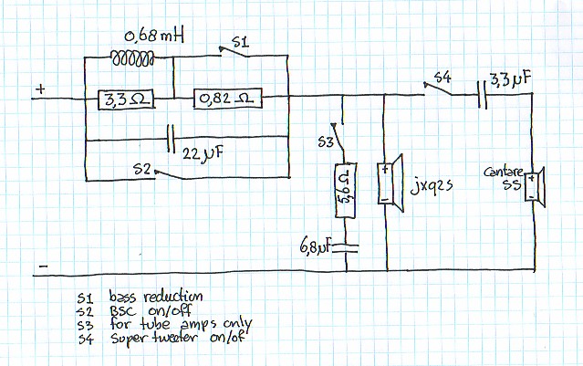

This was one flexible configuration what I worked up for testing and analysis purposes. Additional impedance compensation would be necessary in the end. But the components are really too much. But feel free to play around with it until the tone balance is about right, then fine tune using less components. We call this configuration the FlexoNotch.

Soongsc,
Last Saturday I had some time to buy the components for your filter. Of course I was very curios and built right away.
Your filter (with a little difference of resistor value)
2 mH
Amp. 18Ù 3,3Ù 5,6Ù JX92S
1µF
My experience:
First of all I had to turn the volume up from +4 to +9. What I noticed immediately was that the sound was very smooth. This is because it is a bit weak in the middle frequencies, around 3000-6000Hz. The low/mid is a bit too strong between 40-500Hz. The high is smooth but there is an accent on the very high tones +16.000Hz. That is a bit too much especially because it isn’t a beautiful, pure, clear high.
Sum. I think it is a too strong filter in the low and upper high, it makes it too smooth and therefore I miss the direct contact with male and female voice the Jordan can produce.
But you inspired me and I changed the filter many times. I think this is because you are running in open air and my Jordan is placed in a cabinet witch produces more mid. The cabinet is tuned at about 70Hz.
The following report is not complete but the most important changes I did.
1
2 mH
Amp. 6Ù 3,3Ù 5,6Ù JX92S
1µF
A bit more live comes in but also too much high.
2
2 mH
Amp. 6Ù 5,6Ù 3,3Ù JX92S
1µF
Not much difference a bit more on the lower end. Still sounds smooth.
3
0,68 mH
1µF
More bass and more mid. Balance gets better. The smooth sound is total gone although. There is more live in it now.
I did not like the extreme high from the Jordan so I changed the cap from 1 to 22µF
4
0,68 mH
22µF
Now we are getting somewhere there is more live in it again.
5
0,68 mH
Amp. 3,3Ù JX92S
22µF
This my original BSC. And I think it is not bad at all. We have contact with the singers and actors again. But still I miss the clarity in the high region the supertweeter can bring. I connected the supertweeter again with a switch and tried it for several ours in on and off position.
6
0,68 mH
3,3Ù JX92S
Amp. 22µF
3,3µF Surface Slim
For me it is clear the supertweeter adds so much more clarity and detail which the Jordan alone can not give. It makes the sound more transparent and even a bit more dynamic also for the mid. Now after I have experimented with different BSC’s I am more and more convinced of the quality and value of this supertweeter.
But still I was not satisfied, the bass and the mid are a bit too strong even with the supertweeter.
7
0,68 mH
3,3Ù 0,82Ù JX92S
Amp. 22µF
3,3µF Surface Slim
For me this is the perfect filter. It weakens the lower bass a little the mid is in balance with the high and the supertweeter adds just enough. I also experimented with a 4,3µF cap instead of 3,3µF but it was too much high, and the sound is getting more diffused (getting more like a normal 2 way system). A 2,2µF cap also can do the trick.

Ref the supertweeter, I know there are various opinions on this, so it's probably better to use the driver without for a while and see what your preferences are. It is important to get the toe in right. I can accept the JX92s slightly brash response as a trade off for the knockout imaging. (Also, I'm kind of a purist about this fullrange thing, otherwise I could have stuck a ribbon with the JX125 and gone that route.)
Hm, I've not found the bass on the JX92s at all bad. In fact, in the enclosure I use them it's cleaner than the sealed box JX125s. The MLTL also manages to reach 35Hz without any effort and it sounds very clean and alive.

I use the Jordan as a center in a home cinema system. So the front speakers take over the bass (and the sub).
oh now i get it. i thought you wer using Jordan all around like i am planning to do. what do you use for front and rear then?
Triumph said:To prevent confusion the bsc in a drawing.
I love this drawing. I might copy it if you dont mind.
