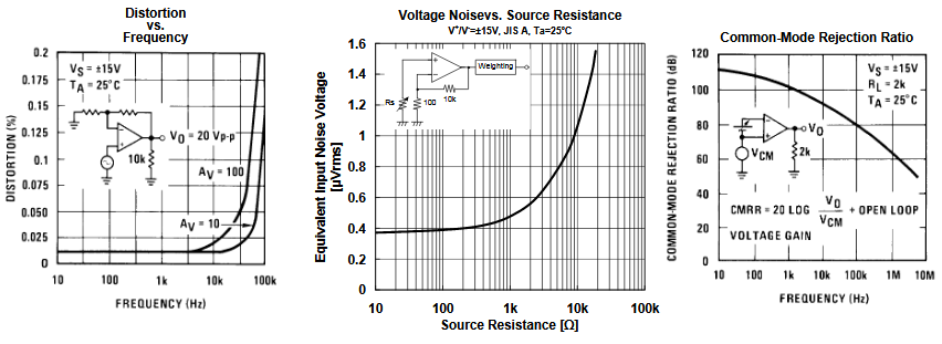

The strength of a JFET is it's inherent high impedance, low noise (including protect the circuit from interference) and DC operation (you can avoid capacitor in the input).
When you read spec-sheet, the single spec number is based on certain operating point. For example distortion is a function of gain and impedances (input and output). If you lower the impedances, the distortion will be less.
Check JRC2068 spec-sheet. Operate it in its best zone and it will outperform NE5532 soundwise. JRC2068's THD of 0.001% is near the hearing threshold. There is no proof that 0.000005% sounds better or audible. And it's 6 V/us slew rate at around +/-15V output swing is also above the 3.9 threshold. It's input noise is of course above hearing threshold, but it depends on the acceptable noise level of your audio system. That's why we need the JFET. BF862 is very low noise (and high current drive too).
Opamp speed is mostly a liability in design. It affects our hearing in a simple way no one will agree 🙂
NOTE: The image is to show that specification changes with operating point. It is not from opamps mentioned in discussion.
