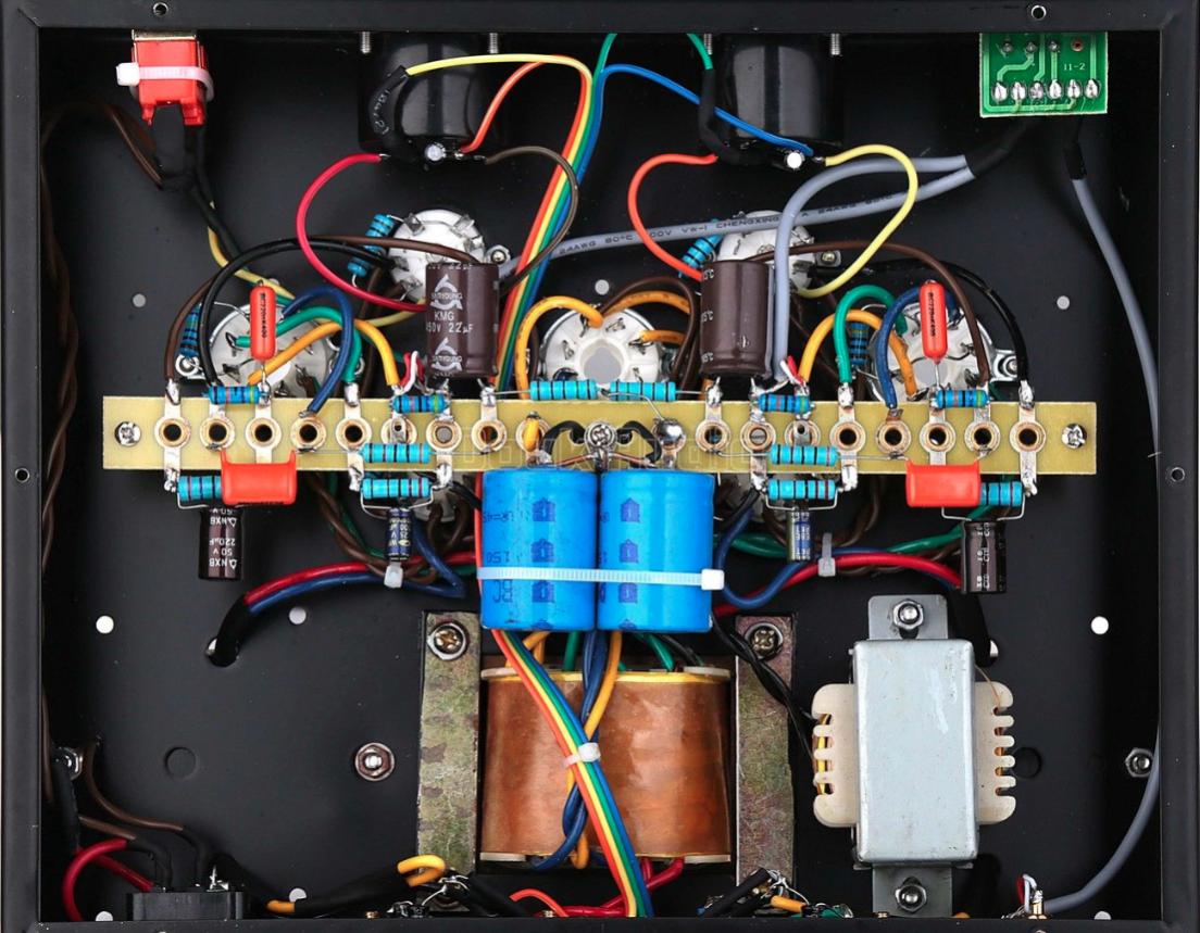

From taking quick look at the pic I assumed that it's a PP (push-pull) amp since it has two output tubes per channel. Turns out it's actually a PSE (parallel single-ended).
That's unusual in a commercial amp and I'm guessing it was done because they had a pile of SE transformers that would work. From a design standpoint PP would probably have some advantages (I'm no expert) such as noise cancelation, but their "design philosophy" (I use the term very loosely) seems to be to use parts they can get cheap in order to maximize profit. Following proven design protocols is not a major consideration.

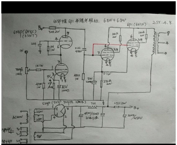

So I found a schematic! It was posted as part of an Amazon review in which the buyer said it was sent to him after he requested it from the seller.
It's hand drawn, which seems odd since this is a commercially sold amp and not some DIY project. Unfortunately, the only voltages listed are the cathode voltages. And it looks like they used a couple of different cathode resistor values on the input tube.
Based on those voltages, according to the schematic, the amp draws between 123 and 125 mA. The limit for the 5Z4P rectifier is 125 mA. So, according to the schematic, they're running the rectifier right at the limit in terms of current.
But that assumes that you actually have 220v at your wall socket, which you probably don't. It's probably over 240v. This is why the use of PTs that have 220v primaries can cause problems when you actually have higher wall voltage.
But that's not the only problem.
Just as on some of the other Chinese amps the first cap after the rectifier is way too large a value. This can result in arcing and even blown rectifiers. And that's if you're lucky. It can also cause transformer damage, if you're not so lucky.
The data sheet for the 5Z4P says the maximum value for the first cap should be 4 uf, yes 4. According to the schematic they're using 150uf.
On amps that are drawing considerably less current than the rectifier allows, you can get away with using a first cap that is a bit larger but they go way beyond that. The "designers" of these amps apparently don't bother to read tube data sheets. Or, if they do read them, they ignore them and just use whatever parts result in the most profit.
Now, I do see on the schematic that some other rectifiers are listed, including the 5Z3P which can handle more current but it also draws more heater current (3A vs 2A) and who knows how much the PT is actually designed for since no current specs are shown. IF the winding is good for 3A, the 5Z3P can be used but the transformer will run hotter. If the winding is really a 2A, the additional stress could destroy the PT. So you takes your chances. In addition the 5Z4P is indirectly heated, which provides a slow start while the 5Z3P is not slow start.

Switch to a 5AR4 / GZ34 rectifier. It has a 1.9A heater and can handle 100 mA more current than the stock 5Z4P rectifier. Plus, it provides a slow start.
The 5AR4 also can be used with a larger input cap value, but not 150uf. That's still way too much. I'd use a 47uf 450v first cap. The second 150uf cap can be left alone. Just replace the first one.
After making those changes all the voltages need to be measured to make sure that the output tubes aren't being run too hard and that the heater voltages aren't too high. If the measured voltages indicate a problem then further adjustments can easily be made.
Once the design flaws have been taken care of, this amp has a lot of potential. There's plenty of space under the chassis so it's not a difficult amp to work on. Also, since it uses point to point / tagboard construction any modifications to the circuit will be easy. That's not the case with amps that use circuit boards.
