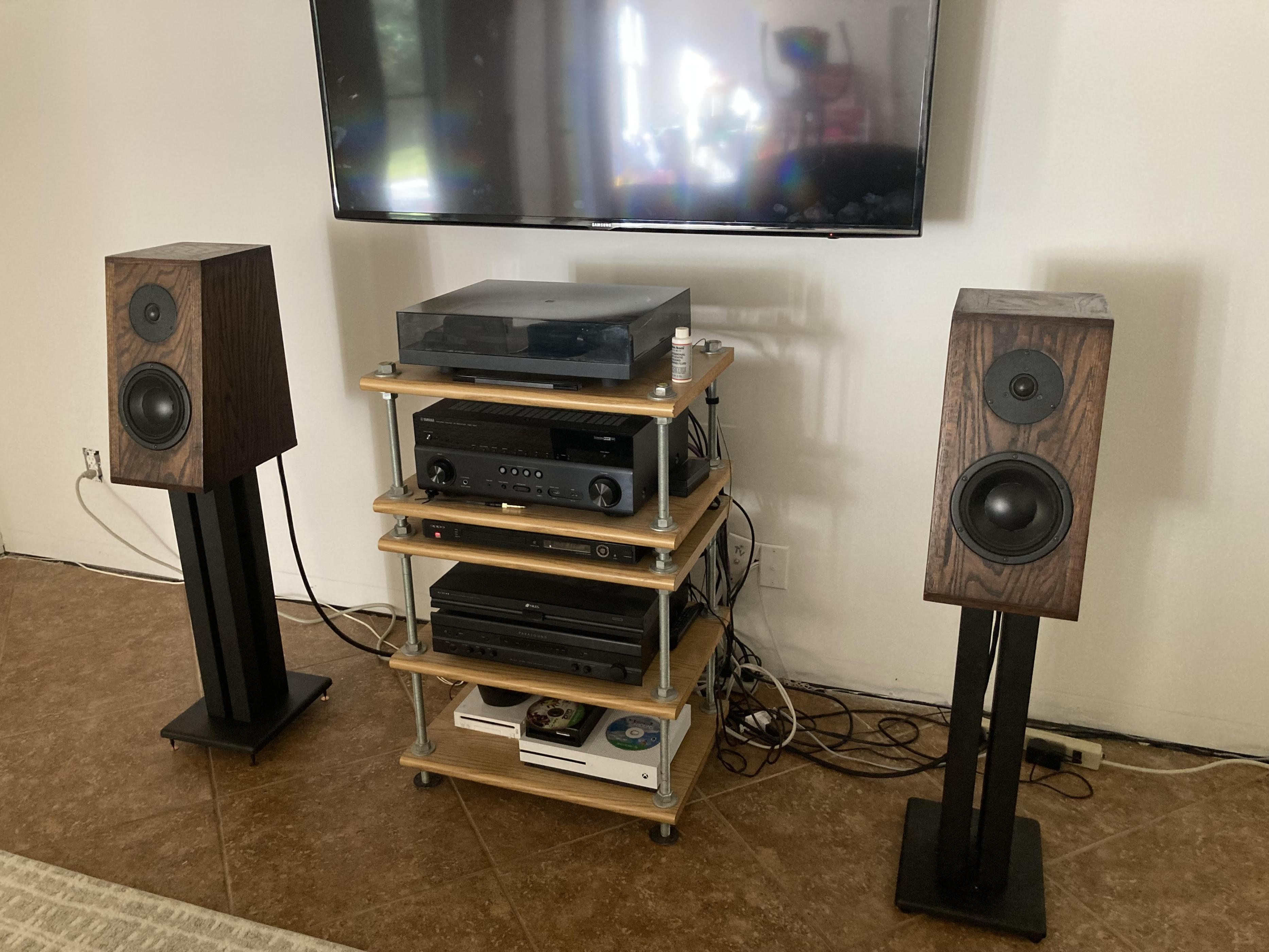

I have a DIY Dynaudio set from Madisound (circa 2000). MDY-4 monitors with D28/2 tweeter and the 17W75EXT woofer. - the same drivers as used in the Contour 1.3. MDY-4 has time-aligned (sloped) front baffle, different cross-over topology (3rd order), and an aperiodic enclosure.
I absolutely love them but after so long I'm wondering if an upgrade to new speakers would realize any benefits.

This looks like a nice bookshelf, but you certainly have room for generous sized 3-way or 4-way floorstanders that would give you more bass, higher sensitivity, less distortion in mids.
What sub do you have and what's the budget?
The sub is nothing special - a Polk Audio geared for HT w/ 12 inch driver. It goes down to 30Hz or so. I've thought to replace with sealed SVS (or a pair of them), but want to know I'm keeping the bookshelfs first.
I've plenty of room for larger speakers. Budget is flexible, but needs to hit a high value to dollar ratio. $500 to $1.5K? I'm intrigued by Troel's designs (ETKA Mkii or Discovery 861 seem like good sizes for my room).

To your suggestion about repurposing the existing drivers - I really like that. I'd love to build a three-way if I could find a woofer in the 7 or 8 inch size that would integrate well with existing drivers. One issue is that the mid-woofer has a high Qts (.7?) - hence the aperiodic design. It might be tough to integrate. I'd hate to abandon them though.
Is your comment about the reduced distortion a function of not having mid and woofer frequencies from one driver? E.g. going to a three-way? I'm still learning. I thought that using the sub would might mitigate that issue?

Getting subs to blend with the topis often hard, and you really need at least 2. (SUB)woofers, are usually the easiest to design and build.
The other thing i would suggest is that the tweeter could be a whole lot closer to the midBass. You will not get to the “magic” quarter-wavelnght spacing, but purposely placing a tweeter so far from the midBass i consider a shortcoming. I’d go as far as notching out the tweeter bezel to push it closer. XO might beed to be tweaked.

Yes, you said you really like the basic sound and these drivers seem very good and worth keeping to me. Reduced distortion would follow from relieving the midwoofer of low frequency excursion; allowing it to focus only on the midrange. A sub only helps grant this if the midwoofer is being high-passed (full signal run through the sub's crossover), rather than still running full range (full signal from your amp) with the sub filling on below 100hz.
Finding suitable bass drivers is definitely possible; the mid would be given a sealed housing in a new cabinet, so its QTS doesn't matter. Only thing is it seems there was both an 8ohm and 4ohm version of this driver. You'd ideally need measuring equipment to design a new speaker, and would want to know which driver version you have there. I'd be thinking a 10" or 12" woofer per side; it looks like you have more than enough room.
Now, I don't think these look very good myself but the basic idea of one cabinet module for the tweeter + mid + another discrete cabinet for the bass driver would be the general concept here. e.g. Carmody's Tarkus and Jeff Bagby's Kairos 3 way outline. Troels does something similar with the SBA 741, which I think looks ghastly but....
At the end of the latter document, Jeff says building a single new cab would make sense and can be made to look nicer.
Building your own nice big subs would definitely solve the bass and be simple and no risk, really. Repurposing the drivers into a true 3-way would be more complex, costly and need measuring equipment, but has higher performance potential.
Thanks all for your comments. I am going to focus improving the bass via new subwoofers (x2).
To Motokok - thanks for reference to Tarkus and Kairos. Not the look I want, but good information. The L/R signal is being high-passed. The Parasound pre-amp has both high-pass and full-range outs (plus sub). It's a neat feature. Roll-off is 80Hz (fixed) and is first-order (6db/octave) so is gradual. I hope it reduces distortion somewhat. That Parasound also has HT bypass so it gets out of the way when using AVR, but is pure two-channel when using other sources.
I do like the sound, so I'll keep the boxes as is for now. Maybe I'll do a full redesign at some point (3-way with closer spacing on T/M) - that'd keep me busy for a while.
