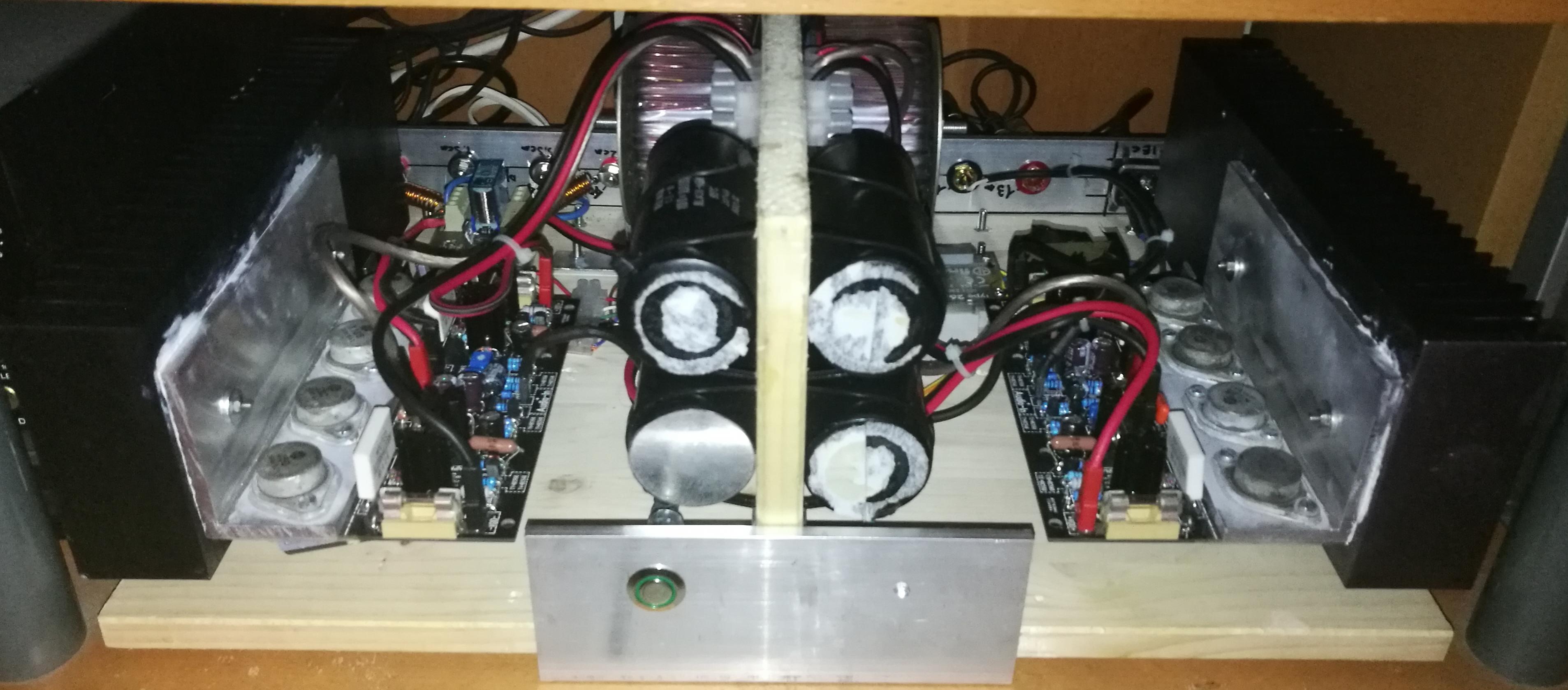

Crescendo Realization with FMMECh PCB for TO3

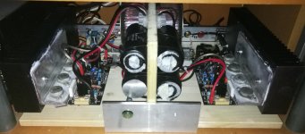

I want to share my recent rebuilding of my crescendo, with the TO3 FMmech boards. For the moment, all is mounted in a temporary wood board, but i'm in the way to choose a decent aluminium enclosure to finish this project. Absolutely no oscillations at any load, dead silent and well performing wiht my stereo set!!

That's a good way to build.
Find out what space/volume you need after folding all the component assemblies into a working arrangement.
And then buy a Chassis/Enclosure to suit.

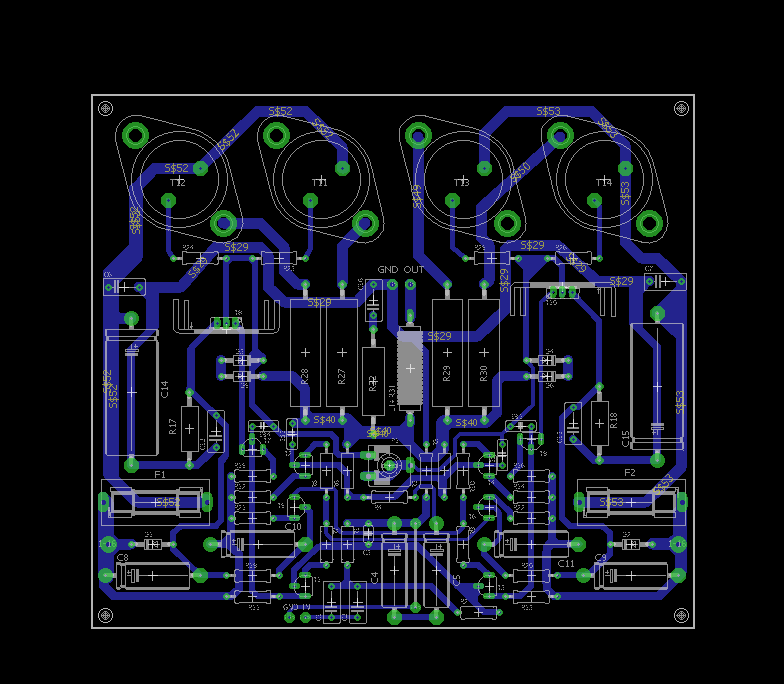

IMHO The original PCB Layout of Crescendo is not so optimized, and prone to HF oscillations. Better employ a newer layout.
Are you asking a question, or telling us a specification?You know that the original ELEKTOR PCBs had 70µm copper layer?
Best regards!

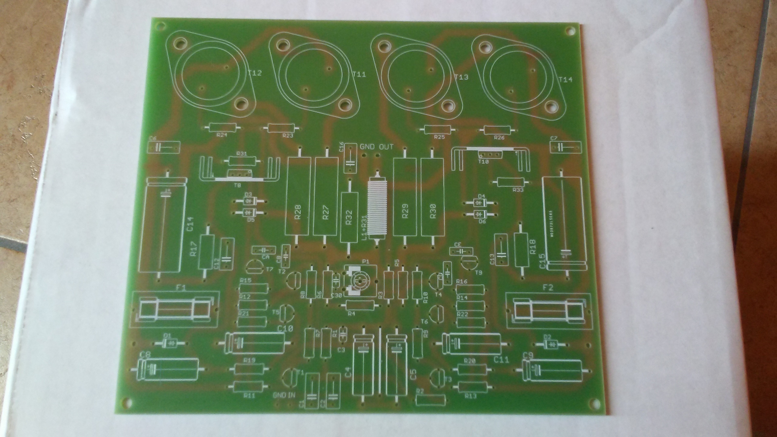

i read that the source resistor are the problem of oscillationIMHO The original PCB Layout of Crescendo is not so optimized, and prone to HF oscillations. Better employ a newer layout.
this is the original board .
something to improve?
the pcb is 146x129mm.😱
Hi scafas,
google for 'ray's audio page' and see, what can be improved.
I know for sure that Elektor sold their PCB's for this project exactly with this specs.
Best regards!

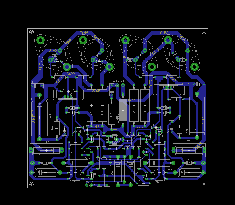

i see , so i add some components on board to prevent oscillations..Hi scafas,

- Use poor induction resistors for R27 to R30
- increases C16 from the Zobel network to 100nF and uses a MKP
- isolate T8 and T10 from the heat sink and connect them to zero
- Mount 22k load resistors for T8 and T10
- T8 and T10 may be needed. they are replaced by MJE340 and MJE350
- place a 100 nF capacitor on P1
- reduce the polystyrene from C2 to 100 pF
