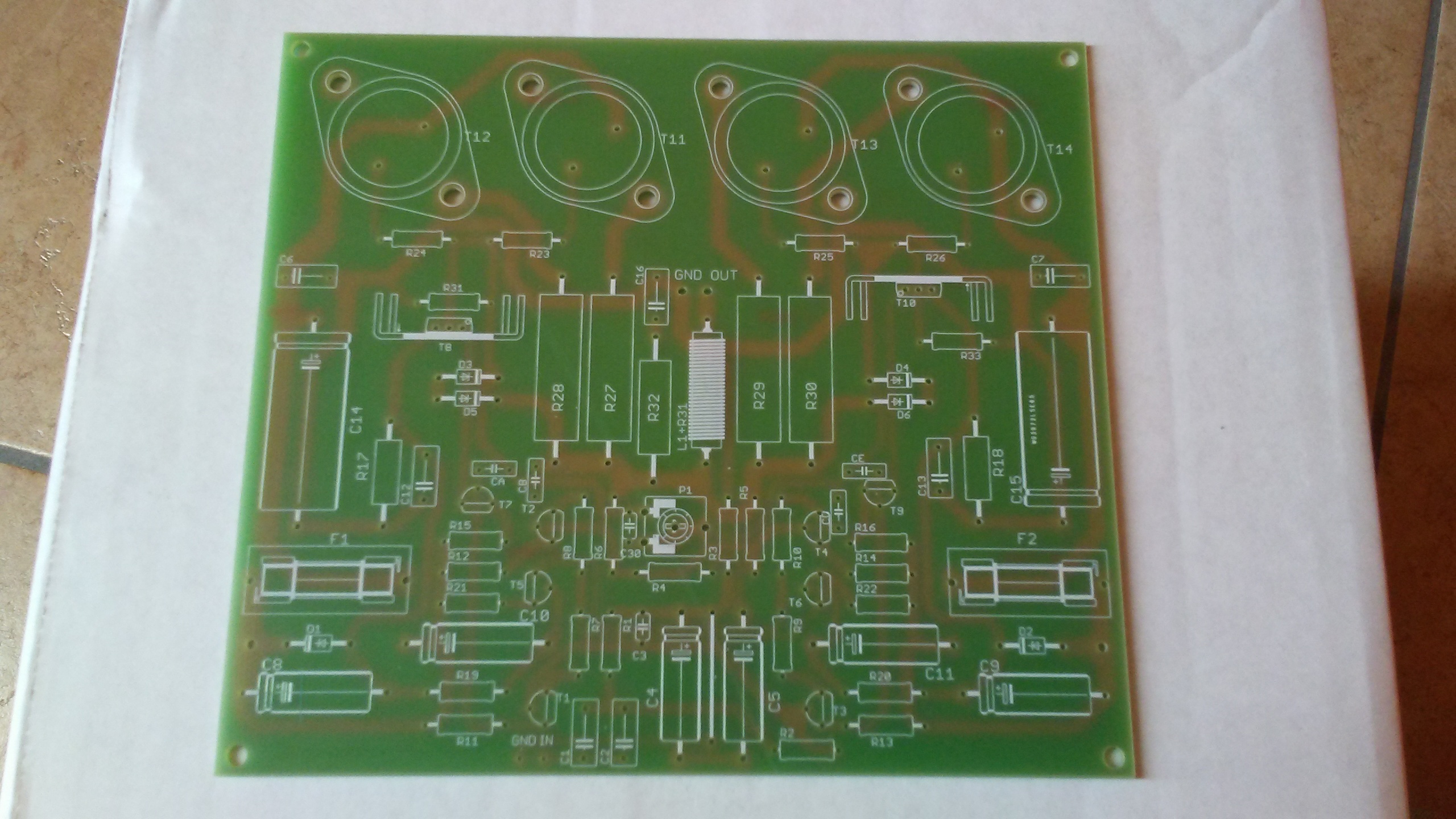

Thermal ompensation is an option only for those IRFP's and not necessary for the HITACHI originals, I think.
Best regards!
Best regards!
Of course, but one must be aware of different arrangement of pins (IRFP gds - Laterals gsd).
With few bridges it is possible to use ECW20N20/ECW20P20 for example. Also if interest I can edit PCB .
IRFP's simulates little better, that is why I prefer them .

tha layout is the same as original .Are you share the pcb layout...
8pcs available :
pcb power amplifier Elektor Crescendo 250watt hitachi mosfet | eBay
Did I ask you yet whether the copper layer is 2 oz (as with the Elektor originals) or just 1 oz?
Best regards!
Best regards!
2ozDid I ask you yet whether the copper layer is 2 oz (as with the Elektor originals) or just 1 oz?
