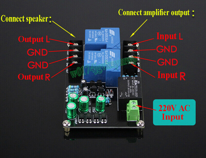

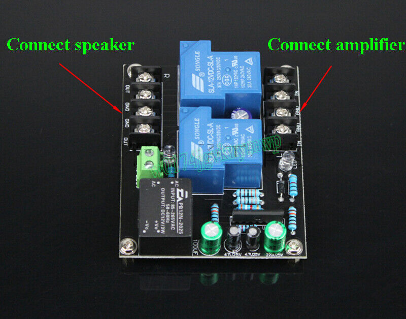

Hi my dear minek, i hope you have a nice day.
Can i use anyone of this speaker protection module in the picture bellow?

No, they all share the GND for both channels speakers.
You need to find board similar to the one I posted earlier.
Description should include keywords 'BTL', 'bridge', 'isolation'.
Your amp is BRIDGED (internally).

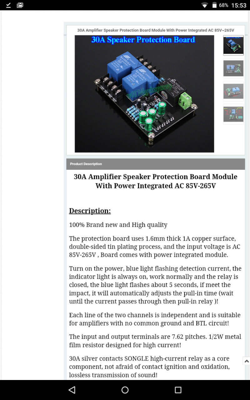

The first and second picture of the speaker protection say on description "Each line of the two channels is independent and is suitable for amplifiers with no common ground and BTL circuit!"
Correct me if i'm wrong, but if i understand, this speaker protection module is suitable for BTL and i can use in my amplifier board TDA7498E, right minek?
I was looking at the picture, and I saw speakers connectors marked as GND, but the statement above clarifies this.
If the above statement is true, then yes, it should be suitable for your amp. It even has its own PSU; not bad.
