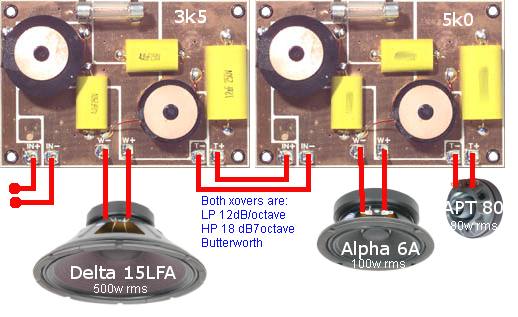

I nowadays got my hands on an old suspended project. It was an instrument cabinet.
And I still have an unresolved question about its xovers.
If I divide HF out of a 2 way xover in to two, via an other 2 way one, I would actually make a plain 3 way one, right?
Here I want to divide HF shelf which starts from 3.5 kHz into two with 5.0 kHz cut point.
Looks simple but I'm still suspicious 🙂 Like, does it cause phase problems etc.
Any ideas?
Thanks in advance

And here is the diagram:

You will end up with very little output from the 6A, it is essentially
superfluous. The APT with the right horn can work with the right
bass driver at either crossover frequency. the croosovers cannot
be used together in any effective manner I can think of.
🙂/sreten.
