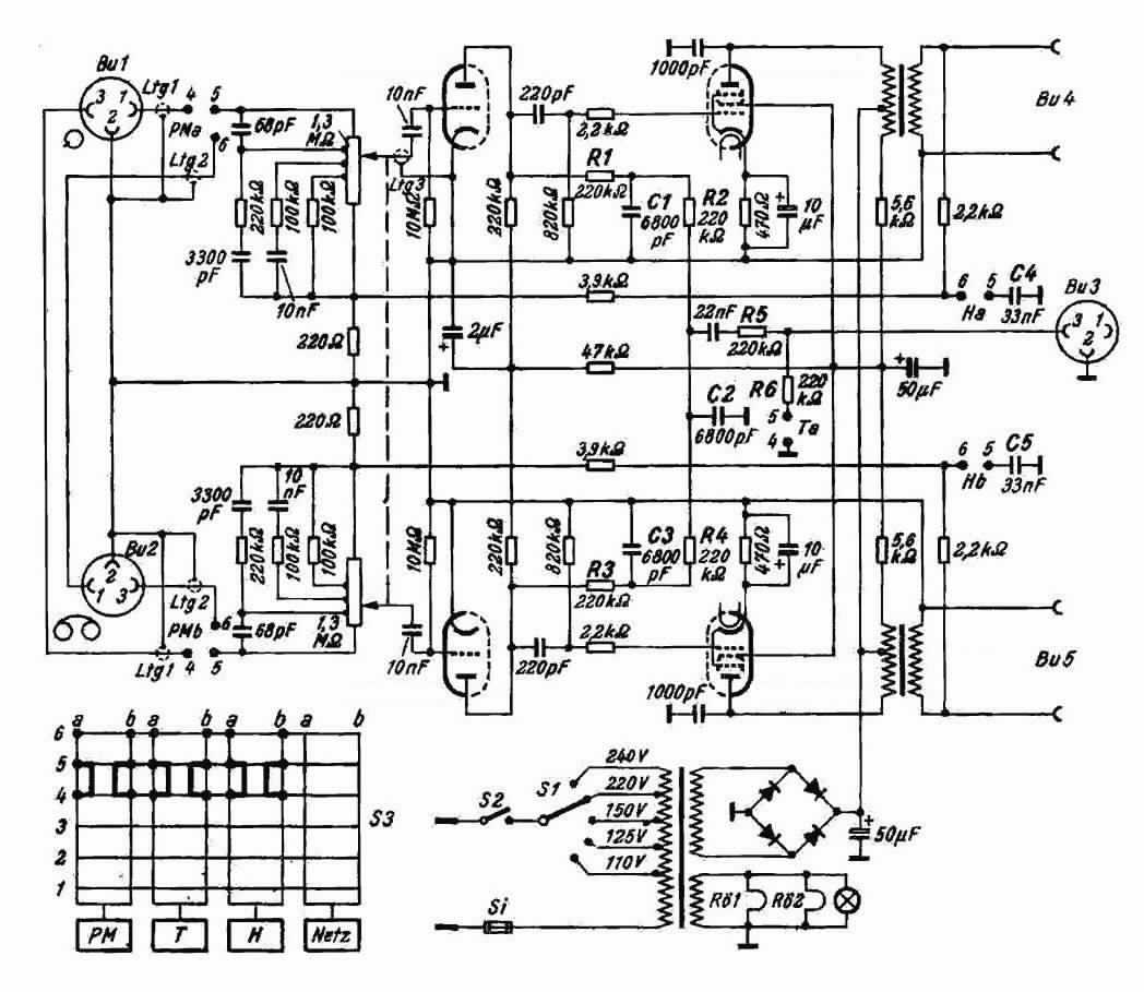

So I have now figured out the OPTs. The main turns ratio is 33:1, that gives me 8,700 ohms for an 8ohm speaker or 4,350 for a 4 ohm speaker. They are physically quite small so I guess good for 5w or less and probably limited in bass response. Given the rest of my collection of bits any suggestions for a schematic?

So I have tried to figure out a simplified schematic to work with the bits I have in the post above based on the original telefunken schematic. Please let me have your comments and suggestions .

Folks
You've all been silent since I posted the schematic. Please let me know if you think this will or won't work. I want to set about breadboarding a single channel and would rather not have something let the smoke out🙂I am rather intrigued by the power supply using the OPT as a choke. Of course this was invented as a bit of commercial cost cutting but does have the advantage of reduced part count and as I have suitable OPTs it would be a bit of a waste not to try it. So outstanding questions are do I have B1 voltage correct? If so should I attempt to reduce it or change bias in some way to get into flatter area of the curve? Please help before I buld this and burn something 🙂

Your schematic shows a special wound transformer. Part of the primary possibly being uses an a hum bucking (choke) or cathode feedback winding.
If you have the transformers and can figure out the b+ ground and plate terminals the resulting amp will result in about 3 watts output
