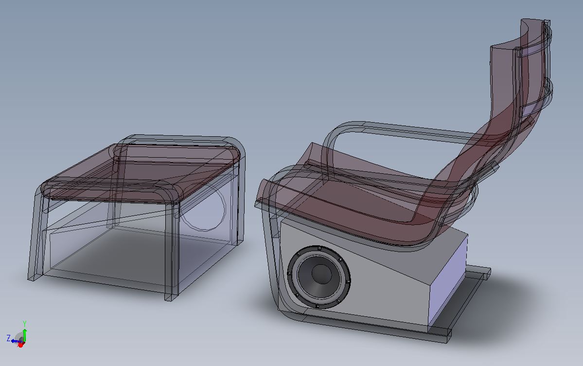

Also thinking about some sort of 2.1 system based around the Ikea Poang chair...

How about woofers in a box underneath the chair? Looks like you've got that idea already... I once read long ago that woofers with a bandpass response in open air, go flat when pointed directly at the floor, within inches of the surface. That should be pretty enveloping; unsure how much r/l separation you get.

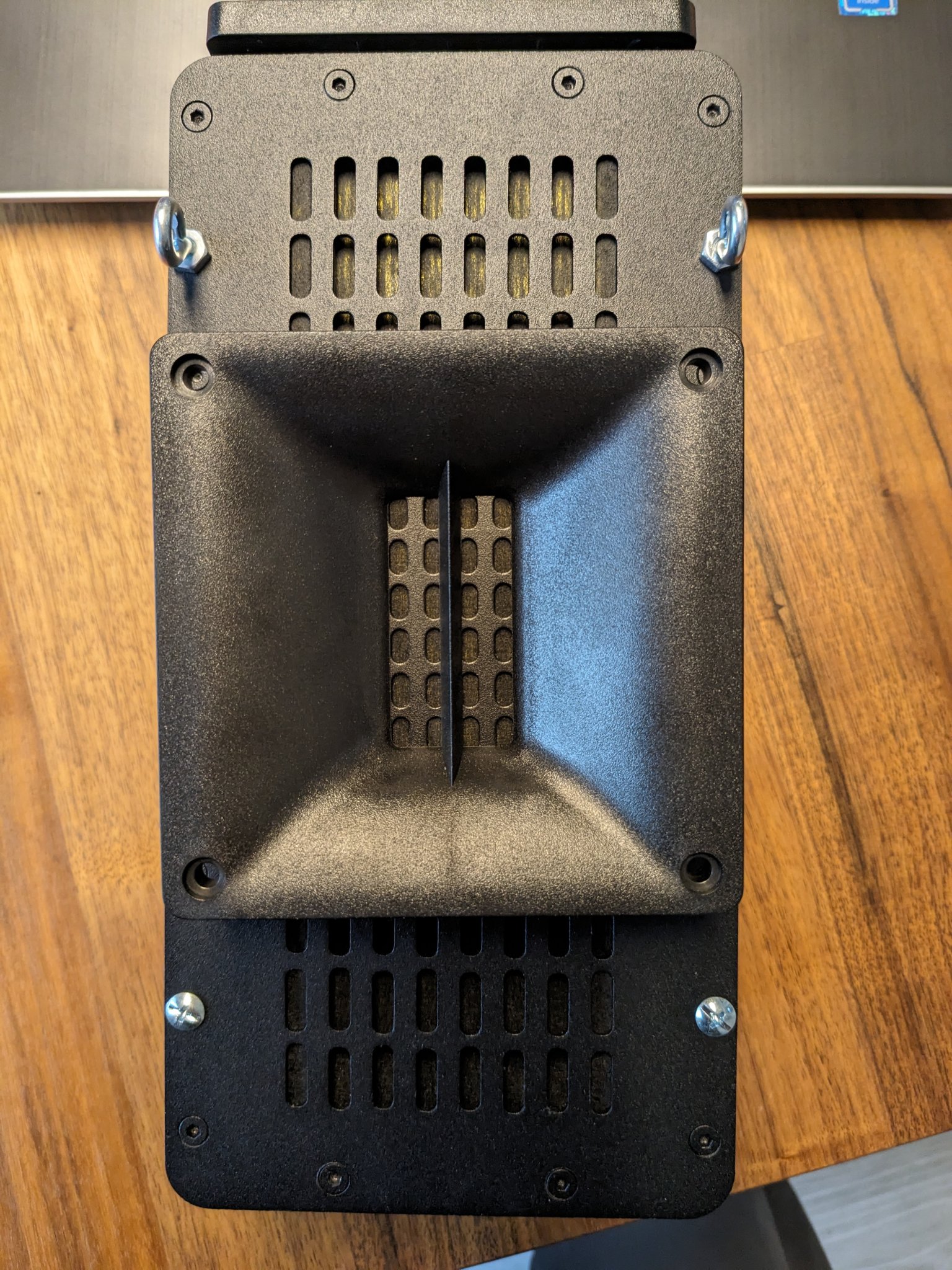

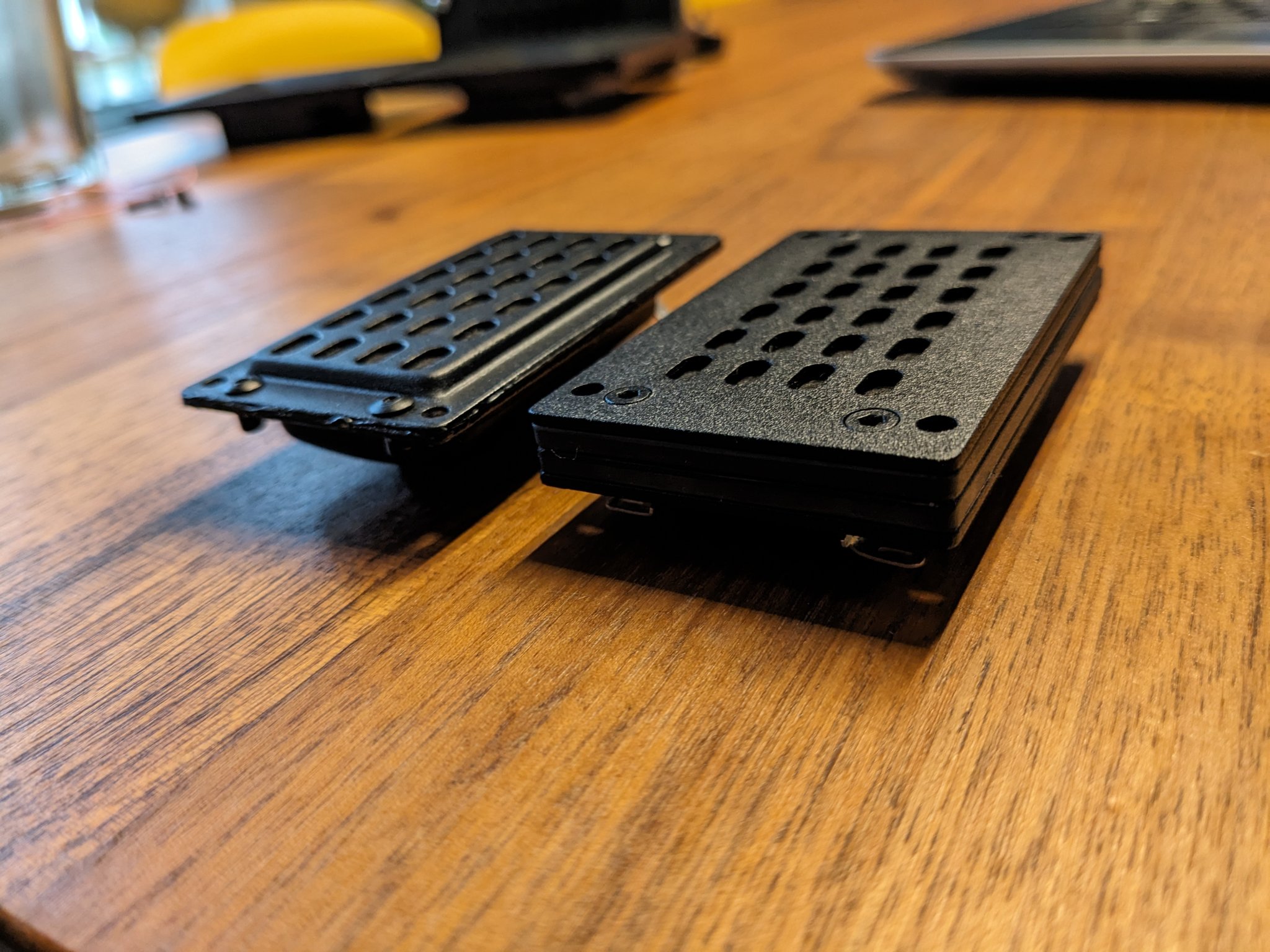

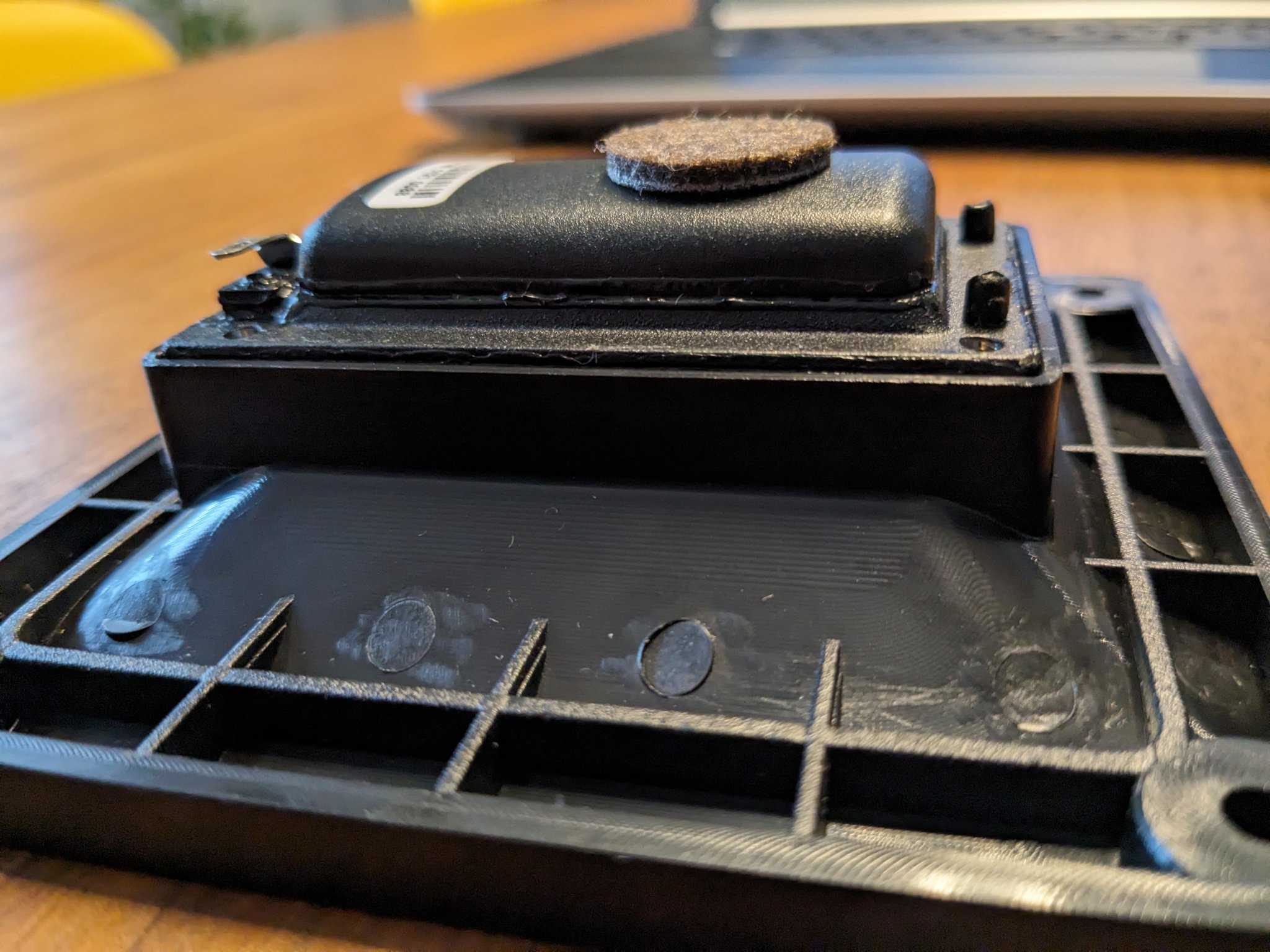

I received a pair of the new version Radian LT2.2 tweeter and matching waveguides today. That's the end of the good news. The bad news is that the revised tweeter got wider and no longer fits into the recess of the waveguide to sit flush as it did for LT2. It's about a 2mm difference. Radian either dropped the ball on the design revision or they accidentally labeled old style waveguides as those for the 2.2. I've already contacted Radian with the mistake and we'll see what they say. The construction quality is certainly improved on the new version and now matches that of the 8 and 10" drivers. No more rivets and glued joints.
My thinking is that if the waveguide improves top end response without messing with the midrange, I'll use the waveguide to hold the tweeter and provide an easier place to create something to attach it to the LM10n. Kind of like the bridge that BG created for the Neo3/Neo10 combo shown earlier in this thread.

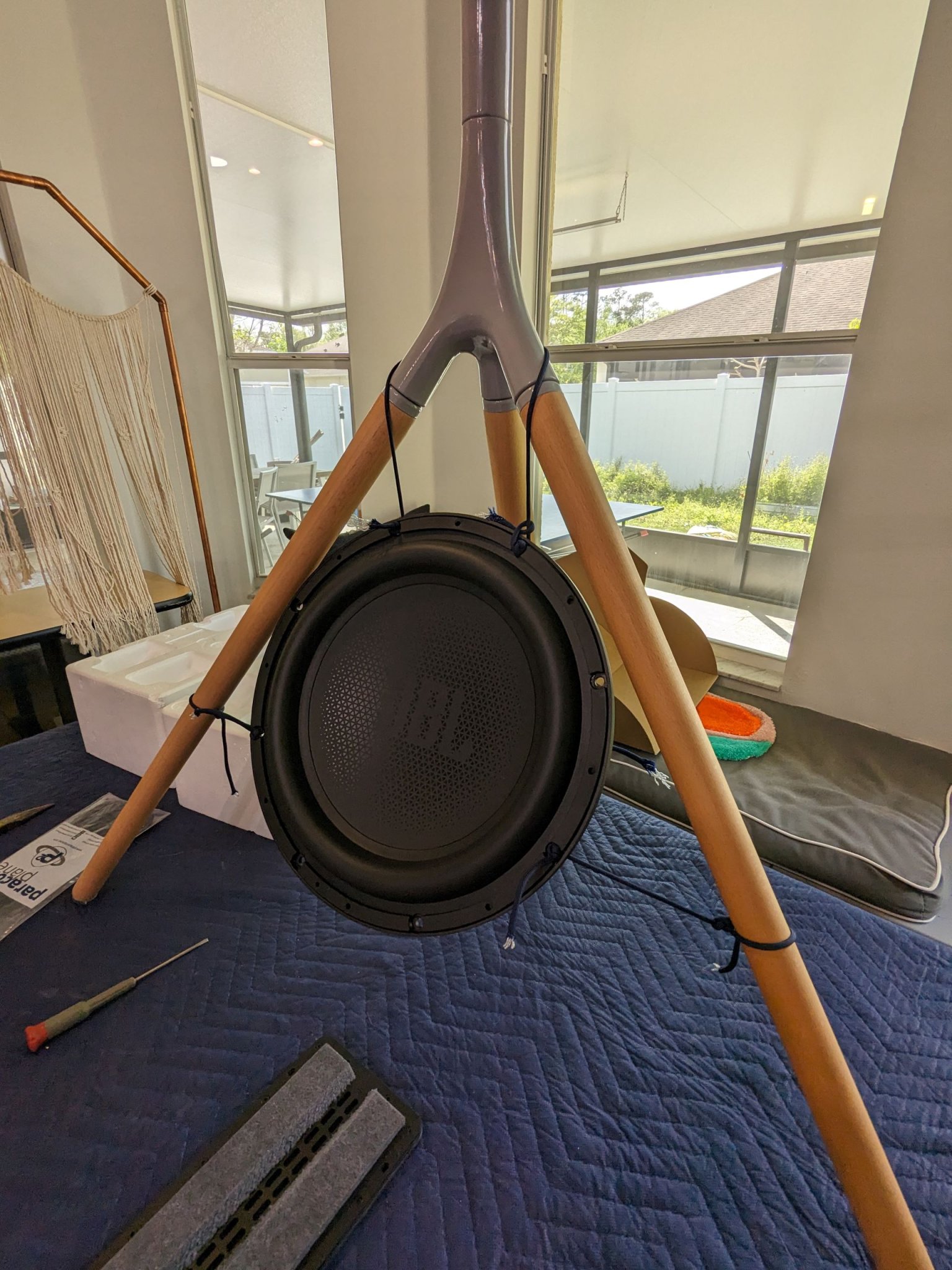

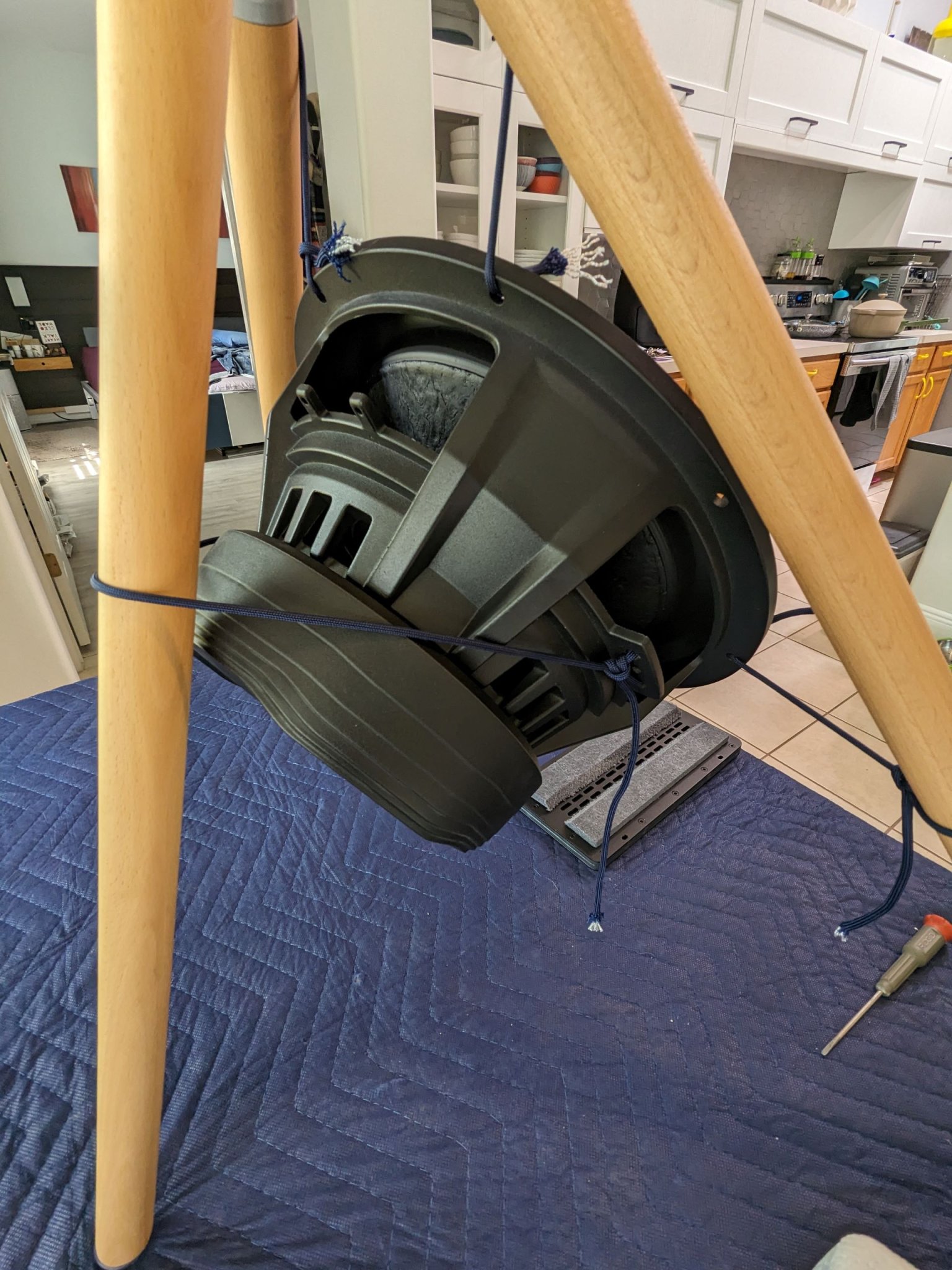

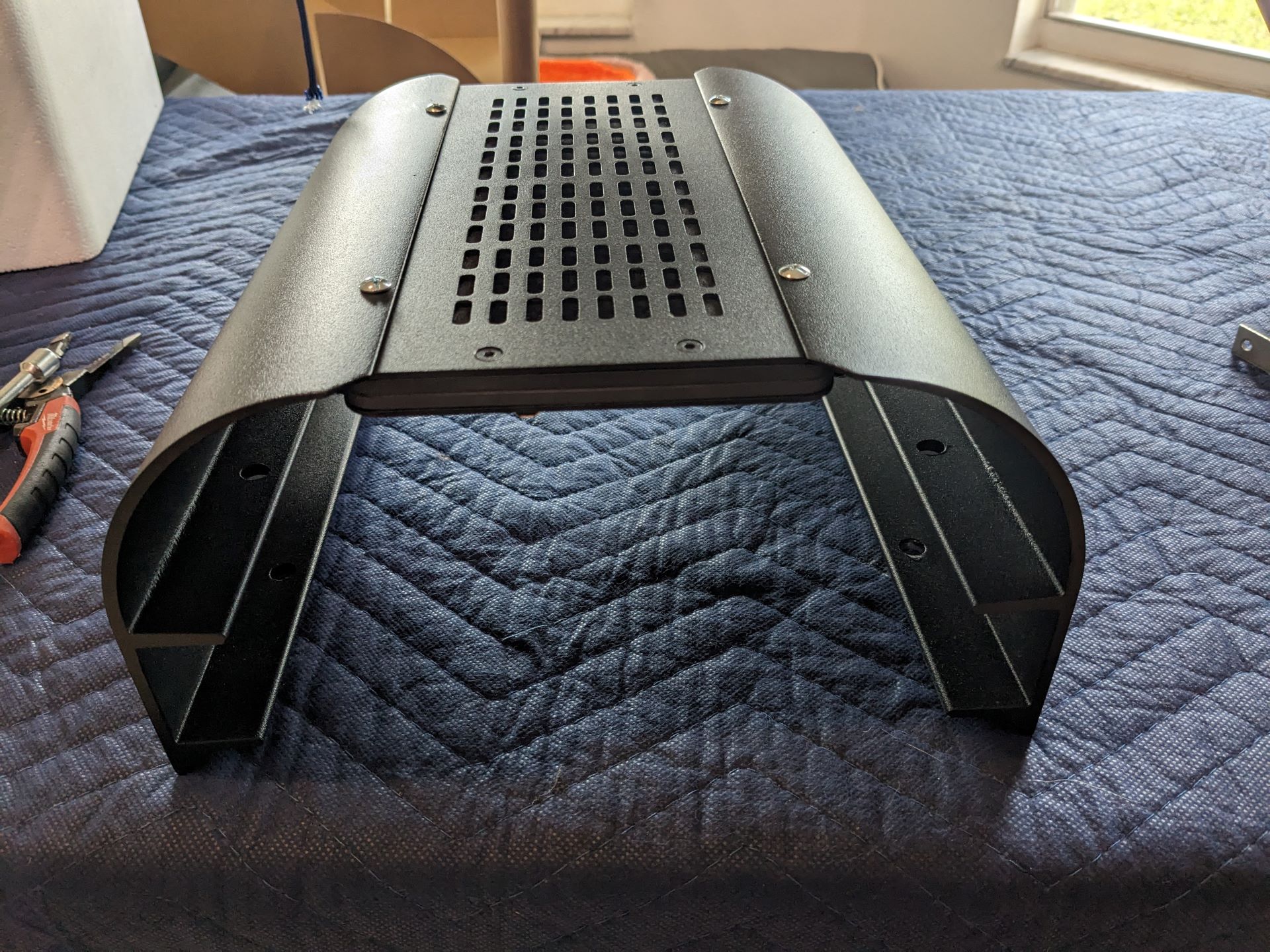

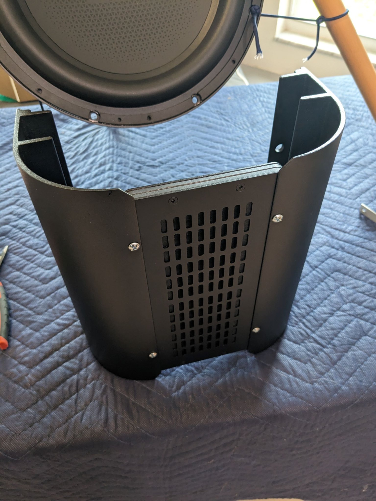

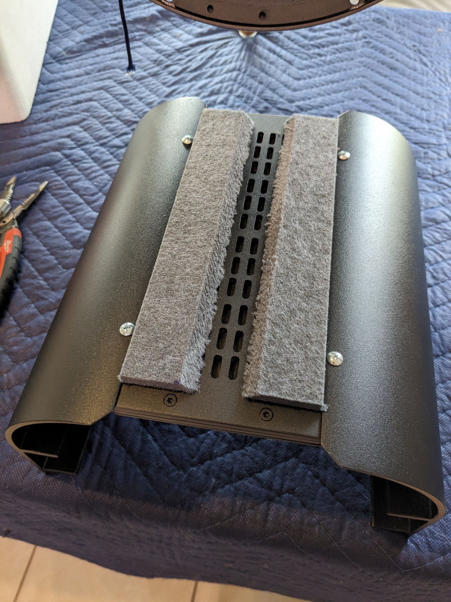

Finally got some more time to mock up options today.
