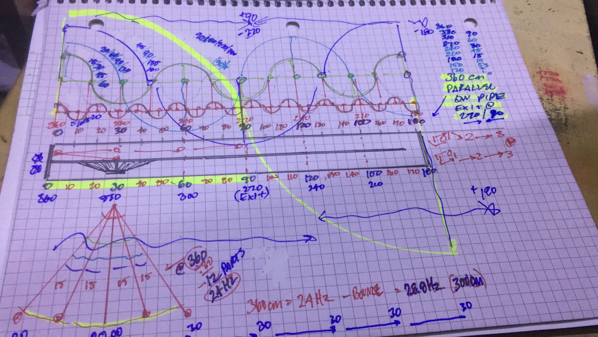

these two blueprint like pictures aren’t in standard units whatever and a lot of it doesn’t make sense because it’s ancient numbers or forgotten ones unit of measure and it’s converting those to something modern that’s going to help out but only if it’s a centimeter or 1÷254 which is the conversion of centimeters and then parts of a circle meaning pie but the pie with the number parts and (not the symbolic one ) this is PI 22÷7 . and what that ends up being in the radians or degrees as centimeters is circumference.

Only horn response can come up with the numbers for offsetting a pipe or a driver or stub that will contribute it precisely to a number that’s needed and nothing else will do that so we build speakers we understand what steps do we understand how things are gonna be perfect or they’re not in regards to that and the closer you get to perfect in the decimal points of it because of your arrive at numbers that matter for a very important reason
GM it is what’s wrong with Paraflex that needs to be fixed (The misalignment in both lengths offsets and cross-sectional area at a certain point )but then reveals the numbers to use to understand Egyptian pyramid and it would seem more so than anyone has in the history of civilization at this point?

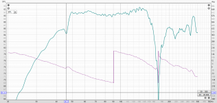

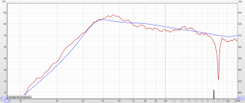

HI Guys!
Thank you very much for those big informations!
I want to go in deep with fluid dynamics because is very interesting and I think I will test 2 ports on sidewalls.

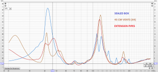

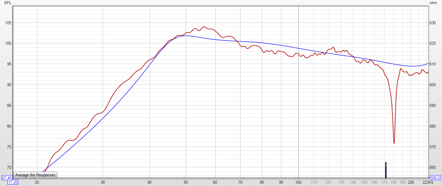

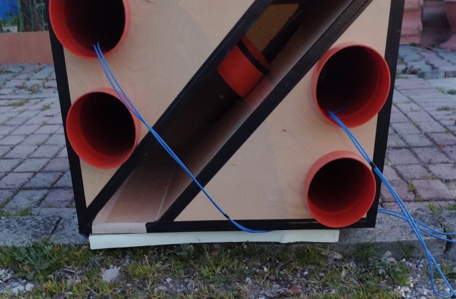

Now I bring you my (poor?!) results with round ports.
4 Ports,14cm diameter each, 45 cm lenght.
I tested in outdoor enviroment but with mic maybe too close to the enclosure ( 3meters max).
I like linearity of the response but I would eliminate the dip at 45hz and 170hz even if I will use steep LPF at 100-120hz.
I hope that 45hz is due to air leaking from the enclosure joints (only screws at the moment)
the 170 I think is a modal resonance of the internal lenght of the enclosure so I will use damping material if necessary.

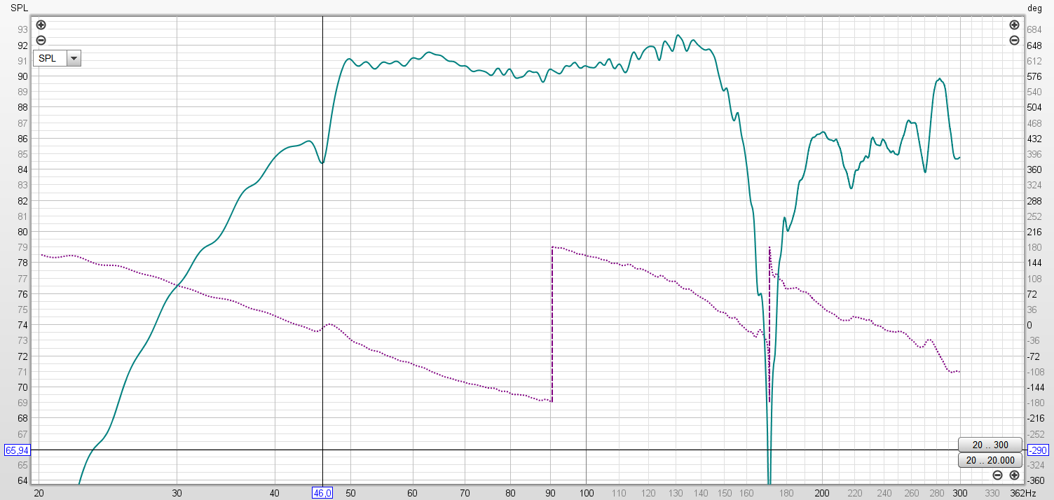

This plot is mic inside a vent:
Still same dip at 45hz and very broad response from the port.

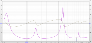

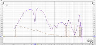

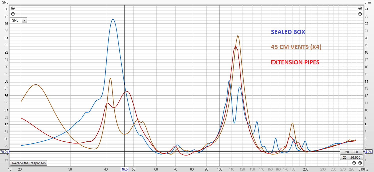

Initially I couldn't see by eyes which was the real tuning fr so I built a quick impedance test jig
I built also two sealed front panels :
I've never made impedance tests but I think that BR impedance dip is in the same frequency of the bigger peak casued by the lenght of the plenum.
The BR tends to lower the highest peak.
Can be a problem?

Ale, 3 meters should be plenty. Was the mic on the ground?I tested in outdoor enviroment but with mic maybe too close to the enclosure ( 3meters max).
Leaks around the drivers also could be part of the problem.I hope that 45hz is due to air leaking from the enclosure joints (only screws at the moment)
I doubt a narrow dip like that would result from an internal resonance.the 170 I think is a modal resonance of the internal lenght of the enclosure so I will use damping material if necessary.
Locate and fix the leaks, then re-test.

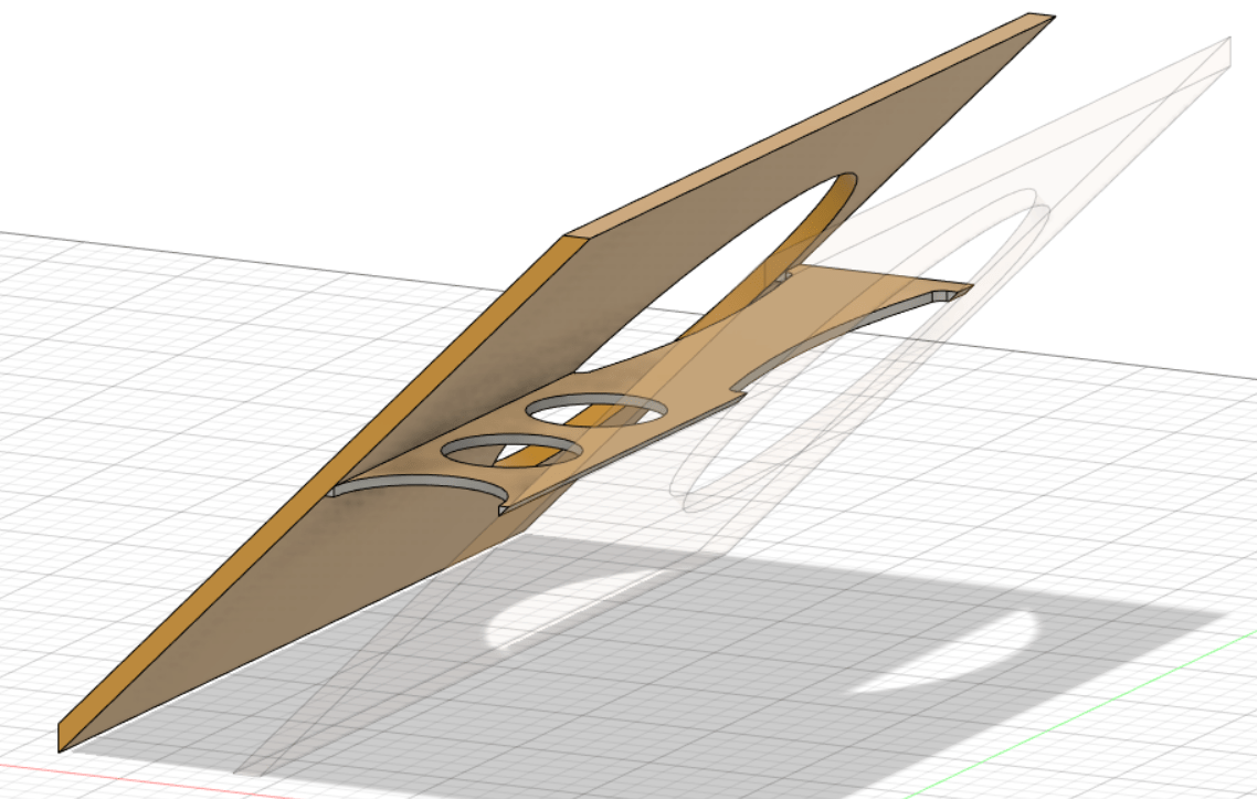

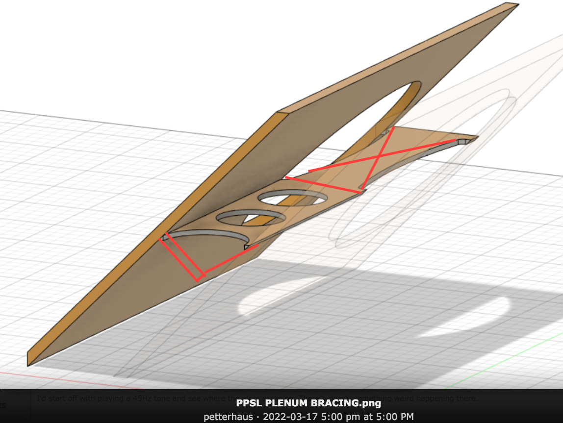

I'd start off with playing a 45Hz tone and see where the air is escaping. There's clearly something weird happening there.
On a different note, is there any concern about the compression ratio that the cones will see? - The slot looks quite narrow.
Chris
Chris

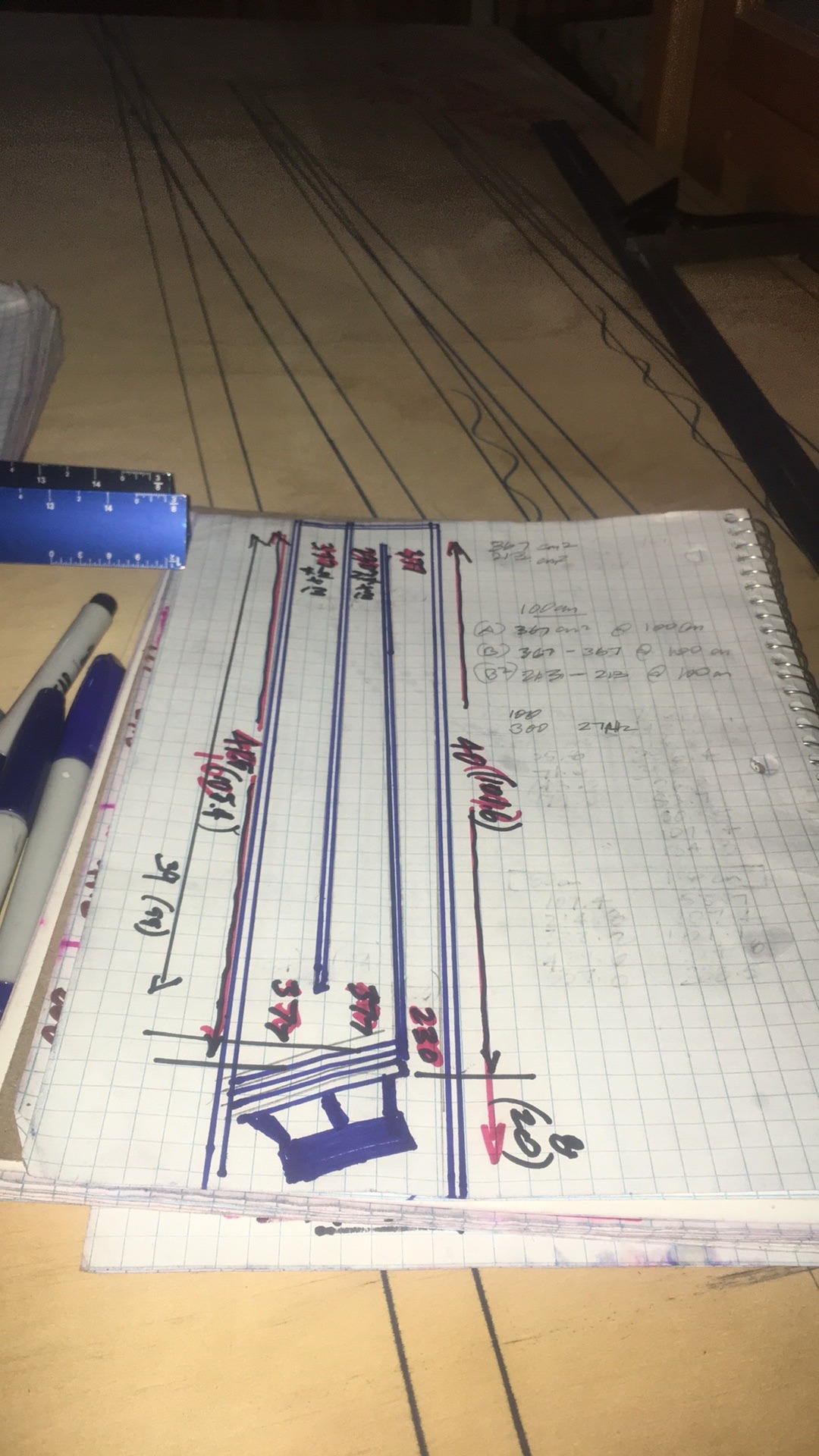

Chris,The slot looks quite narrow.
The compression ratio is under 3/1, not a problem for the B&C18DS115-8 drivers used in this project, even if they were horn loaded- the plenum does not provide much LF cone loading in this design.
HiAle, 3 meters should be plenty. Was the mic on the ground?
Art
yes mic on the ground in a garden with 2 small buildings at 10meters at least.
Today I found big leaks from the "utility" doors using sin waves.
I'm glueing everything together except for the front baffles and internal braces.
do this kind of bracing interferes with the plenum or brings some resonances?

I made some noise like you suggested and after I decided to seal everything definitely, was a shame the air mass leaking 🙄.
about compression ratio: I've read a big part of the ppsl thread and every plenum were as little as you can mount 1 driver with the magnet in the plenum.
For my goal dimension I developed the exit area in height.
Thank you
Ale

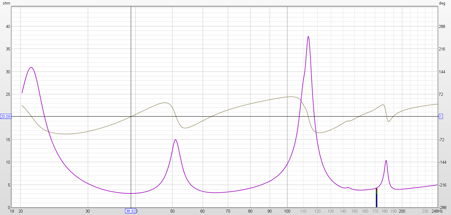

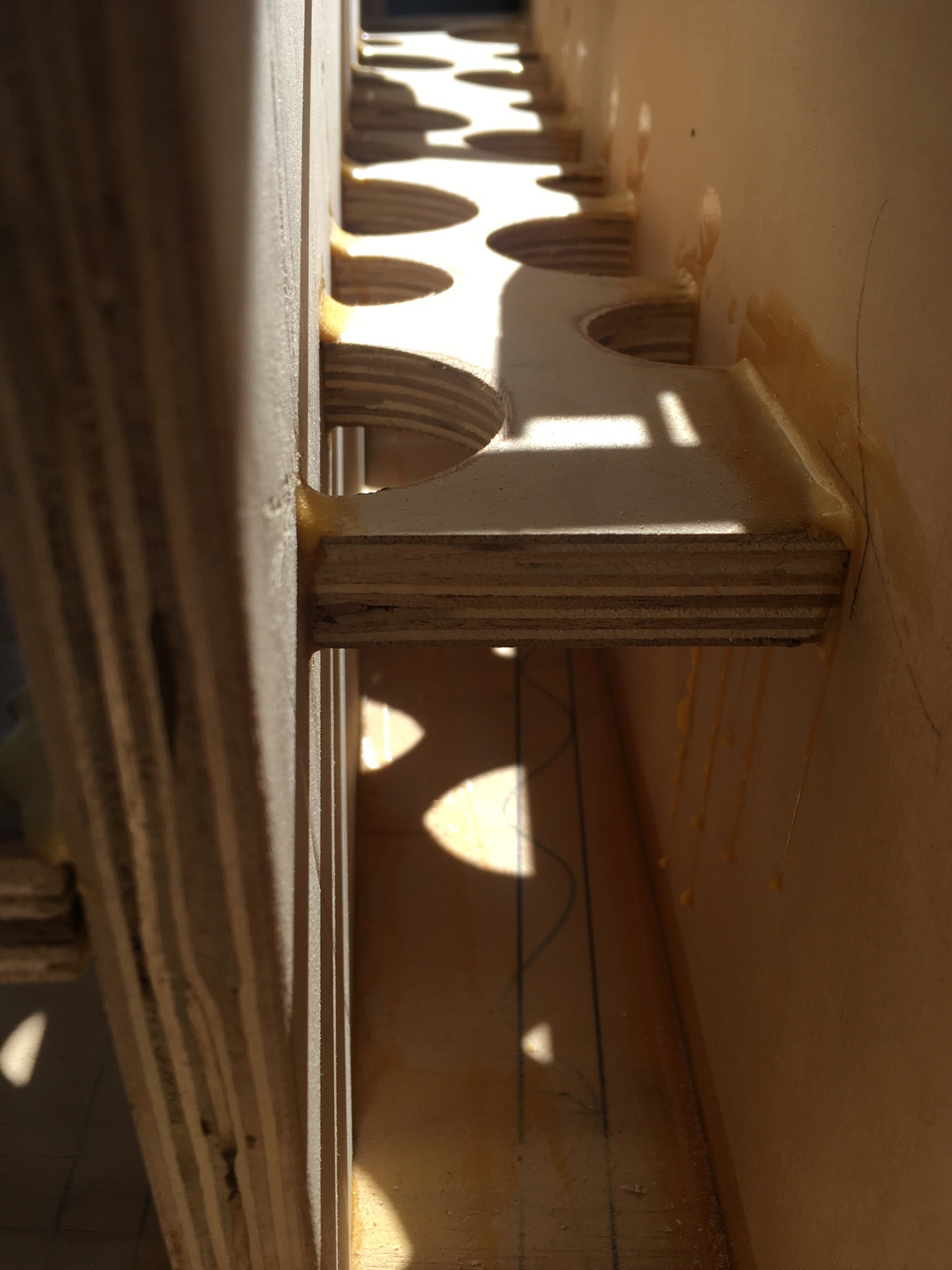

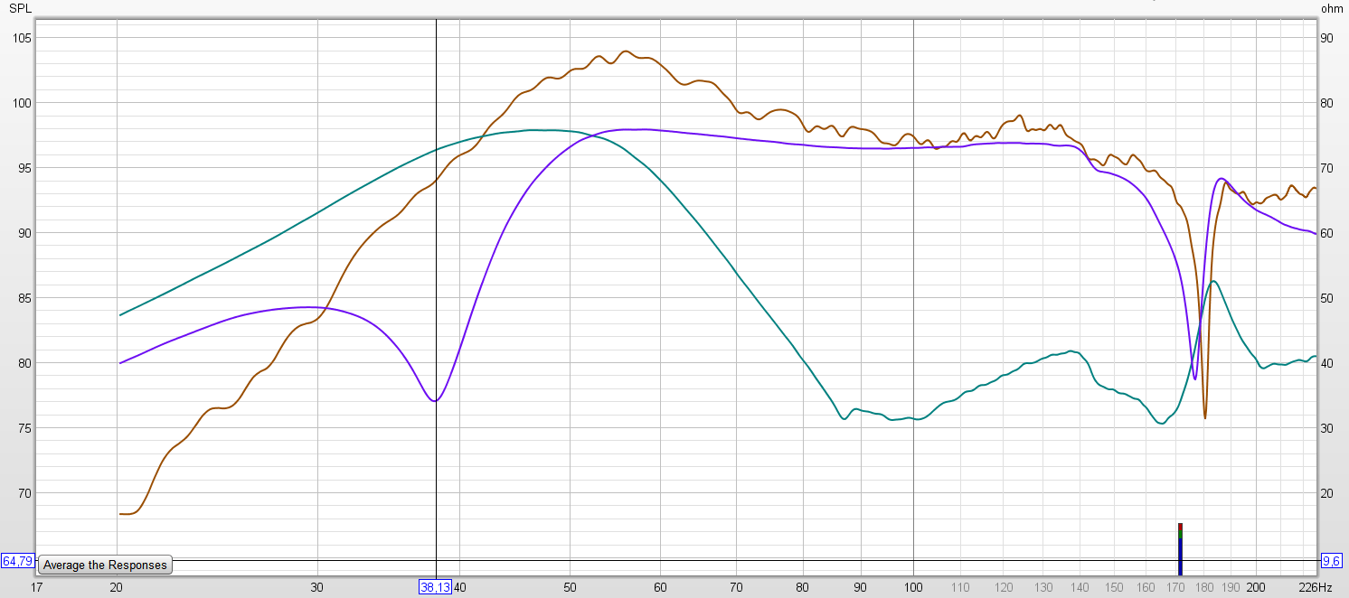

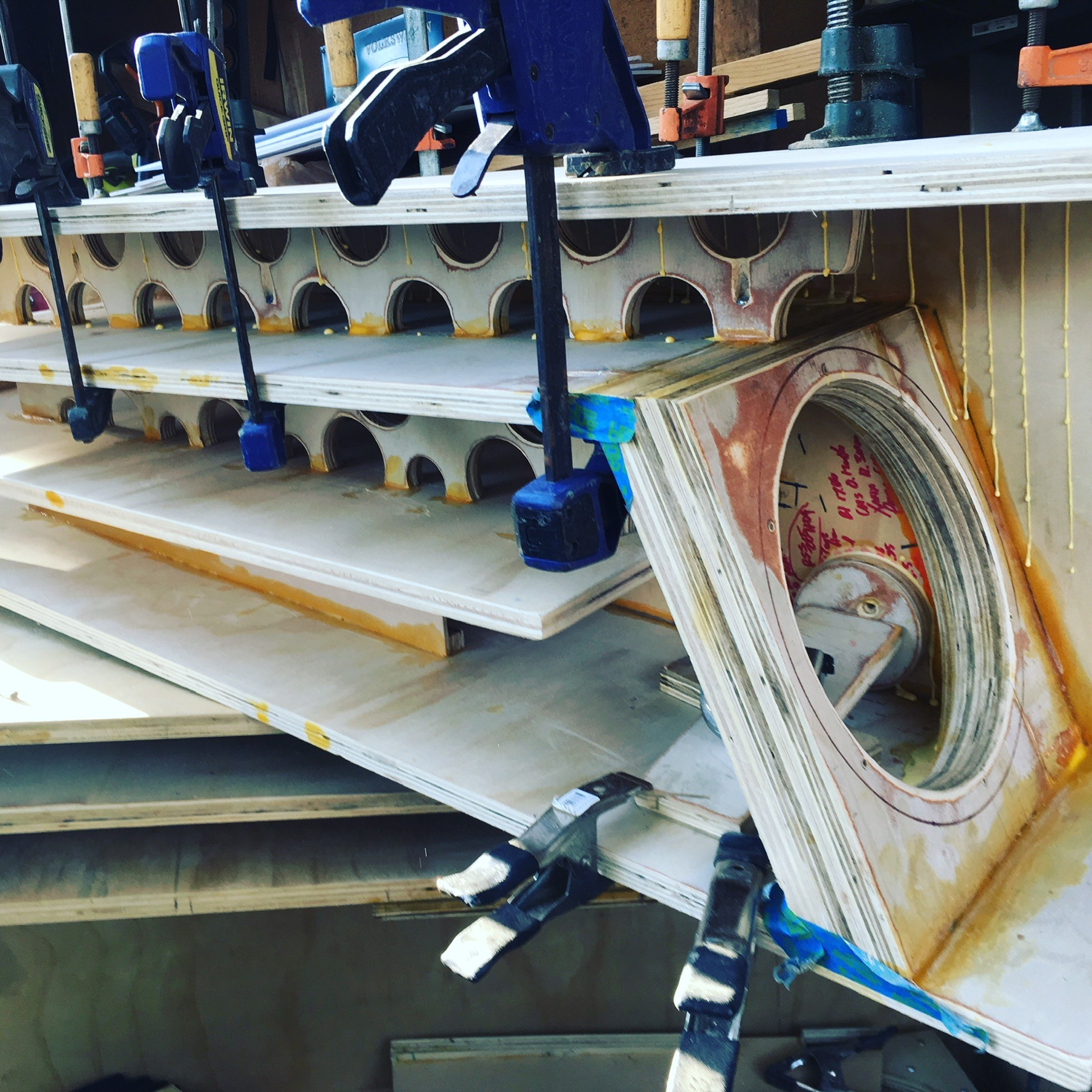

HI

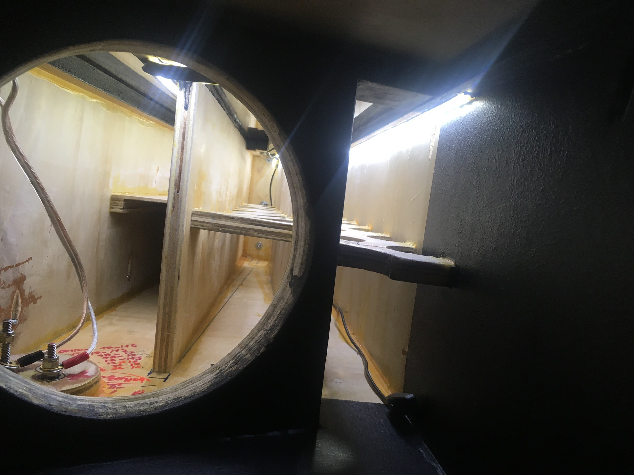

Finally I assembled with glue the box except the front panels.
For the moment I used one 200mm pvc pipe 42cm long per side, Unfortunately 42cm is the max lenght I can achieve because of the cone baskets position.
I included the plenum bracing like Art and Booger suggested (bracing perpendicular to the plenum sides and chamfered holes)
and now impedance and fr measurements are very clean.
Here the measurements ( outdoor, 3 meters, no spl calibrated, no smoothing):
RED: total response
BLUE : mic inside plenum
GREEN: mic inside one port.
Here impedance check ( using headphone out of the soundcard and resistors jig):
I tried to learn how to check tuning fr of a reflex cab looking at the impedance and its phase and it seems tuning is at 39hz and I could cut the pipes
for my 44hz goal. Putting also a piece of paper in front of a vent and looking at the minimum cone excursion I obtain 39hz'ish region.
But the final response and mic inside a port it seems the tuning is higher and the peak is very broad.
Now I'm not sure how to interpret those data.

HiHI

Meanwhile I measured one speaker impedance in free air out of the box and the fs peak of the driver Is at 42hz, despite of 30hz showed in the manufacturer datasheet.
Do I Need some warming up for the suspensions?
Can this be the detail that moves the reflex Port peak higher in frequency than the dip of the nearfield (plenum) cone meausurement?
Thank you
Ale
The suspension may need breaking in, run it past Xmax for a while below Fs.Hi
The Fs also will appear lower at higher drive levels, might take 4 volts or more to read correctly.
Both excursion and impedance minima should be at Fb, regardless of Fs.Can this be the detail that moves the reflex Port peak higher in frequency than the dip of the nearfield (plenum) cone meausurement?
Is your plenum actually the 79cm depth indicated in the Hornresp inputs in post #1?
Ok. I Will use an amp in the impedance jig and do also free air noise if with amp Notting changes.The suspension may need breaking in, run it past Xmax for a while below Fs.
The plenum depth is 89 simulated and 88.2 in real world.
Ale
Despite my ingnorance understanding the difference between impedance and fr plot,
the horn resp imported response overlaps the real world 😀
this is without flare and ports extensions, so not a scenario I would use, but only for testing.
scenario 1: no 2°flare with extension ports
scenario 2: with 2°flare without extension ports
(scenario 3: with both).
Thank you
Ale
Thank you
Ale
+/-3dB, close enough for rock & roll ;^).Despite my ingnorance understanding the difference between impedance and fr plot,
The deep notch at 180Hz is interesting, looks like the plenum and port output may be 180 degree out of phase at that frequency, usually that sort of dip would show up in the simulation. That said, Hornresp is assuming one port, but there are four, so the port's "pipe resonance" will not be the same.

If the ports are capped off (covered/stuffed), does that dip still show up in the response?
