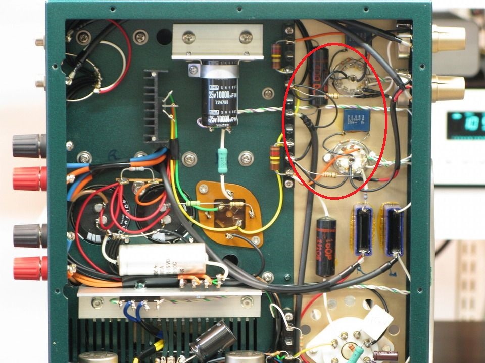

The output sound of push-pull tube amplifiers may depend more on phase splitter circuit. .Cascode in some pushpull amps has good results even in drive single-ends. Look at f2a se Ampfire ..... design by Ken Shindo in Japan. A cascode with 6aw8a..... I drew cricuit and made , the sound is unbelievable .

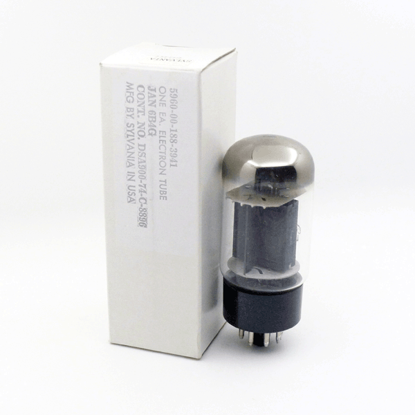

Be damned if the 6DJ8s didn't work. ;^) Bad thing is those Rifa coupling caps were leaking DC so for the time being I stuck in some ODs to get this thing working right. (any suggestions on maderatly costing coupling caps to replace the ODs) We had some straight sided Sylvania 6B4G and some coke bottle (3 Raytheon/1 Sylv). I put the straight sided tubes in and some 6DJ8s in and it sounded pretty good except for the really bad hum.
Recapped it with new electrolytics and that helped but still had some hum. Got to screwing around with it with different things, longing for a possible GL, no luck. Just to try something else I swapped the DJ8s out but no luck. Swapped out the power tubes for the coke bottles and bingo. Still a faint hum but perfectly acceptable.
Can anyone explain that??? I mean it hummed equally bad on both channels.

Do you know for sure that the Sylvanias were well-matched? I've never seen a straight-sided 6B4G, can you post a picture? The output tubes have to be well matched in this amp or it will hum.
Hi Hooman,The output sound of push-pull tube amplifiers may depend more on phase splitter circuit. .Cascode in some pushpull amps has good results even in drive single-ends. Look at f2a se Ampfire ..... design by Ken Shindo in Japan. A cascode with 6aw8a..... I drew cricuit and made , the sound is unbelievable .
I am interested in the Shindo amplifier. Do you mind to share your final circuit?
It looks like you are driving f2a tubes, which have low bias voltage. Can the driver be revised to provide more swing? I have a hard time to find the triode curve for the pentode section for a quick estimate.
I have the circuit of f2a amp. And I have built it several times. The bias is -10V. The power supply is+ 350V and the output is 10W. After a few years of studying on Shindo's products, I made several models. I never seen one of them.

Ah, those are the triode-wired 6AV5s that were sold to the military as latter-day subs for 6B4Gs. Since they are indirectly heated, there wouldn't be any filament hum, so it must have been very poor matching.

Common mode noise in a push-pull amp cancels out provided the output tubes are very closely matched. I would not put DC on the 6B4Gs, myself. What is the hum now, 60 or 120Hz? You might still have some residual ripple, or the input stages might have poor power supply rejection. Hard to say without a scope.

Please publish the schematic of Shindo F2a amp, thank you.I have the circuit of f2a amp. And I have built it several times. The bias is -10V. The power supply is+ 350V and the output is 10W. After a few years of studying on Shindo's products, I made several models. I never seen one of them.
