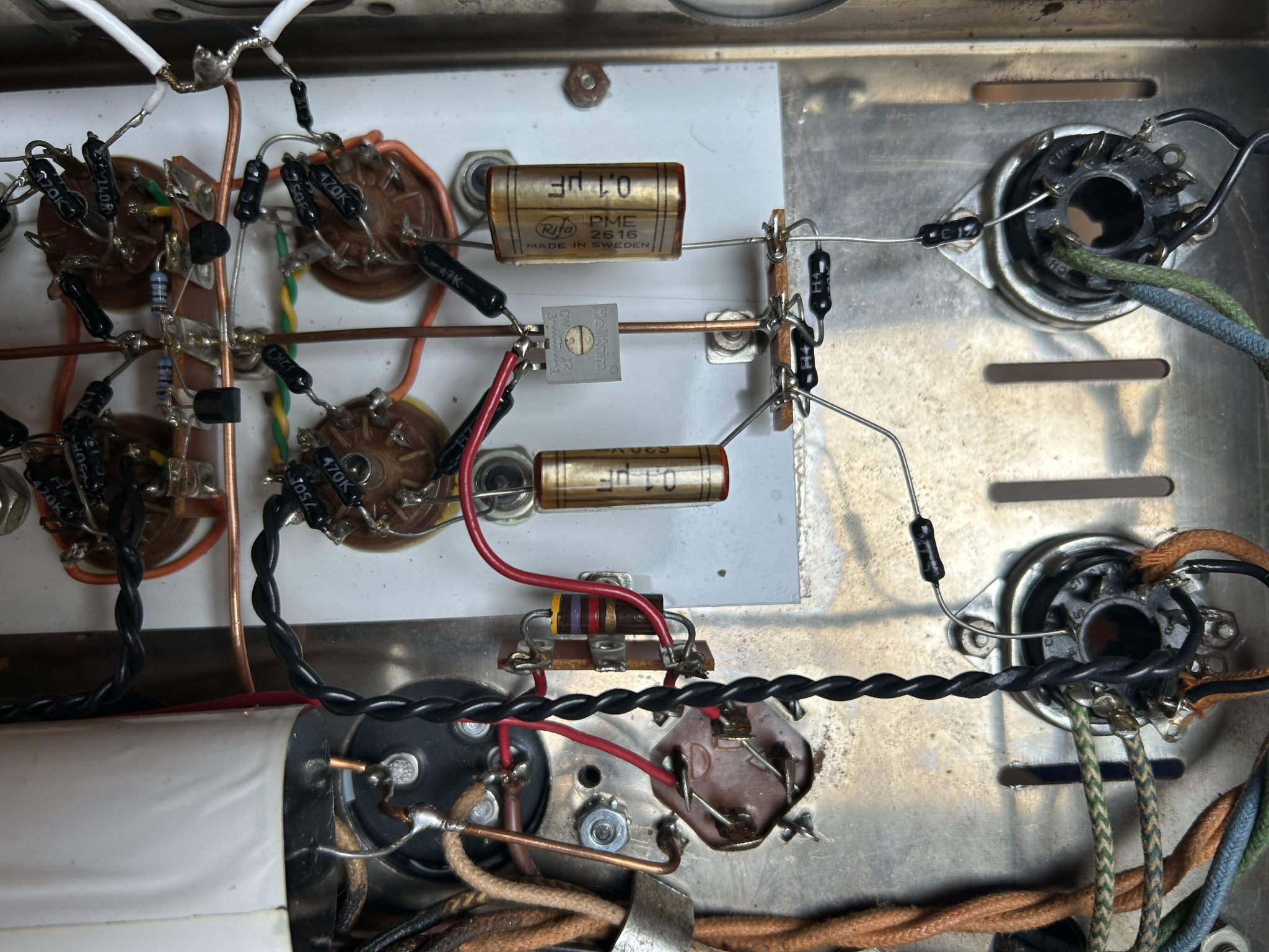

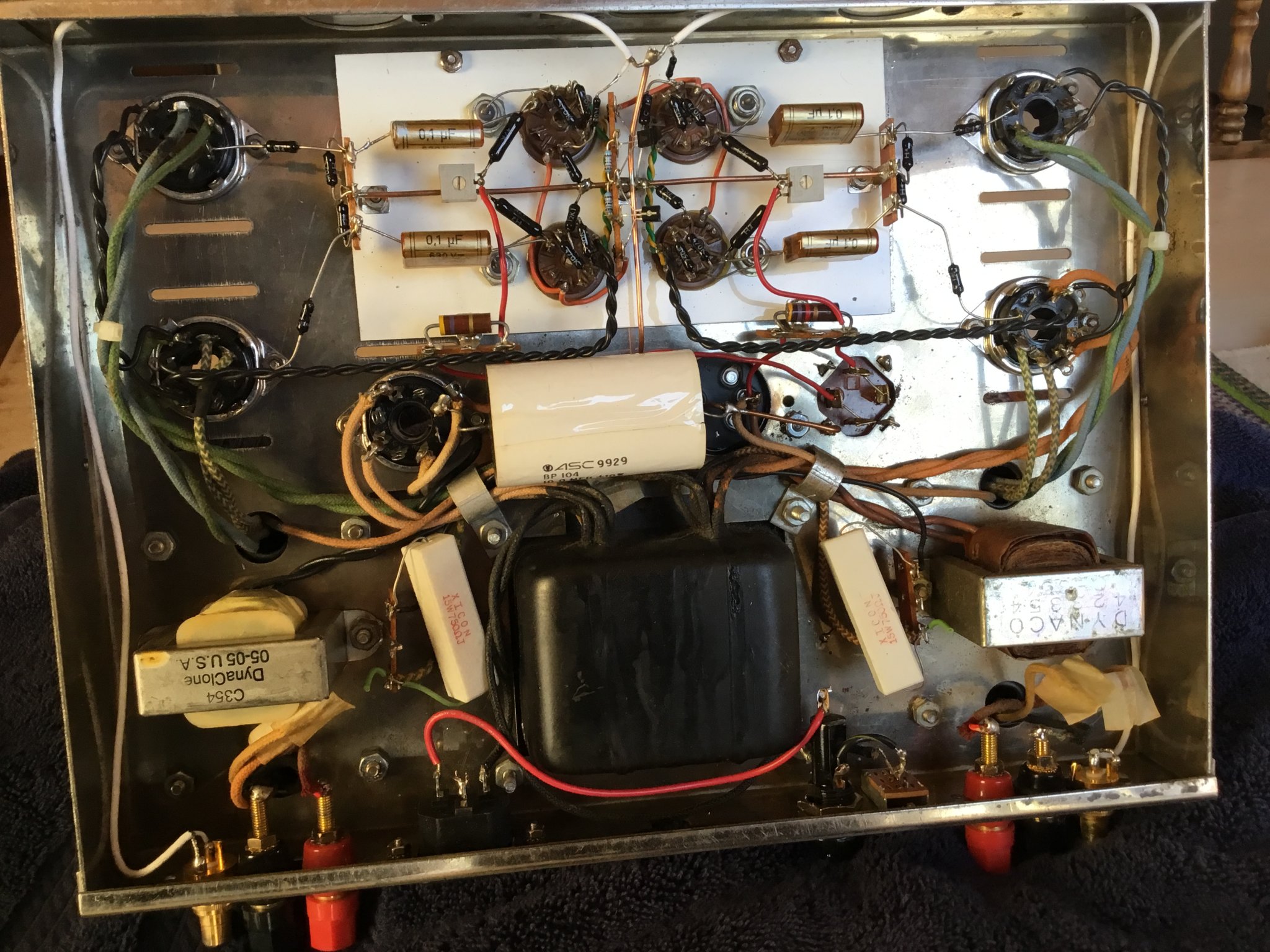

I have an audio amp a friend brought me in hopes I could help him. The amp has 6B4 out put tubes that appear to be run in paralle. I have no idea what the preamp tubes are, I am hoping some one will recognize the circuit.
Here are some pics. TIA

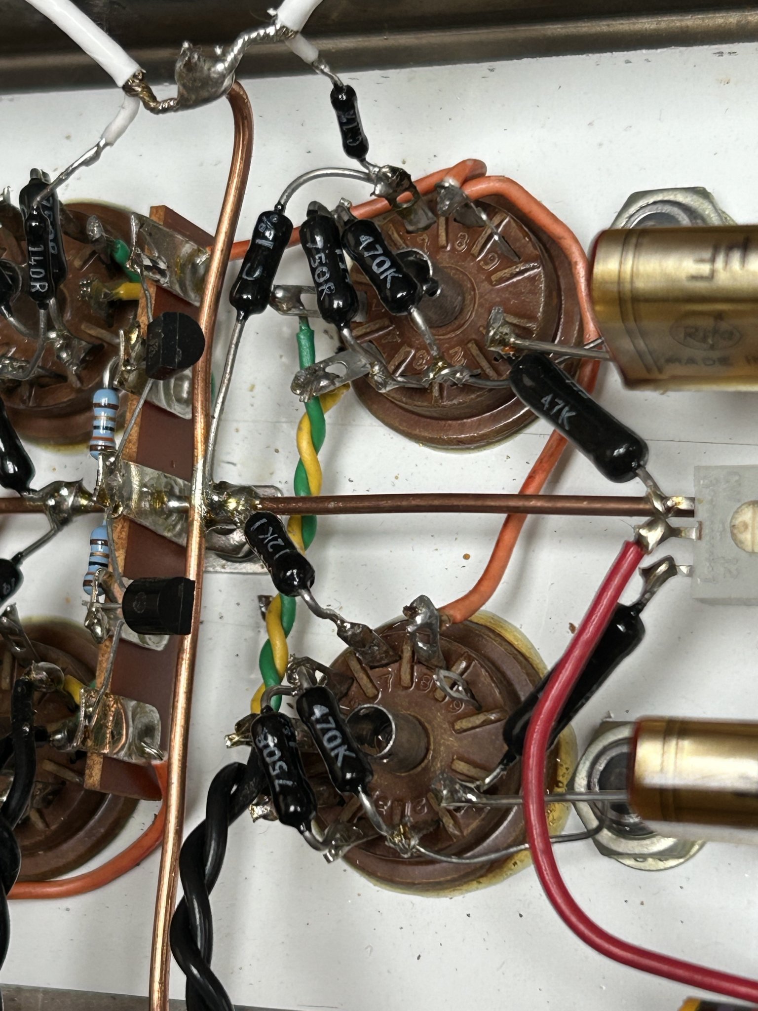

Next. It may have missing wires from the bottom tube as there is no input to it.
I need to say your point-to-point workmanship is very nice.
But yeah maybe ditch the Rifas, especially if they are vintage. They are famous for the wrong reasons...
It's pushpull. This looks like cathode bias output stage and it also looks like in addition to 6B4G you can also run EL34/6CA7 UL connected in it. Long ago I heard a very, very similar amplifier with 6B4G driving a pair of Quad ESL speakers. I believe that one was equipped with 6DJ8 or 7308. Sounded very good. Charlie King built one or more of these in the late 1990s.
Be careful not to put a lot of stress on the leads of those Holco resistors, I had a lot of problems with ones that went noisy, they are otherwise fine resistors. (High voltages can cause noise problems too - if that is a problem replacing the 47K plate resistors should fix it. The RIFA caps probably ought to be replaced.

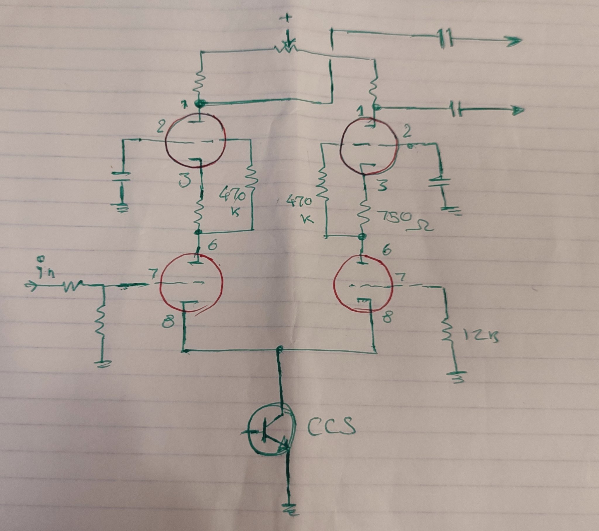

This may be one of those those builds, this amp was supposed to have been built by Mr King. We looked all over to find a schematic to figure out exactly what it is, but alas found nothing. So I decided to draw the circuit but lacked the knowledge to figure out the cascode split phase inverter. That’s when I turned to this fine group of DIY’ers for help.
I am unsure if this amplifier worked when he bought it, but it end up with me not working. Now I believe I can recreate the schematic and get down to trouble shooting it.

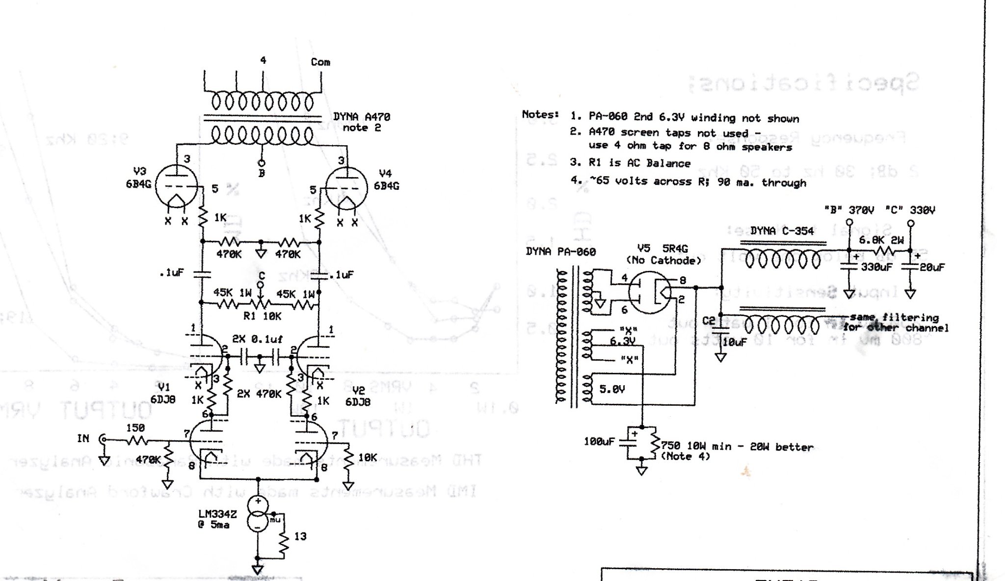

Yeah, the mystery tube is a 6DJ8/6922. Circuit is the Hedge differential cascode originally described in Wireless World in the mid 50's. Showed up in a few Stereo 70 front end board re-do's. One of Harvey Rosenberg's companies, Tube God maybe, made a PC board for it. Idea started when I heard directly heated triodes for the first time. Was enthralled! Acquired a 2A3 single-ended, DIY, stereo amp and loved it. Wanted a bit more power and decided, as I had a few Stereo 70 chasses lying around, to try and build up a PP version using as much of the 70 casework and iron as possible. Settled on 6B4's and got the output stage working, experimenting with ways to lower the B+ to not blow up the tube. Ended up with a choke input filter and actually used the small cap at it's input to "tune" the B+ to the voltage shown.

I was hoping to get some help with amp and it looks like we were able to close the circle back to the builder. I am a local tech who just piddles with these things and a friend brought this to me about a year ago and I gave up on it then. Here lately I ask him to bring it back and I’d make another run at it.
I drew the schematic out yesterday and my lord if Stellavox didn’t show up with his original schematic. Believe it or not we’re on vacation and I brought the chassis with me to study the chassis and to see if I could make any progress on it. Bingo!!!!!
Thx for all the help gentlemen.
