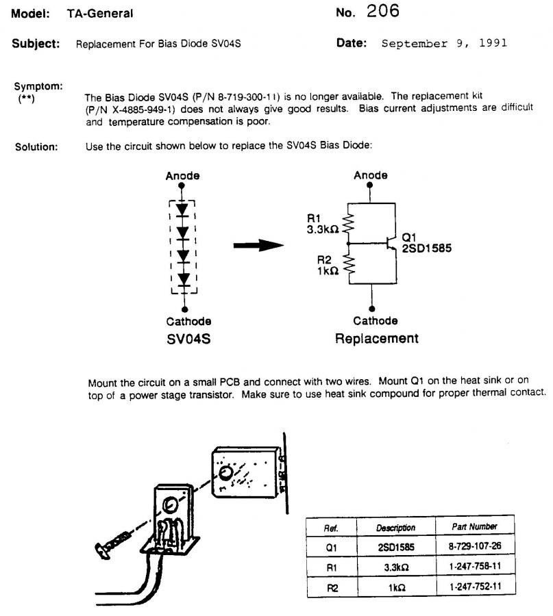

Another option might be in the attachment. Not sure if it had the same voltage drop. Used it for a sony long time ago. Maybe someone with more knowledge can tell whether it is applicable? (Used BC550 instead of 2sd1585, got this info at audiokarma i guess)

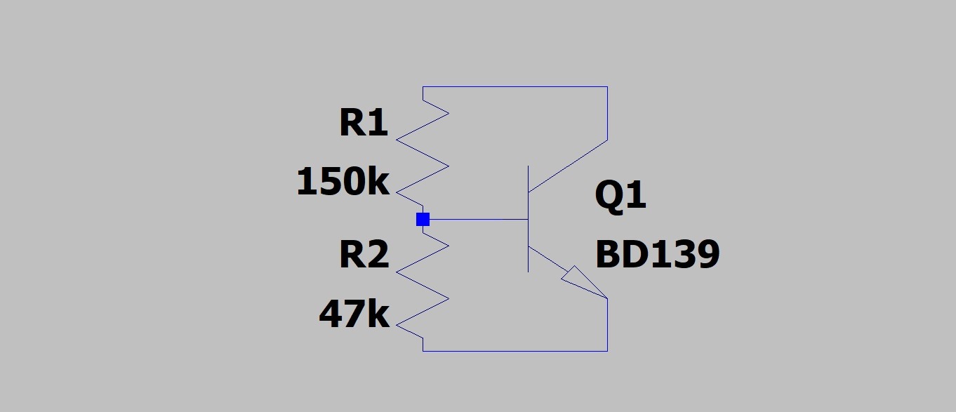

Forgive me for being in Mcgyver mode, , but I am just curious if this would work:
With the resistor values shown, voltage drop would be about 2.5V, at 150uA that is, and one of the two can be adjusted for desired Vf. You could bolt the transistor to the heatsink, but would this be heat sensitive enough I don't know..

@gijser : I can easily test your schedule. I really enjoy soldering that together and have those components in stock. This BD139 will fit perfectly at the heatsink with thermal pad in between. Unfortunately I don't understand the calculations, I just don't have enough knowledge for that.
Me neither, I just know that increasing R2 vs R1 will lower the voltage drop, and decreasing will do the opposite. Also, the voltage drop varies with the amount of current that flows through the circuit, but that is also the case with a diode string.
I tried this in a simulator, and it worked there...

With 5 miliamps, to get 2.518V drop from the 'rubber diode' circuit I posted above, the value for R1 should be 4.7k and R2 1.65k.

The trick of the Vbe multiplier is that the base current Ib does not pull to much current from the current through the base-emitter resistor Irbe, while at the same time this current approximates the current through the collector-base resistor Ircb, which should not pull to much current from the actual collector current Ic.
In a mathematical form: Ib << Irbe << Ic.
Knowing that Ic = β * Ib, the optimum can be found by: Irbe = Ic / √β (the 'sweet spot')
Thus, Rbe ≈ Vbe / ( Ic / √β): Rbe = √β*Vbe / Ic
This is viable for any application of the Vbe multiplier.

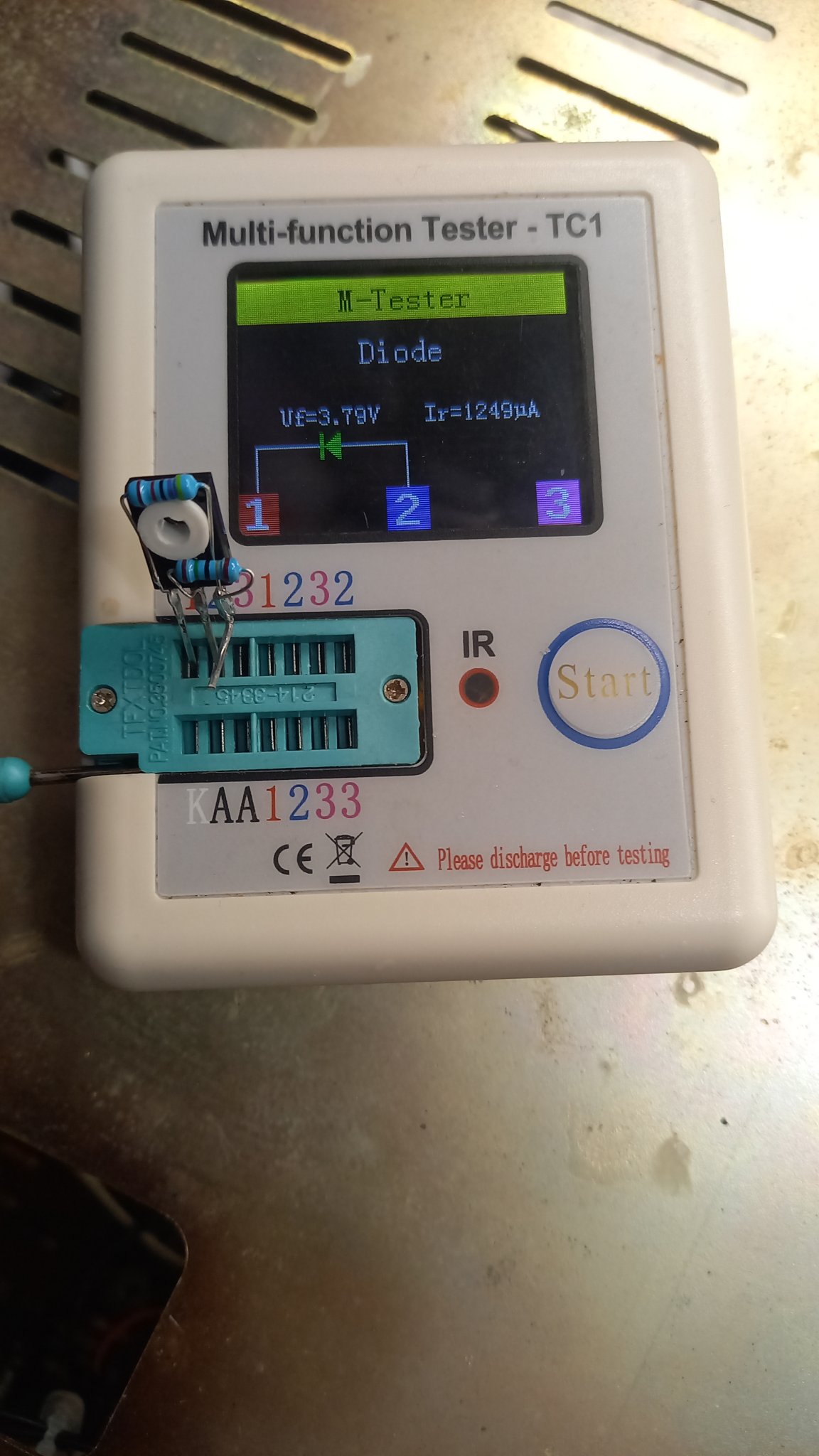

I just liked to build this with the components in schematic, but results seem quite different. See attachment 😉

Also, no matter if you end up with 3 or 4 x 1N4148, place them afterwords on the heatsink and cover them with thermal paste,
to get them to function as close as the originals.
Or get a dual diode in TO-220. You can get them with the diodes connected in series. Then just bolt the TO-220 to the heat sink with appropriate mounting hardware/pads and/or thermal goop and you'll be set.
