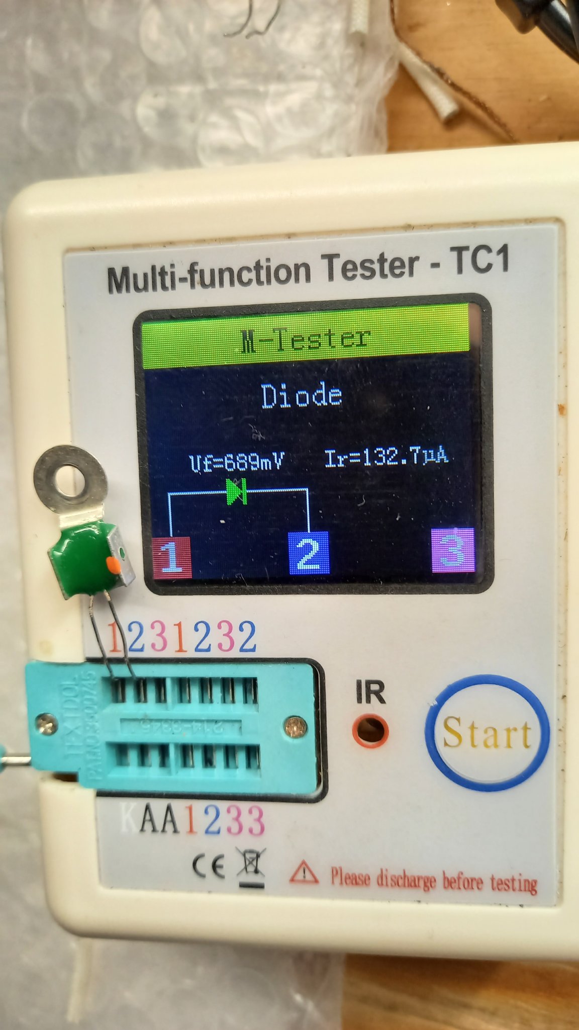

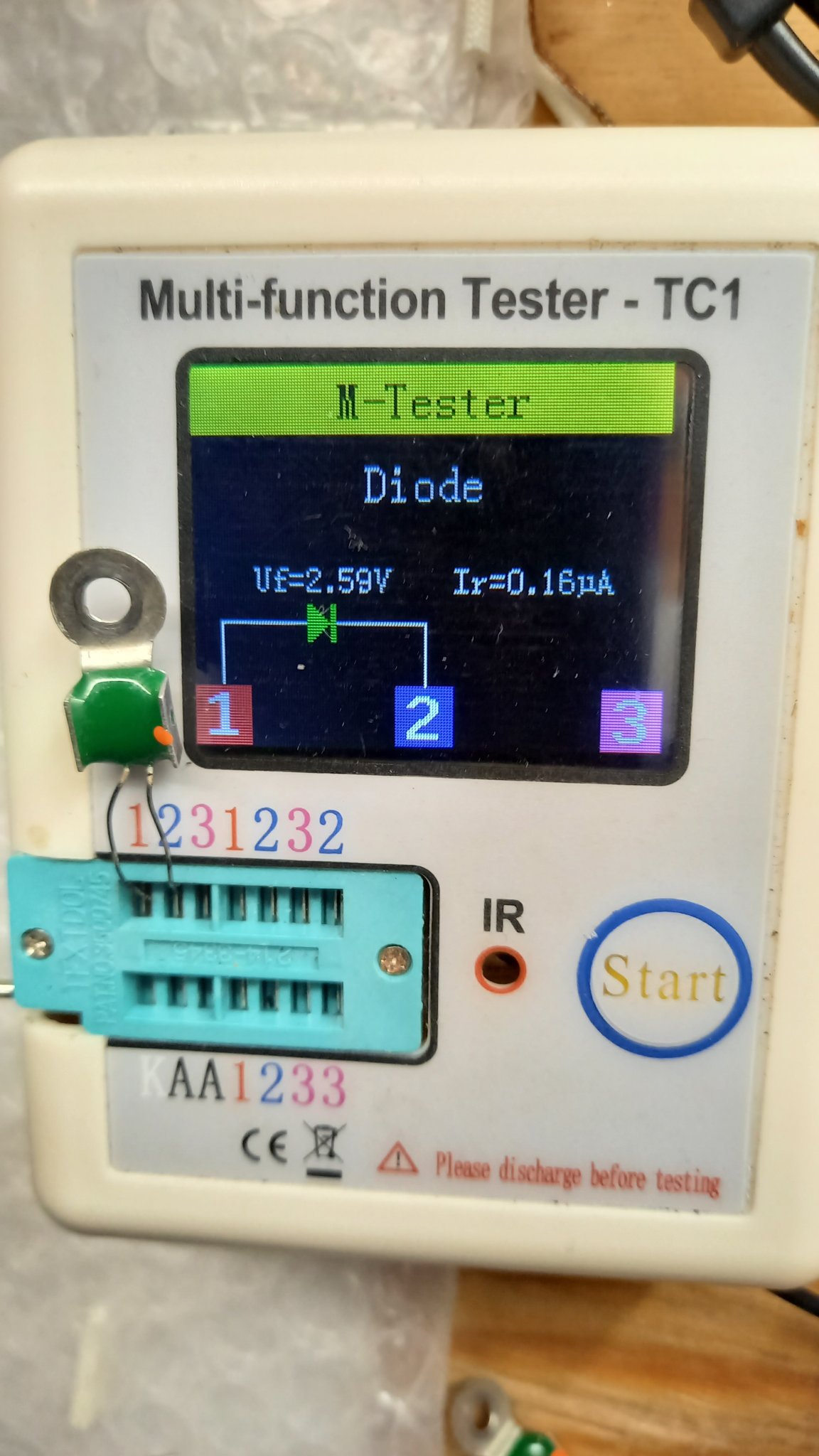

I just liked to build this with the components in schematic, but results seem quite different.

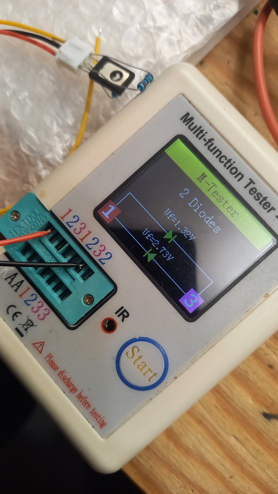

The schematic in post #24 works with about 150uA current, but if more current is running you need different resistors. Your tester runs 1250uA through the circuit, so you get a different result. With higher currents, you need to use lower value resistors, like in post #31.
This is why I wanted to know how much current runs in your diode string when the amp is working. I am sorry you fried a transistor, I hope it was not caused by just measuring the current.. but I can't see why.
The 3.8v drop you show in post#39 is actually to be expected when running 1250uA with 150k and 47k, I get a similar value from the simulator.
Thanks citizen124032 for posting the formulas. I think suitable values for the resistors in this case, assuming a few miliamps of current, would be 4.7k for R1 and about 1650 ohms for R2.

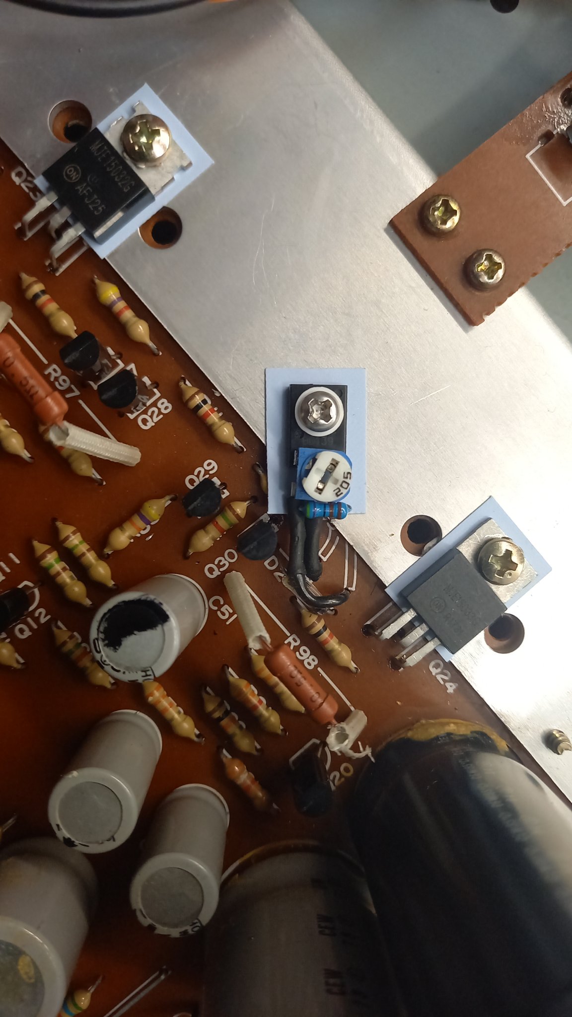

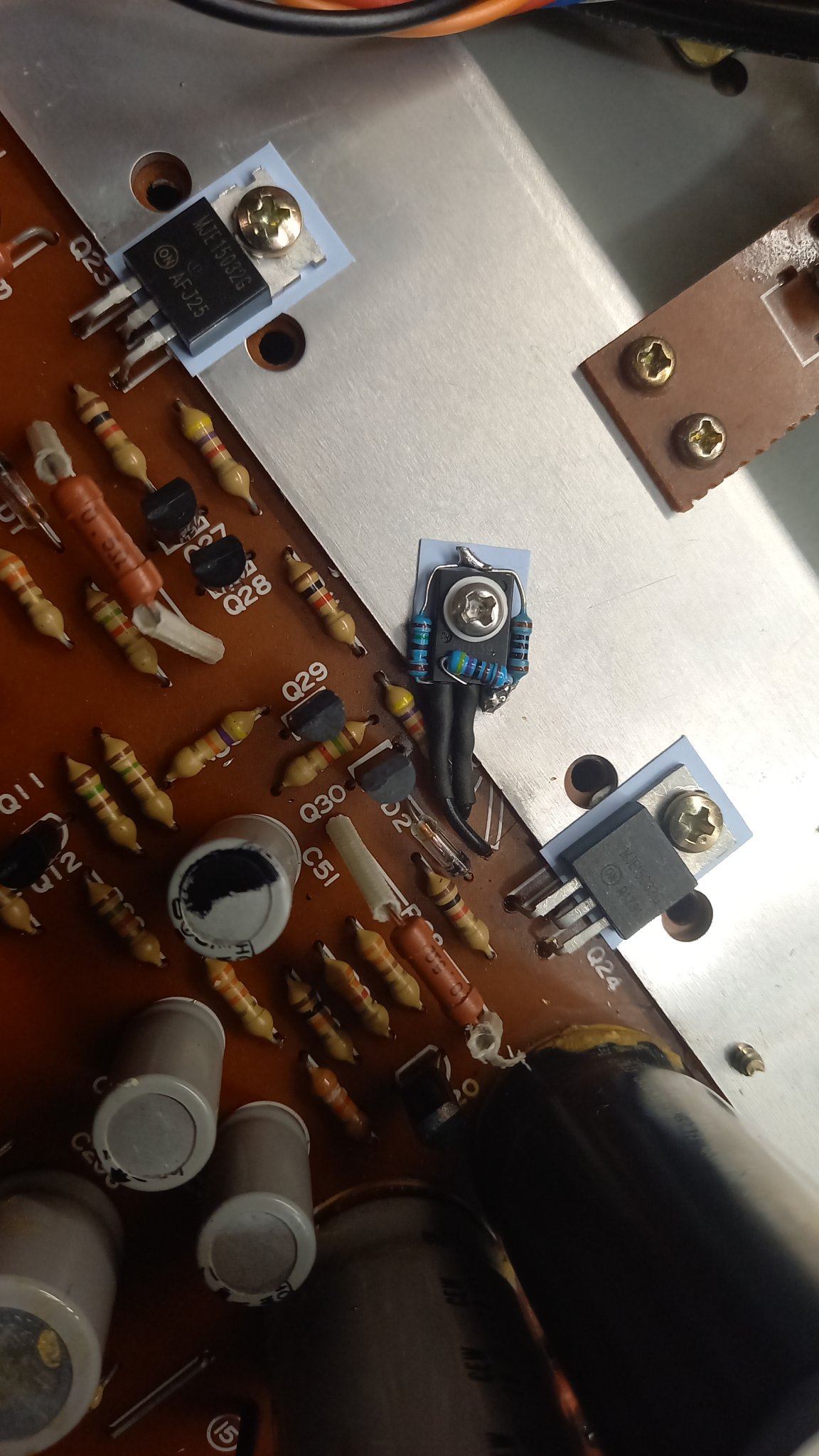

BD139 and 4.7k for R1 / 1.5k for R2. See test attachment with multimeter. Think i'm going to solder this one, seems to get closer and in circuit it's less current.
(I'll replace the output transistor. Not sure why it shortend. Happens often when I'm messing around 😆 )

I placed a 100 ohm resistor in series + the 1.5k resistor for R2. It seems to be working! Tested the unit and the base voltage of the output transistors has now lowered from 0.68V to 0.65V. Still a bit high, but there is result 😀
If i raise the resistance of R2 a bit more to 1650 ohms as you suggested , will it decrease the base voltage of the output resistors? (I really don't get the math etc. etc) Thank you!

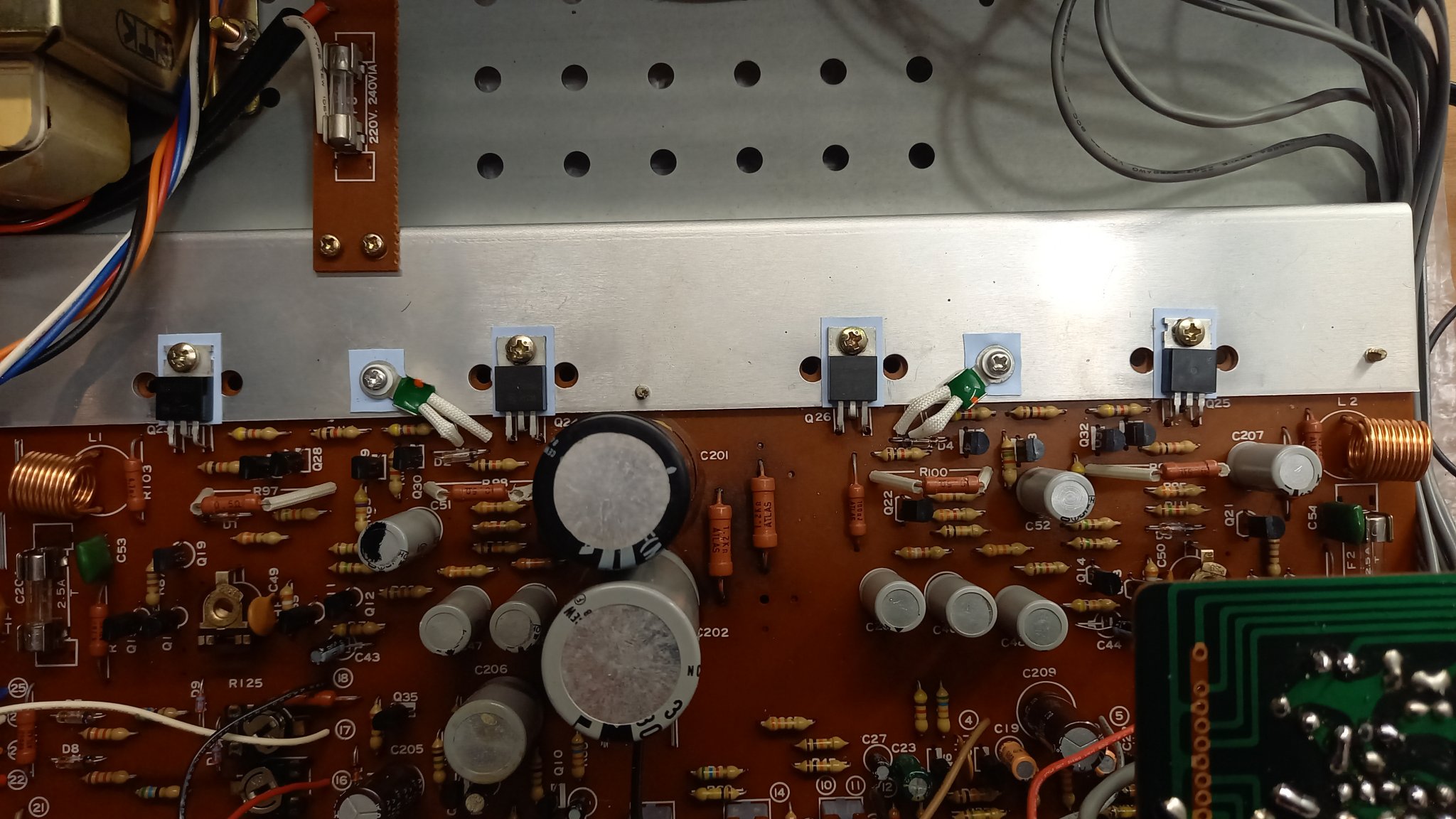

Yes, if you raise R2 it decreases the forward voltage of the circuit. Great that it seems to work in practice! now I hope it tracks the temperature well enough, we don't want any more fried transistors..
Also fun to see how the elegant greek math approach gives about the same results for the R values.
And I have to say, th BD139 with the resistors soldered around it, it looks quite professional!
Reactions: Ingy76
I love developing these kinds of ideas. That's why it's nice that these forums exist. People with the knowledge and I have handy hands! I'm going to look for 150 ohm resistors for R2. Must have them somewhere. Yesterday I only had 100 ohms available. Thanks for all the contributions!🙏
