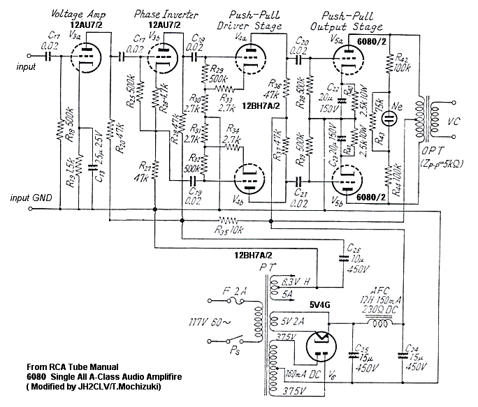

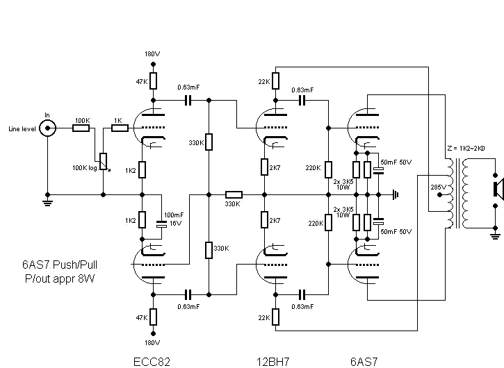

Maybe something like this, except using 12BH7 tubes in place of the 12AU7 and 6SN7.
https://www.angelfire.com/electronic/funwithtubes/Triode_Power_Amplifier.html
6.5% distortion at 12.5 Watts, 4% at 5 Watts. The 400V B+ exceeds the 250V B+ max 6080 tube ratings however?
The winding voltages on the central power xfmr should give some clues.
It seems that these mu 2 tubes are difficult to get good low distortion results, partly from the difficult driver stage and partly from the non-linear 6080.
JHStewart9 has a P-P 6080 amplifier design using a bootstrapped 6SN7 driver stage, 400V B+, and fewer tubes. (not requiring a separate 500V B++ for the driver stage as in the above)
https://www.diyaudio.com/community/threads/novel-driver-for-6as7.384337/#post-6974040
0.72% dist at 10 Watt

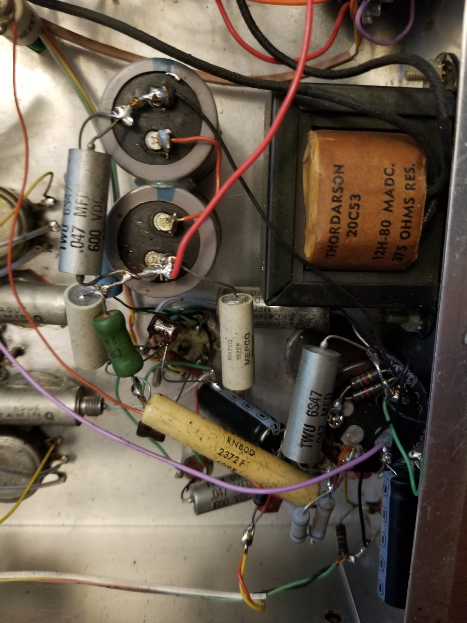

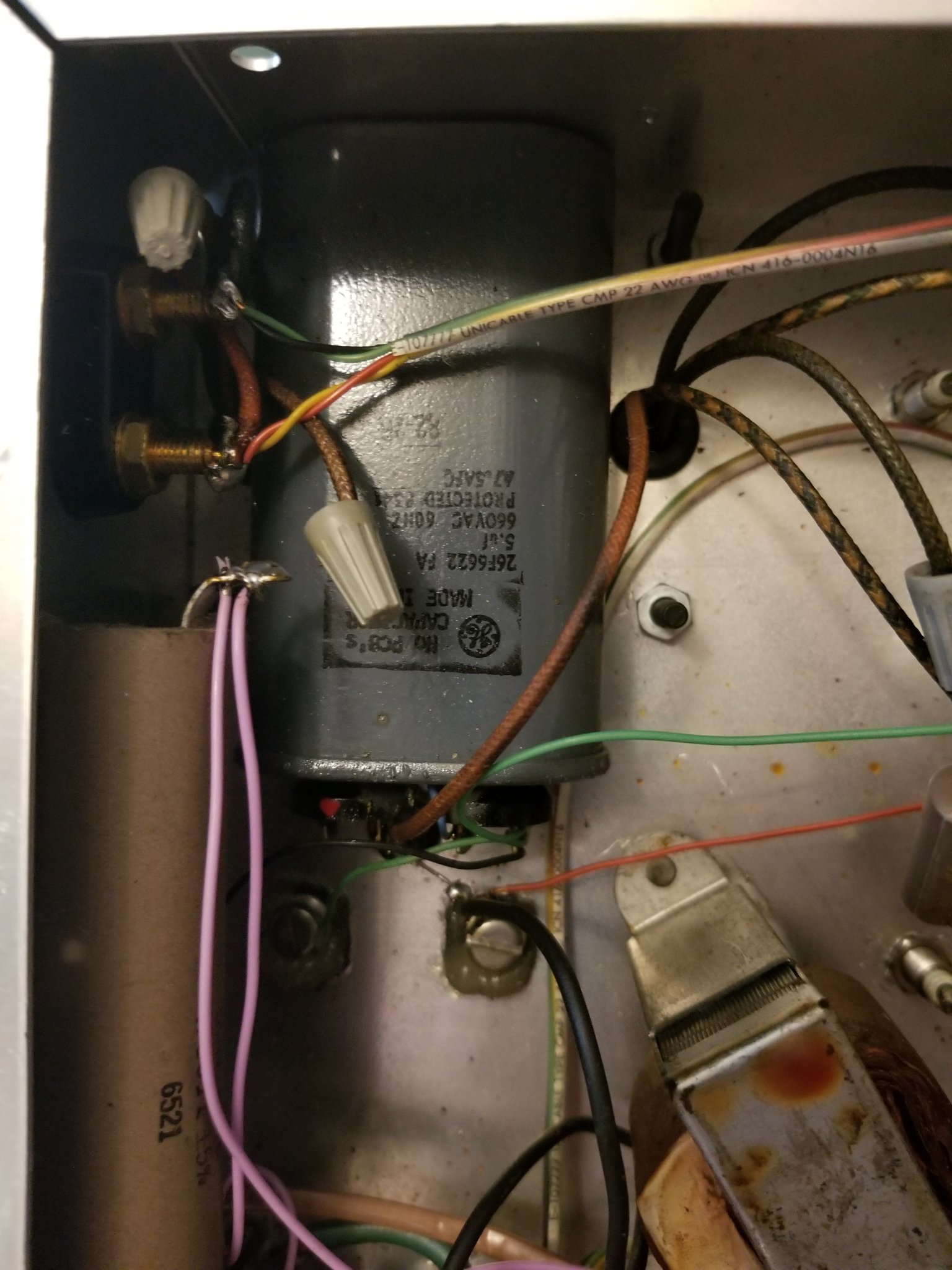

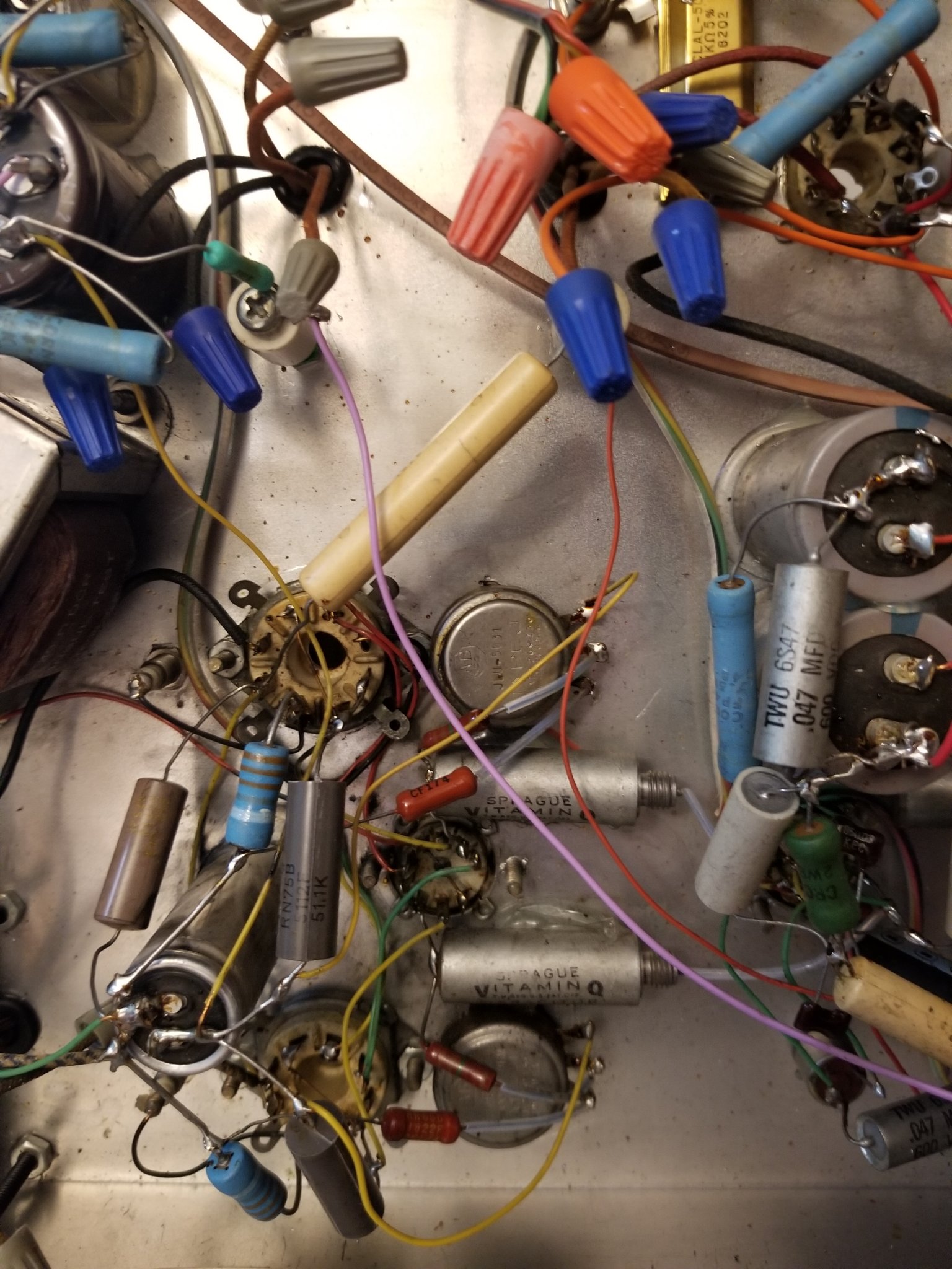

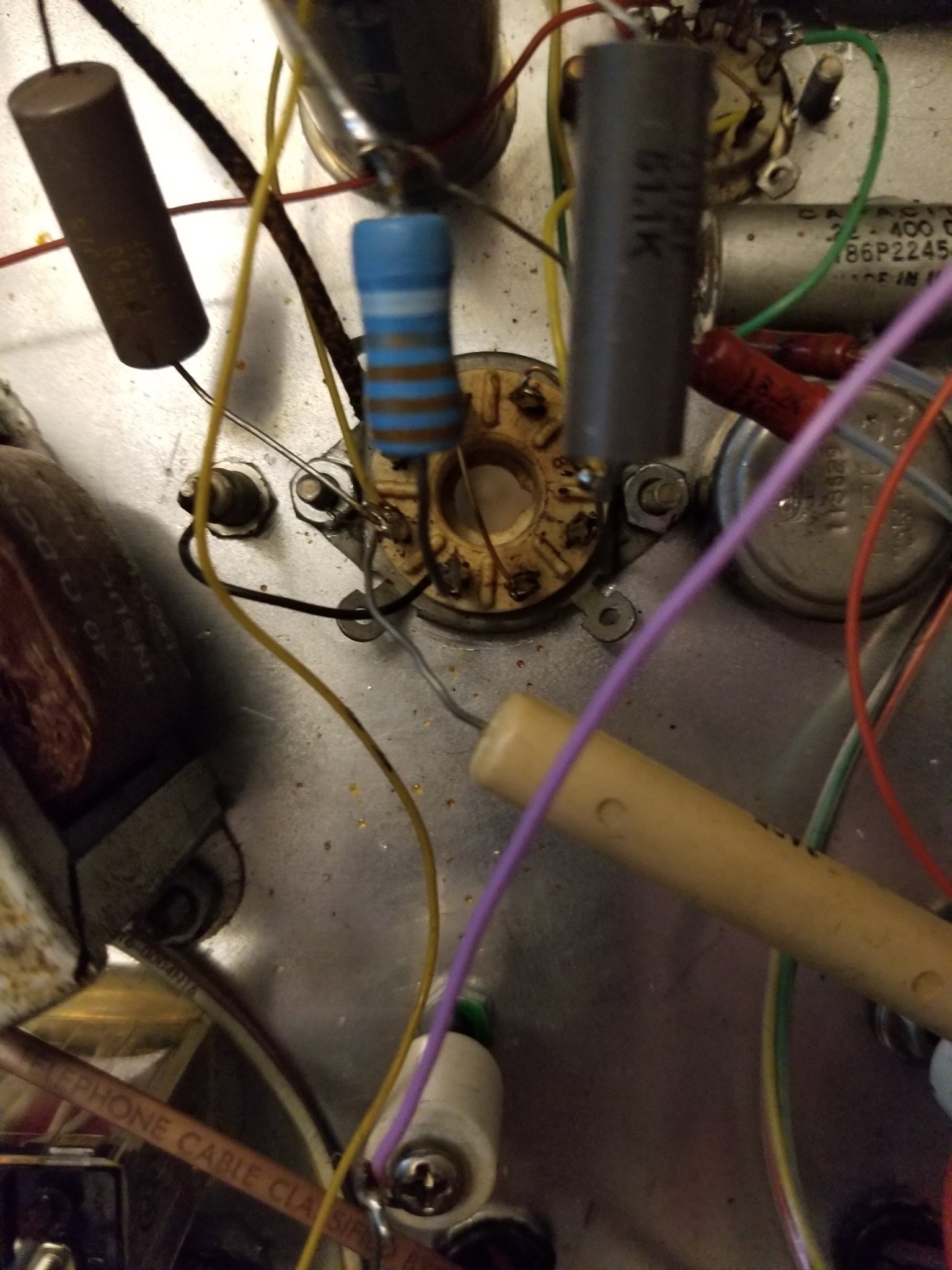

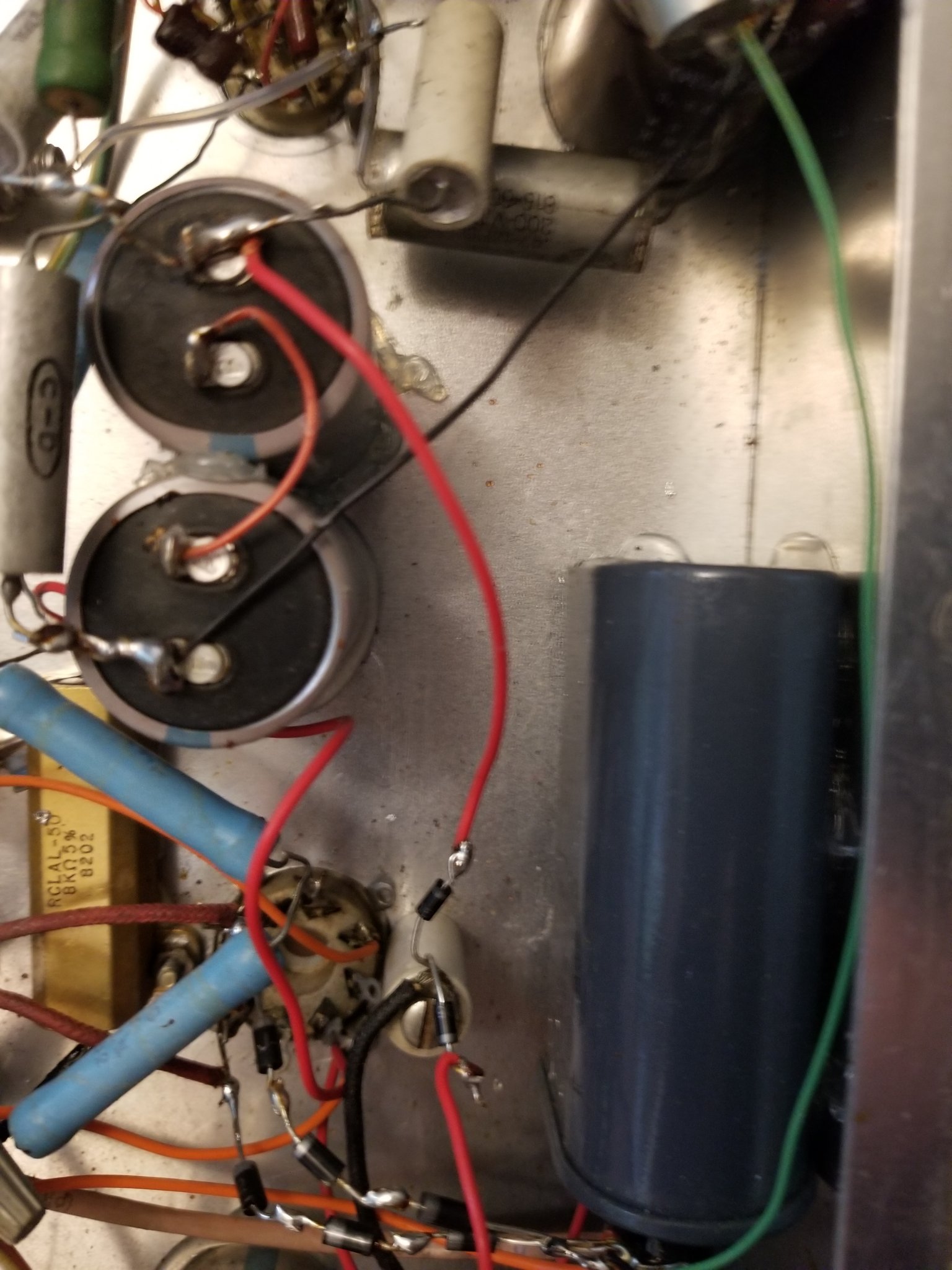

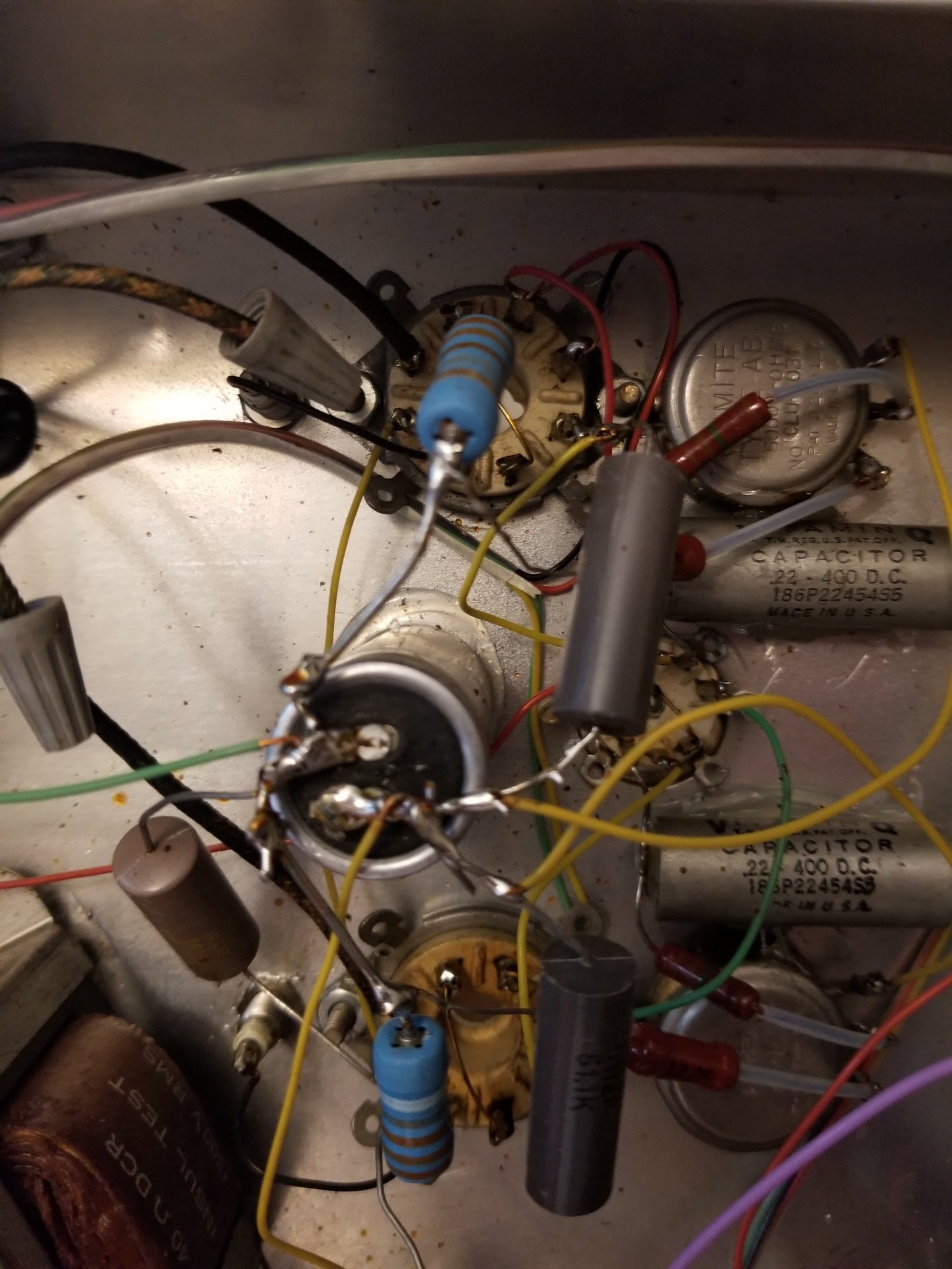

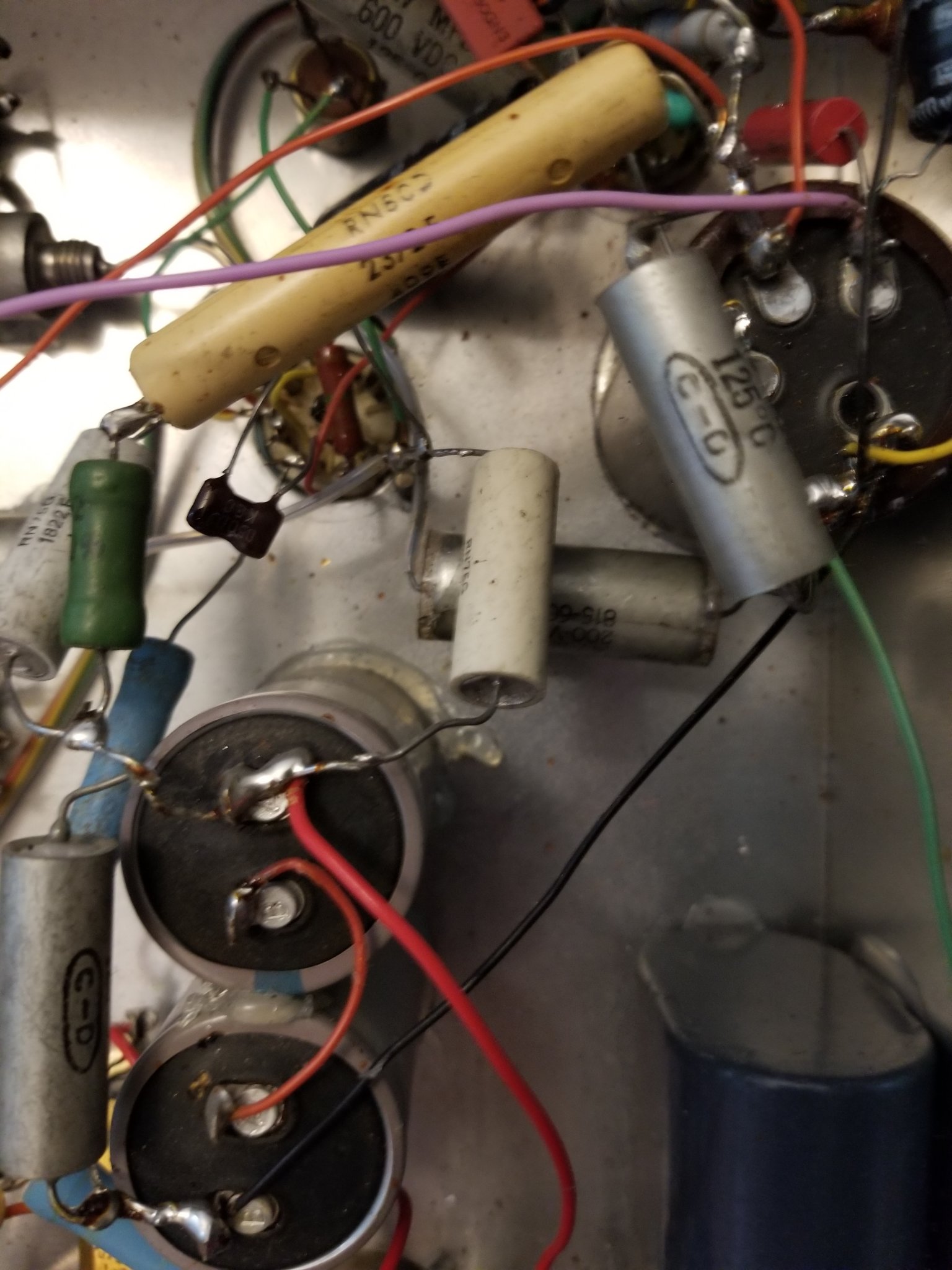

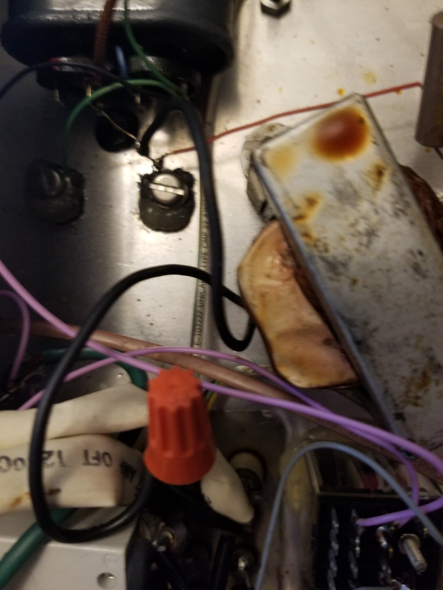

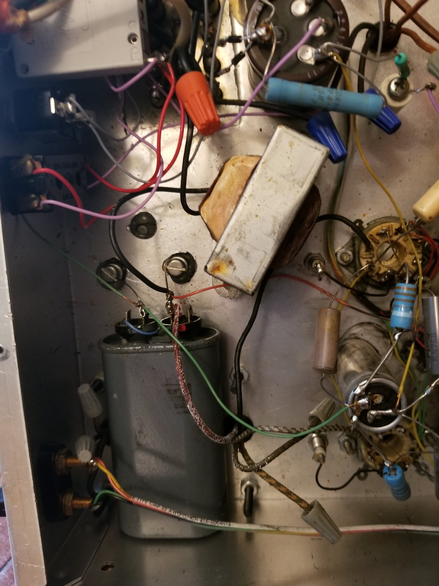

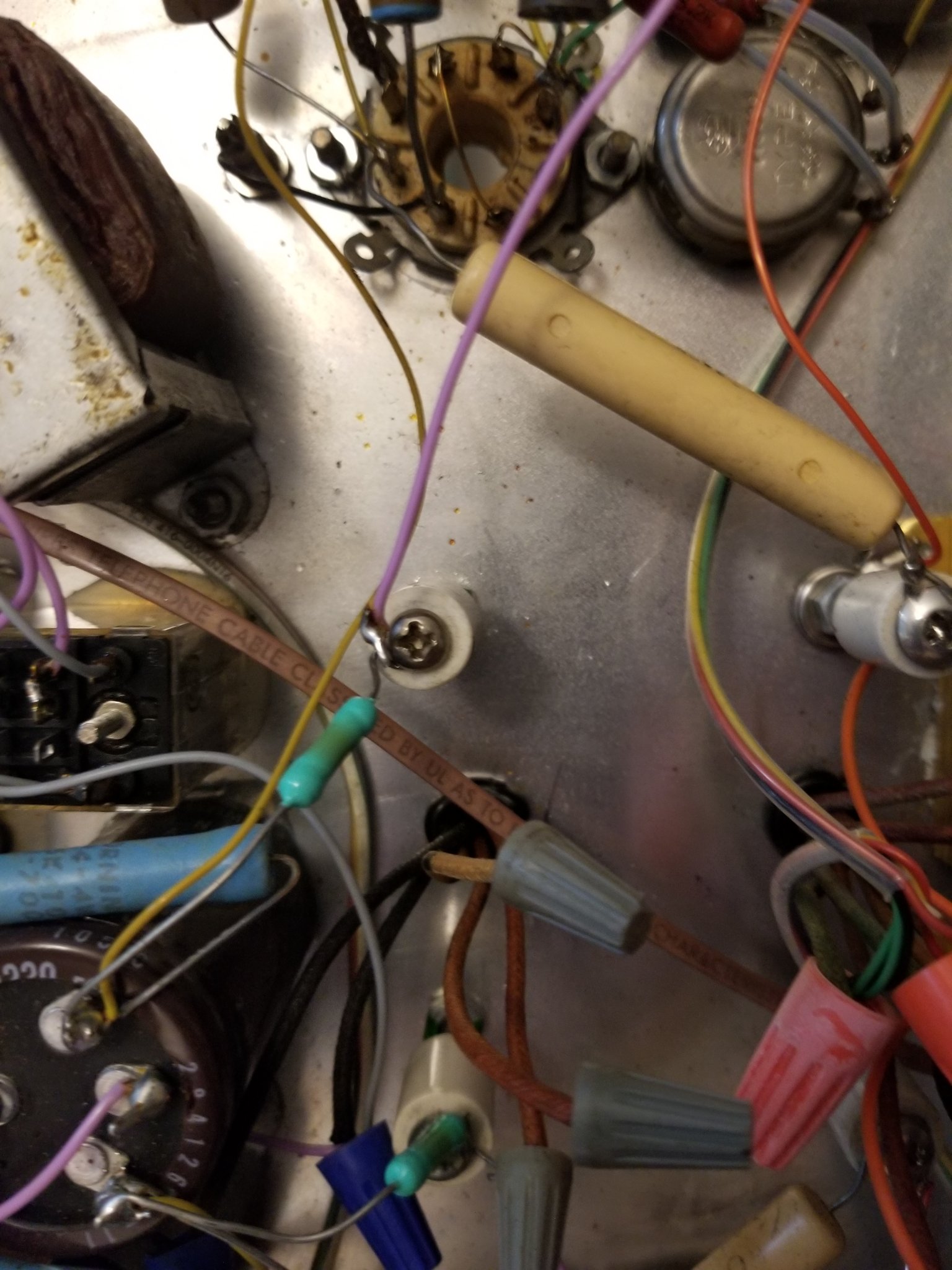

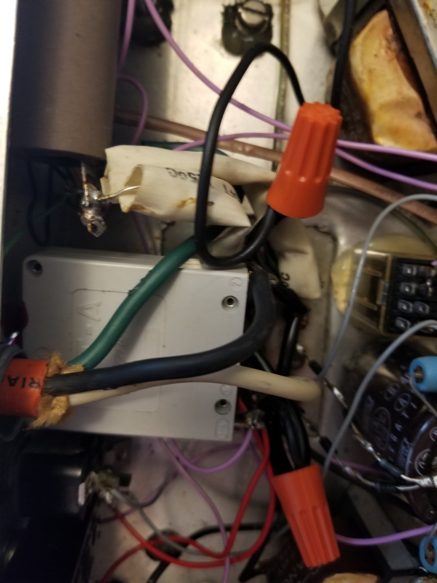

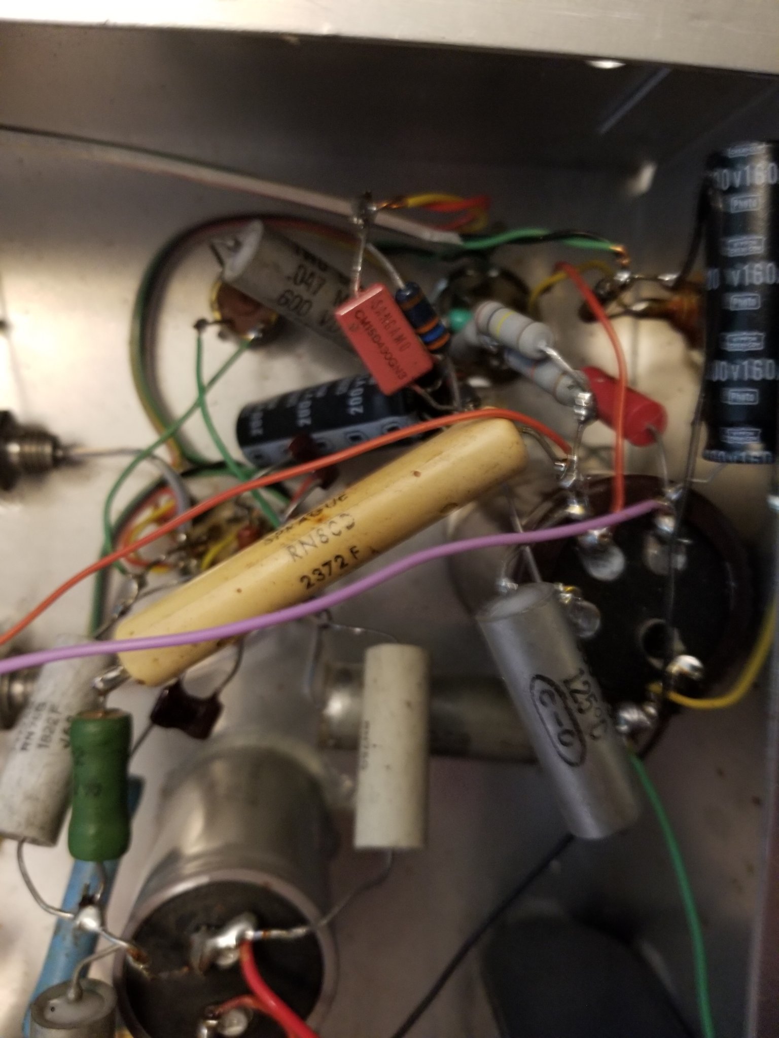

Here are the pictures. At this point, I can either start disassembling and documenting the amplifier, or I can sell this to someone with a lot more time and knowledge of electrical engineering.

It looks like it was a prototype with many changed connections and updates as the circuit was refined. Personally, I would rewire it and clean up the layout and connections, remove wire nuts and hanging wires, and components. I would remove the old electrolytic capacitors and update them to MKP4.
