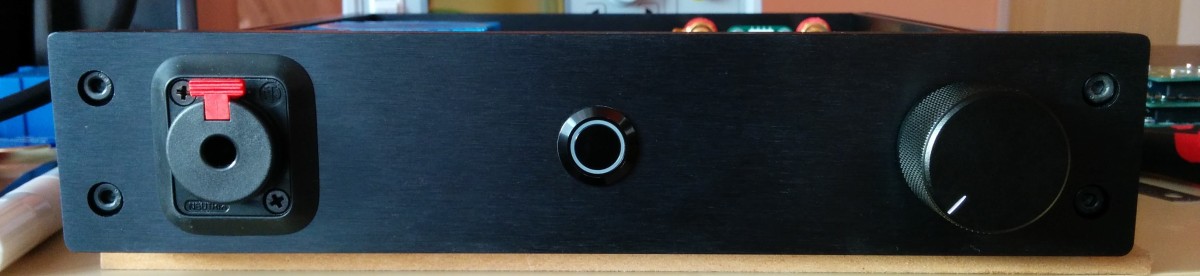

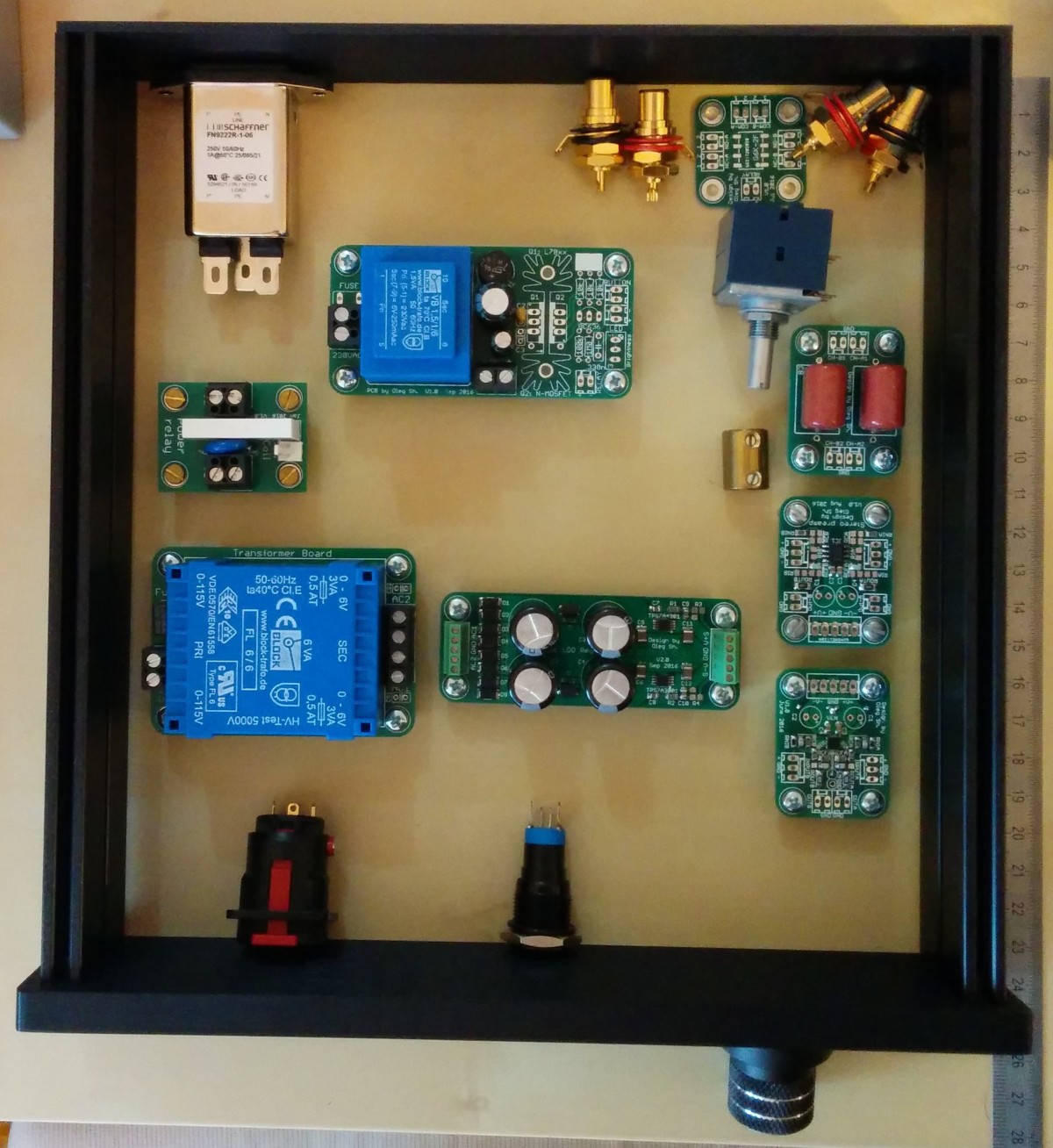

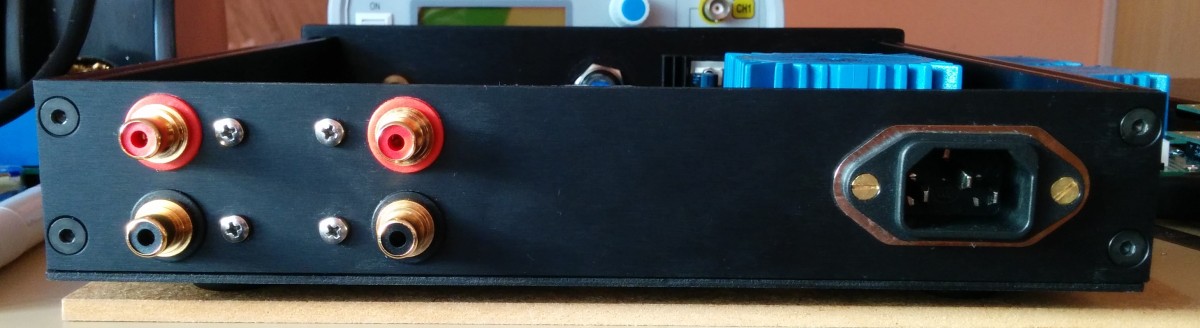

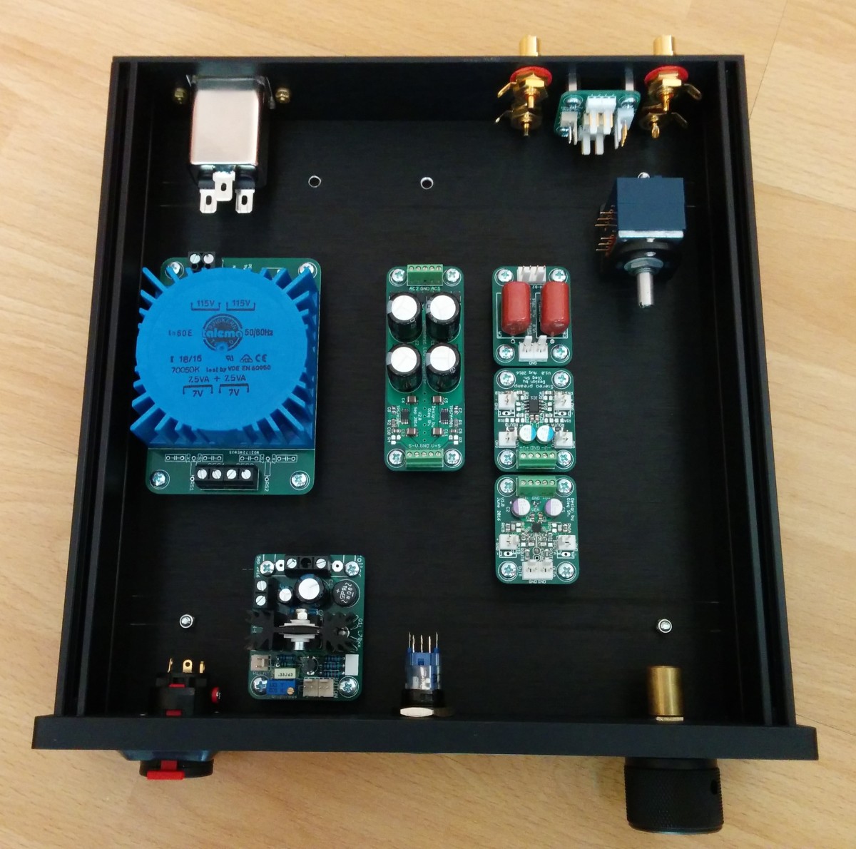

I am slowly putting together various bits which should become a stand alone head-amp one day. Attached is the preliminary layout inside of chassis. The ON/OFF will be operated via the push button with standby circuit. It will automatically switch the input to "path through" when OFF and will connect it to the volume pot when ON. It will also turn ON/OFF the head amp's power supply by a relay.
I have finally done all the drilling and mounting of parts inside of chassis. Now waiting for the molex crimping tool to complete the cabling. It should be in my hands within a week. Also bought myself USB audio interface (Focusrite Scarlett 2i2 2nd gen) for quick measurements, new digital soldering station and a lot of drilling hardware for the large diameter holes. I must say it becomes progressively more expensive hobby when one has to buy all the tools for it...
