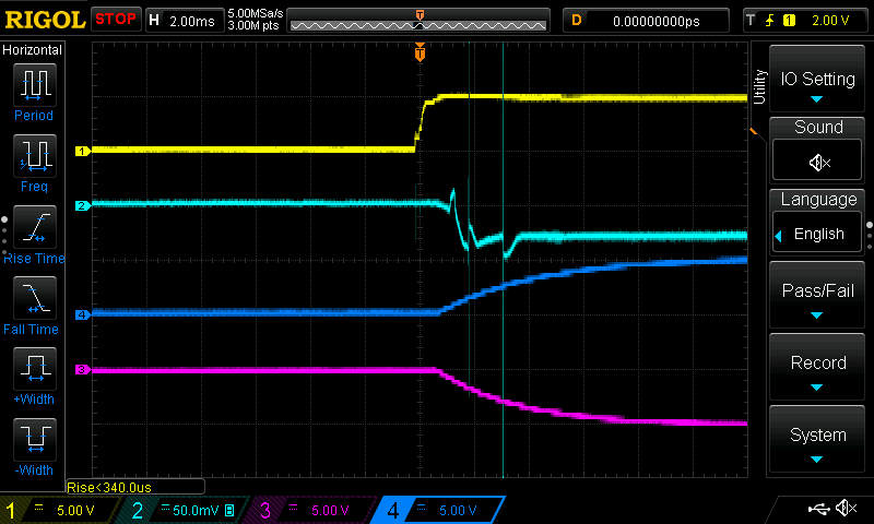

Just learned how to do a single-shot measurements using all four channels of my DS1054Z. The transient is there. When unmuting there is a sudden DC offset on the output of around -30mVDC which decays to zero within approx. half a second. Interestingly that the mute releases the OPA1622's output when positive rail reaches +4VDC level which was exactly the design target. Despite the unmute delay there is still a transient that I can not explain. If someone has an idea what can cause such behaviour please comment!
The legend for the waveforms:
CH1 (yellow): +5VDC input.
CH2 (light blue): headamp output.
CH3 (pink): negative regulated supply rail
CH4 (dark blue): positive regulated supply rail
Oleg

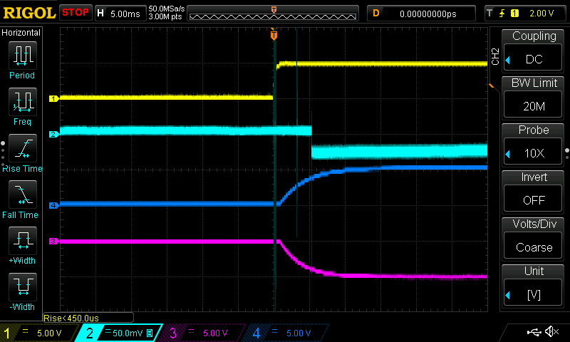

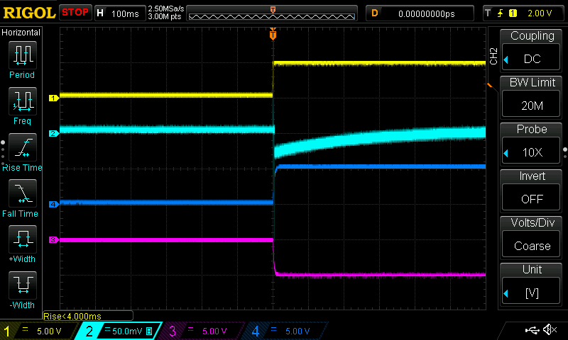

The turn-on transient comes from the OPA1642 (see attached). The offset comes from the OPA1642 output before the OPA1622 unmutes. Interestingly, the OPA1622 does well when unmuting and just passes the DC offset further to the load. Next I'll try to replace the OPA1642 with the new part and see if it helps. If it doesn't, I'll probably try it with the OPA2140 instead.
CH2 (light blue): OPA1642 output.
Oleg

Today I finally received the OPA2140 and tried it immediately in the headamp. The result is the same, the small pop is still there. I conclude that this family of op-amps simply has such a turn-on transient... or there is something else going on which I don't understand.
In principle it is possible to delay the unmute of OPA1622 further by changing D3 (LED) to a resistor and using a capacitor instead of R15. Since the internal impedance of the enable network of the OPA1622 is around 700k (see p.16 of the datasheet for details), resistor can probably be as high as 1M which in combination with 1u capacitor should give a long enough unmute delay.
Oleg
Just tried replacing the unmute circuit (LED + resistor) by an RC network using 1M resistor and 1uF ceramic capacitor. The turn-on pop was nearly gone (unmute delay was roughly 0.5 sec or less) but a much louder turn-off transient noise appeared. So I reverted everything back to original. I guess the only solution in this case is using a more sophisticated muting circuit controlling the relay at the output of the headamp. Since the turn-on pop is not so disturbing I do not plan to change this design. If somebody is interested in having a PCB, I have some left. PM for details.
