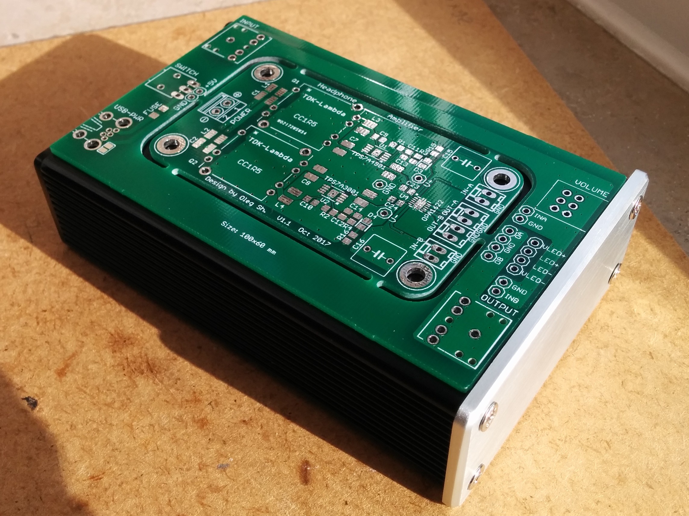

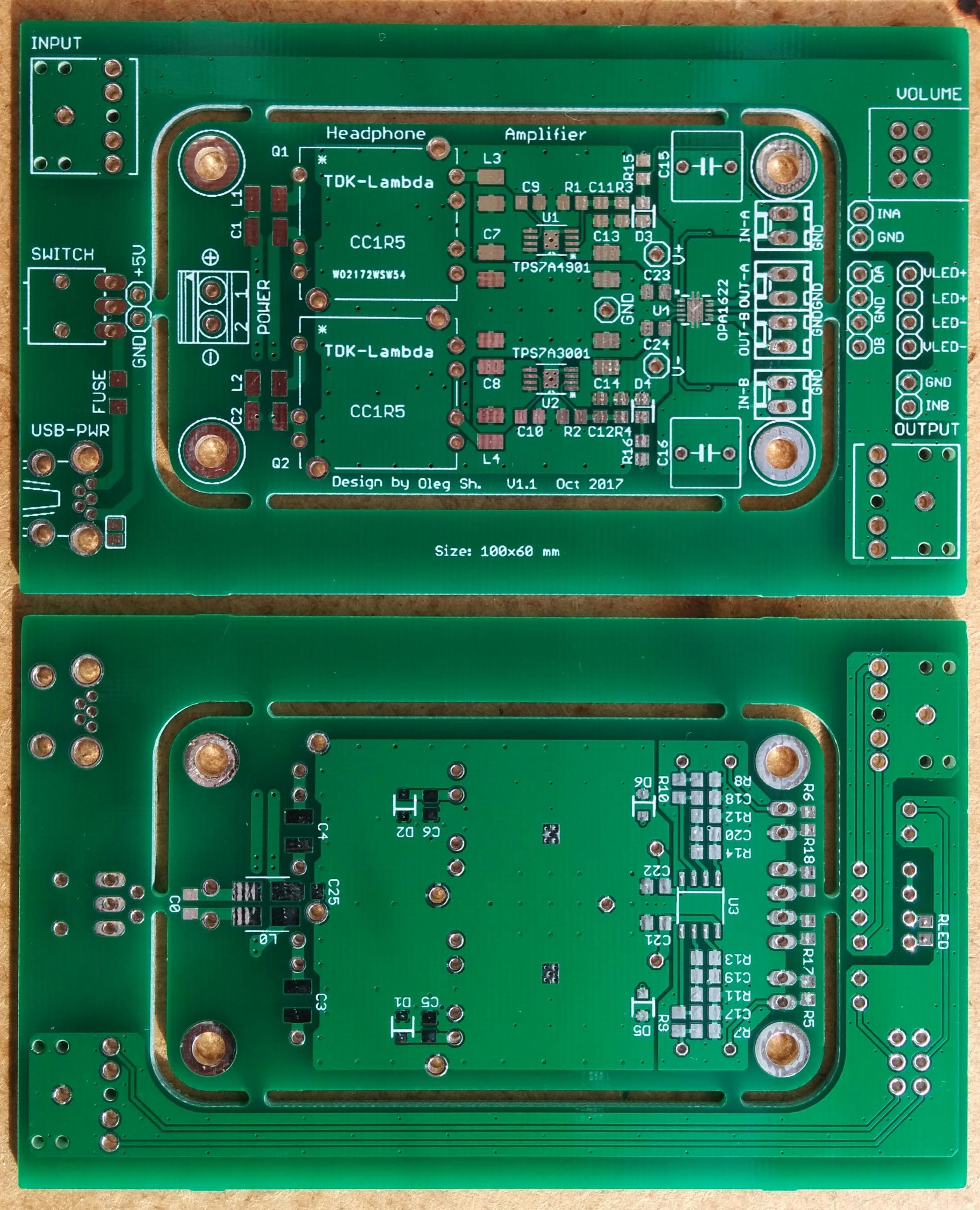

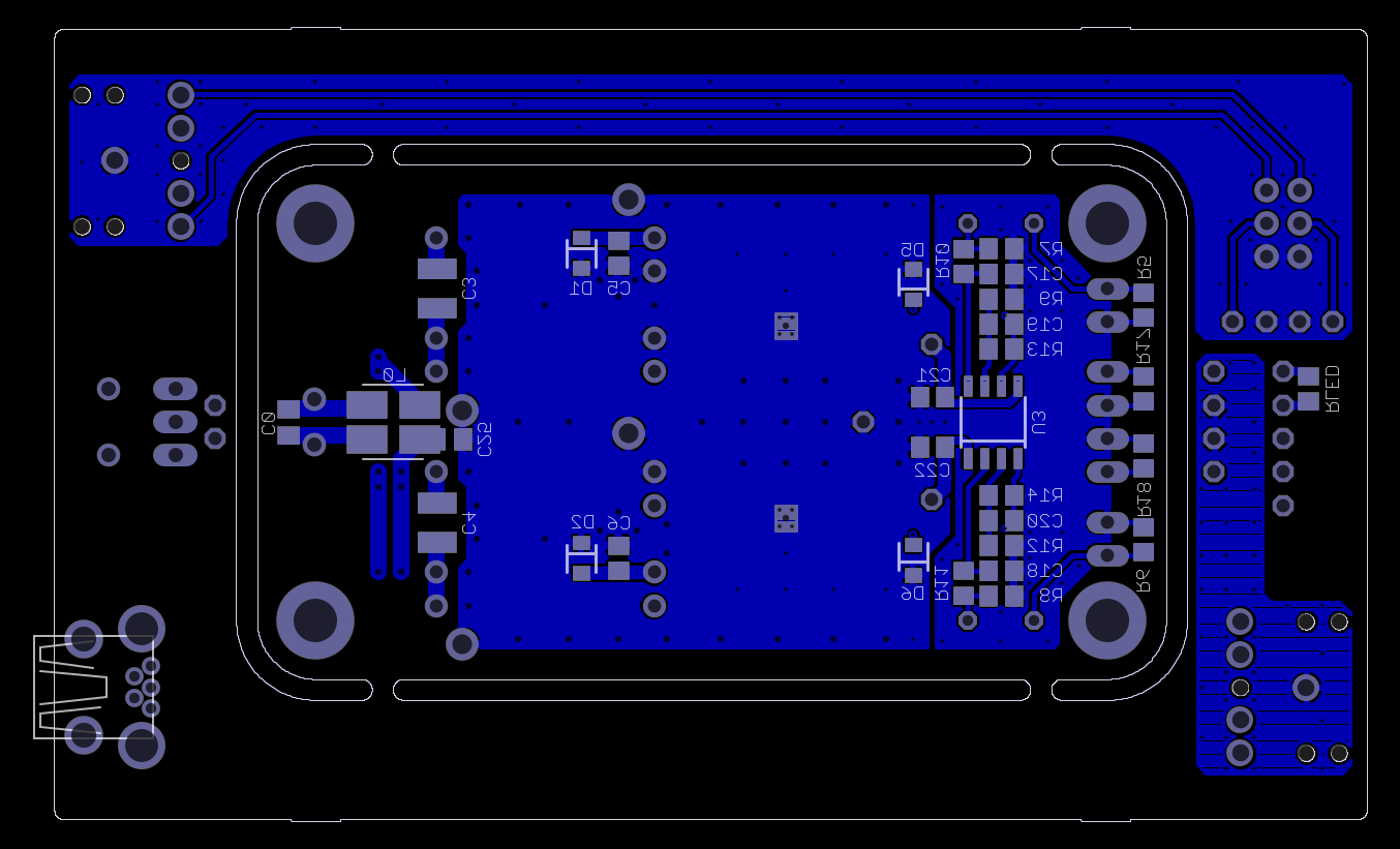

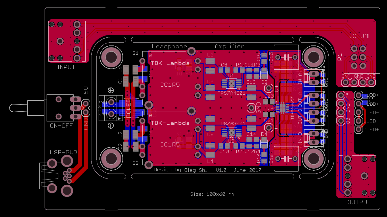

While the headamp undergoes systematic and thorough testing by a fellow diyer I decided to find a suitable chassis for it. I've got one from ebay which has 100x60x20mm internal dimensions (see here). I decided to make mounting the headamp in such a small chassis easy by adding all necessary peripherals on a 100x60mm PCB. The way I've done it (see attached images) allows separating the main headamp board from the peripherals should the project require different arrangement. The assembly requires soldering a dozen of jumpers but it is easier than wiring all the ins and outs using loose wires.
If someone sees potential improvements to the design please share your thoughts.

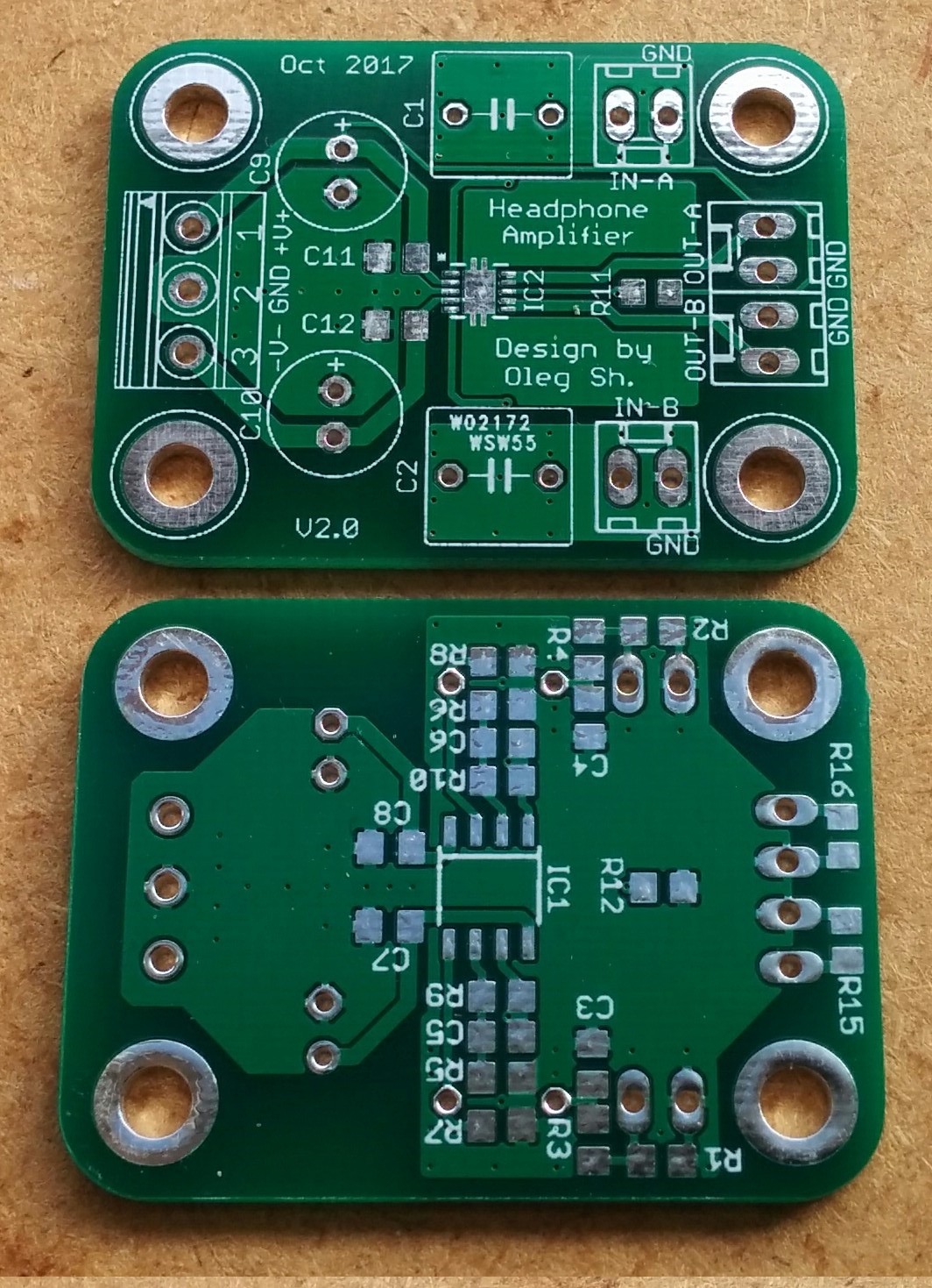

I also made a small headamp PCB without the PSU onboard. It is convenient if one needs to add headphone out to a power amp or a preamp. I also have an earlier design of such headamp where gain setting is implemented around OPA1622.

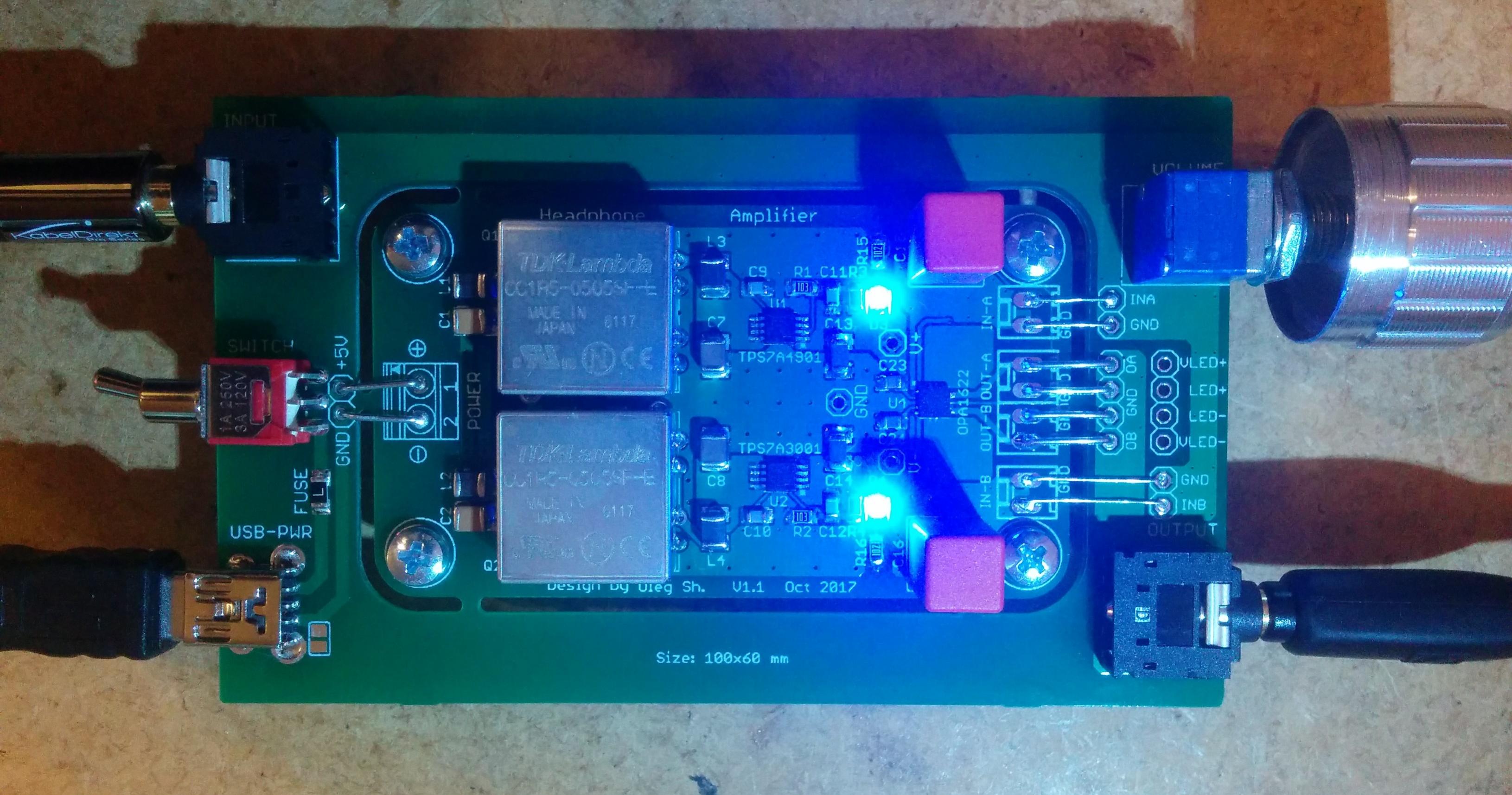

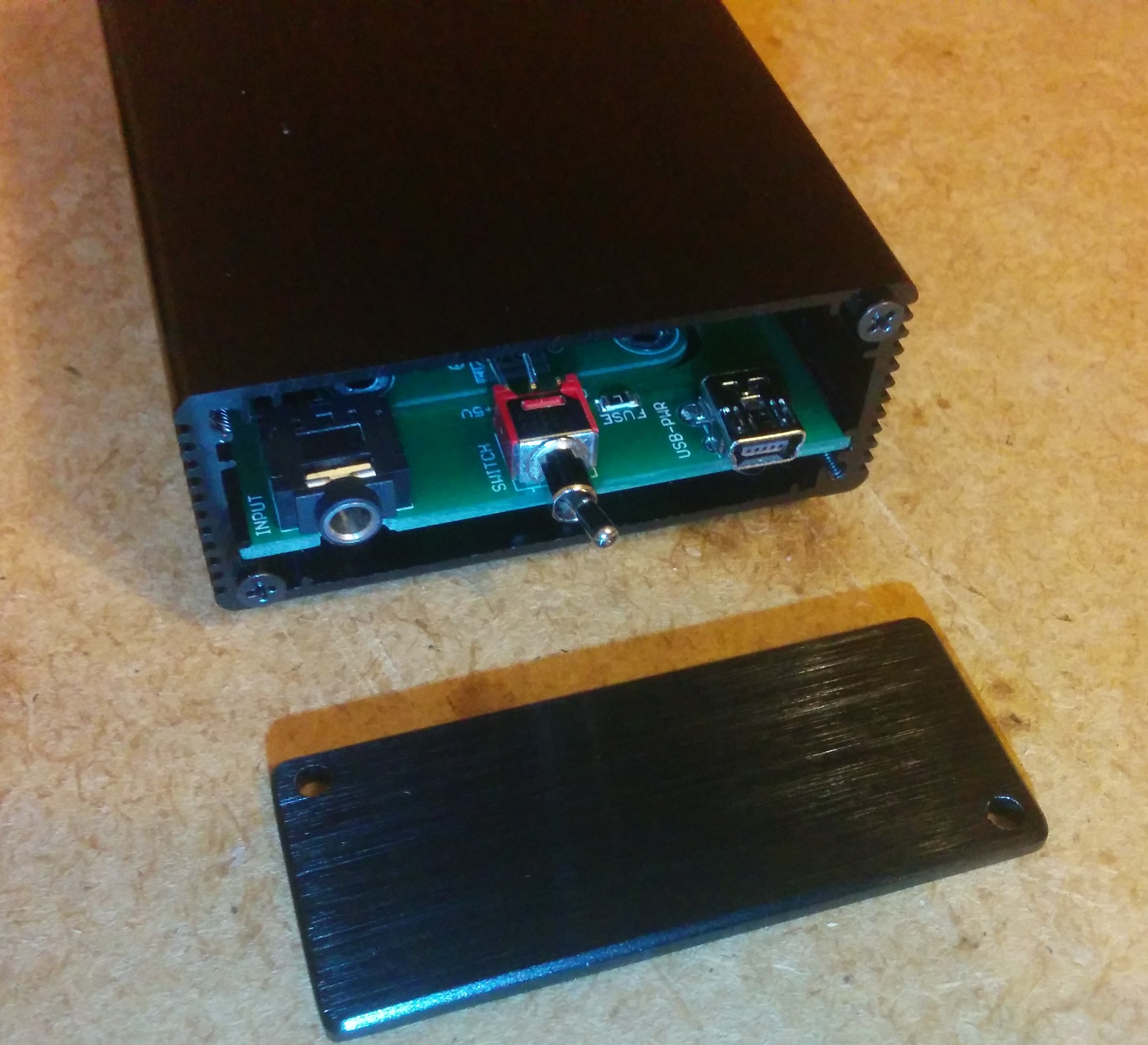

Headamp is assembled and plays music! The sound is excellent, no pops or clicks when switching ON or OFF even with signal applied and at full blast! Now only drilling the front and rear panels is left which I'll do on the weekend. I can say that my design goal is now reached and I have a headamp and universal buffer design for all possible situations🙂

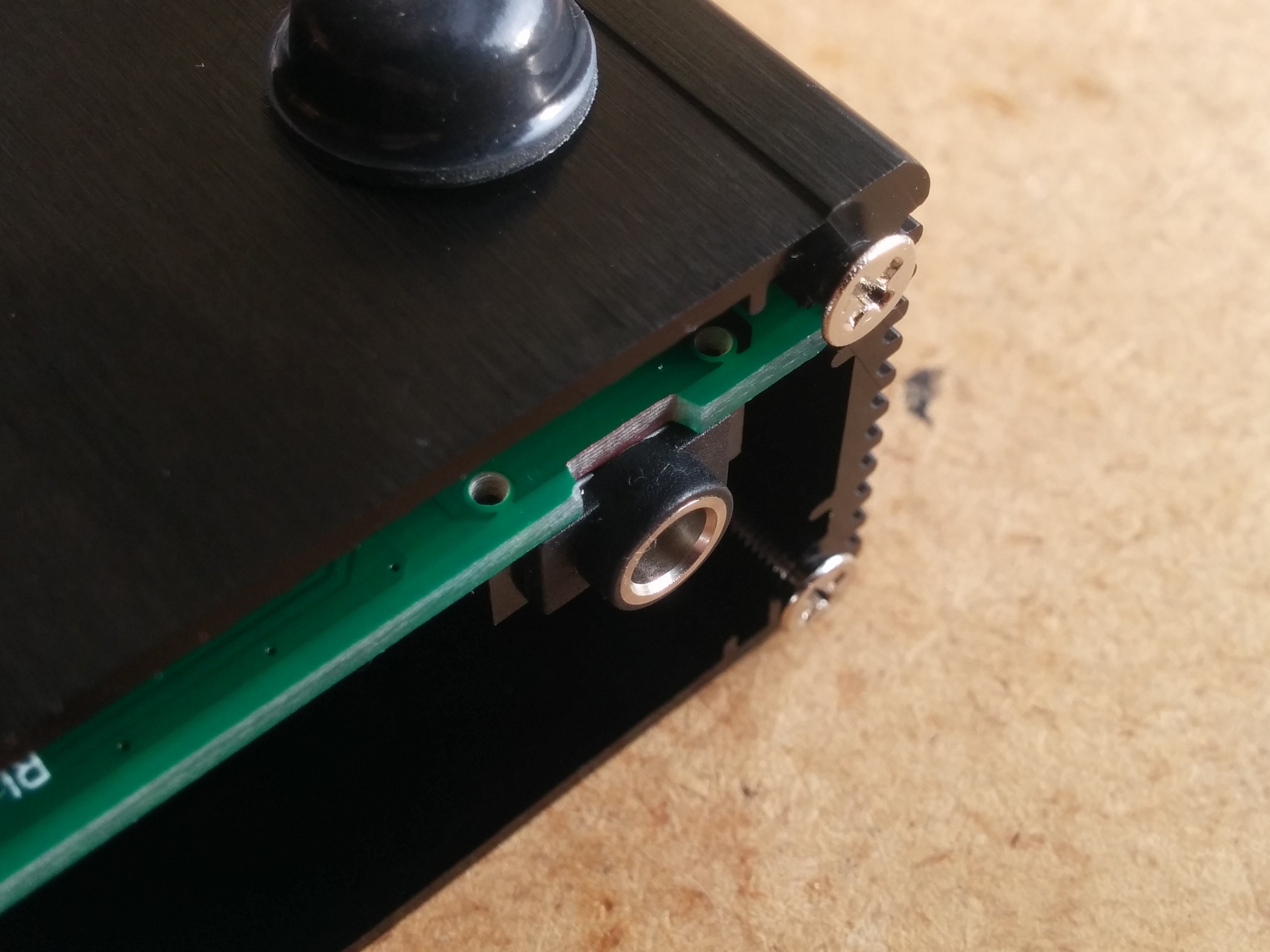

One note for potential builders. I forgot to make two small cutouts for the phone connectors in the PCB design (see attached image). I overlooked the fact that the phone connectors need them to flush mount with the PCB surface. In the end I made them using a small file.

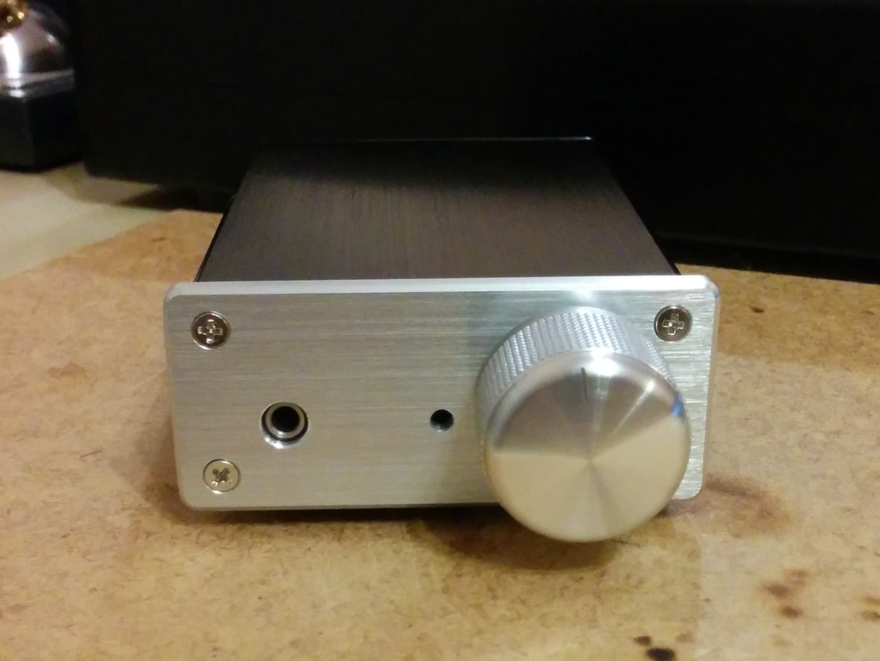

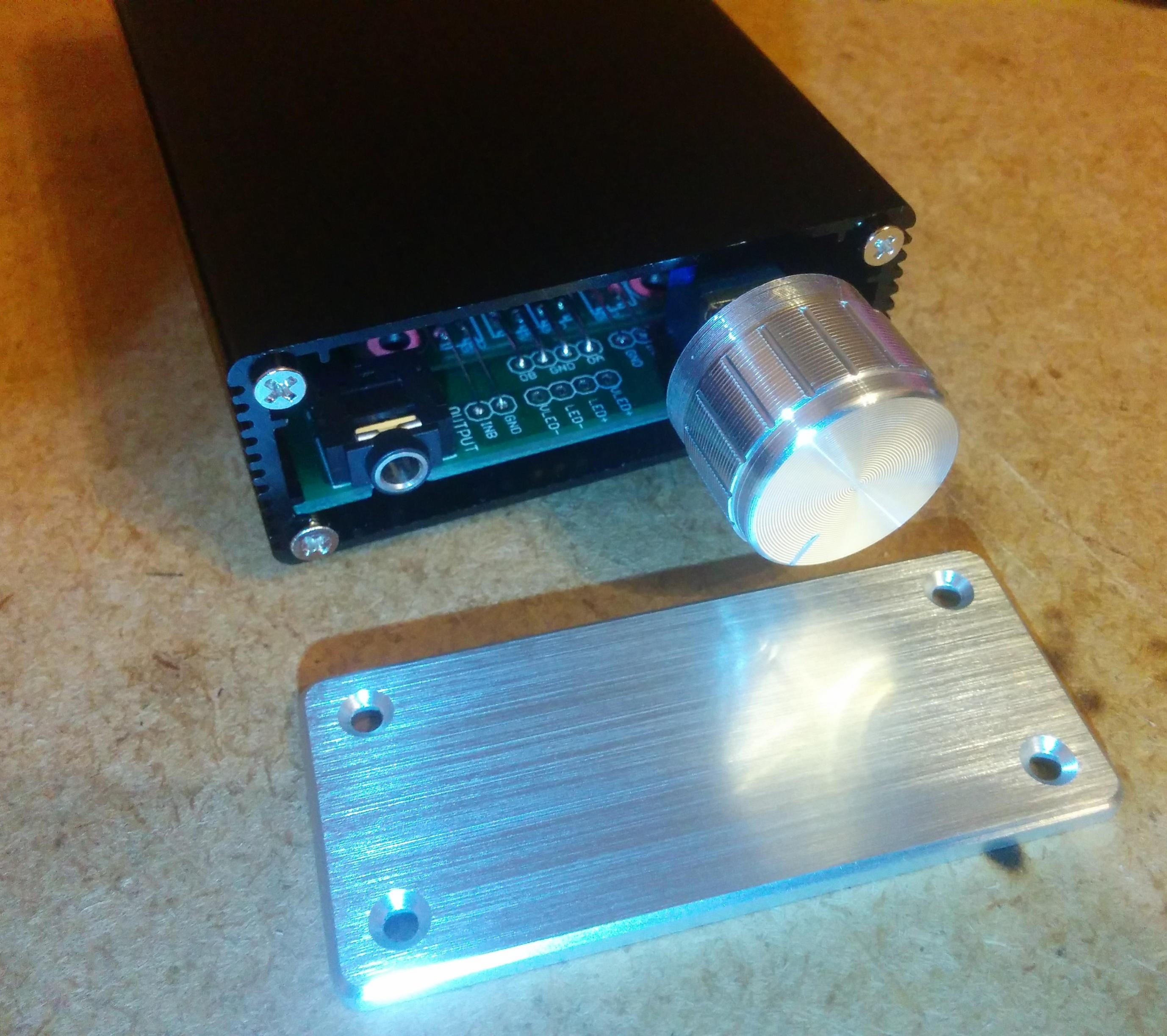

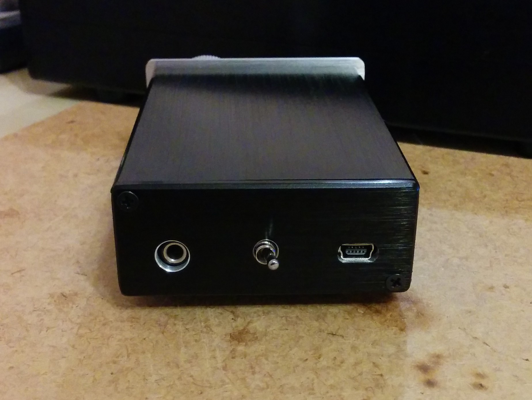

Almost ready! Just need to install 3mm power indicator LED and done.
I made a small mistake while drilling the hole for the input jack and had to enlarge it by 1 mm to fit the connector. Other than that all is fine🙂
