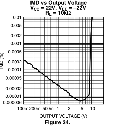

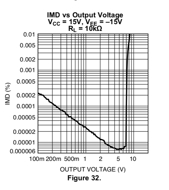

0.000007% IMD is a disaster? HA! You're a funny person. Did you even look at the plot you included with Post #172?

@10 volts its 0.00007%? It shoots to the moon at 8V! By 10 volts it's off the chart!
Yes. The IMD degrades as the amp enters clipping. Any amp does that.

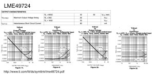

Considering the purifi offers a differential input requiring 10vrms at 4K ohms for full output, it would be good to consider that:
- the relevant datasheet is mostly the lme49724;
- no lm4562 in Tom's buffer is required to swing 20Vp-p, far from it.
I see no reason why this buffer would be unsuitable as input buffer for the purifi.

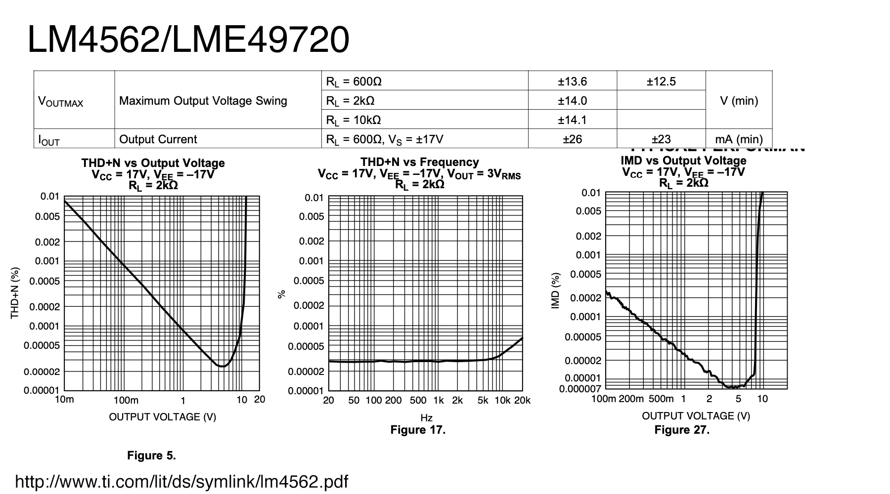

I honestly cannot get to grips with sonic bliss's problem with the specifications of the devices. Right in the introduction to the datasheet it says "Further, dynamic range is maximized by an output stage is capable of driving 2k loads to within 1V of either power supply voltage, and to within 1.4V when driving 600 ohm loads"
So with 17V rails, it can drive to 16V into 2k load, which is 11.3V rms. Which the harmonic distortion curves confirm.
With IMD, and keeping the two tones the same amplitude as the single tone harmonic test, the overall amplitude is increased by root2, so you have to reduce the amplitude to keep the op amp out of clipping. Which - wait for it - by root2. So 11.3/root2 = 8V
Again confirmed in the datasheet.
In any event, the Purifi data is that you need 9.6V rms sine wave to drive the amp to 1% THD. At the point the 4562 will be producing 0.0001% absolute maximum THD

It's easy to get lost in the many graphs in the LME49724 and LM4562/LME49720 data sheets, so I've created some "summary figures". I chose the ±17-18 V supply, 2 kΩ load operating point as that is the most relevant for the Universal Buffer when driving the Purifi 1ET400A. The Purifi has 4.4 kΩ input impedance, but TI does not provide data for that operating point. As 2.0 kΩ is a heavier load, the data point I chose will show slightly worse performance than what I would expect from the Universal Buffer when driving a Purifi 1ET400A.
Purifi says 9.6 V RMS is needed to drive the 1ET400A to clipping (450 W, 1% THD, 4 Ω load). So by golly we must provide it!
With a differential input, each half of the signal pair drives half the voltage. So each LM4562/LME49720 that buffers the signal into the LME49724 must provide 9.6/2 = 4.8 V RMS. As you can see in attached graphs, the LM4562/LME49720 can easily provide 4.8 V RMS cleanly and the LME49724 can easily and cleanly provide the resulting 9.6 V RMS differential output.
So clearly, the Universal Buffer is perfectly capable of cleanly driving the Purifi 1ET400A to clipping. The THD/IMD/sound quality will be limited by the Purifi and not the Universal Buffer. That's exactly what you want.
