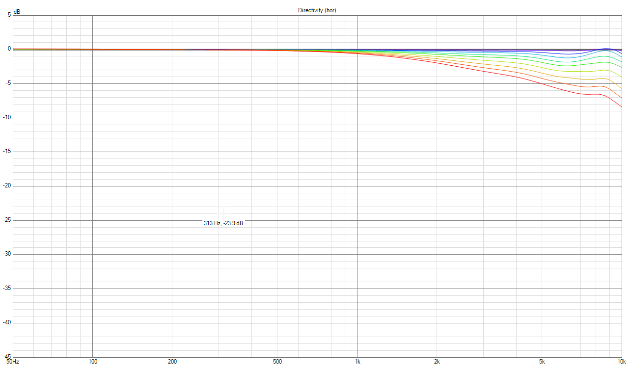

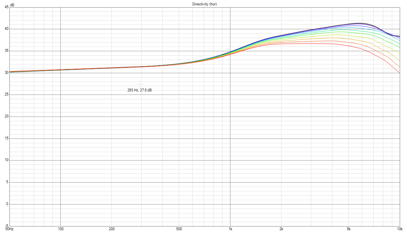

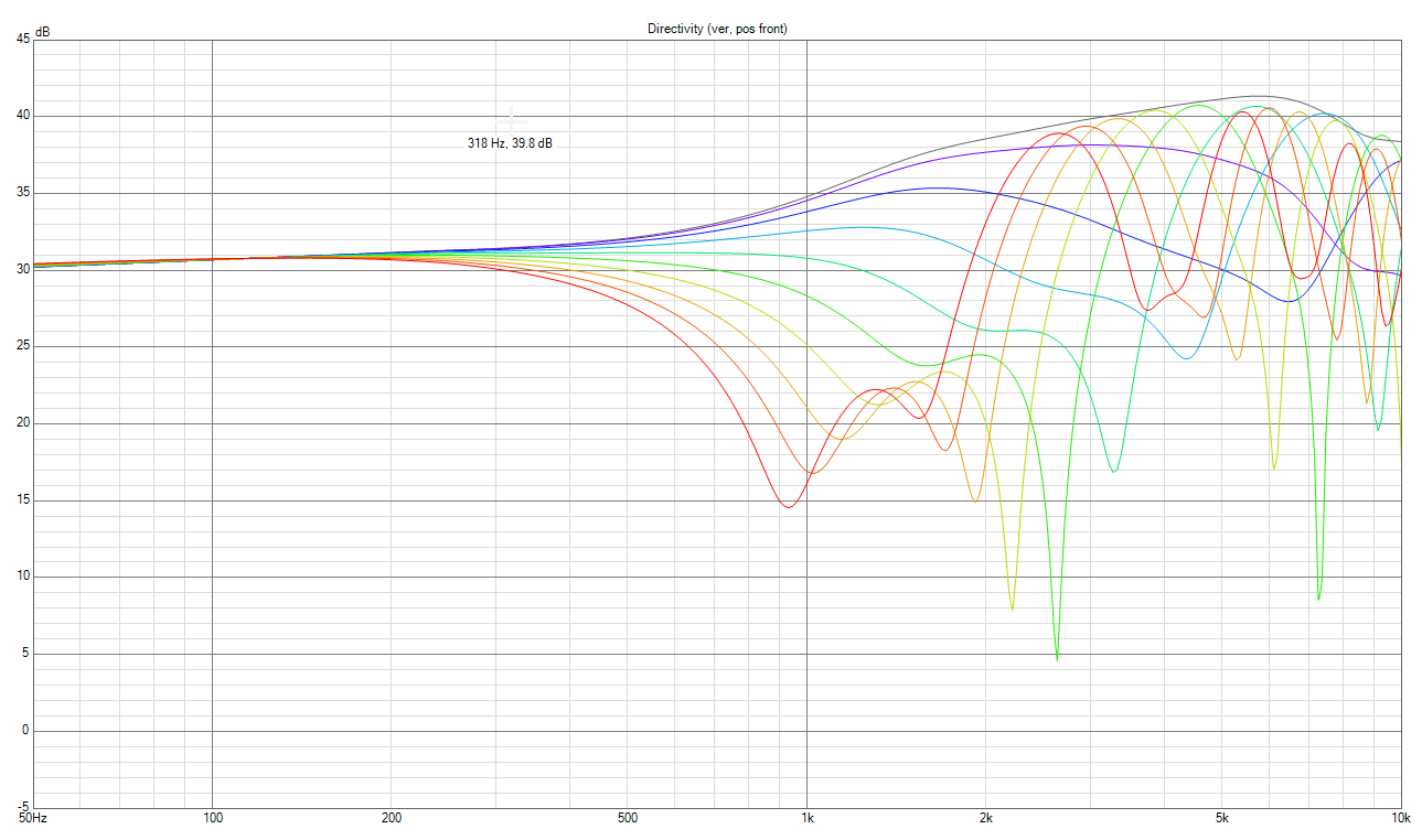

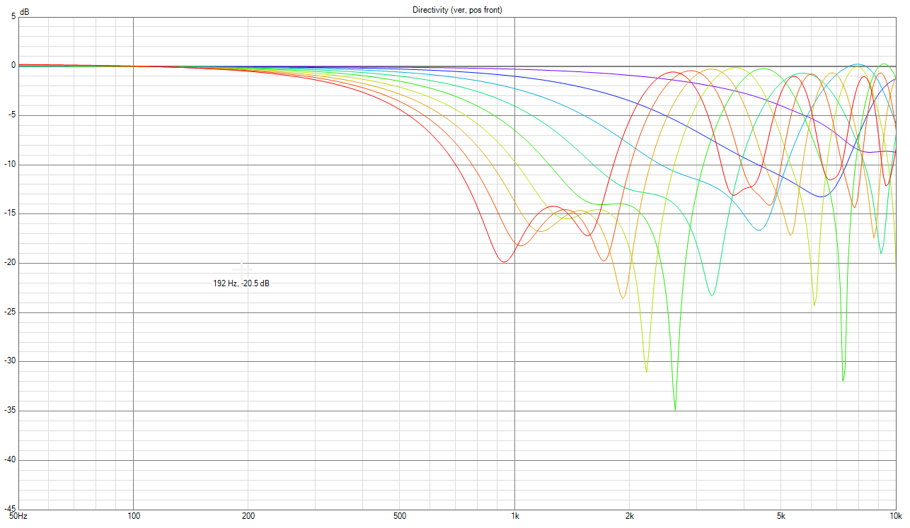

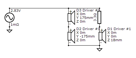

For the better part of two years, I've been futzing around with ideas for a speaker that's attractive enough that my wife will allow it in the living room, that's dynamic, and has broad horizontal directivity and narrow vertical directivity.
I've tried a bunch of things, but keeping coming back to arrays because of their WAF
I know a Unity horn would be an obvious choice but my wife kicked mine out of the living room. (You can buy mine in the "Swap Meet" section.)
For today's experiment, I've done some (relatively) basic simulations of an array of small Unity horns.
This is just a starting point. The results are not great. I think the fundamental challenge here is that each element requires wide horizontal directivity AND narrow vertical directivity. Which is difficult to achieve without a Paraline or a Ribbon tweeter.
The attached pics show:
1) The response of a single element
2) The horizontal and vertical response of three elements, that have been shaded and curved to improve the overall response
3) Same as above, but this time with normalization
4) The crossover

Reflecting on these results for a minute -
If you look at the vertical directivity, there's basically a frequency where things get FUBAR. That frequency is equivalent to the height of the Unity horn. In the sim above, I simmed three Unity horns, each one 175mm tall.
I chose that number mostly because that's a fairly "easy" size to pull off, using affordable tweeters and midranges. My "unitized waveguide" had dimensions similar to that:
