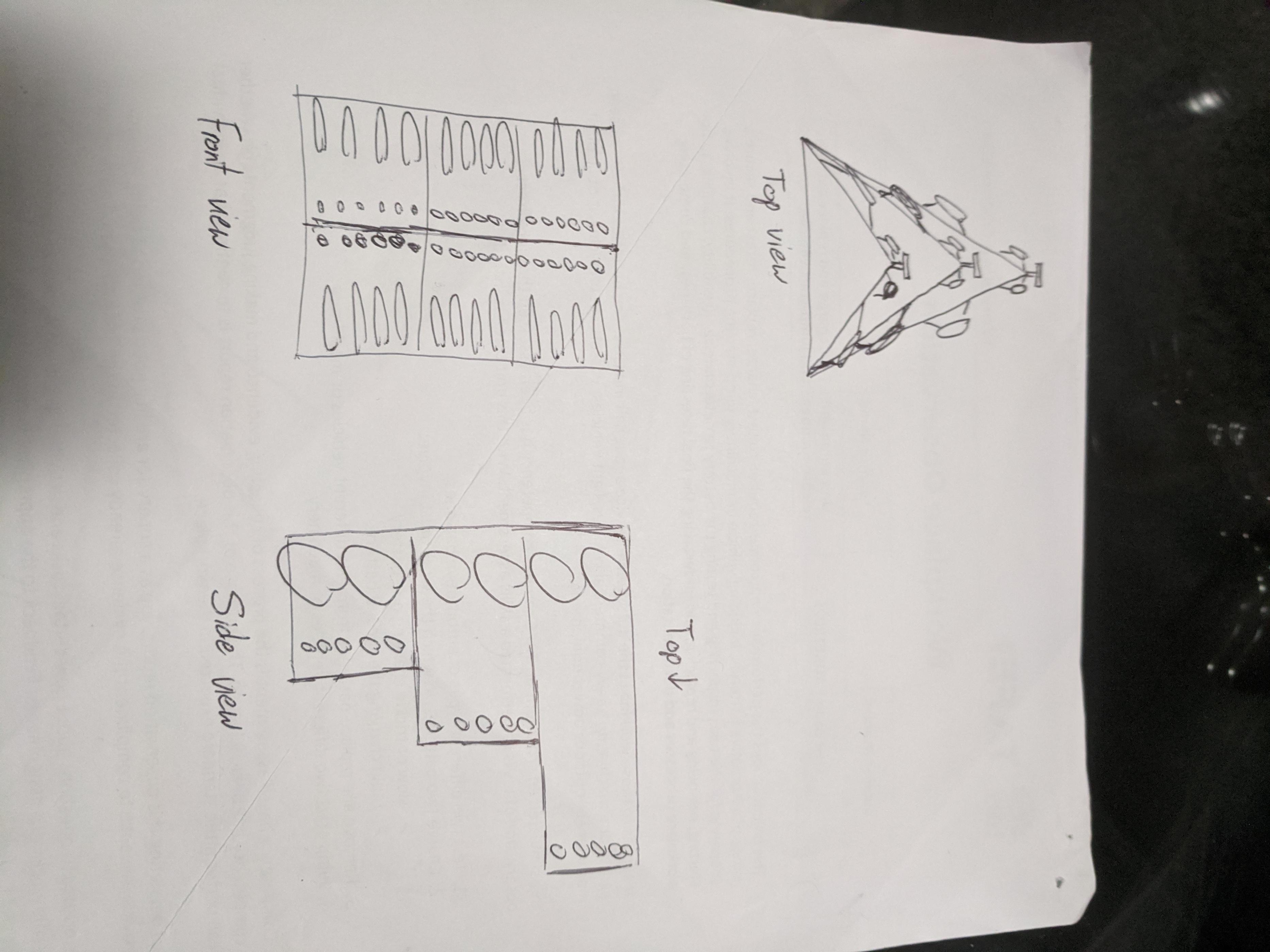

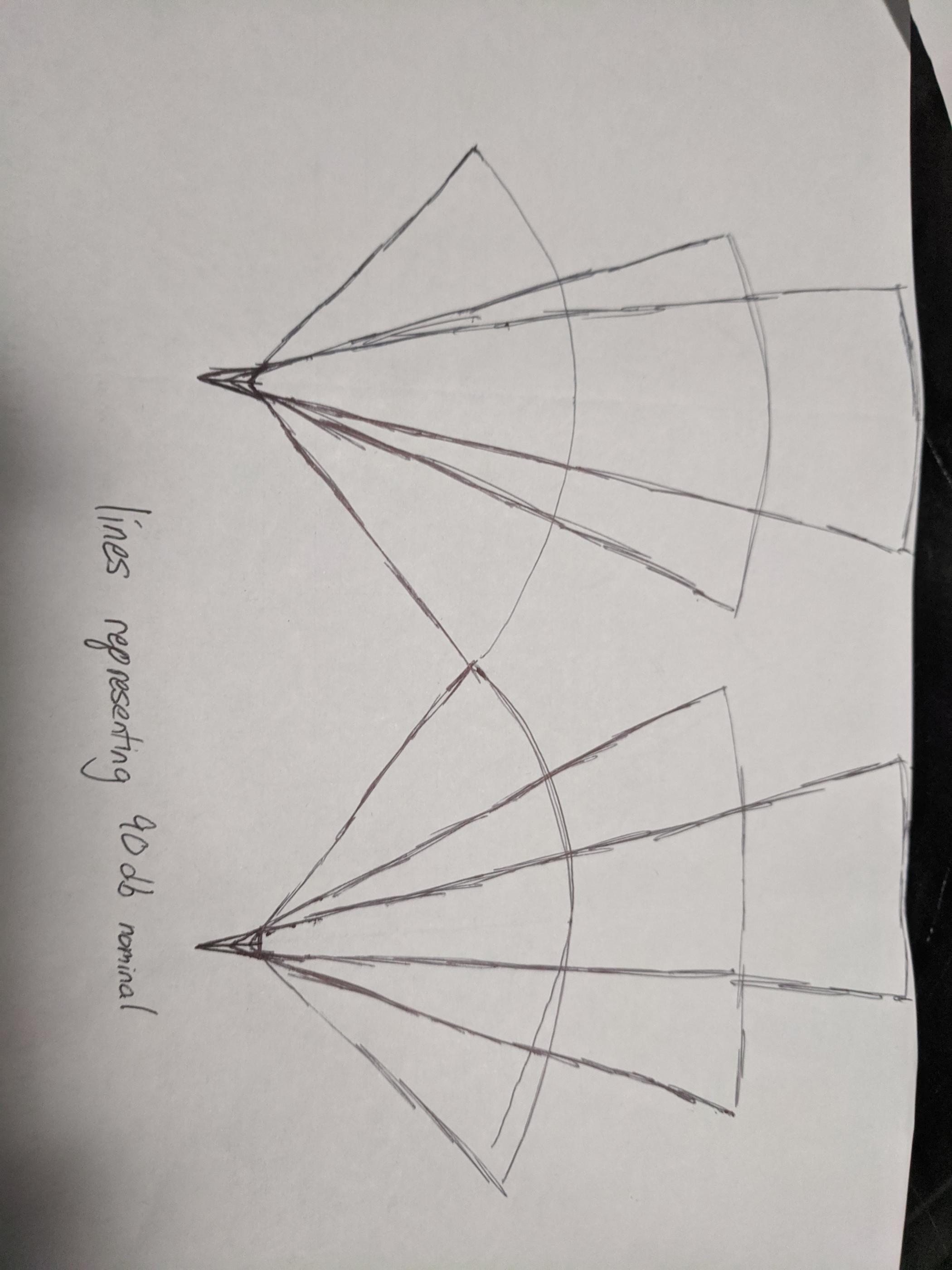

I've attempted to draw (poorly) what I understand you to be saying
The pictures show a three segment line with the top box having the smallest coverage angle and the longest throw for a given spl, as well as the approximate coverage pattern of said boxes.
Is that more or less what you meant?

Hey there all, like many others I'm a bit of a lurker on this forum and have been interested in diy audio and the likes for several years, but haven't really posted much on here as of yet.
I heard about the Danley horns a while ago and as time has gone by curiosity and a growing knowledge of the related technologies and design theory has led to the inevitable - me wanting to build one 😀 (sort of). I've had a small pa system going for parties and small events and feel like designing some hornloaded mains for it (the subs are horns and I will soon be building some hybrid horns for kicks, so may as well match the rest)
Now I recognise that one of the inherit benefits of the synergy design is that it operates as a point source radiator, and that would be lost with a line array adaptation, but I suppose humour the thought and just assume that I want to build one out of curiosity (I do).
I'm not sure how one would go about it, but would a "linear wavefront synergy" or whatever you'd call it work? As in a synergy with multiple midrange drivers stacked vertically along a waveguide with paraline'd compression drivers and an effective wavefront expanding only on the horizontal plane? I'm assuming that what I'm saying makes sense, but feel free to tell me if it doesn't..
The way I see it I'd like to try and incorporate the use of a shared waveguide to ensure cohesive horizontal coverage, the use of acoustic bandpass enclosure design to minimise HD, the ability to combine multiple drivers acoustically to increase sensitivity and spl, the use of an acoustically large wavefront for higher frequencies to increase nearfield response throw and the tight vertical directivity control offered by line arrays.
I have two dbx driverack 260s (6 outputs each) available for time alignment, phase control, eq and everything else, so I have plenty of control over a lot of variables in the digital realm, which should allow for flexibility in the design phase. I also have a passion to learn and understand horn design, and have played around with hornresp in the past, however would have no idea how to model such a thing in the program. I would however assume that for the sake of modeling the expansion could be seen as a 2 dimensional problem which would simplify things.
I know this is probably not the easiest way to build a set of pa mains that will do such a job, however I guess I'm just the type to experiment, and I have measurement gear and time (due to covid) to muck about to find what works and what doesn't. I suppose I can help with the collective knowledge on synergy systems as well, so that can't be a bad thing right?

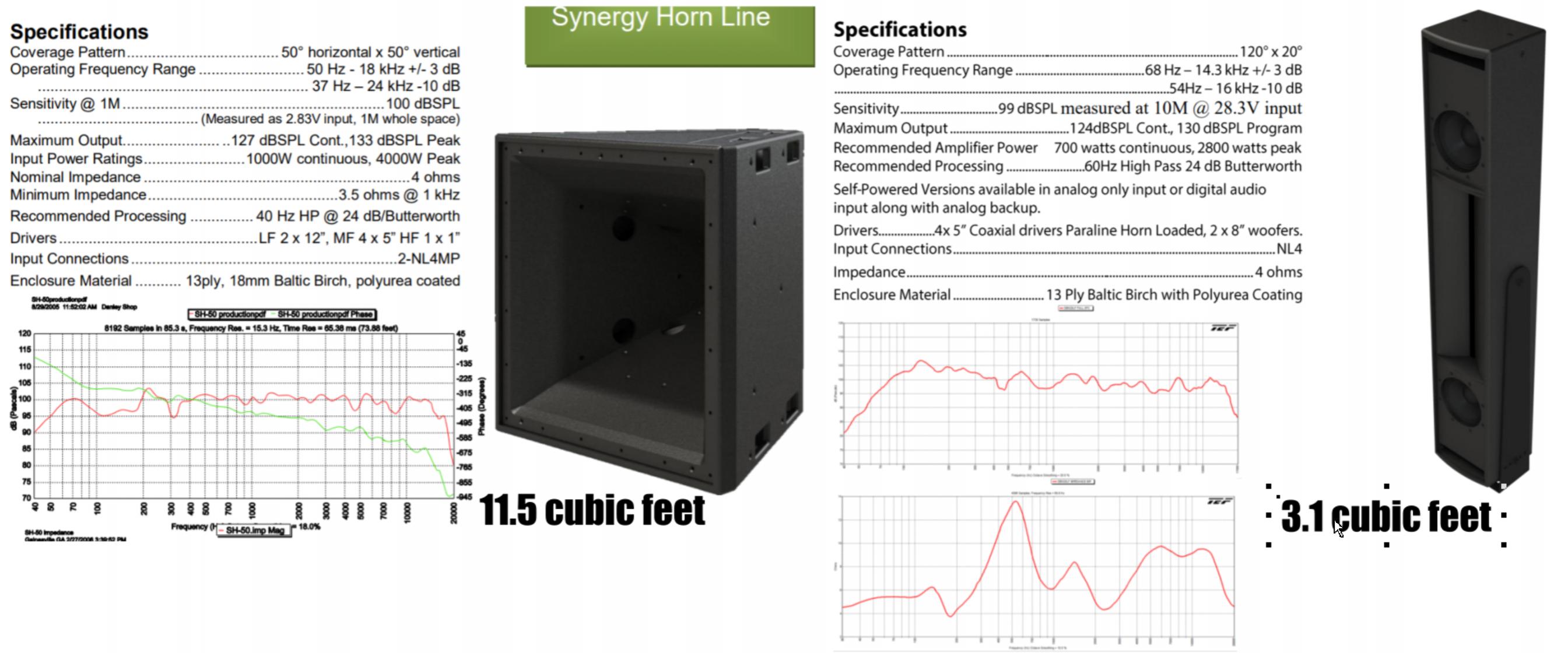

But the idea that you're going to raise the efficiency by using a bunch of tweeters - that's largely impossible. You just can't pack them tightly enough to get them to "add up" above about 5-10khz.
To demonstrate this, I've attached the spec sheet of the Danley sh50 and the Danley DBH20LF. The DBH speaker is about as close to a line array as you'll get from Danley. And note that even though it has five compression drivers, versus the SH50 with it's single unit, the efficiency of the two speakers is just about identical. What's notable is that the DBH20LF is VERY small, less than one third the size of the SH50.
This isn't meant to discourage your project. I think the Paraline is really interesting if you need to build a box that's as small as possible and you're willing to pay for a lot of drivers. It's also interesting if you want to do something strange, such as create a loudspeaker with a beamwidth of 100 degrees by ten degrees.
If your project doesn't include those requirements, it might not be worth the hassle to use Paralines.

I've been thinking off making synergy line array with cheap 3" full range speakers with some cheap 6 or 8" woofers.
I would start with the bottom one at about 100°H and make the angle smaller the longer the array goes till about 50° or even smaller. Just like that p.audio 100/50 asymmetric horn.

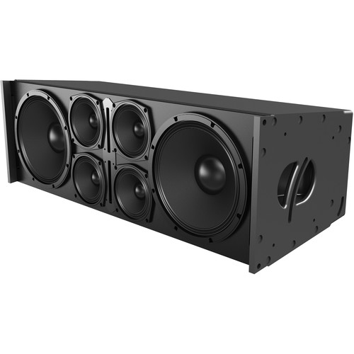

Line array manufacturers are beginning to wise up to this concept. In the first pic above, note that the midranges are uncovered, and the distance from the tweeter to the center of the midrange is right at the limit of how far it can be.
In the second pic, a newer design from JBL, they're starting to converge on the idea which I describe. Basically there's a phase plug covering the midrange drivers, and this phase plug makes the midrange behave as if they're much smaller. This cleans up the polar response and reduces comb filtering.
The boxes from VTC Pro Audio, using a pair of Paralines, take this even further. The horn loading is even more pronounced than the JBL.
Note that one of the bizarre aspects of the VTC boxes and the Jericho boxes is that you can have wildly asymmetric beamwidth, without pattern flip.
