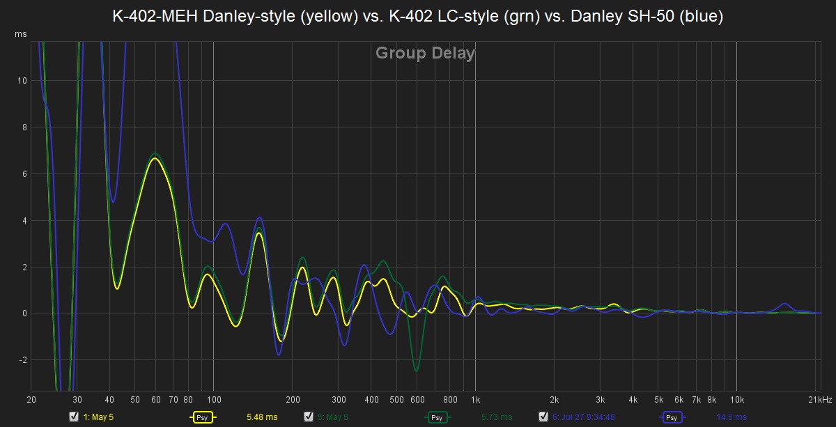

Here are my unity horn polars, not too shabby huh? 🙂
I am using the LeCleach instructions. I don't want to call it a "LeCleach crossover" because it's more than that. It's not just a crossover topology, it also requires a specific manipulation of the midrange location. Which just happens to work spectacularly with Unity horns.
Also, we agree on everything else, so I hope this post doesn't come off as disagreeable 🙂 My Unity horns are set up based on your advice.

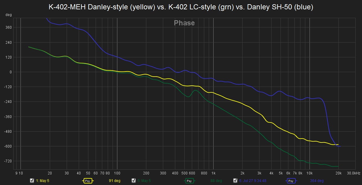

Okay, the only way that I could see to compare the two methods (Danley-style vs. Le Cléac’h style from the presentation that you posted) is to implement both methods and measure the results. That's what I did this AM. The results are below:
The MEH used in the yellow and green traces is the prototype K-402-MEH using a BMS 4592ND (dual diaphragm) 2" compression driver and two 15" Crites cast frame woofers. The blue trace is the Danley SH-50 overlaid for comparison.
It's obvious to me that the phase response of the drivers themselves largely determine the flatness of the overall MEH phase response. The BMS 4592ND overall phase response is largely determined by the phase response of its individual diaphragms (low and high frequency).
This is also true of the TAD TD-4002 2" compression driver (Be diaphragm), which has an even flatter response than all the other compression drivers mentioned (including the BMS 1" compression driver used in the SH-50). A comparison of the Danley SH-50 phase response to the Klipsch Jubilee (TAD 4002 compression drivers) is shown below, both using Danley-style crossovers:

I think you've got it. Just remember that Danley mentioned that he's not using "named" crossover filters. If you consider what he's actually doing (I've begun to use the same approach with outstanding results in my 5.1 bi-amped/triamped array), you might see that the amplitude/phase characteristic of the drivers themselves (i.e., no electrical filters used during initial measurement) determines the crossover points and provides the steepness of the resulting filters. You have to be careful about which drivers that you're selecting for the desired properties to keep the overall phase flatness within desired limits....Maybe I reading too many of my own ideas into the hint??
I'll say that again: if you want flat phase out of the MEH loudspeaker, you need to select the drivers with the desired phase response to achieve that (which is what Danley has done). To correct the phase of a particular driver, you're going to need FIR filtering. You can of course use FIR filters in a DSP crossover to correct undesired driver amplitude/phase characteristics, but I've found that capability isn't really necessary to use, and it further simplifies the resulting setup if you don't have to use FIR filtering.
Danley is using passive crossovers in its Synergy series, but a simple DSP crossover without FIR filtering capabilities will work like a charm to produce the same or better results (as you see above in the K-402-MEH and Jubilee vs. SH-50 amplitude/phase/step plots). Instead of using first order filters on the crossovers due to the spacing of the lower frequency ports in front of the higher frequency ports, you can use simply delay to correct for time alignment. Even if you don't correct for those time alignment mismatches, I think you'll find that the result overall loudspeaker phase response is not strongly affected in MEHs since the ports are within 1/4 wavelength of each other at the center crossover frequency (at least that's been my experience).
