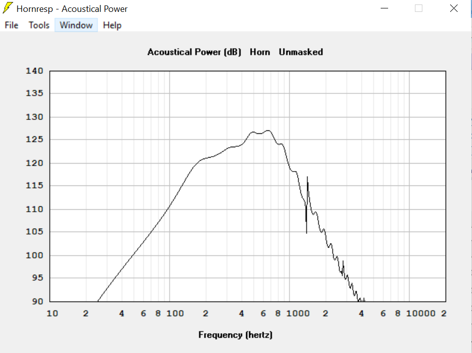

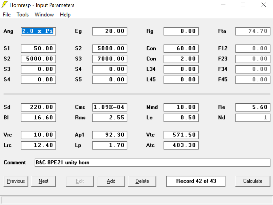

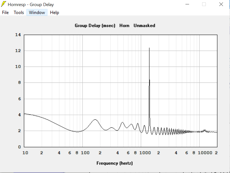

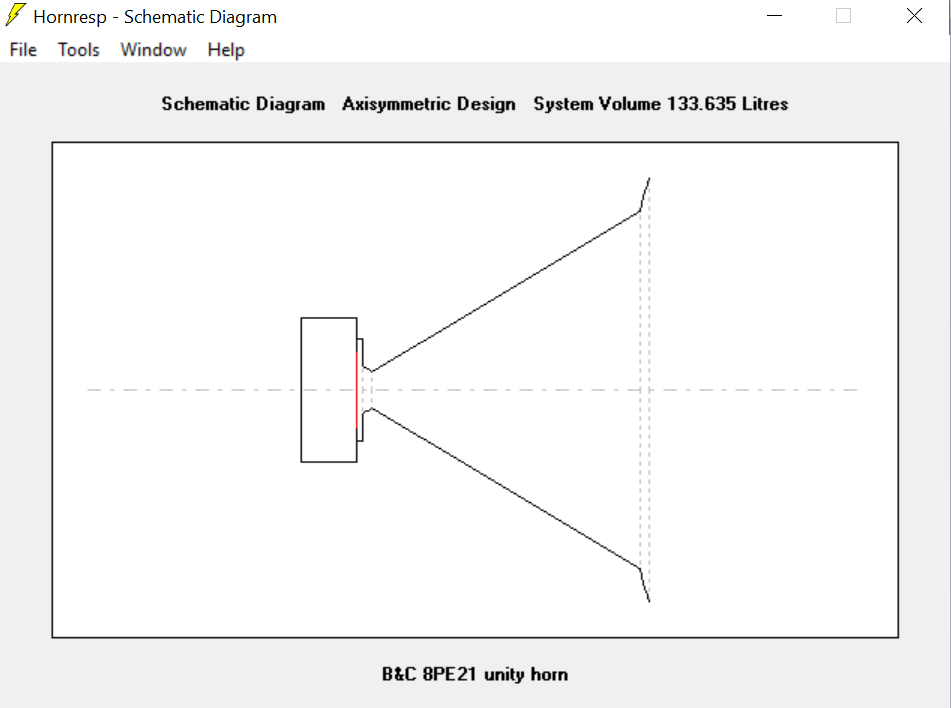

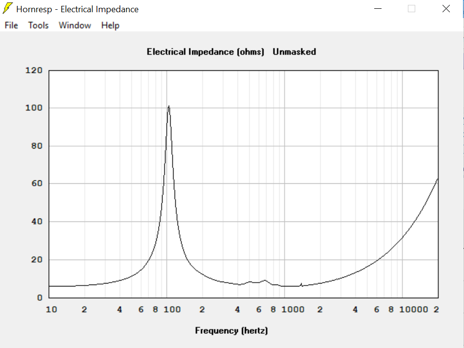

The B&C 8PE21 is looking promising, even though all uses of it I've seen in a Unity so far are with a 1" compression driver and a higher intended low cut.
I'd like to get these to 115dB SPL within excursion limits, which the current model just barely does with two of them (graphs shown are for a single driver). Shrinking the back chamber (Vrc) from 10L to 1L drops response at 100Hz about 6dB while leaving the rest of the response untouched. Raising it as high as 100L doesn't even change the response on the graph until down around 40-60Hz, which I guess is nice so that there's some flexibility in construction to just make whatever sized "big" back chamber is convenient and leave it at that.
Response is *not* flat within the passband, which I'm OK with since I'm going to be doing plenty of other EQing if the system hits overall SPL targets. I'm wondering what else I could try to get better than 110dB per driver at max excursion. The fact that it's excursion limited seems to suggest that in that region, port size will *not* affect efficiency much. Hornresp agrees. Lengthening the throat adapter (Lp) does shift the response hump downwards.
Any ideas which parameters here might help level out the response, or narrow the pass band so that I can sacrifice bandwidth up around 6-700Hz for the sake of efficiency lower down?

I should rephrase what I said about port efficiency: @Cask05 it makes sense to me that too small of a port/too high a compression ratio would limit efficiency. I'm saying that it doesn't seem like I could gain much back with a bigger port if I'm already excursion limited. I'd be happy to be wrong about that though.
I've got some 8pe21 sims flatter than that but same similar on the low end. High end is most affected by L.p. and Ap1 also Vtc but you really need to model as a throat ported OD to see that. A fair amount of bandpass peaking is unavoidable and then you get more roll off as you go below pattern control freq of the horn
The 8PE21 is very efficient. It has a very high efficiency/bandwidth product and so is suitable for loading. Your conical horn may not be achieving the most in that respect. However, it is still a good choice due to the directivity it offers.
Baffling, or another base radiation space assignment might be beneficial. I have found the 8PE21 to become quite loud on less than a Watt, crossed above 150Hz.
As far as excursion is concerned, these will happily go higher than the suggested 1mm.

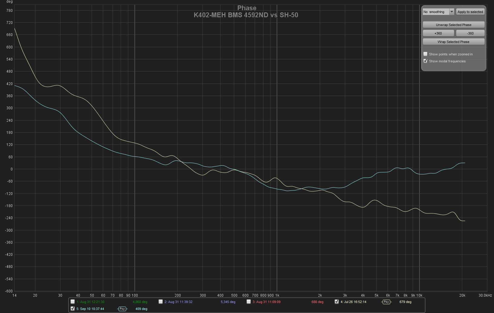

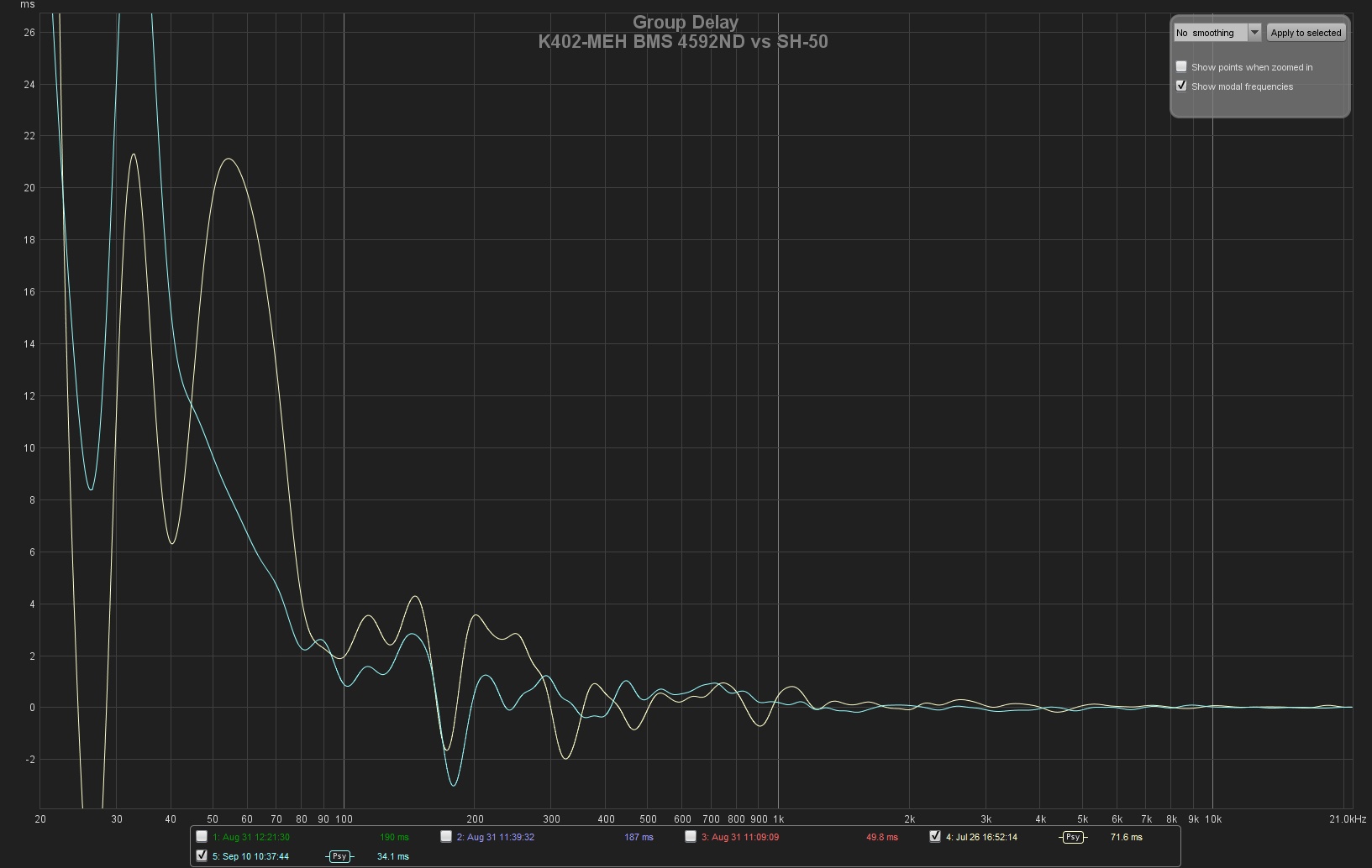

I think that there is a reason why you are not finding midrange drivers used with 2" compression drivers--is due to the fact that you don't need the midrange driver, even at 115 dB/one mThe B&C 8PE21 is looking promising, even though all uses of it I've seen in a Unity so far are with a 1" compression driver and a higher intended low cut.
Below, you will see the phase and group delay plots of a stock SH-50 compared to the K-402-MEH w/BMS 4592ND. Remember the emphasis that Danley placed on phase which to me indicated the reason why the midrange drivers were used at all:
The SH-50 traces are in manila color, while the K-402-MEH's are in light blue.
The reason for the midranges--once you see the actual driver traces individually--shows that the primary reason for the mids in the SH-50 are for phase growth control of the apex 1" driver, since their contribution the SPL output of the SH-50 is just over one octave (520-1360 Hz). Once you see that your 2" compression drivers can easily cover this band without the phase shifts of a BMS 1" compression driver used on the SH-50, I think you might rethink the need for the extra mids, instead applying your efforts to a better horn profile and full range operation--like both the SH-50 and K-402-MEH provide.
Chris
If you were running your MEHs at 125+ dBC all the time, I could see the need for the mids, as Danley is using them--extremely high power operation for PA duty (well above 115 dB). Personally, the max values of SPL at 1 m on-axis that I use them in the house is probably more like 105 dBC in the peaks, and about 83 dBC average (during loud demastering duty).

Regarding the graphs, it seems to me at a glance like both phase plots look pretty good, although you're right, there are qualitative differences. I'm not sure which one is "better". They both look fairly linear, with the K-402-MEH heading back towards 0 degrees as it goes up and the SH-50 going down.
