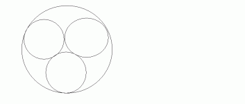

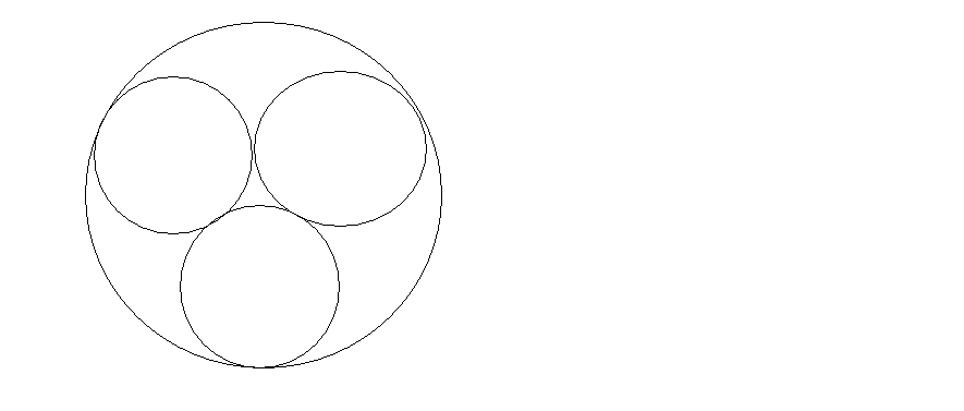

Thanks John,
When I saw how you removed area behind the new holes, I figured that might be the case but asked anyway, hoping to avoid carving away. Then another thought came to mind. You used the words "reflection off the holes" to describe the cause of the 4khz anomaly. Since the walls of the mids entrance holes are perpendicular to the tweeters wave front, the nature of the physical interaction seems straightforward, unless you were simplifying for brevity's sake. If it is just a simple reflection, I surmise that making the hole smaller just makes that area available to create a reflection smaller. Small enough to be invisible to 4khz or just simply reduced enough in area so that the reflection energy drops to insignificance?
Either way, by breaking up one larger area into several smaller ones should either reduce the reflected energy or, if the reflection angles are different, diffuse it. So, one last try to avoid getting out the cutting tools and bondo. How bout we insert several pieces of thin-walled tube into the entry hole? The tube pieces would need to be the same length as the entry hole, and fit snugly against one another and the wall of the hole. Would this break up and diffuse the reflection? If it worked, it would allow the hole area to remain essentially unchanged, so you wouldn't give up output. Cross section below.
Sheldon

Wow!
I guess it's similar to the straw port seen on some of the Mission
loudspeakers. It was done to cut down on port noise. Provided a low pass filter to reduce port noise.
No real reason that it couldn't work on some level. THe length would be rather critical. The whole length of tube may act as a resonator. And most probably as a 1/4 wavelength resonator. But if is above the passband who cares! Definitely worth experimenting with.
Mark

Thanks Mark,
I was proposing that the length of the inserts be equal to the thickness of the current horn wall, which is about 1.25cm. That would make them a 1/4 wavelength resonator at about 6.8khz (343ms/0.05m). If the crossover is at 1.5k, we should be out of trouble by then.
Sheldon
Good question catapult - during my experiments I was planning to try the same thing.
I also wonder about getting away from circular holes altogether and going to either
a) a large hole, but covered with a minimally (10-20%) perforated grill - something like to cover for ceiling speakers. It could present the same net surface area, but impact the tweeter much less.
b) a slit running the width of the horn. this would in theory have a much worse diffraction effect, but again might be OK if covered with a minimally perforated grill.
The radiation pattern from the mids might be a problem, but at the wavelengths involved with the mids, it's not entirely clear to me that it's insurmountable.
