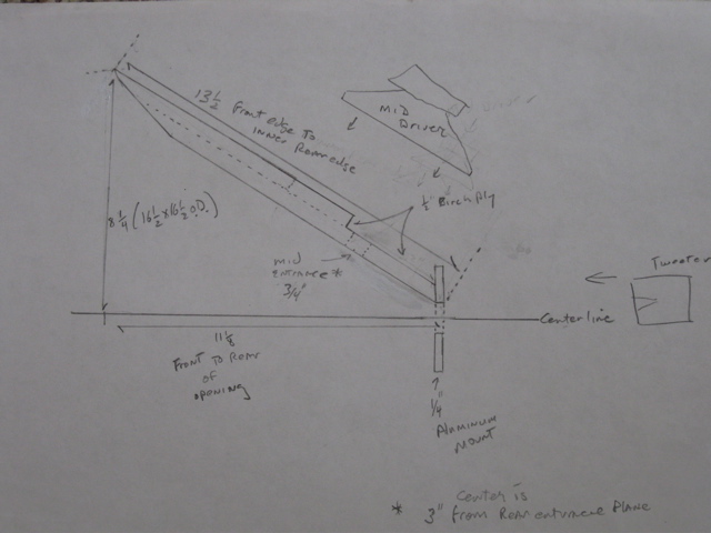

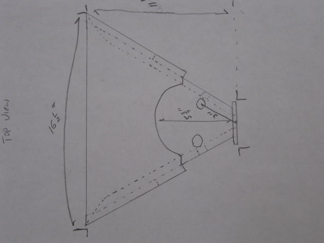

I am presenting the pictures of an unfinished prototype in a hope that a showcase of a piece of hardware proves that I am building something rather than just asking theoretical questions for questions sake, and may thus attract more responses from the knowledgeable people.
First, because this is my first conical-shaped Unity, I would like to understand better where to locate holes for mid-frequency drivers. Should I start at the same distance from the throat as the pyramidal-shaped Unity, or does the different cross-sectional area at that distanced change the location?
Second, as already asked on the web-page, I wonder if, by a miracle, someone does not have an extra mid-frequency driver, or knows where to acquire one.
Third, as again mentioned on the web-page, I need help in locating a shop with a CNC lathe that would do turning of the throat for a reasonable price.

Can someone tell me how small the entry holes in the unity can be? It seems small holes (1cm diamter for midrange, 5cm for bass) get the best results in my akabak script, but there has to be a limit on how small one can make them. Especially for the bass range which has a lot of air displacement, is distortion introduced by air speed or pressure in the hole?
MaVo said:Can someone tell me how small the entry holes in the unity can be? It seems small holes (1cm diamter for midrange, 5cm for bass) get the best results in my akabak script, but there has to be a limit on how small one can make them. Especially for the bass range which has a lot of air displacement, is distortion introduced by air speed or pressure in the hole?
An akabak script, that's great!
I didn't realize there was a student version of Akabak until I stumbled across it on the tapped horn thread. If I'd known this when I did my "unity" project, I would have certainly used it.
I tried a couple of different hole sizes, and wound up going with ones which were VERY small - less than a cm across.
Then again, I was using 2" midranges, which is unusual.
I'd guess the size of the holes is quite dependent on the SD and the VD of the driver you are using.
The aurasound mids which I used have a larger xmax than the prosound mids used by Sheerin and Danley.
Sheerin may be the best person to contact about this; he discussed it on Audioasylum and his site on snippets.
