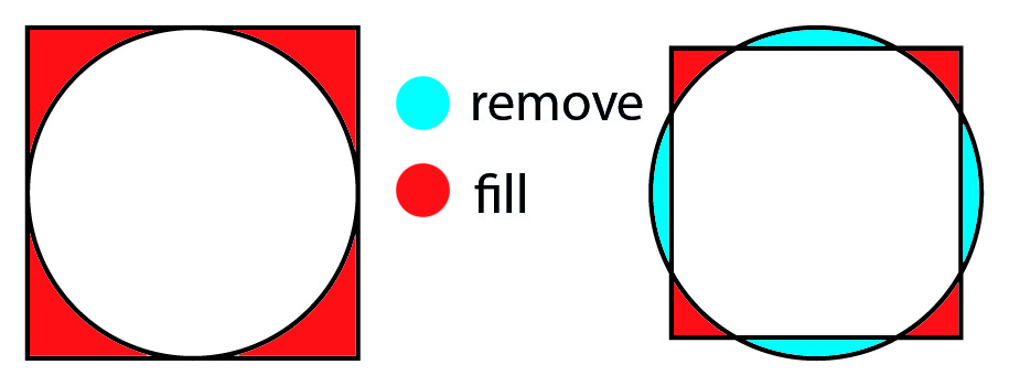

For the horn throat, I used modeling clay and did trial and error until I felt I had a good result. We'll see how much a different driver changes things, but I feel it can only get better.
If I were more ambitious I would try something entirely different with the throat. The original unity horns and many clones seem to mate a 1" diameter CD to a 1" square horn entry then fill the four corners. I would like to see how the same 1" diameter exit would work going into, say, a 0.875" square and then using a combination of material removal and filling. This could make for a smoother transition and a more constant flare rate.
What I've done is a bit more like your illustration on the right. However, I also took the mounting plate for the CD and started to flare it out by turning it up in the lathe. I then overlap the square throat like your right illustration, perhaps overlapping even slightly more. Then I have more removal than filling and I find that it is easier to remove. Filling with bog isn't my favourite thing. The result is a smoother transition.
That shows the flare on the mounting plate, but it doesn't show the square overlapping as I actually did it.
Looking again at my 3D render, you can see that if you are willing to do enough filling, you could actually get it perfectly smooth without making the square smaller. You just have to fill enough so that there isn't a sudden transition at the throat, but instead very gradual.

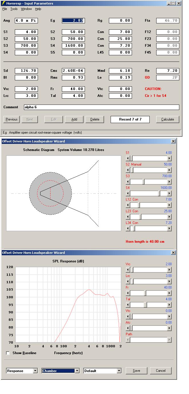

But these parameters are unfortunately impossible to build. For instance, the throat chamber volume and area is set to zero. Which means there is no throat chamber. And that's perfectly valid, as long as the area where the woofers enter the horn is large enough. But it's not - it's set to fifty square centimeters, which is a small fraction of the woofer's size.
You're right about the parameters. However, this model doesn't accurately depict what we do w/ these unities. I've simulated the alpha 6 mid in winisd as a 4th order bandpass box, and I want to see what happens when I build that box and mate it to the horn. I'll also have to seal the back of the alpha 6.
As far as the woofer offset, you're also right about the model. However, as I'm only using two drivers, I can extend a shelf off the sides of the horn to allow for overhang, much as Paul Spencer has drawn out on his blog, as well as offset the entry tap (great idea, Paul!).
Finally, I don't necessarily plan to have the entry tap at 7 cm from the apex- I'll likely move it closer but will experiment w/ placement via removable wooden plates, onto which the woofers are mounted. As long as the woofer is close enough, the high end roll off won't happen too soon (I've played around w/ hornresp a lot, changing up the L1L2 and S2 to see what happens). I'll likely use a BMW 4550 and a miniDSP for this project. I'm shooting for a fair amount of flat FR overlap between the mids and the CD. If I get it, I'll bisect the overlap for my XO frequency, and use the minidsp to adjust delay and individual driver EQ.... an analog purist I'm most certainly not!
Yeah, this may make an unnecessary pile of sawdust, but I've always been more of a trial and error guy than a modeler. Anyway, I'm starting to learn sketchup on my own, and I'll start a thread when (if!) I get everything together.

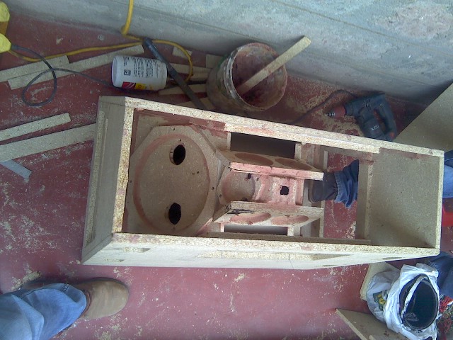

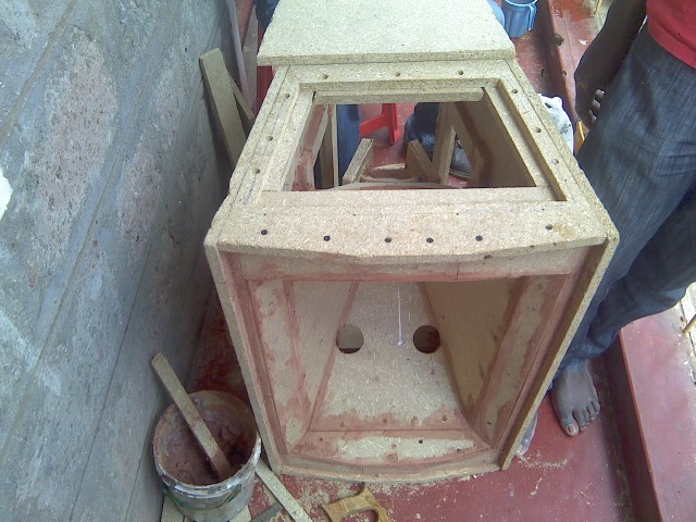

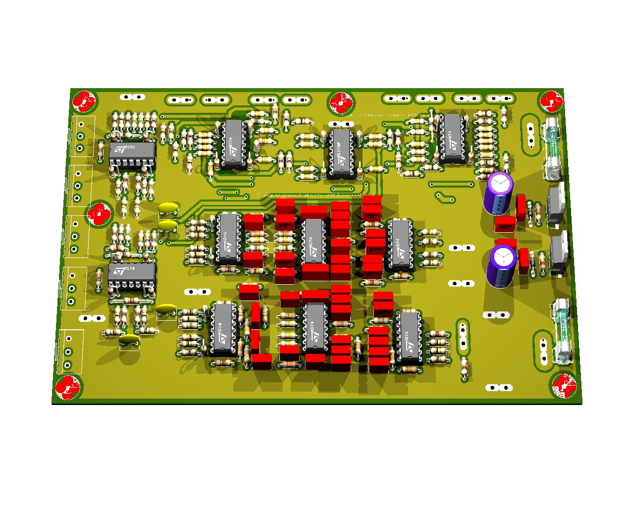

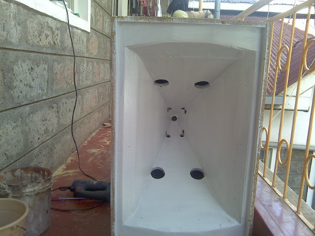

hi all i have been looking for a 24db active crossover to go with the unity horn / synergy horn i made but i have found none. i made a 24db cross over but it did not work well with the horn as i expected could someone please help.
