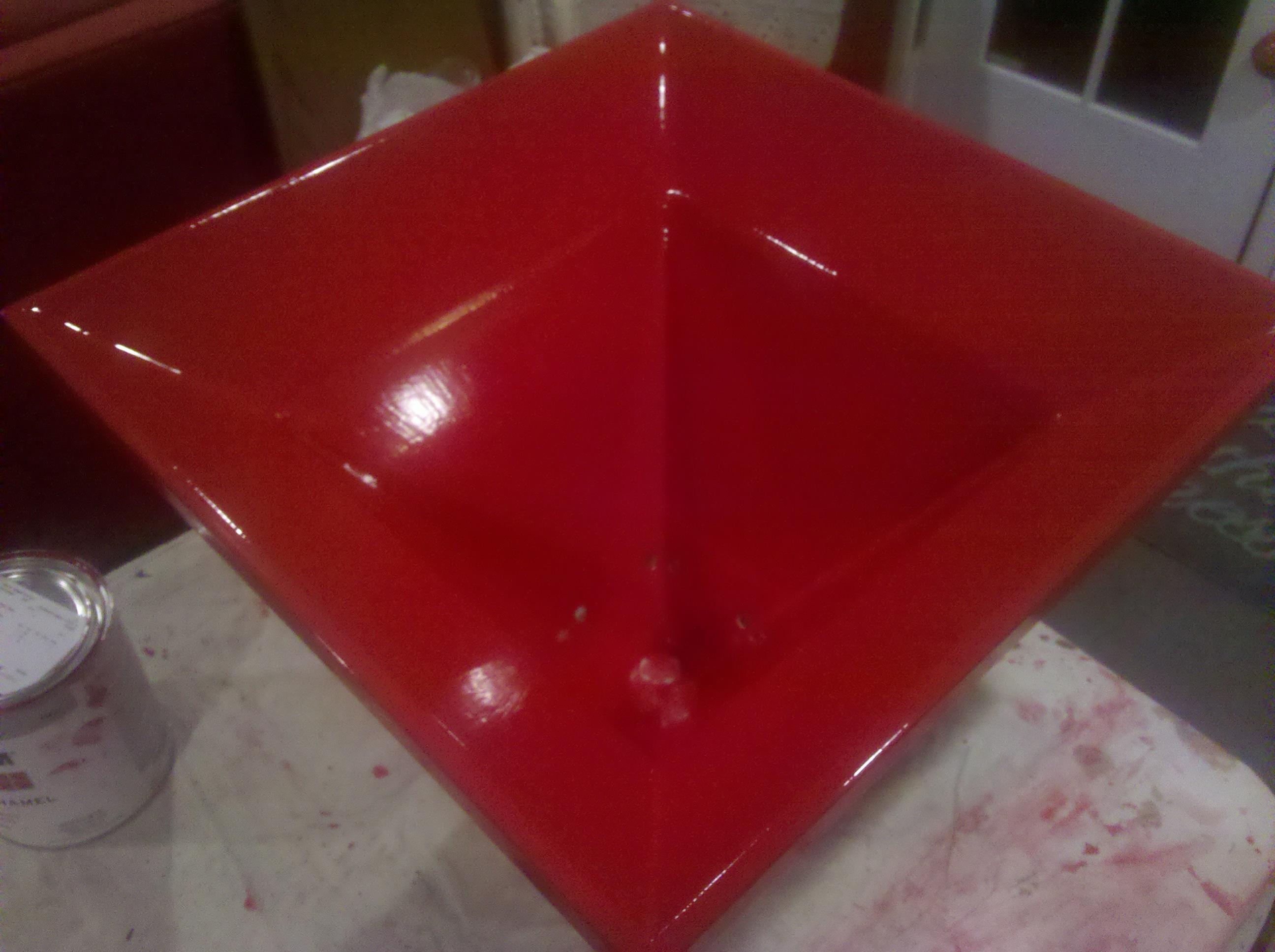

This project isn't dead. My wife and I opened a seasonal gift shop so we have essentially been sleepless for the last few months. It's all packed up now and I finally have time to for hobbies.
When I last worked on the project, I was getting good measurements and everything seemed to be behaving as it should. However, I just didn't think it sounded good. I'm hearing some sort of distortion, but I haven't yet figured out how to get distortion measurements. I've got a couple ideas:
B)Tidy up my rig. I currently have a hodge-podge of consumer and professional gear cobbled together for this experiment which is the source of a good bit of noise and who knows what it could be doing to be signal. Some equipment mergers and acquisitions are in order.

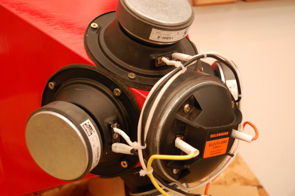

A) Widen my midrange ports. I suspect my ports are too small and are a potential source of distortion. I initially built mine based on data from hancock, but the larger ports used by paulspencer seem to be getting fine results.
I'll post results as I get the ball rolling again.
Oh, and I ordered the kit for this beast.

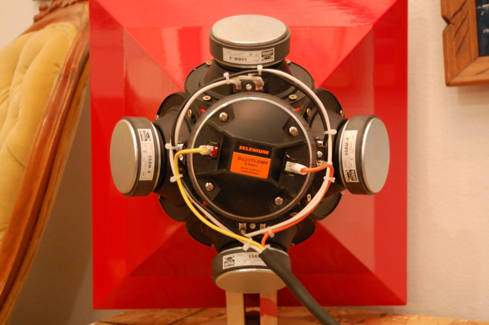

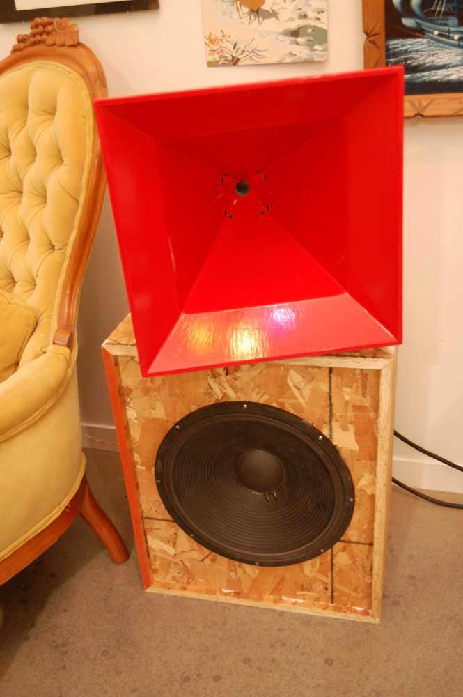

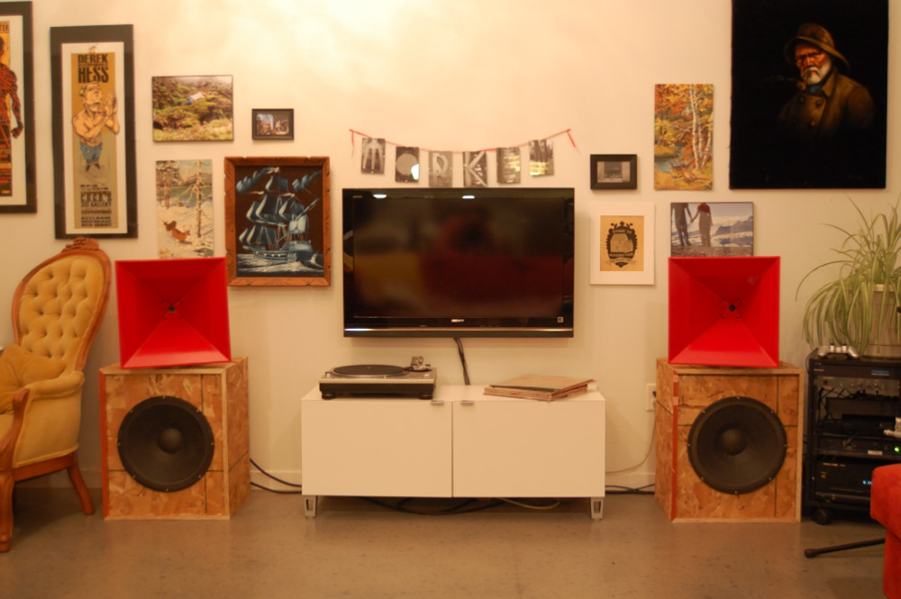

It lives!
Tonight the speakers live!
SO much fun. They sound great. I think Paul Spencer's analogy of the narrow coverage horns to headphones is appropriate - but rather than the image being printed across your forehead as with headphones, it is laid out in front of you. The walls seem to disappear. This lack of room interaction also affords a great deal of detail. I mostly listen to multi-track recordings and only rarely straight 2-mic stereo recordings. This means overly dry recordings (typical of alot of mainstream pop music) can be uncomfortable. On the other hand, well crafted recordings with lots of acoustic detail are a treat. The same goes for dynamics.
On the critical side - high sensitivity speakers are more susceptible to noise. This is made even more apparent by my current kludge of components. I am using the MiniDSP for the mid/high and an old DOD active crossover for the woofers. The mid/high's are powered by a surround receiver and the woofer's by a QSC MX700. Future plans include a passive preamp, another MiniDSP and multiple Tripath kits for amplification. Also, I am working the d220ti drivers way too hard (12db BW @ 1200hz) and hope to replace them with BMS 4550's. When rocking out real hard they sound strained and give a kind of nasal quality to the tone.
Other details: woofers are McCauley 1560b 15"s in 3.5cu.ft sealed enclosures. Sources are my PS3 (as a media server) out to a no-name DAC, and a Technics 1200mk2 through an ATI phono preamp. Paint is candy apple red Rustoleum.
I made measurements of this system in my living room, but REW crashed before I saved and I am enjoying the music too much right now to re-measure.
