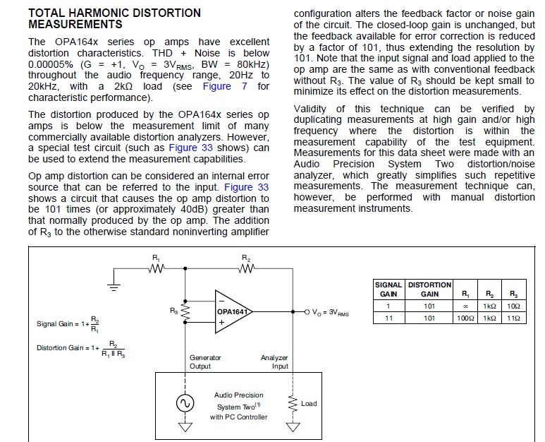

If it's measurable then your circuit has a problem cause no AP can measure it with lm4562.
When an opamp is marginally stable it will work better with a gain of 3 to 10. To keep the system gain at unity an input resistor voltage divider is used to reduce the input by the same amount as the gain! Seems silly but does give better stability.
The inability to even measure distortion from so many high performance opamps is mentioned in their data sheets.

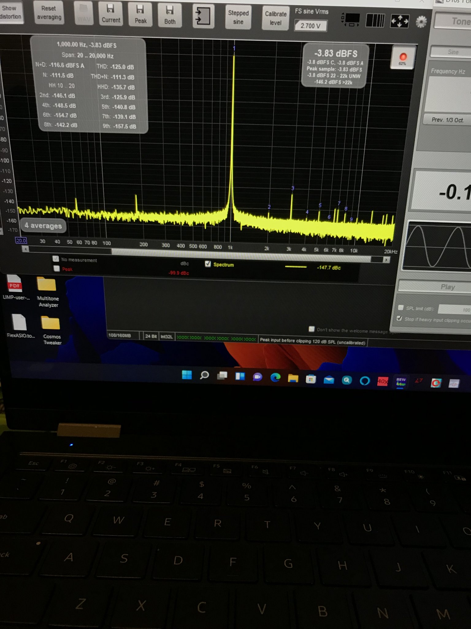

At this point it seems to be good down to -111db thd+n, basically equivalent to connecting the d10s directly to the e1da adc. I have verified the same with my Quantasylum qa402.
I will test it tomorow with an smsl su-9 dac which has much lower distortion at about -120db thd+n.

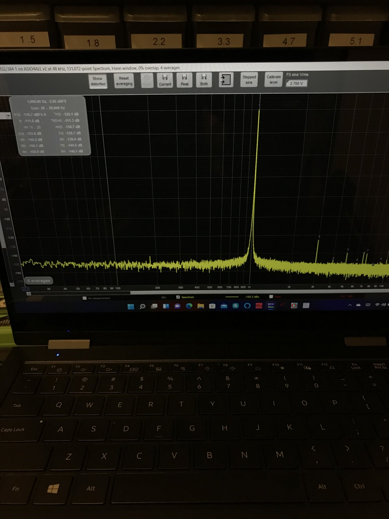

Tested on the smsl su-9 dac today and reached the boundary of this buffer circuit without going to a well designed printed circuit ( which I am not capable of).
Direct connect to the e1da dac I get thd of -125db and thd+n of -117.5db.
When I go through the buffer I get the following so at least I know the limits on noise now.

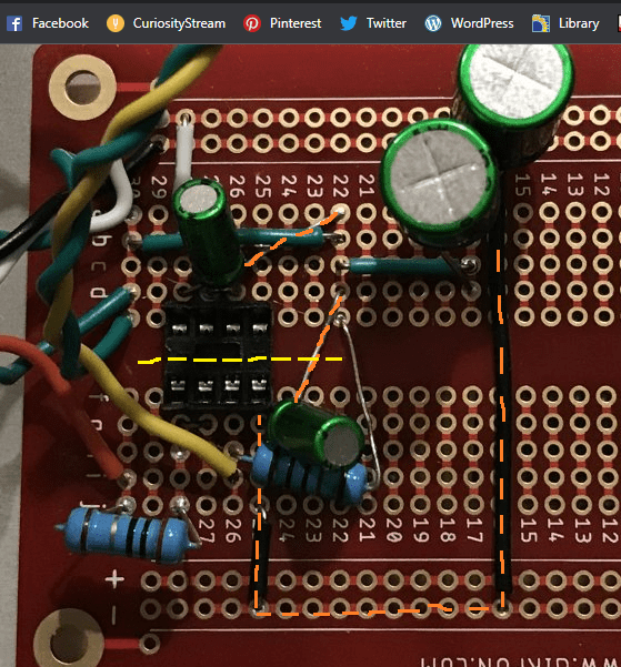

Hi HearingAids,
Couple o' things . .
- in your pic in post #68, I don't see the recommended 0,1uF supply bypass capacitors
- maybe it's just me, but I wouldn't use NP electrolytics for supply bypassing
- forcing use of the pad-rows of the breadboard is causing some unwieldy ground returns -- dashed orange on the pic

Thx for your time in reviewing it. I tried 100nf film and separately and combined with .01uf ceramics for higher frequencies. The best results I got were with the 10uf np. Maybe better with lower frequency issues. I don’t understand it.
Ok so on the ground bus. Run it on the solder side and connect to the perpendicular pad row where a ground is needed? Or am I misunderstanding?
You're welcome!
Yup, that's it exactly. Should reduce your ground inductance, which helps both stability and EMI susceptibility.
But it looks like you're already pretty much there -- minus 120 dBV S+N is pretty darn good! Congrats!

What about running power supply wires directly to the pad rows rather than down the + and - busses? Which is noisier, the power supply wire direct but obviously no longer twisted with it’s partners or the busses on that board?
You could get better common mode behavior by using one single regulator across the V-V+ and a virtual ground placed very close to your IC.It will help you when you get to the real world pcb using its own supply. Usually positive regulators don't have similar behavior while a virtual ground reffered to both rails obtained from one single regulator should improve the common mode noise.
Since you have only a single DIP8, I would skip the + and - busses on the Vero board. Each has only one connection once it gets past the local decoupling capacitors. Those can often be arranged neatly in two clumps, one near pin 4, and one near pin 8.

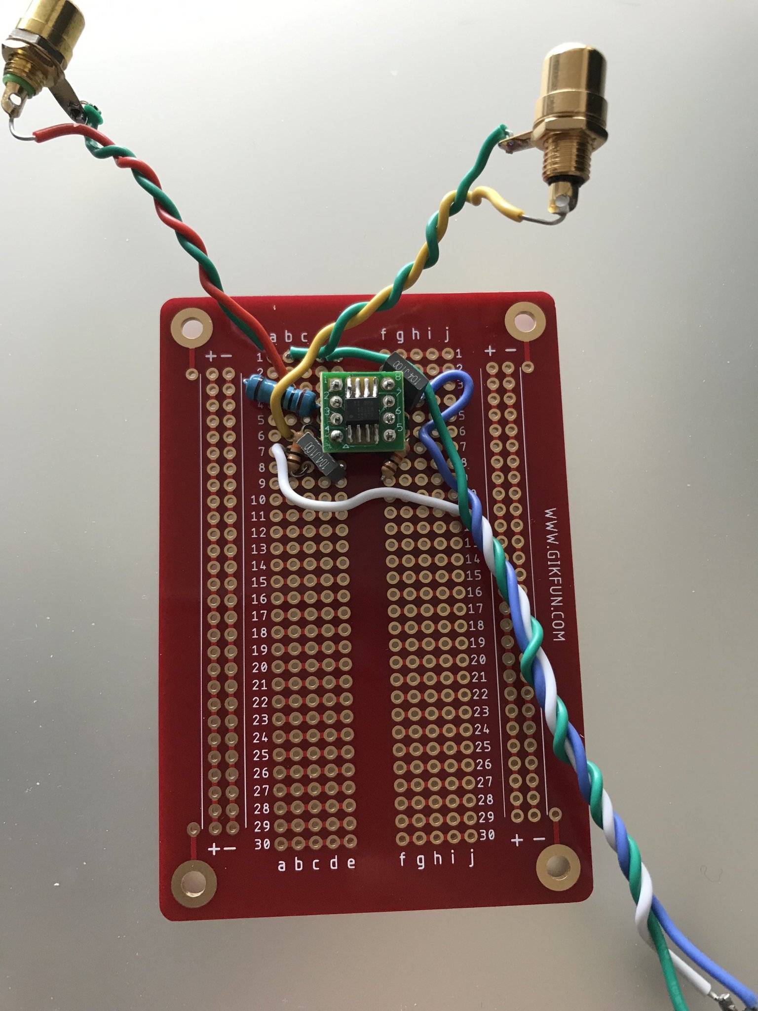

@Rick PA Stadel I tried to follow your suggestions. As several had suggested also I went back to the 100nf bypass caps rather than the 10uf which did not improve things but didnt make them worse and since smaller left them in. I also took out the larger 220uf caps. I tightened up layout and ran the ground bus on the bottom side. Improved about another .5 or so db.![]()
